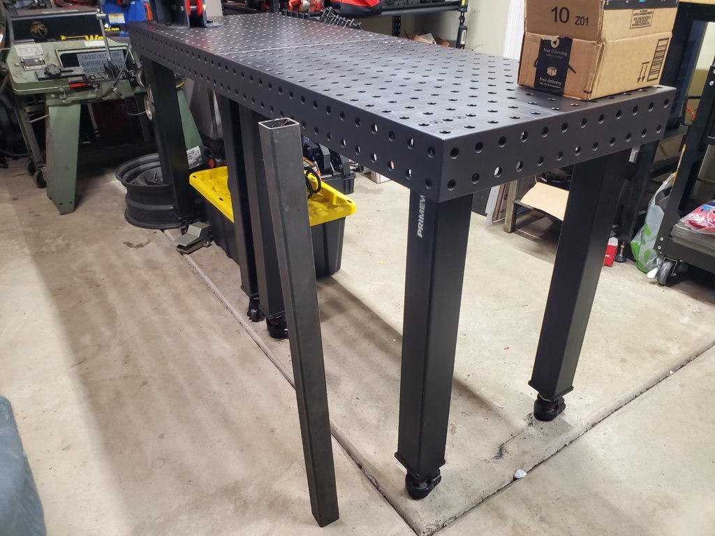

    Out here, a stick is 20' or 24'
    How long are they over there?
    I've got a 3' section of 2" square tube (.120 wall) you're welcome to
    Think it's been in the garage for some 2+ years now :anonymous:

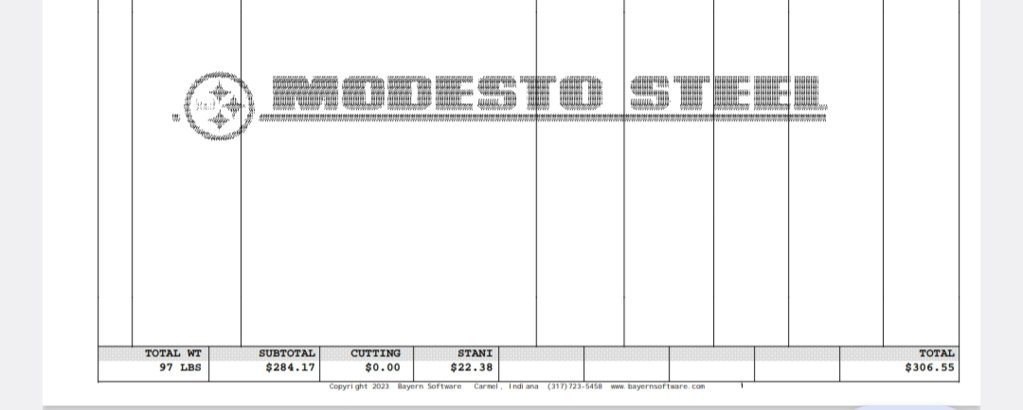

    Well... they only had 2 sticks. But I paid for them. Gotta pick them up on Monday when a buddy with a ladder rack can help me out.
    That's the thing that sucks about 20 ft sticks of metal. lol
