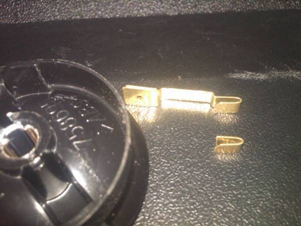

    I used a simple fuse tap from radio shack (make sure you get the ones for ATC fuses as they are larger than the mini's). You can see in the pic below how I cut a piece off of it. I used a pair of snap on cutters.

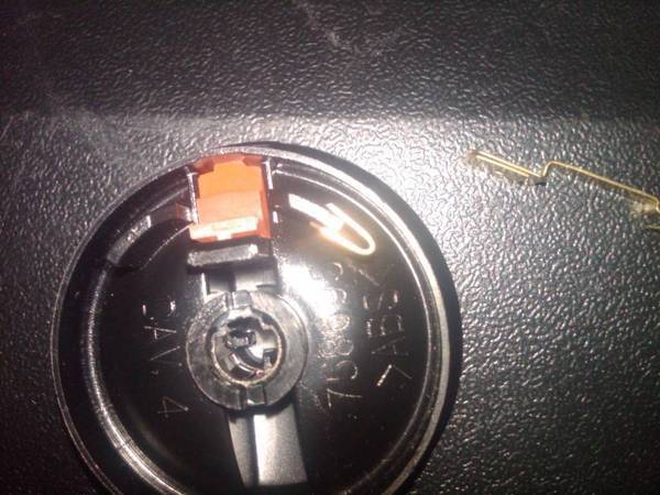

    What you want to do is slip the piece you cut off over the end of the stopper so it makes it about an 1/8" or so longer to keep the knob from turning all the way. What I did to make sure it turned the proper amount was to slip it on the stopper piece and pop the knob back on and turn it to see how much if any adjustment was needed. Just make sure you don't lose the part inside the heater controls...

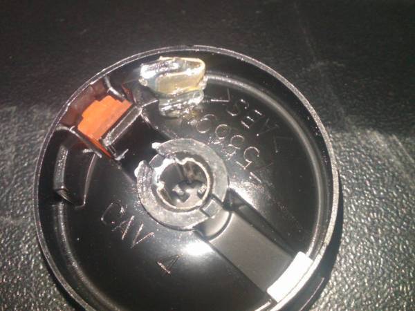

    Here's a pic of mine after I tested it:

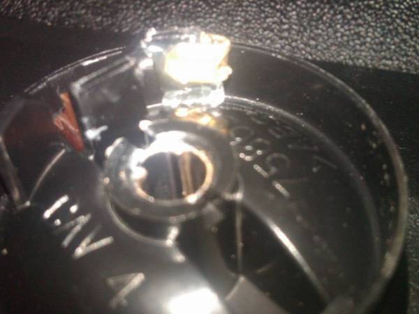

    Now all you have to do is add a little hot glue to the INSIDE edge of the stopper ( if you get glue on the outside, the knob wont be able to turn) and a little glue on the top to fill the space between the original stopper and the piece we've added to make sure it cant shift back and allow the knob to turn all the way. Here's a pic:
    And another from a side angle:
