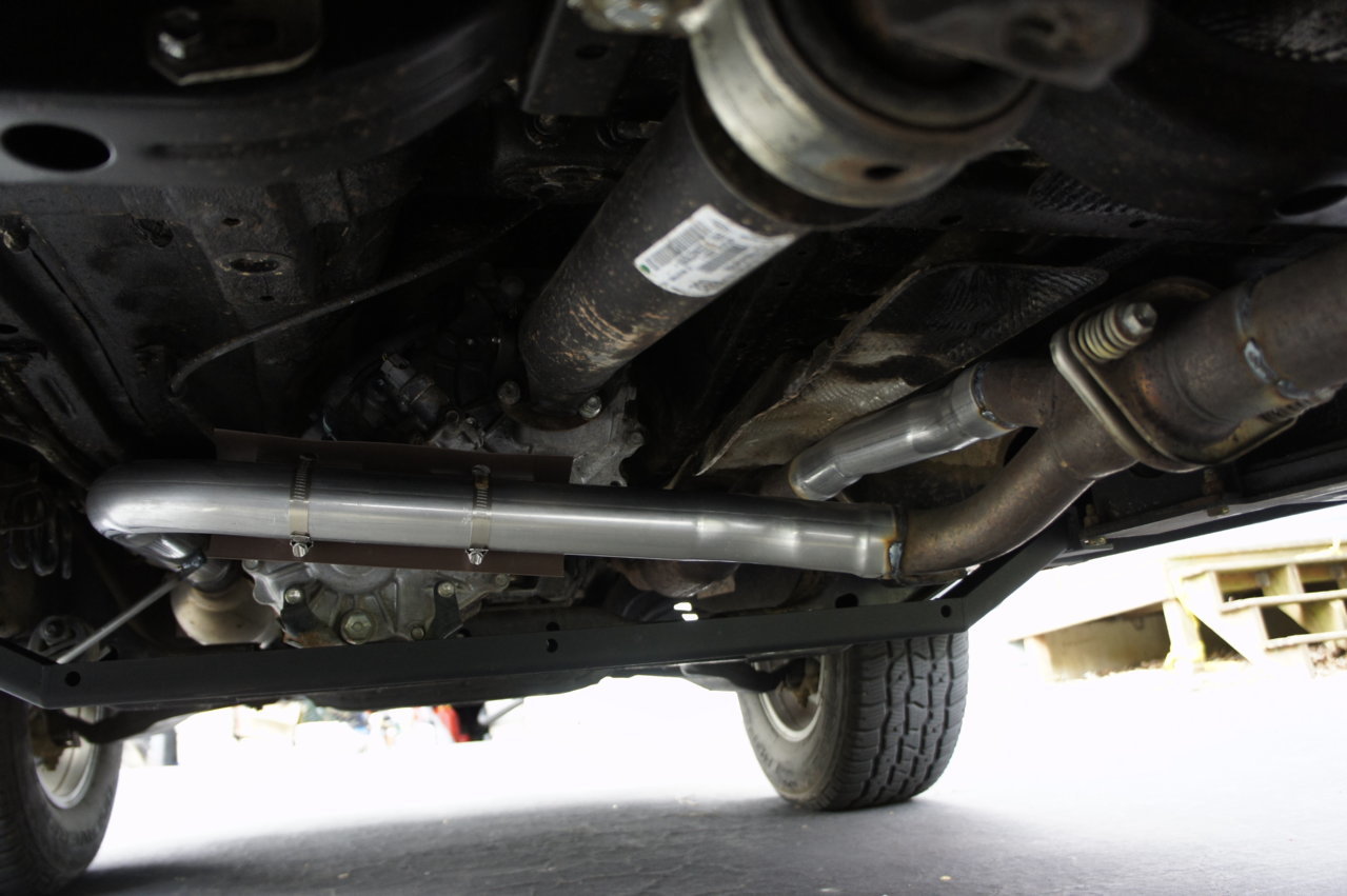

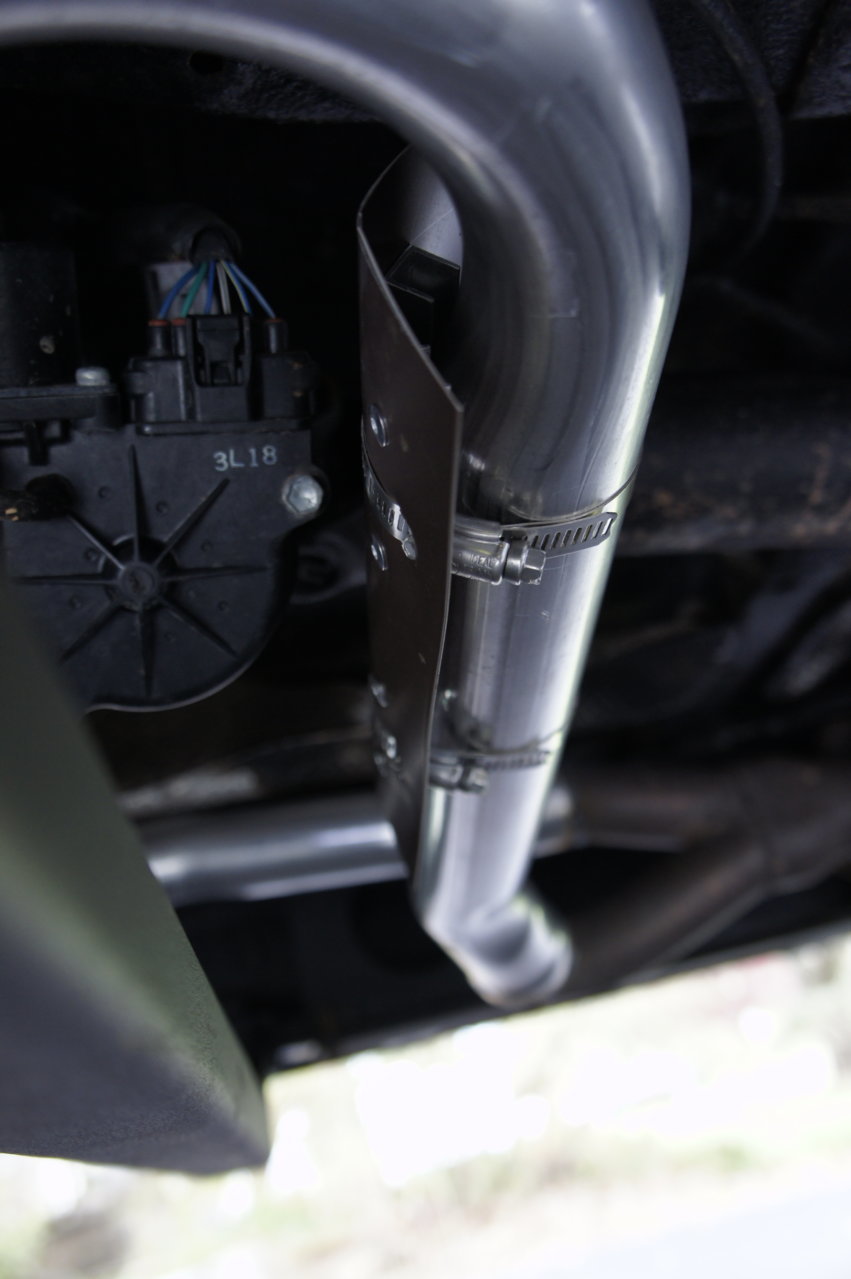

    Had an exhaust reroute done (4/2020). Built and installed a heat shield for the transfer case. The exhaust pipe is not as close to the transfer case as it appears in the photo.

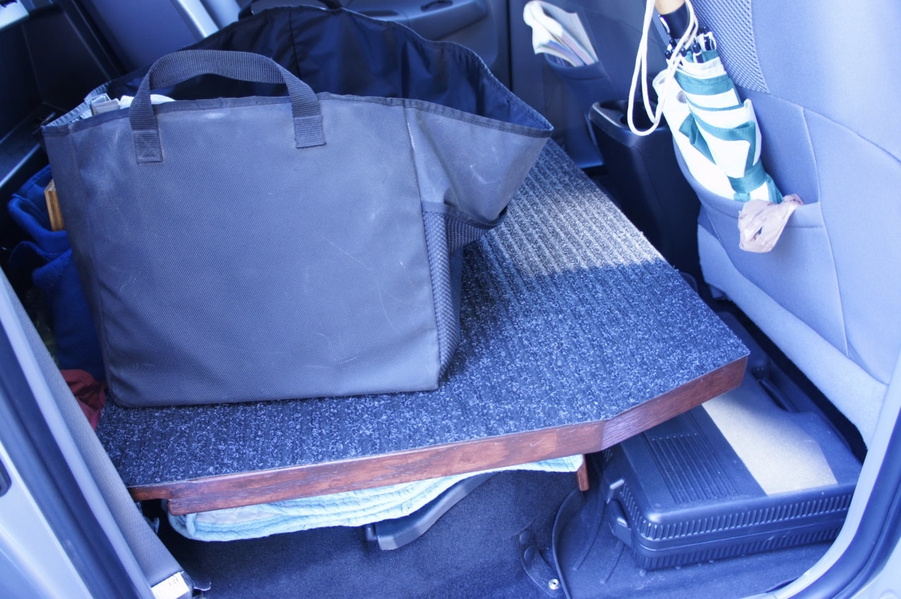

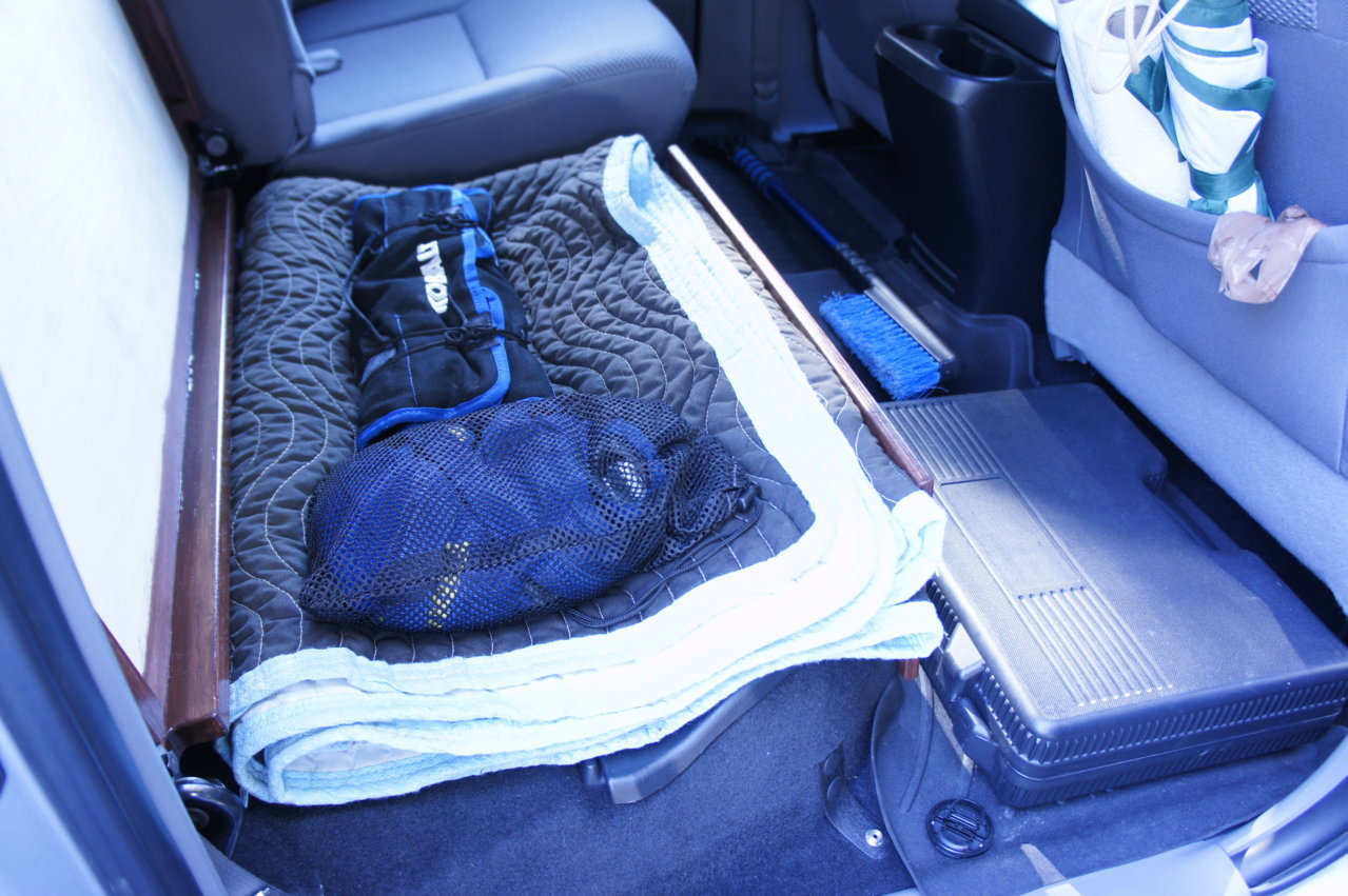

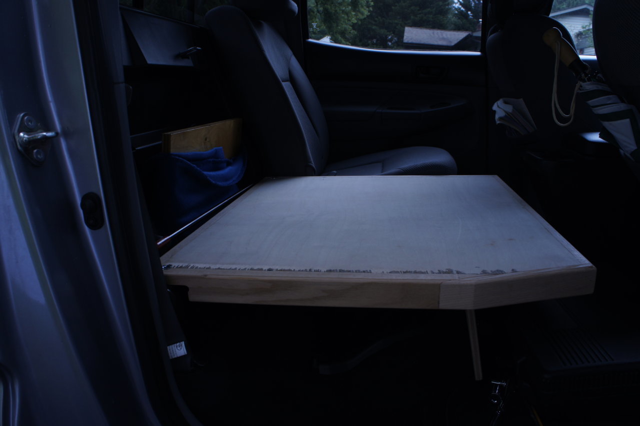

    Two Thirds Rear Seat Delete:
    Used the existing seat hinge(s) so the platform can be raised and lowered.
    Platform Test Fit
    Platform Test Fit
    Under Platform Storage
    Platform Finished
    Platform in Use
