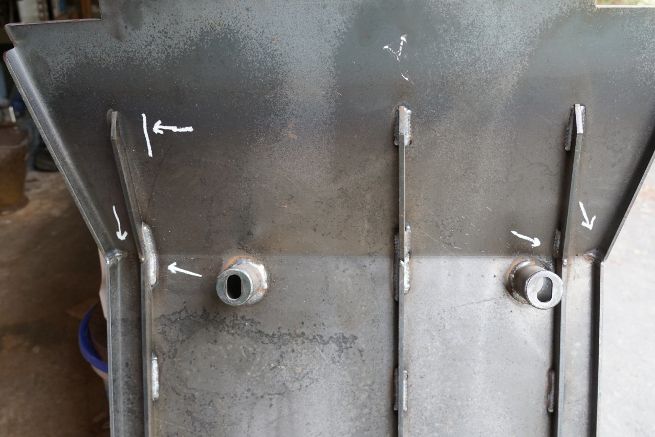

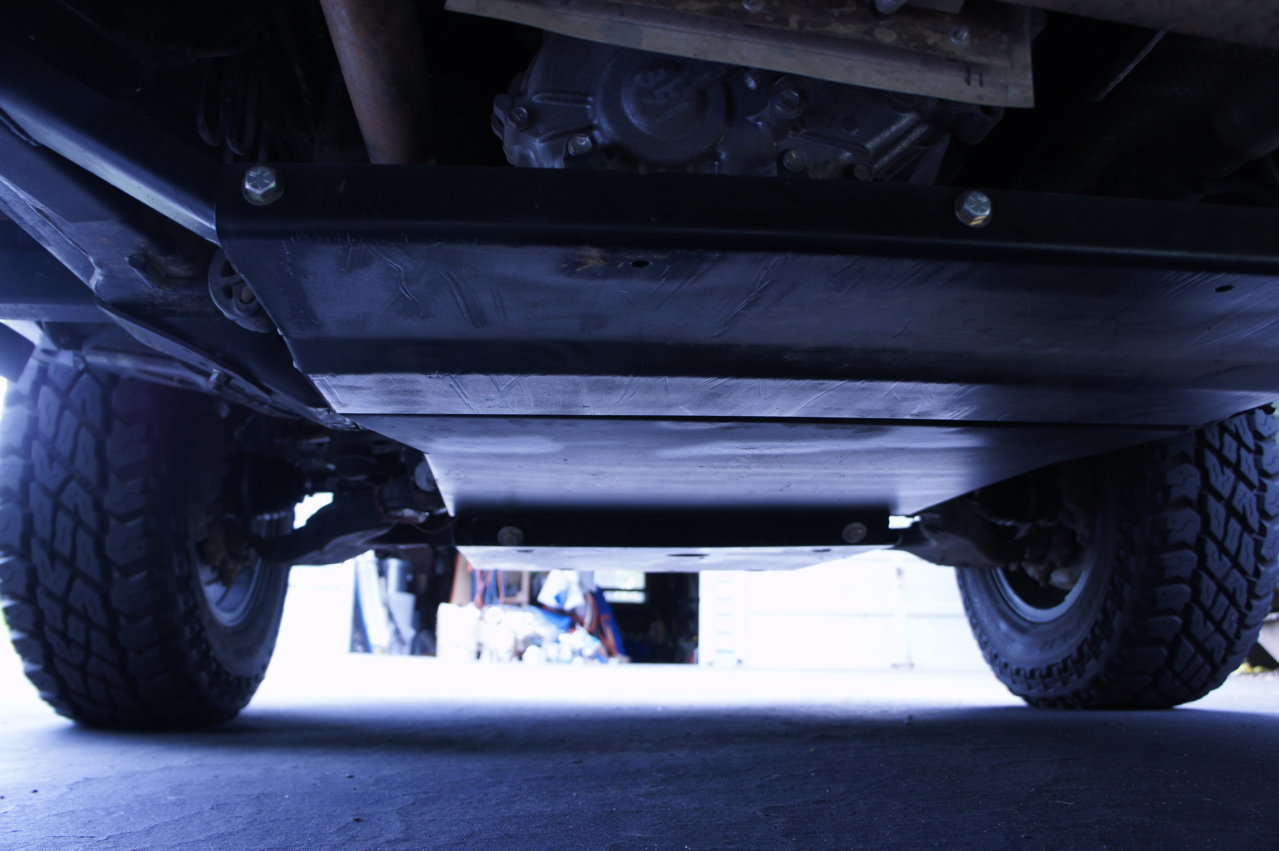

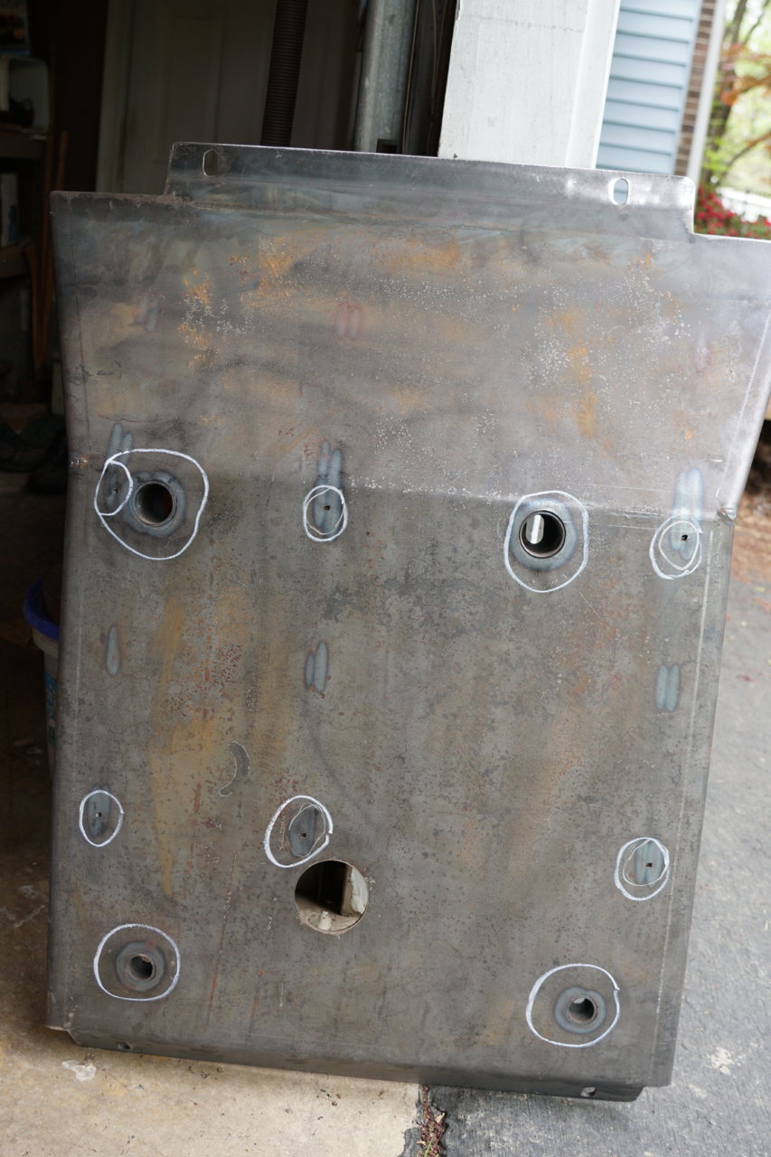

    Winter of 2020, Spring 2021
    Old skids removed and sold. New Mobtown skids and new TrailToys UHMW gas tank skid installed.
    Old warped skids
    I contracted Tony to enhance some of the welds.
    New Mobtown IFS, Mid (transmission) and transfer case skid installed.
    New TrailToy UHMW gas tank skid installed.

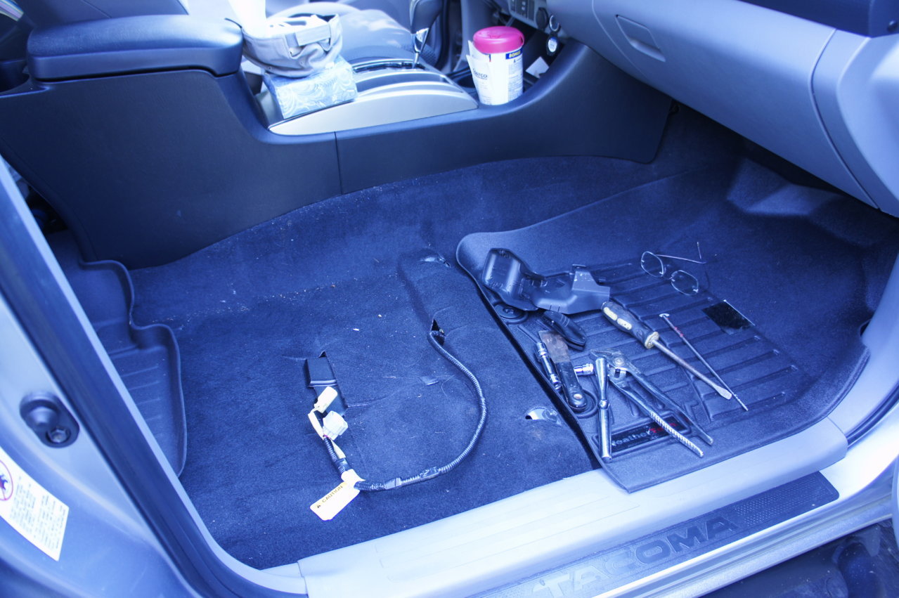

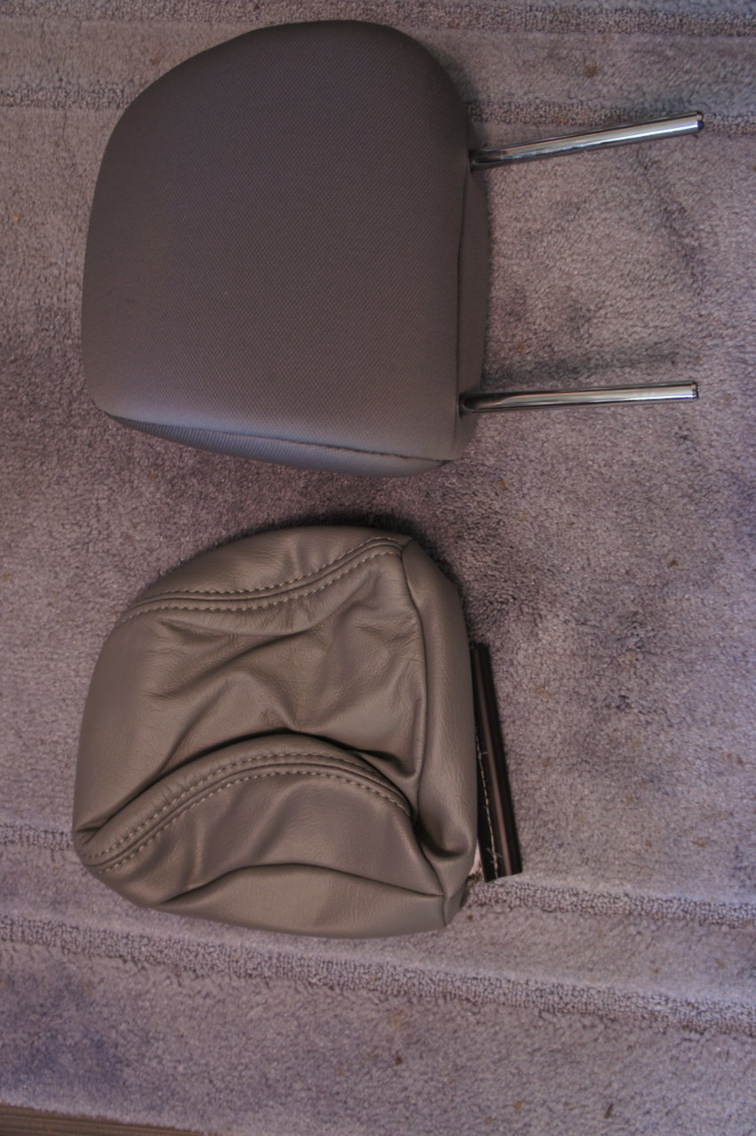

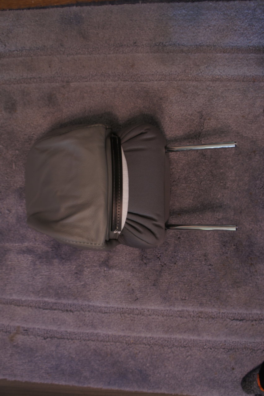

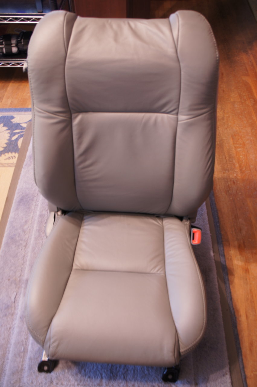

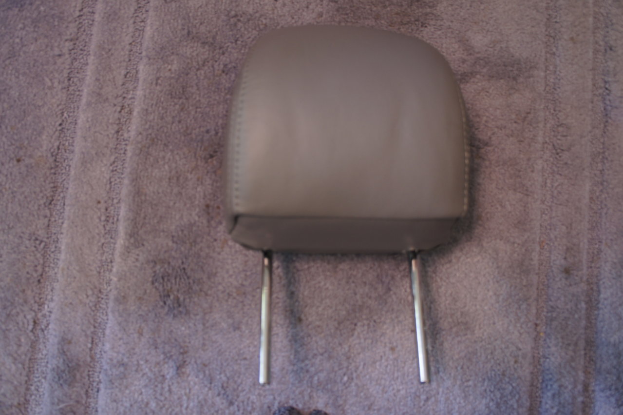

    Reupholstering the front seats is the summers Tacoma project. Started 7/17/2021, seats installed 7/22/2021, final electrical 7/23/2021.
    Got a good deal on a set of new old stock Katzkin leather seat covers. Decided to add seat heaters. First bought “Dorman” seat heaters, because they were cheap. Sent them back, because they were cheap. Eventually went with Clazzio.com seat heaters. I like the controls, Clazzio said it would fit a 3rd gen escutcheon. Tryed it in a 2nd gen and it fits.
    Since I had to strip the cloth covers I also replaced the driver seat foam. The driver seat was noticeably softer than the passenger seat. Considered refurbishing the old seat pad. Decided to replace the pad. There is no aftermarket pad option, replaced with a Toyota OEM seat pad ($$).
    Passenger seat removed.
    Headrests being recovered.
    Removed the OEM cloth seat cover. Note: There was a post on TW saying that the seat cover had to be cut off. Thus the OEM cover was not reusable. In my case, totally erroneous, the OEM covers can be removed without destroying them. Cut the hog rings, not the OEM seats.
    Seat heaters added
    Seat back and seat covered (Katzkin)
    Seat with headrest "ports" cut in. The leather is slightly wrinkled and the vinyl droops. The all knowing internet says install the seats and the natural summer vehicle heat will shrink fit the covers to the seats.
    Seat heater control installed (Clazzio.com)

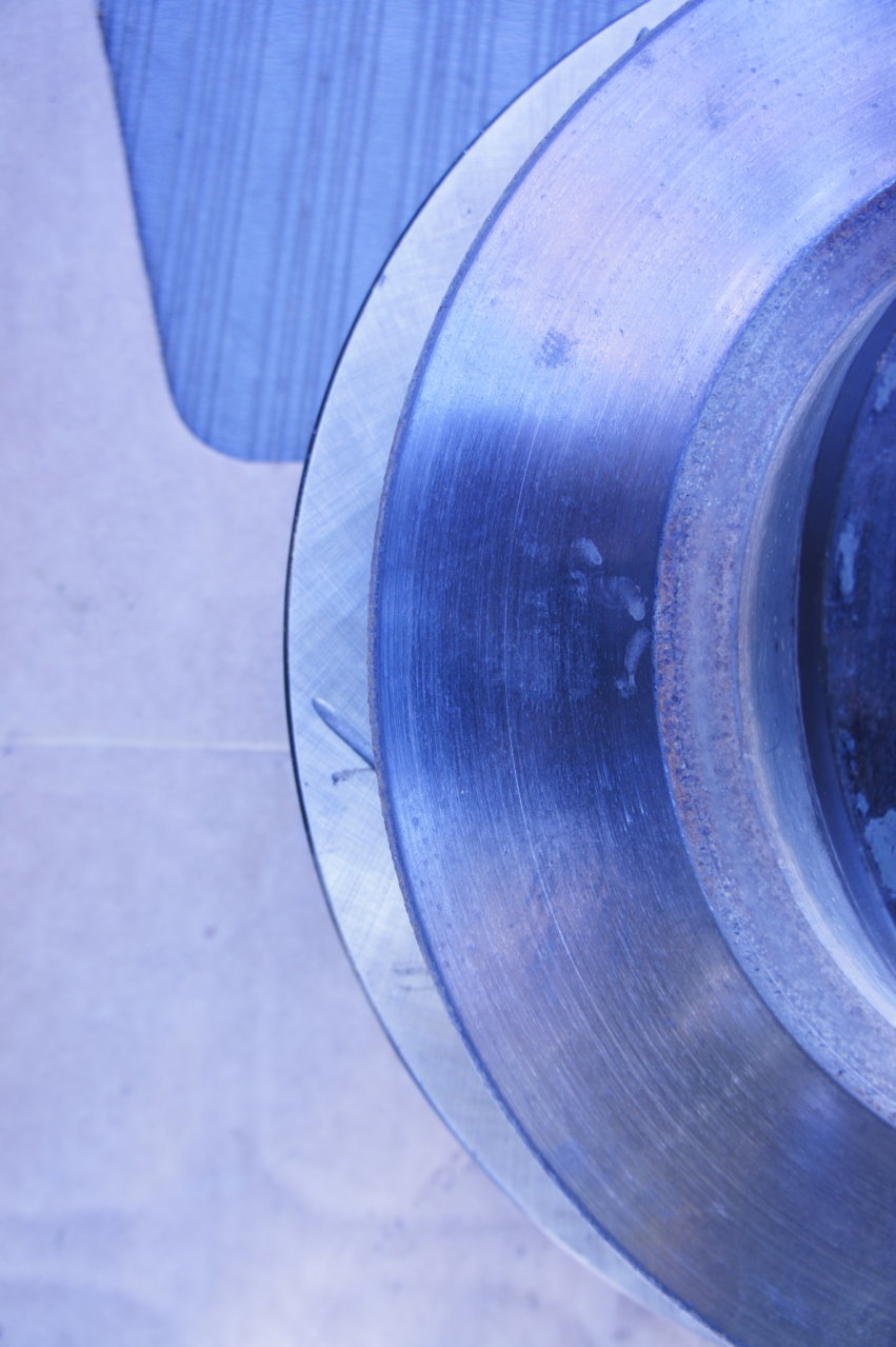

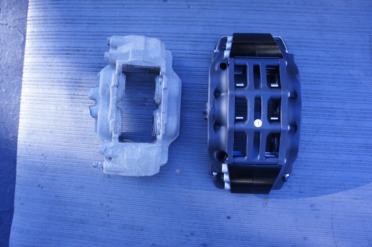

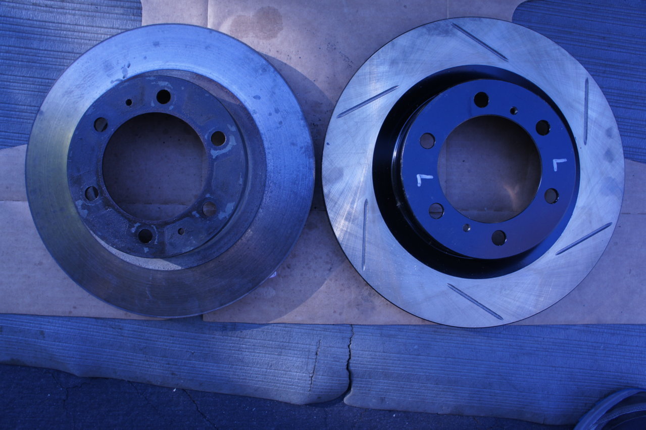

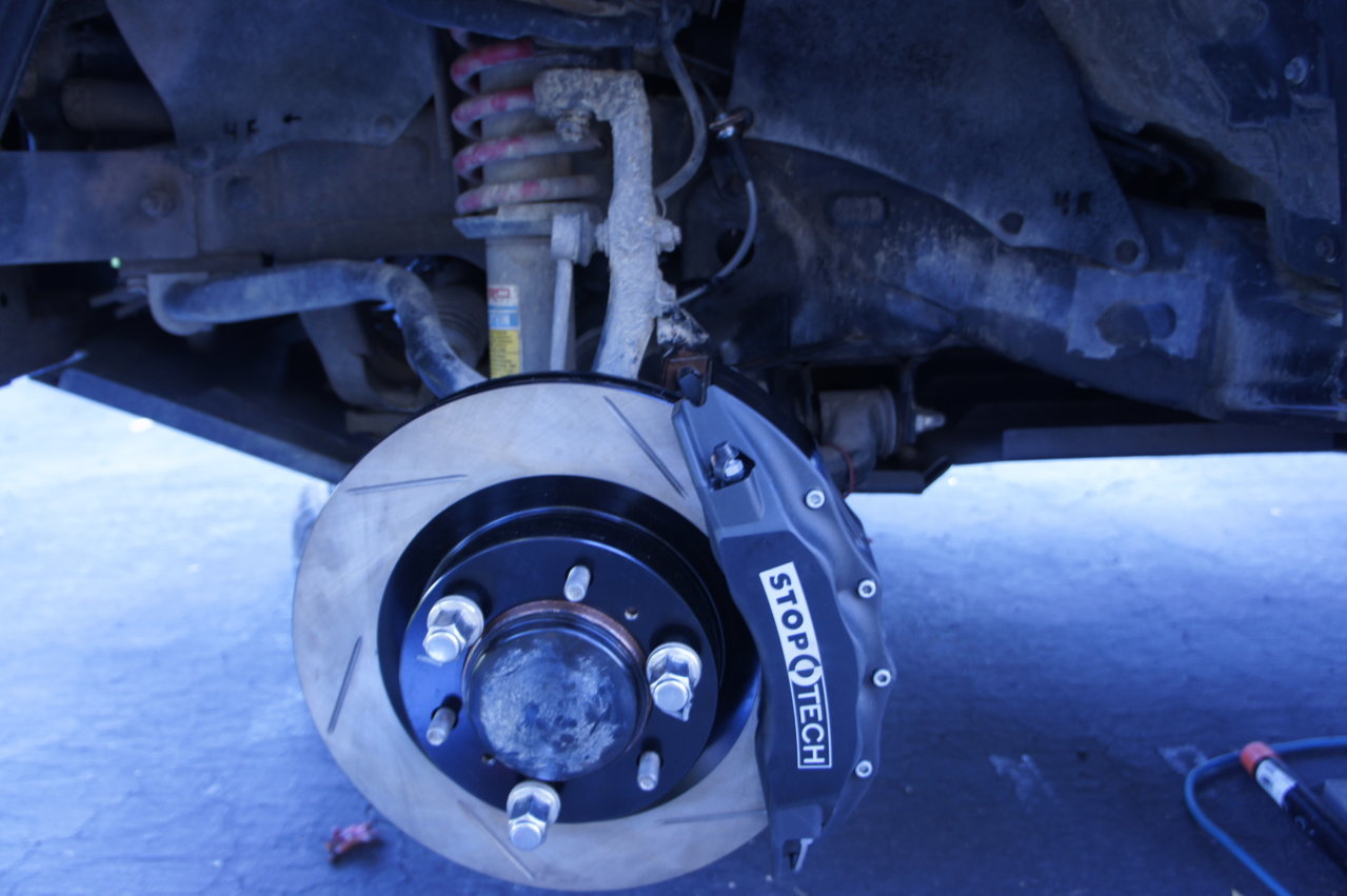

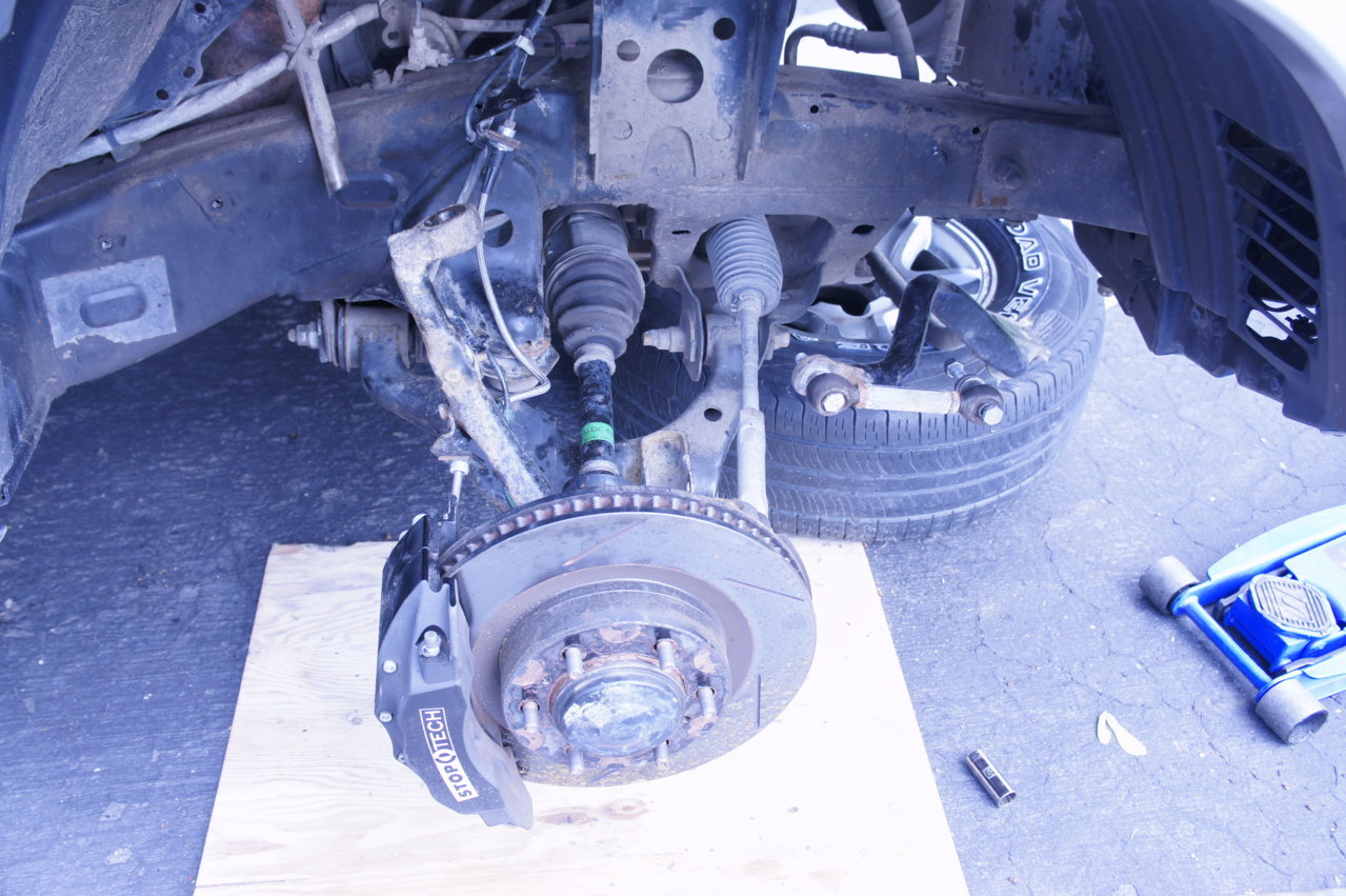

    StopTech 6 Piston Big Brake Kit (BBK) installation (Oct 28, 2021). Admittedly I went off the reservation on this one ($$$).
    StopTech Rotors - 340mm x 32mm, OEM 320mm x 28mm (26mm minimum)
    126.44174SR (slotted right)
    126.44174SL (slotted left)
    Hawk Ceramic Pads - HB122 Z.710
    StopTech SS Brake Line Kit - 950.44006 (+3)

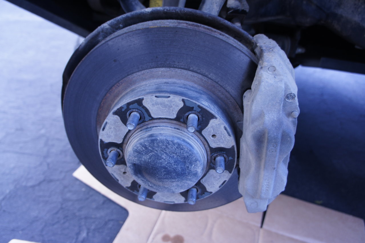

    On the last outing my brakes were noticeably fading on the longer technical trails. Time to up grade the brakes. The installation is too new to give an opinion other that they are shiny. Lessons learned: Start with the 3 pound hammer to get the old rotors off.
    OEM Brakes @ 60,000 miles and 7 years. The pads were replaced & the rotors were resurfaced @30K.
    OEM Rotors vs StopTech BBK
    OEM 4 Piston Calipers vs StopTech 6 Piston BBK
    OEM Pads vs Hawk Ceramic
    StopTech BBK Installed
    Order Page and coupon (taco-gb)
    Quick delivery. Ordered Oct 21, arrived in 2 shipment's (Calipers, pads, hoses Oct 25 & Rotors Oct 26).
    NEW 6 PISTON FRONT BIG BRAKE KIT fits Toyota/ Lexus TRUCK & SUV

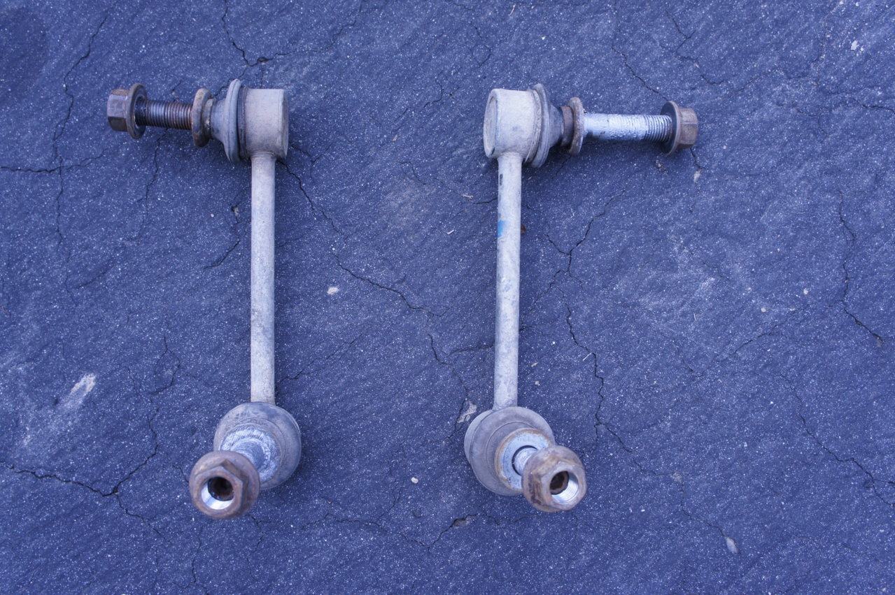

    Installed Overland Custom Design sway bar end links (Oct 30, 2021).
    I bought end links 2 years ago in a group buy. Since the truck was up on jack stands, I decided now was a good time to replaced the sway bar end links. :notsure:
    For considerably less Moog makes grease-able end links. Not as beefy as the Overland Custom Design but more stout than OEM.
    OEM Sway Bar End Links
    Beauty Picture of new brakes caliper, rotor, hose, and sway bar end link.

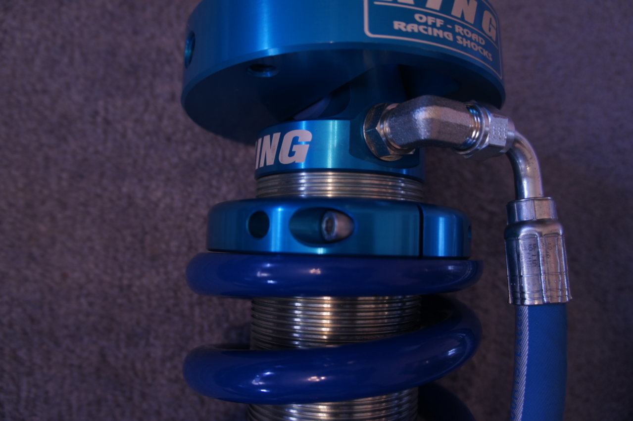

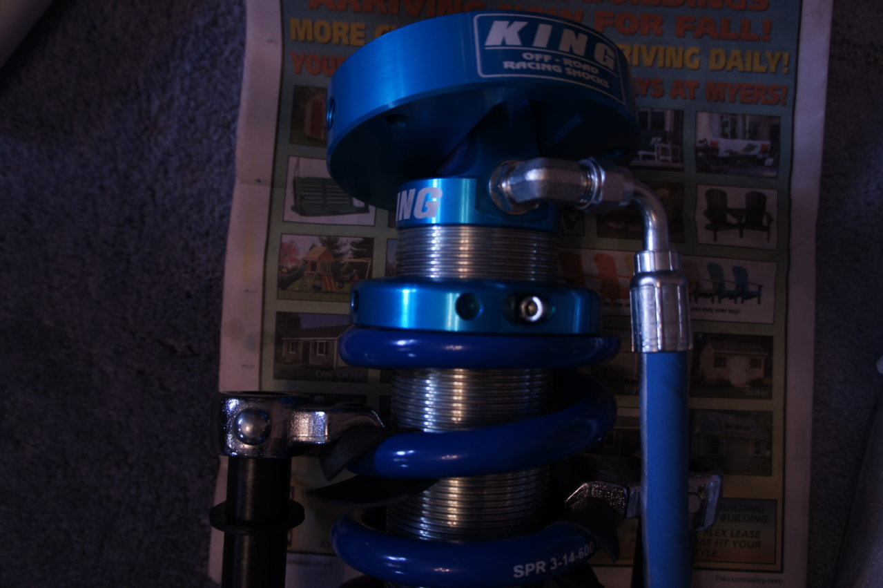

    Black Friday 2021 purchases have arrived. Ordered from Headstrong and Camburg, 11/26/2021, arrived 12/8/2021. Still waiting on bump stops and bolts from Wheelers. Order placed 11/24/2021, no shipping as of 12/09/2021.
    • King 2.5" Coilover w/ Reservoir AND Compression Adjusters for 05+ Toyota Tacoma - 600 lb coil spring - EXTENDED. (25001-119A-EXT).
    • Camburg Toyota Tacoma Pre/4wd 05-21 Performance X-Joint Upper Arm Kit
    Un-boxing King Coilovers a Camburg UCA
    Stock Preload (~2” lift)
    Preloaded, +5 turns Driver, +4 Passenger (~3” lift, with drup hope to get 2.5 - 2.75”)
    With spring compressor
    To be installed when the weather turns sunny and 60.

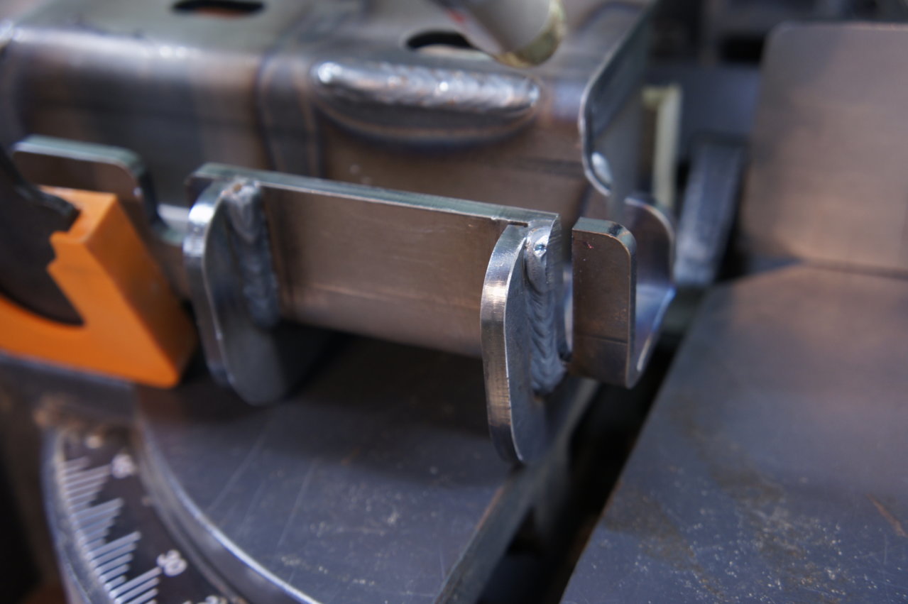

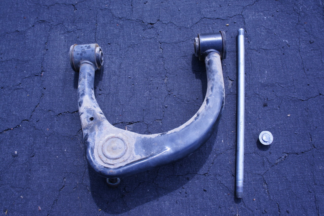

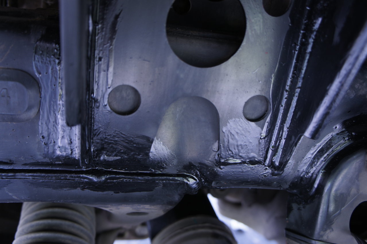

    King installation finished (6/16/2022). Truth in advertising. The truck has been on jack stands for a few weeks. The actual coilover and UCA removal and installation went fast (enough).
    Issues:
    Rust, A lot of time went into chasing the rust.
    Issue with the King remote reservoir mount. It interfered with the original aftermarket frame bumper end mount reinforcement. I’m not the first one to have this issue. Some people notch the King mount. I ordered new reinforcements from BAMF. They bolt on to the frame differently (closer to the winch mount).
    Issue with the BAMF reinforcement. It did not want to play with US Offroad winch mount. I had to cut about 3/8 inch off (the BAMF) to make it fit.
    Original setup.
    Cut out the OEM UCA. The bolt ate 3 "budget" blades. Ended up purchasing "Swiss steel" blades. Cut right through the UCA bolts.
    Everything out (Coilovers, UCA's & sway bar).
    Chasing rust.
    Trimming BAMF bumper mount reinforcement and installed.
    Kings & Camburg UCA installed.
