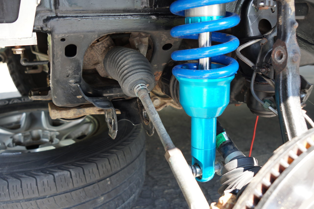

    Truck is a bit less responsive. Lost 2 MPG. Nothing I can’t live with. With full armor and stuff the trucks over 5000lbs. As is I’m happy. A re-gear would get expensive, because while I’m at it I’d add a locker, rear disk brakes and 35’s.

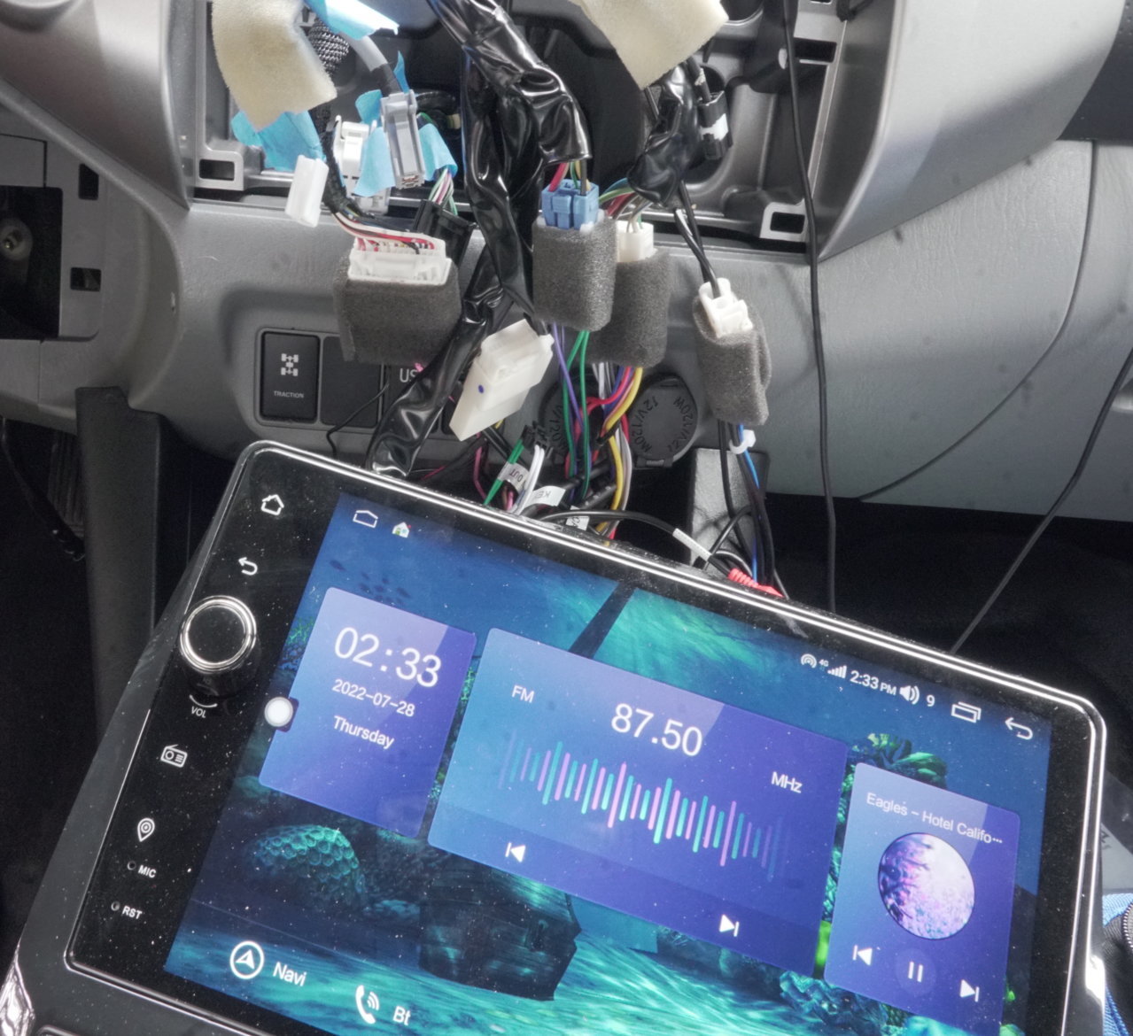

    Joying Head Unit (HU) installation.
    Doc Version: 8/06/2022. Still a work in progress. However, time to live with the Joying, as is, and see what I like and what annoys, etc.
    CarJoying is a automobile HU that also functions as an android tablet. Installation is not entirely plug and play. This is a consolidated installation documentation of the Joying HU drawn from many TW people, TW pages and other websites. Sorry, no attributions are provided, this doc took way to long to create as is. As always YMMV.
    Why Joying? It's an android tablet so many apps are available. For example the plan is to add Gaia maps and Amazon Music. Dasaita is another popular brand. However, the 9" Joying looks OEM. Its also 1/2 the price of similar Kenwood, JVC (etc) units.
    The Plan:
    My truck is a Toyota Tacoma 2014 TRD Sport (second generation). The speakers and tweeters have been previously upgraded. Planning on using the embedded Joying amplifier.
    Non-JBL. Important for the steering wheel controls. My understanding this means no CANBUS. This dictates which wire harness is employed. For me w/o the "redbox".
    No Toyota navigation (GPS). Eliminating the Sirus/XM radio. Keeping the stock backup camera and adding a front camera. Already have a Scangauge II, so no need for the Joying OBD2 module.

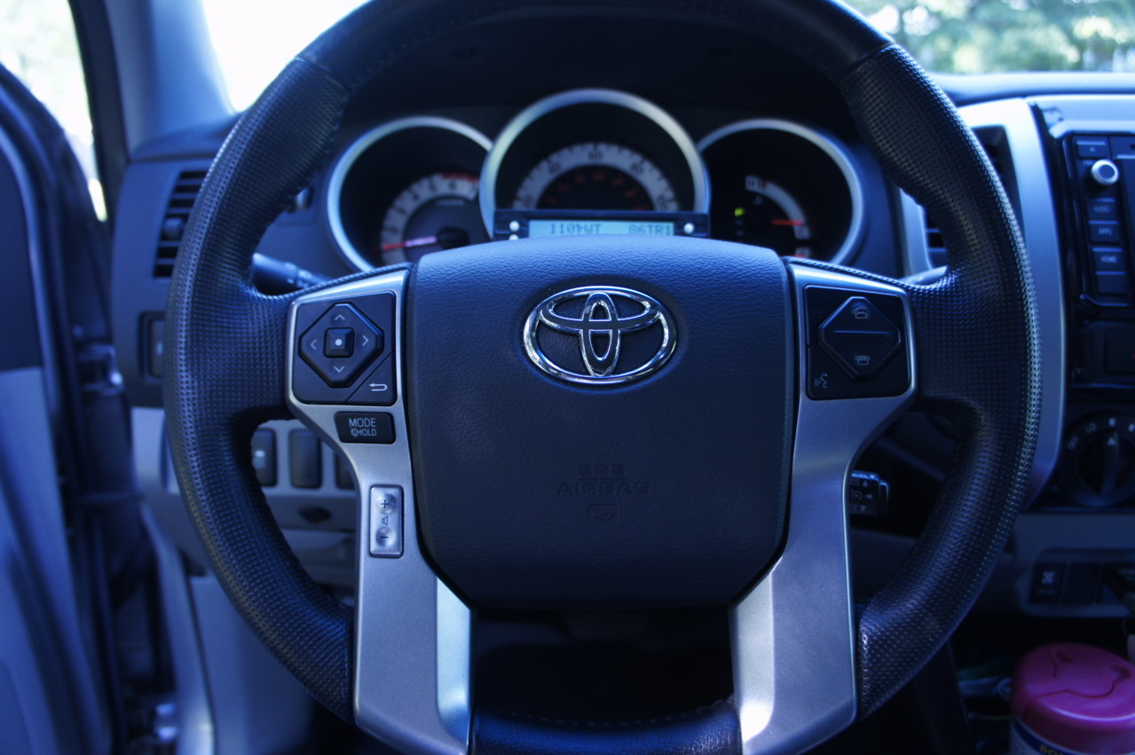

    Steering Wheel
    Stock HU non-JBL

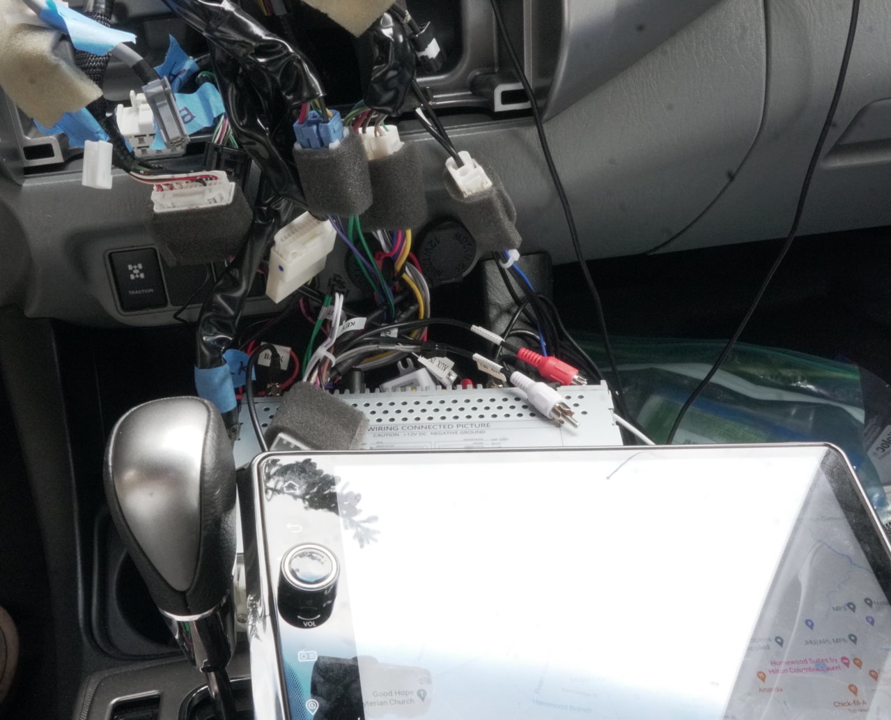

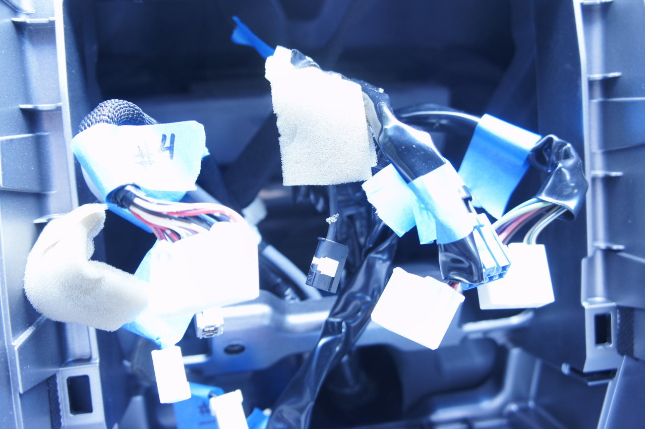

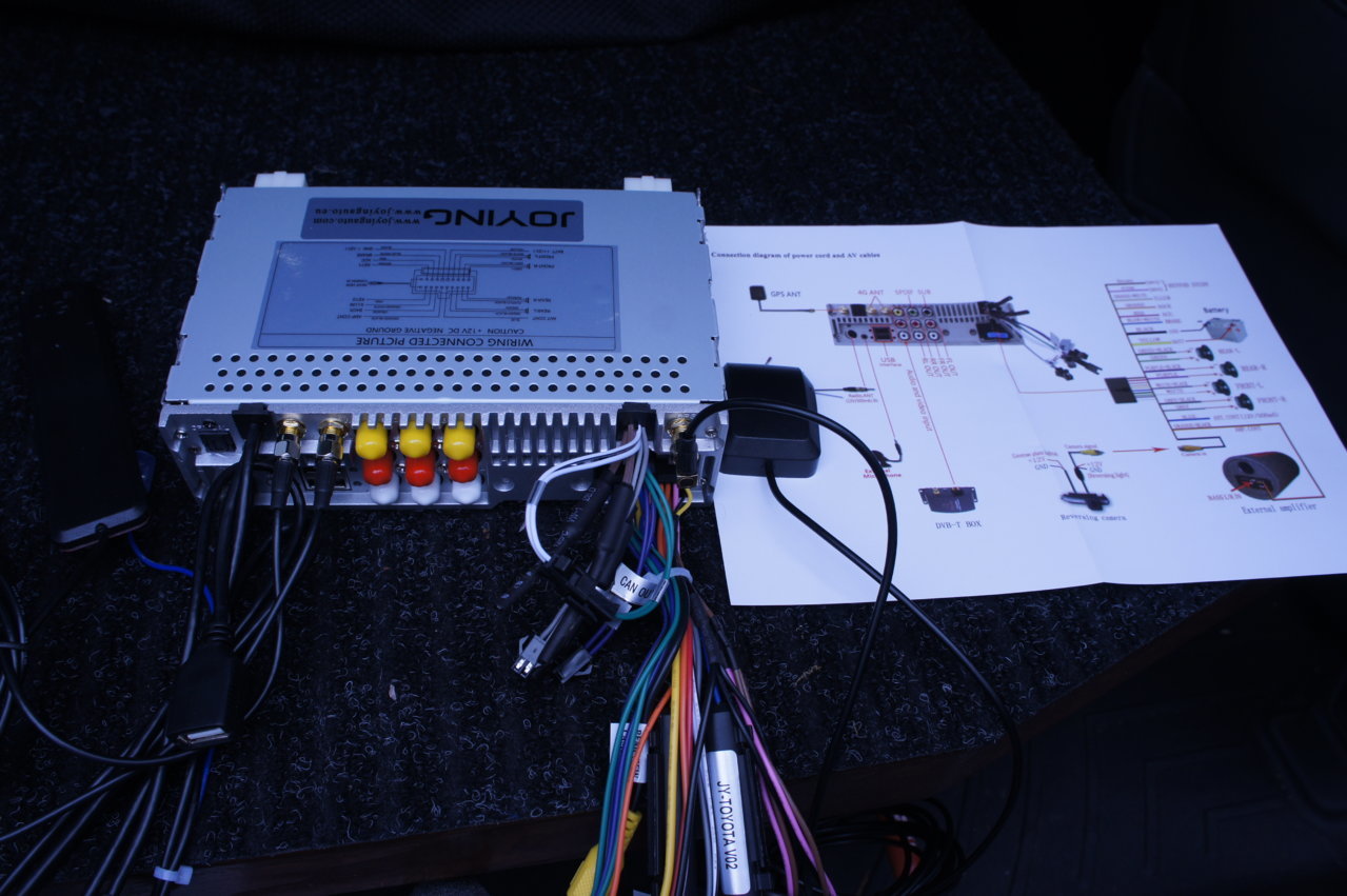

    Remove the OEM HU as per Video2. Removing the trim is not necessary. I label everything.
    Connect the Joying HU (JHU), using the supplied wire harness. Its fairly plug and play, the male and female plugs are all unique and only mate to their respective socket.
    Apply power. Basic stereo and radio should work. At this point no RCA plugs are necessary. T
    he box does get warm, but not too hot to touch.

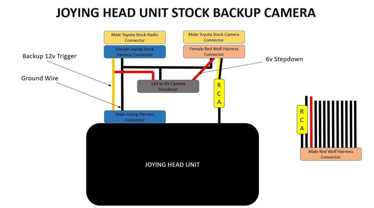

    OEM Rear Camera:
    The objective is to keep the OEM reverse camera. IMHO less wiring, cleaner install. This historically has been accomplished by two main methods. The first is to cut into the factory wire harness. The second method is to add an aftermarket adapter. Logically both methods are the same:
    • Connect power (6 volts) to the rear camera.
    • Connect the backup trigger to the JHU. Telling the JHU the vehicle is in reverse and so turn on the backup camera.
    • Route the backup camera video to the JHU.
    Method 2, using an aftermarket adapter is documented here.
    Obtain these or functionally identical items. #2 and #4 from the Parts List.
    • PAC CAM-TY12 Reverse Camera Harness
    • ZSMAKN DC Converter 12v to 6V

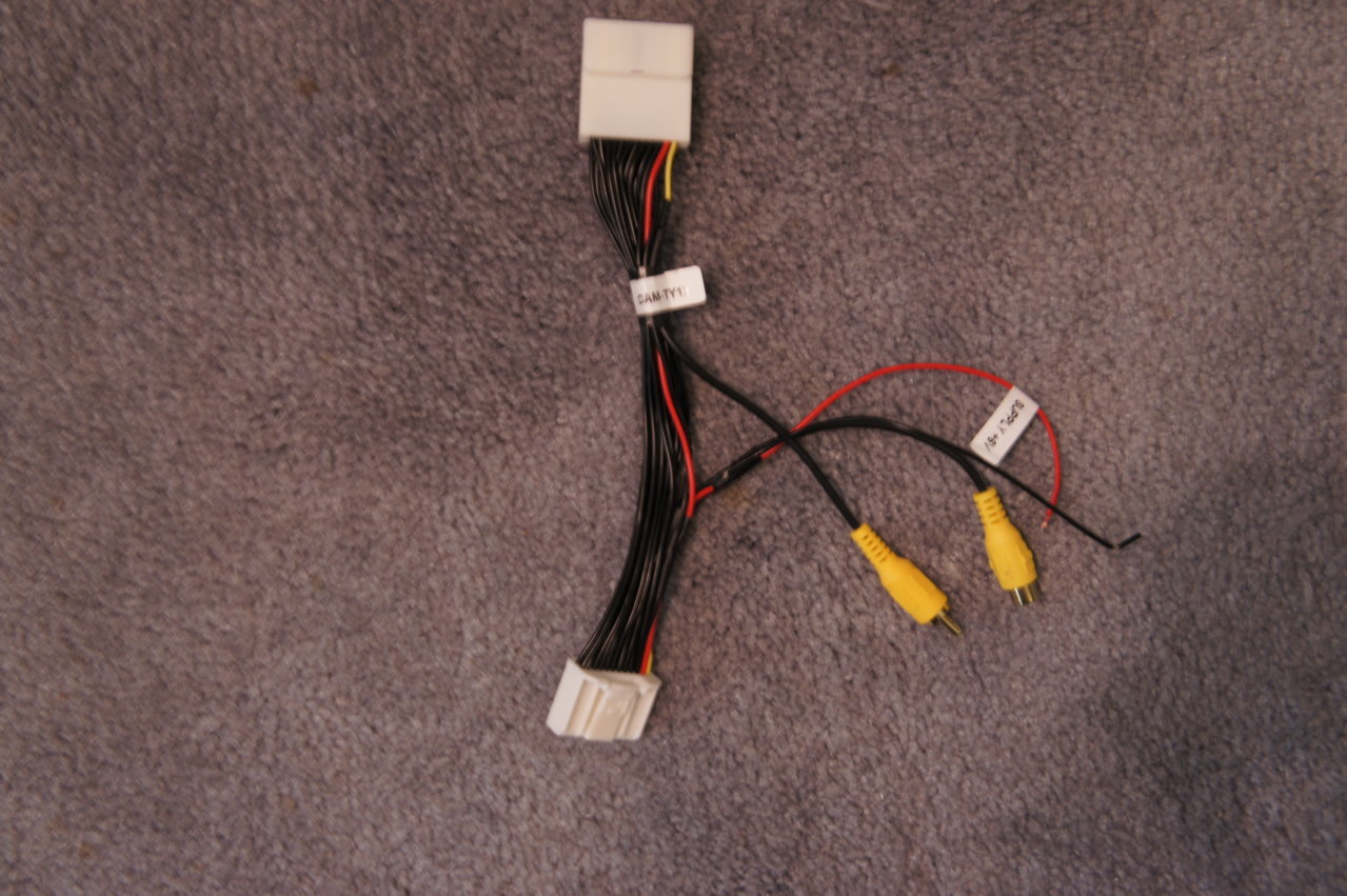

    What was purchased (PAC CAM-TY12):

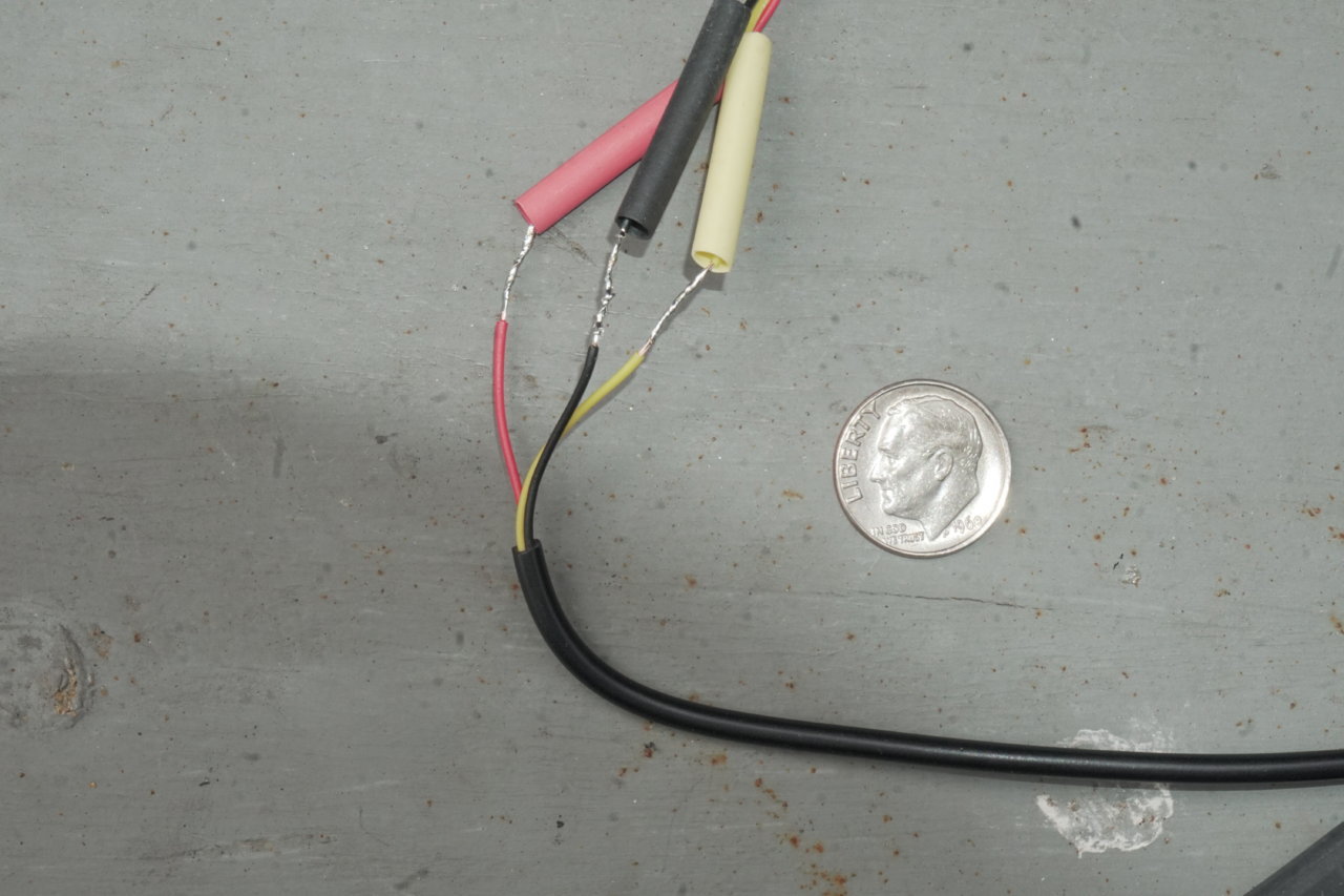

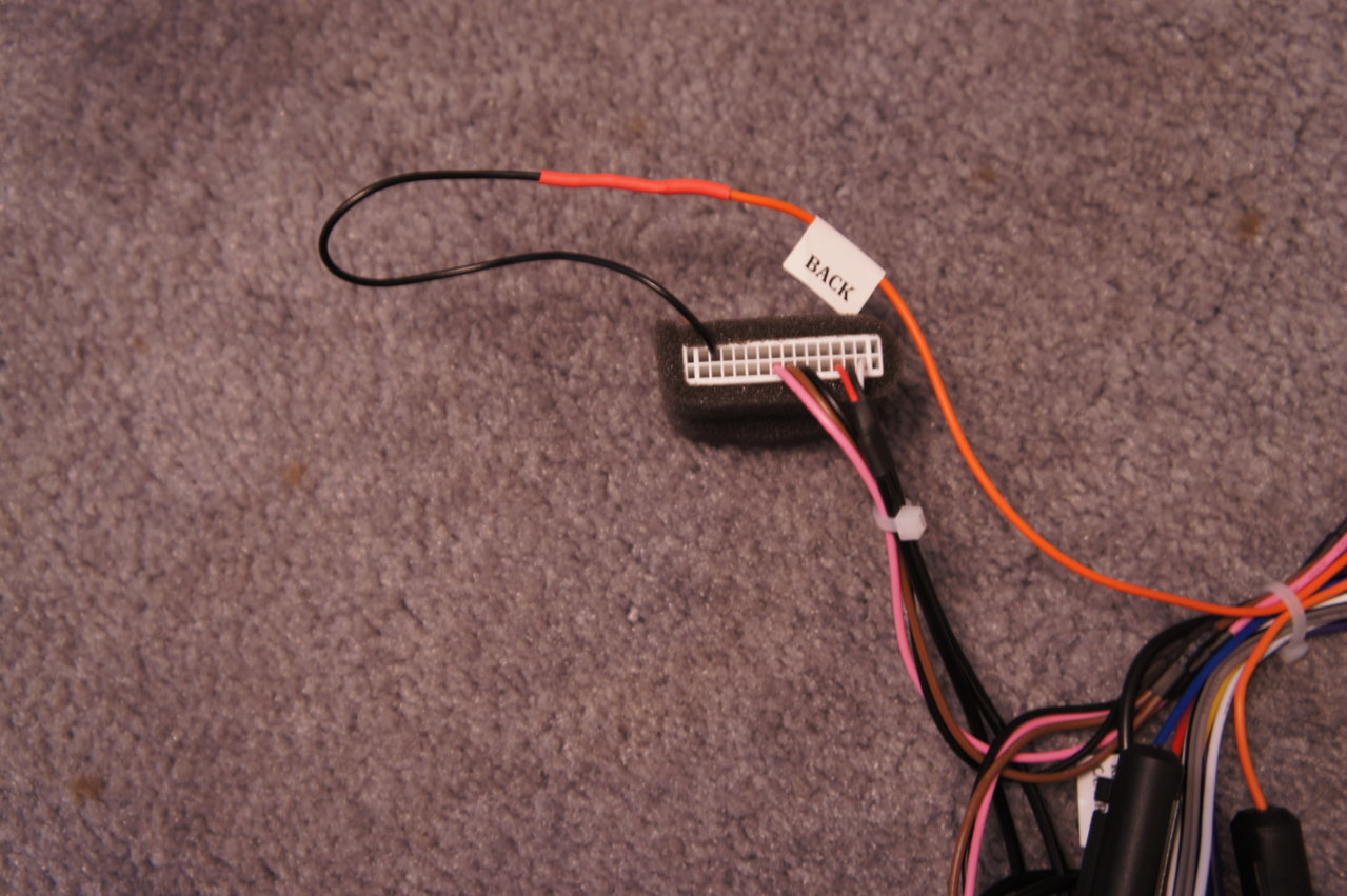

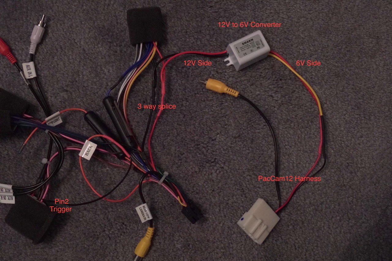

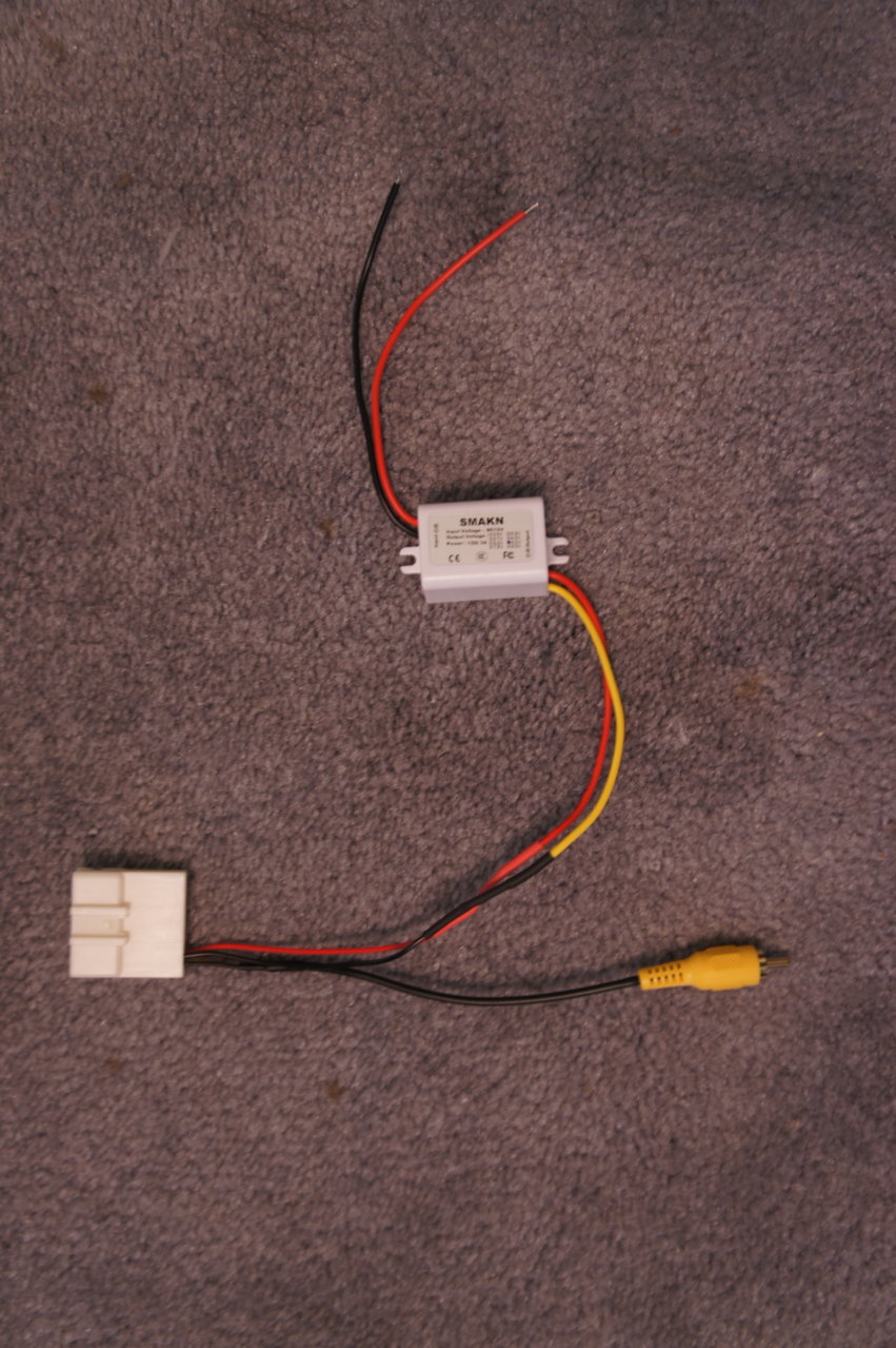

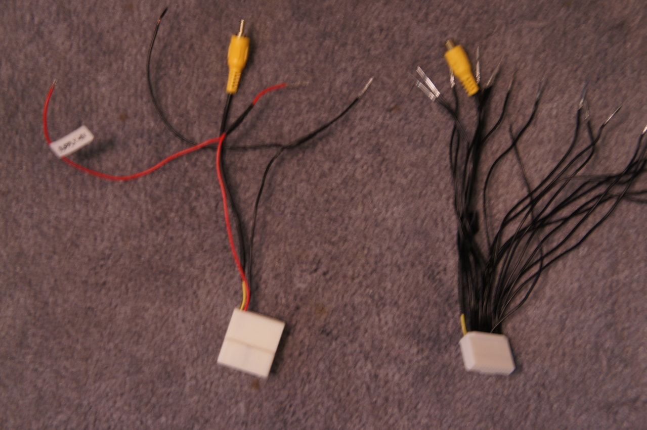

    Most of the aftermarket Reverse Camera Harness (PAC CAM-TY12) is not used. On the 24 pin harness, keep the male RCA jack and the 2 adjacent wires (4 wires total). The rest of the Reverse Camera Harness (the hydra below) is not used.

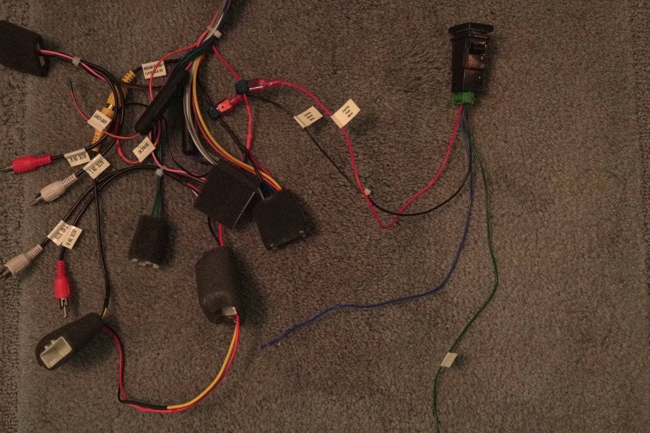

    This is what is being buildt. The following is liberally copied and edited from previous posts. Where the diagram below says "Red Wolf" insert/think "PacCamTY12" (or aftermarket harness). Also note the "Backup 12v Trigger" wire is physically red, not yellow as in the diagram.
    Connect the 12V accessory power from the Joying head unit (red wire), via a 12v to 6v step down converter. Black goes to ground. The OEM camera uses 6v, this is why you need the voltage converter.
    You should have something that look like below. The "SMAKN" box to the connector is the 6v part of the above diagram. Not shown below ---> Black ground and red power spliced into the Joying main connector. Creating two 3 way splices, a black ground 3 way and a red power 3 way.
    Connect the trigger wire from the main female connector, of the Joying harness (orange wire labeled "back"), to pin 2 on the 28 pin connector (also part of the Joying rat nest of a harness). This is done to pick up the Tacoma reverse signal. The reverse signal (on my 2014) comes from pin 2 on the 28 pin Tacoma factory harness. YMMV.
    Others find a reverse signal under the driver side fuse box, but this didn't apply to my 2014 since reverse was already in the factory harness.
    What the Joying supplied wire harness, plus the SMAKN 12v to 6v converter, plus what's used of the PacCamTY12 harness looks like when complete (soldered together):
    Install the complete modified wire harness in the vehicle, turn on the vehicle, select reverse. The JHU should display a reverse view.

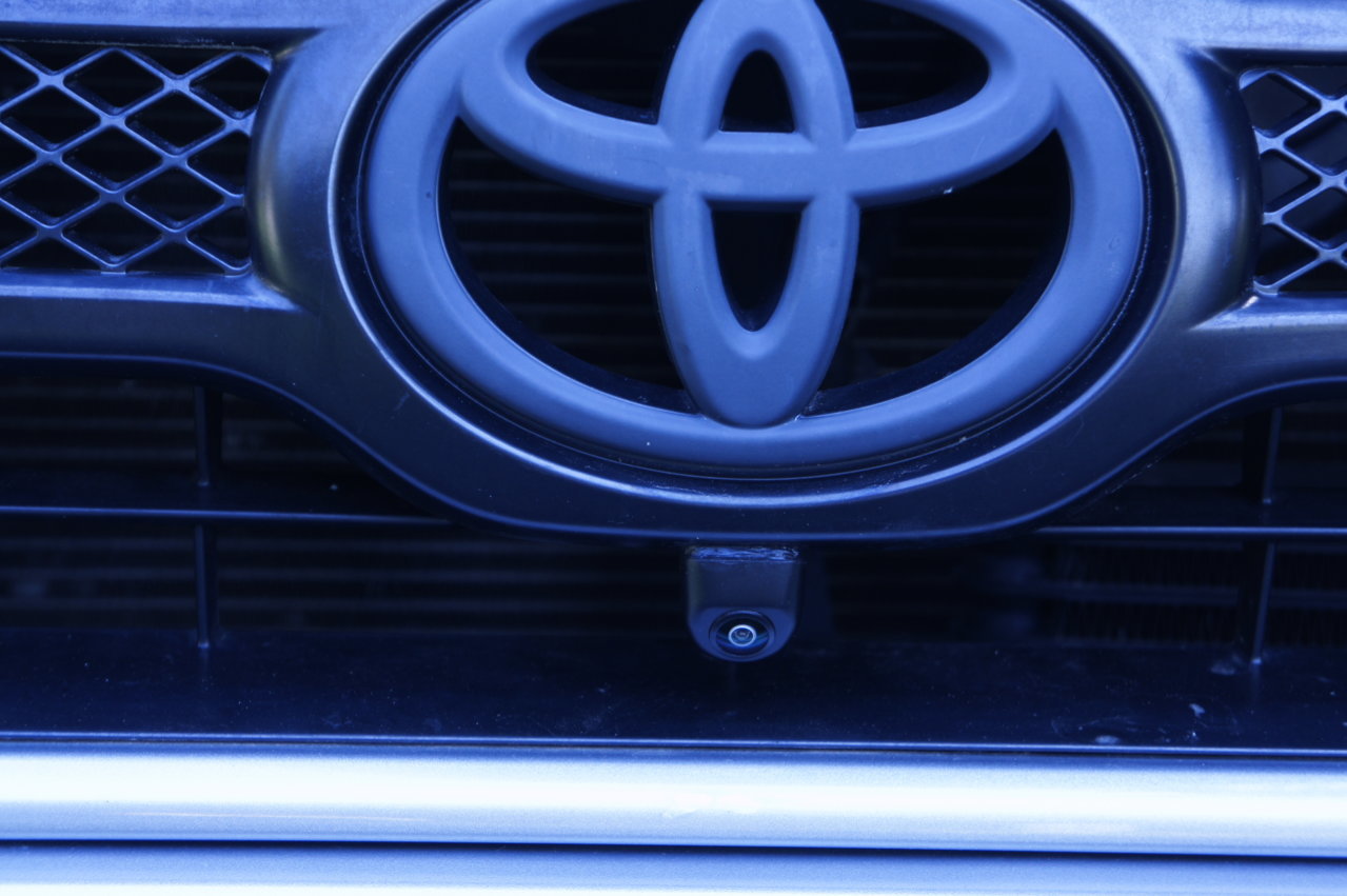

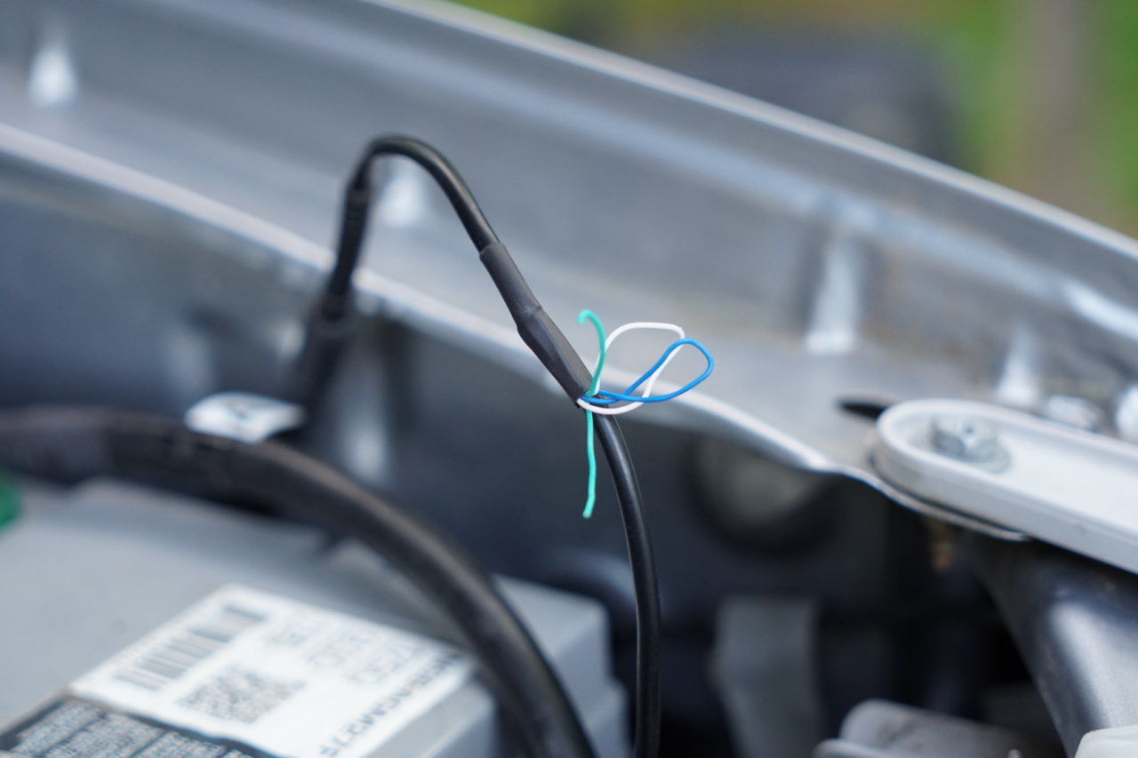

    Front Camera:

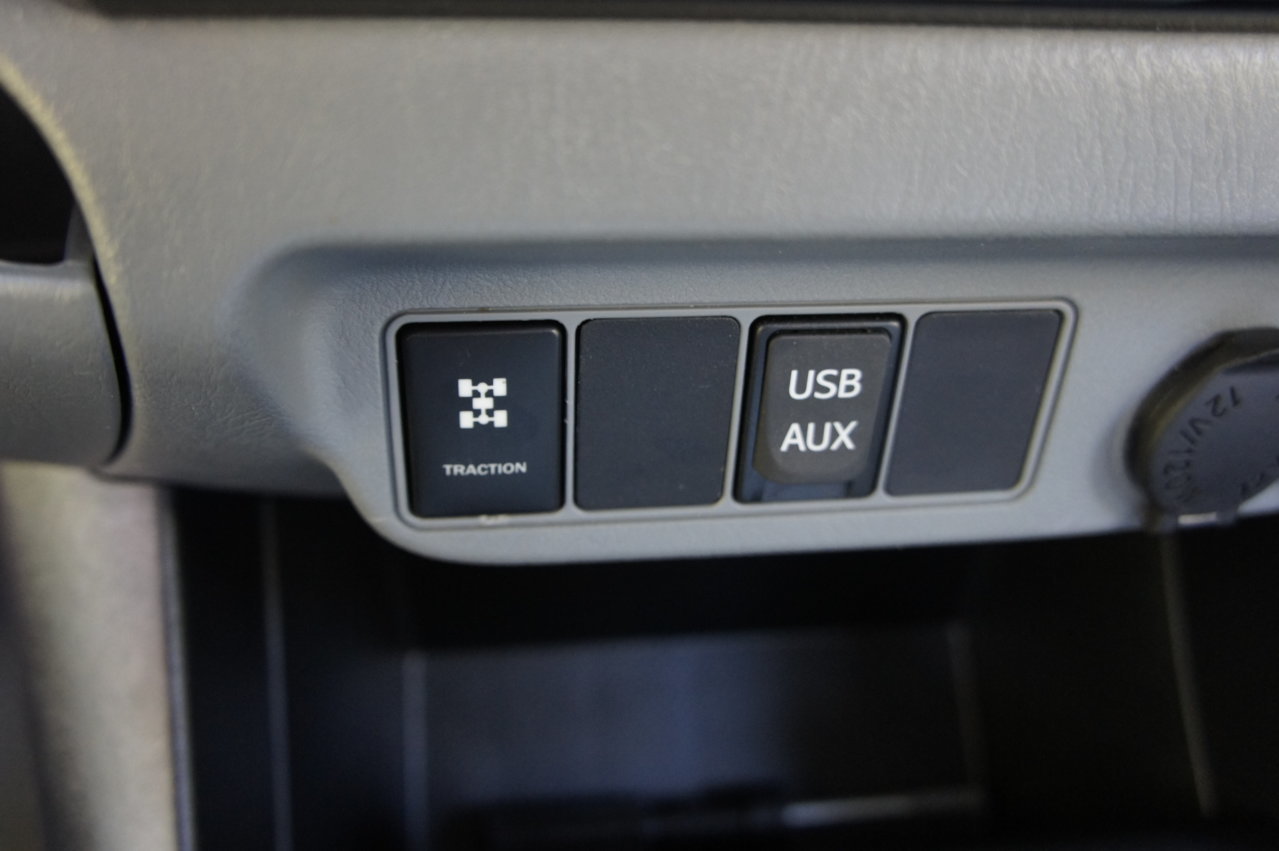

    This is a new installation. I got a EPSPIC Front/Backup Camera (#3 from Parts List). It's advertised as IP69, waterproof to x meters for y minutes.
    Mounted Front Camera.
    The provided camera cable assembly is for a full size truck tailgate installation. This is a front installation on a midsize truck. The provide documents says the cable is 6 meters, ~26 feet. I cut 15 feet off the cable, leaving about 10 feet. Still too long but manageable. The wire is very thin. The splice went ok, but my 1/8 inch shrink tube is too large.
    The camera is rated at 65 mA @ 3.3 V. The switch is rated at 3 A @ 12 V. A typical relay coil will draw ~150 mA @ 12 V. The plan is to splice into the Joying harness for power and ground. Going directly through the switch for camera power, thus no relay.
    Upcoming mod to splice the purple illumination wire (see switch) into the Joying Red (ACC) wire. There is no easy access "illumination" wire. FYI, the green wire on the switch is the power to the front camera.

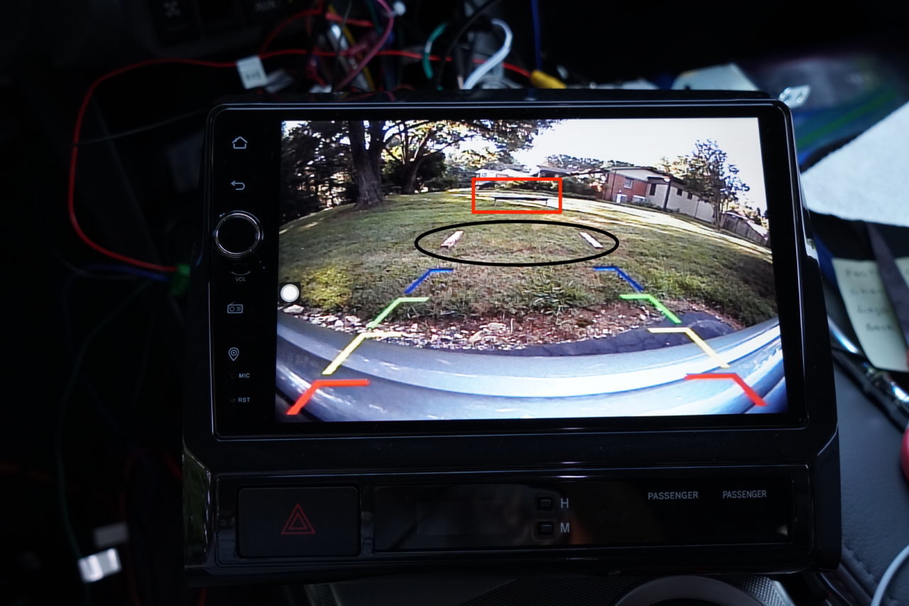

    Front Camera adjustment. A wire cut may be required to get the image or view, correct (i.e., right side up, right side on the right, etc). This is dependent on the camera, and how it was installed. For this camera, a front/down install, it was necessary to cut the green camera control wire (not the power wire), to "mirror" the image. There is no apparent Joying video "mirror" control. There is a "mirror" adjustment for the backup camera.
    Normal View
    Annotated Front Camera View
    • The white guide line is about 2 feet in front of the bumper. Not a "tire view" but still a win.
    • The green guide line is ~3.5 feet.
    • The blue guide line is ~5.5 feet.
    • The black oval. The 2 boards are set apart about the width of the truck, ~6 feet. The near end of the boards are 7 feet away from the bumper. The far end of the boards are 10 feet.
    • The red box. From the driver seat, looking over the scoop, my normal view is limited to ~10 feet minimal. The base of the bench is 20 feet. The bench is 6 feet wide, essentially the width of the truck.

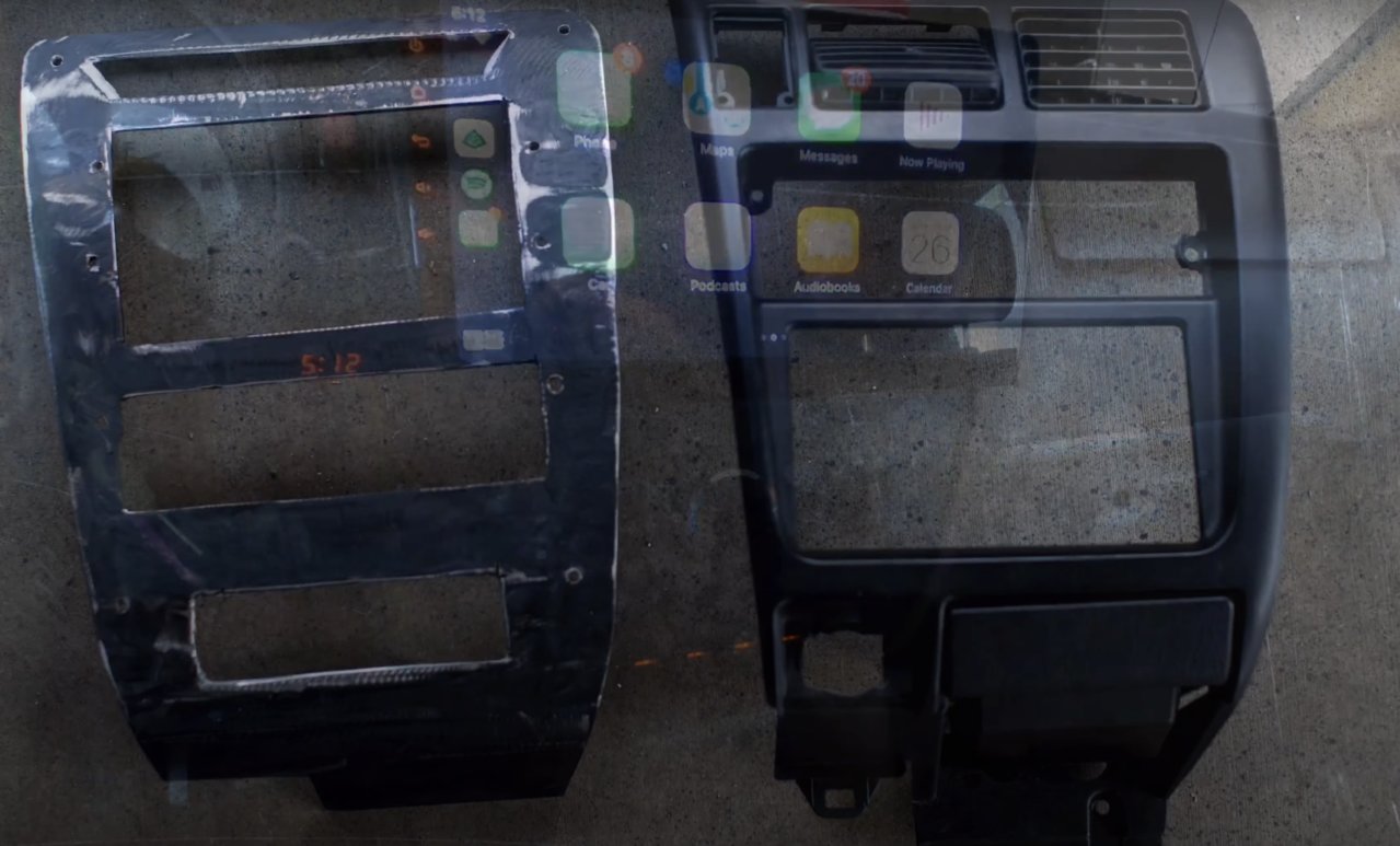

    Few comments, no pictures. I used the OEM mounting brackets. The holes on the brackets are too far forward and the attachment clips don't allow the screen to seat.
    Drimeled the OEM mount bracket OEM holes, oval. Then removed the 4 plastic attachment clips from the screen (male) and the CPU box (female). The CPU box is held by the OEM brackets. The screen is held by the 5? plastic clips.

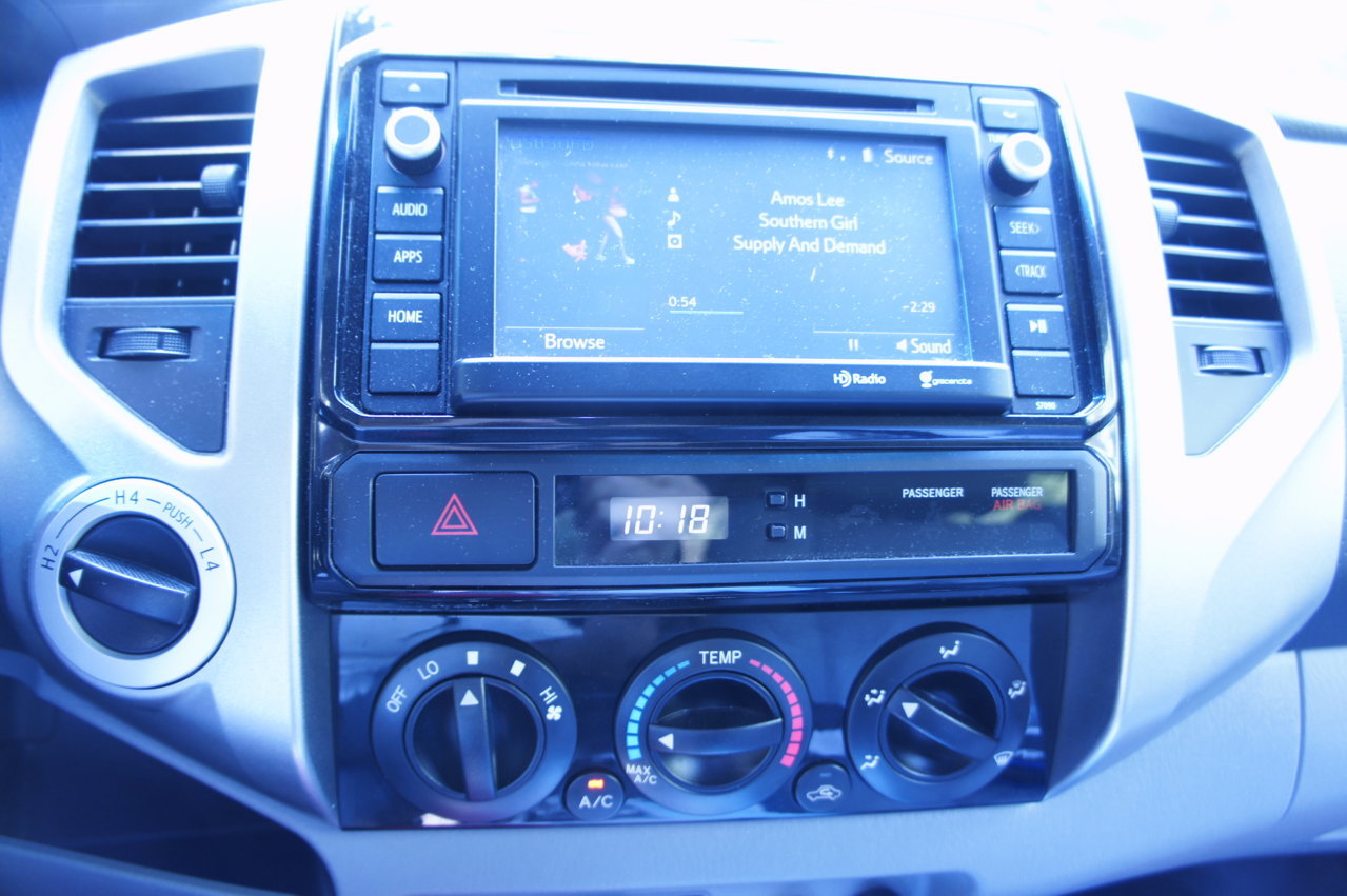

    Stock HU
    Joying HU
    Removed the last blank and added the front camera on/off button. Removed 1 cigarette lighter port and added 2 USB ports.

    • Installing Android 12 (from Android 10). It works.
    Impressions:
    The amplifier sounds good. Better than the stock HU. So it’s a win there.
    The FM tuner is serviceable but it is not HD Radio.
    BlueTooth - CarPlay works but seems a bit flaky, maybe user error. Not as seamless as the VW.

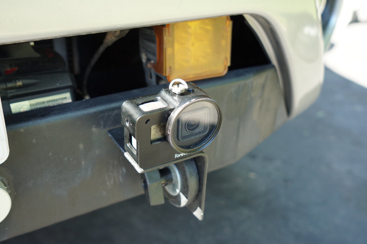

    Bumper Mount:

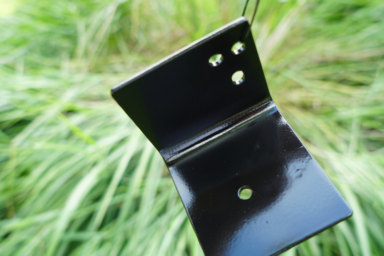

    Took some scrap aluminum (~1/8" X 3" x 6"), cleaned it up, bent (beat) it into 90 degrees. Drilled the mounting holes. Filed, sanded then rattle can primed and topcoats.
    GoPro installed on the bumper shackle mount.

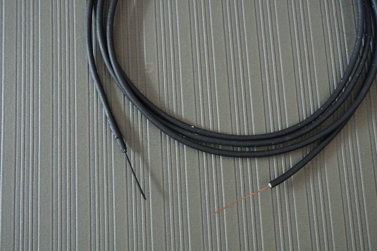

    DIY WiFi antenna. 12 feet of Belden 1695a (RG6?). Grounds stripped 6 cm on each end. It enhances the WiFi connection in the cab. Ends are placed in close proximity to the GoPro and the iPhone (@2.4 GHz).

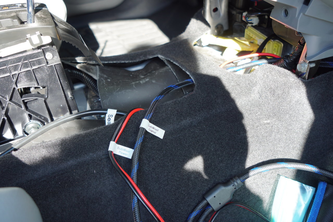

    Picture of SW signal and power wire being run from the center console to under the passenger seat.
    SW installation and shakeout. As small as the SW is (10" x 8" x 3"), the passenger seat may have to be unbolted to slide the SW under.

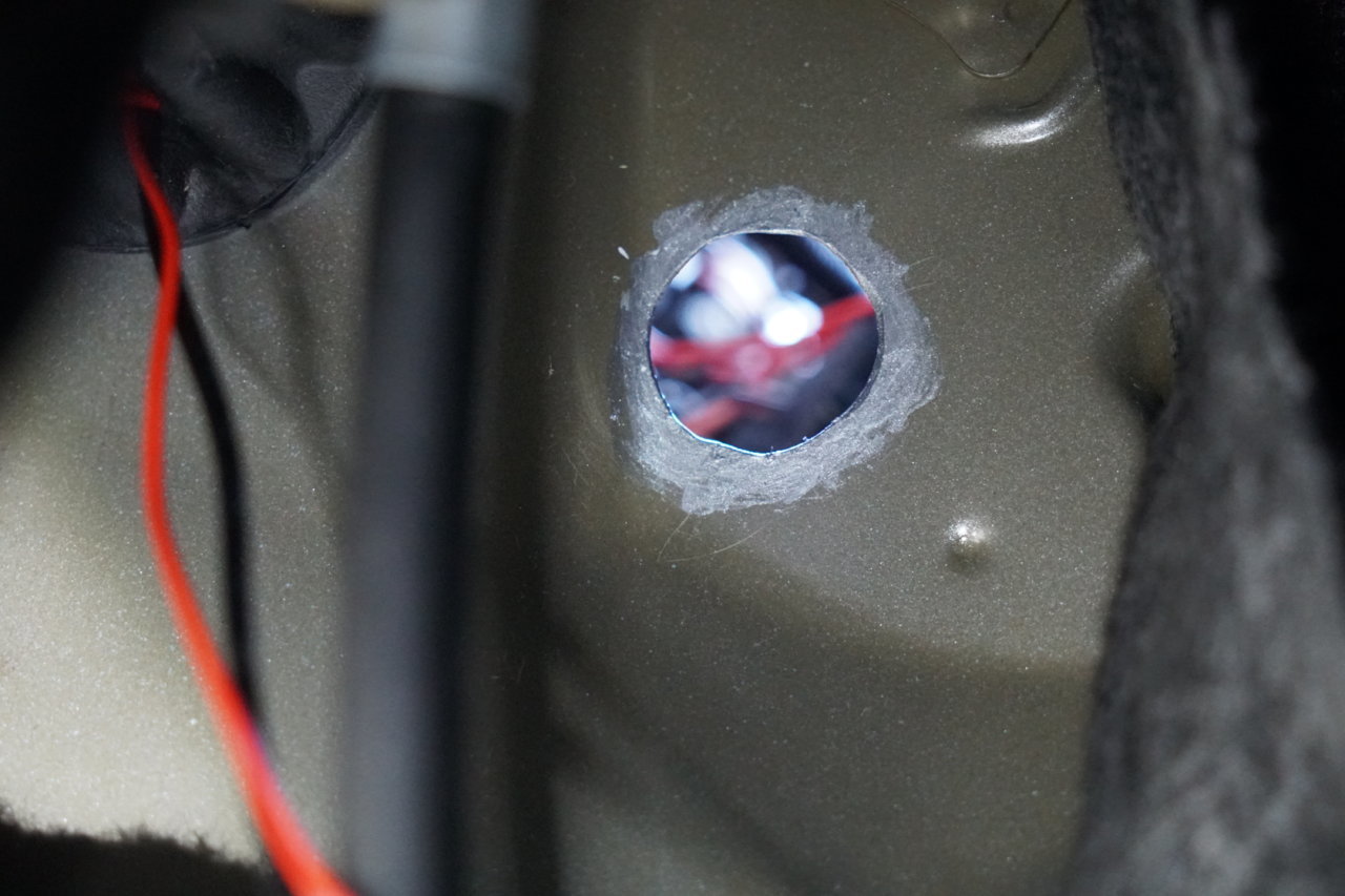

    The SW “proof of concept” was a success. For the permanent installation, running dedicated power and ground from the engine bay to the SW. 8 gauge for power and 6 gauge ground. The amp requires 20 amps however this leaves future room to go to 40-50 amps.

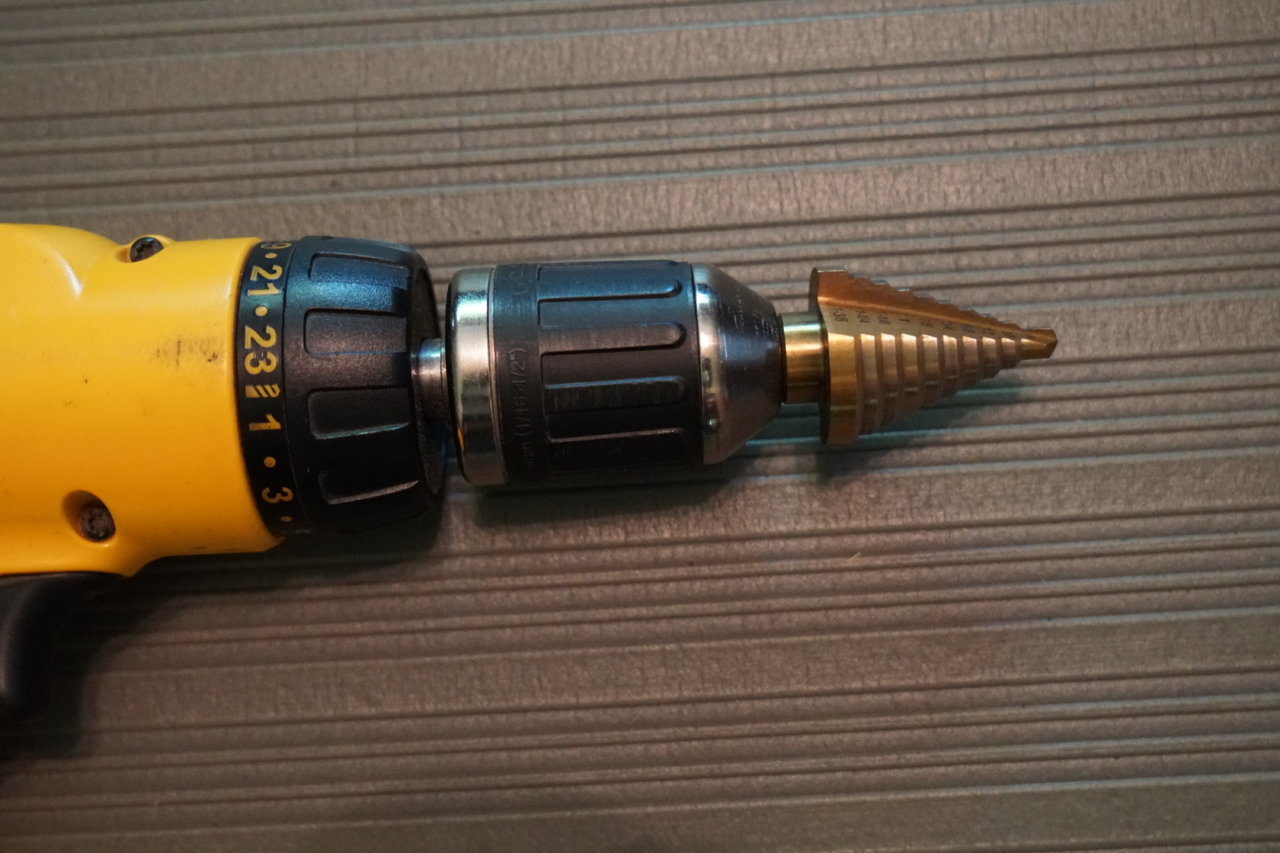

    The existing firewall grommets are full. Drilled a 1.125 - 1.250 hole through the firewall. To make room to drill, the brake cable was disconnected and carpet cut.
    Cool little bit. Not expensive and make fast work in sheet metal.

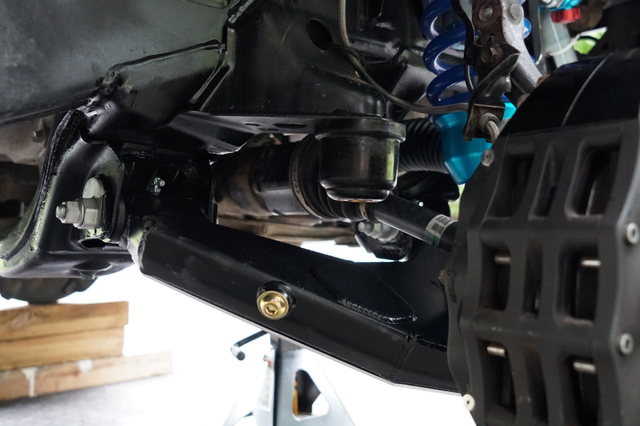

    Replacing the Lower Control Arms:
    After I replaced the UCA's, Firestone said they couldn't do an alignment because the cams were frozen. They did bend/flatten my cam tabs for free. Firestone said $1200-1400 for Moog LCA's installed.
    LCA's are out.
    Flat cam tabs.
    Parts list, installation
    Dirt King LCA's
    Trail Tacoma's DK LCA installation and review. Remove the extra t in trail -->. Then insert "ttrailtacoma.com" for "****" on the link below.
    https://***************/2021/01/26/dirt-king-lower-control-arms-install-review-3rd-gen-tacoma/
    Dirt King link
    https://dirtkingfabrication.com/col...ucts/performance-lower-control-arms-dk-811704
    Got a carbide blade for the reciprocating saw (Sawzall), to cut the LCA's off. Forget the bimetal blades unless you get paid by the hour.
    Diablo DS0908CF 9" Steel Demon Carbide Recip Blade for Thick Metal Cutting
    Ordered the Toyota OEM cam adjusters pictured below. One set per side. Verified that “most” of these parts fit. I can’t verify that the A0001 nut fits; it was never shipped. The old nuts were reused. The 48409-60020 caster adjuster is what had to be cut through to get the LCA off. Truth in advertising. Copied the following bolt diagram off another post.
    Passenger side LCA is in.
    Driver side. Hidden from view; there is a 0.25” taco lean spacer on top of the coilover.

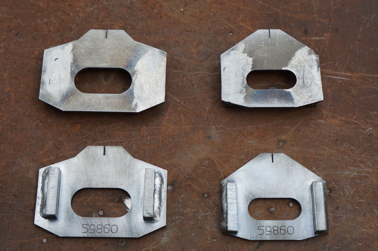

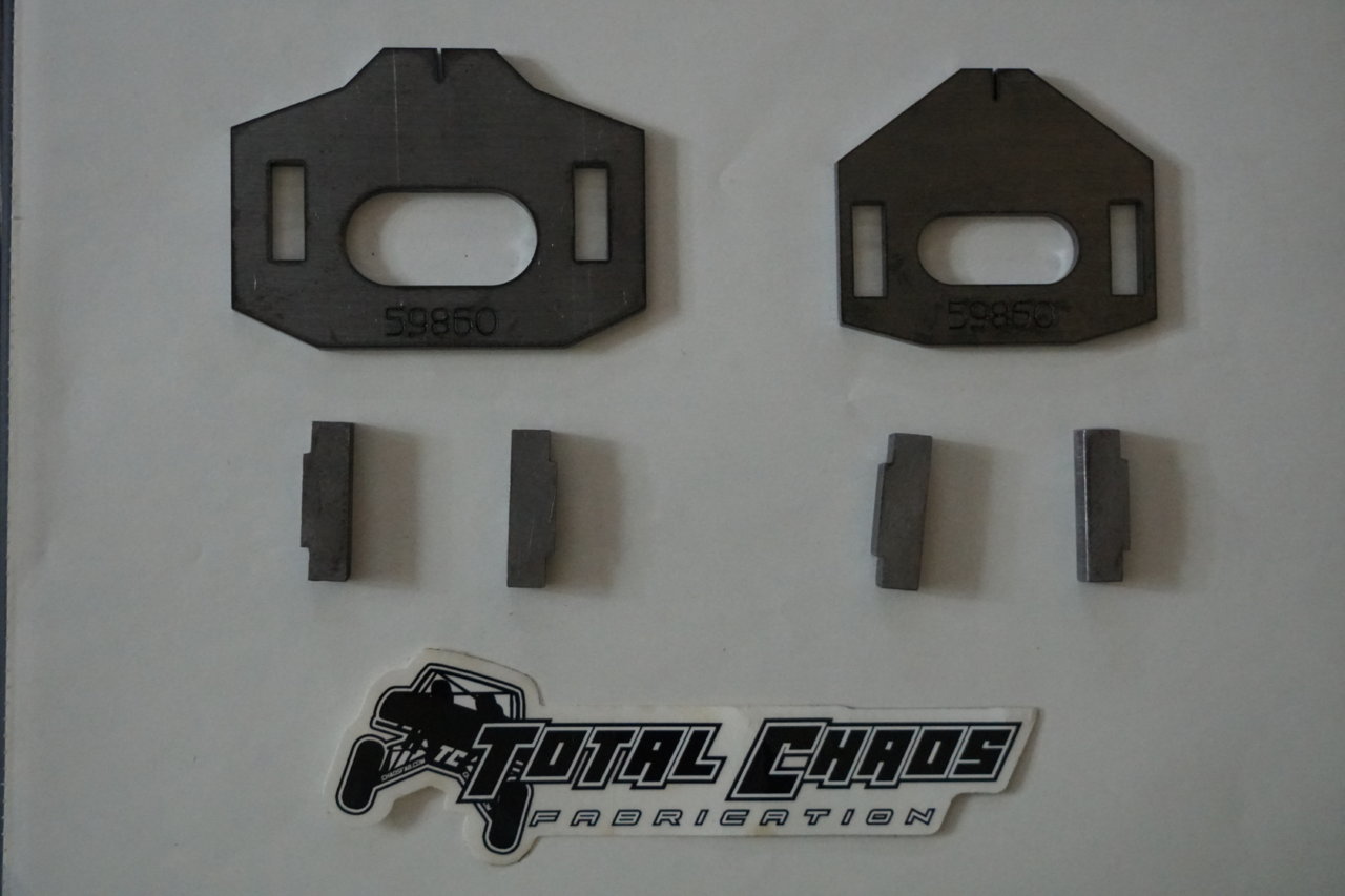

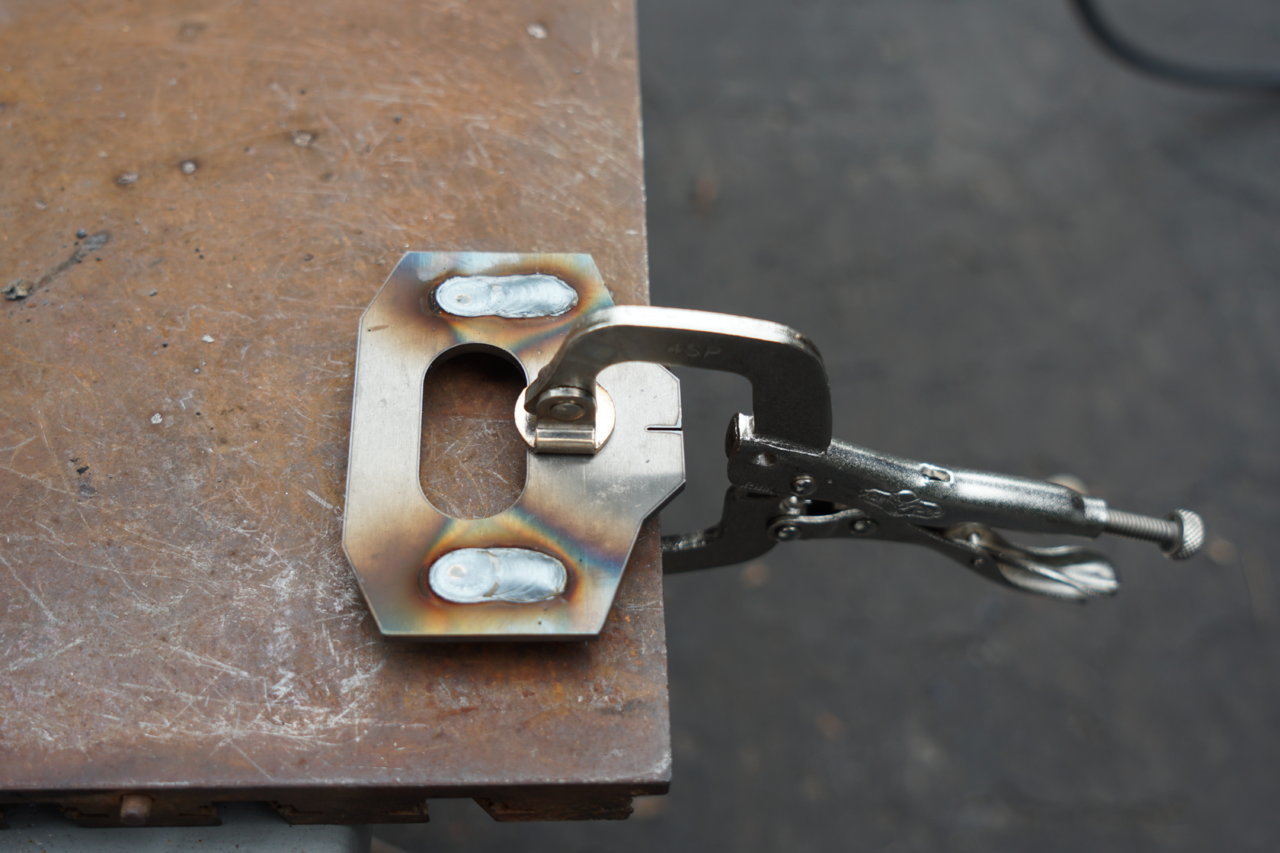

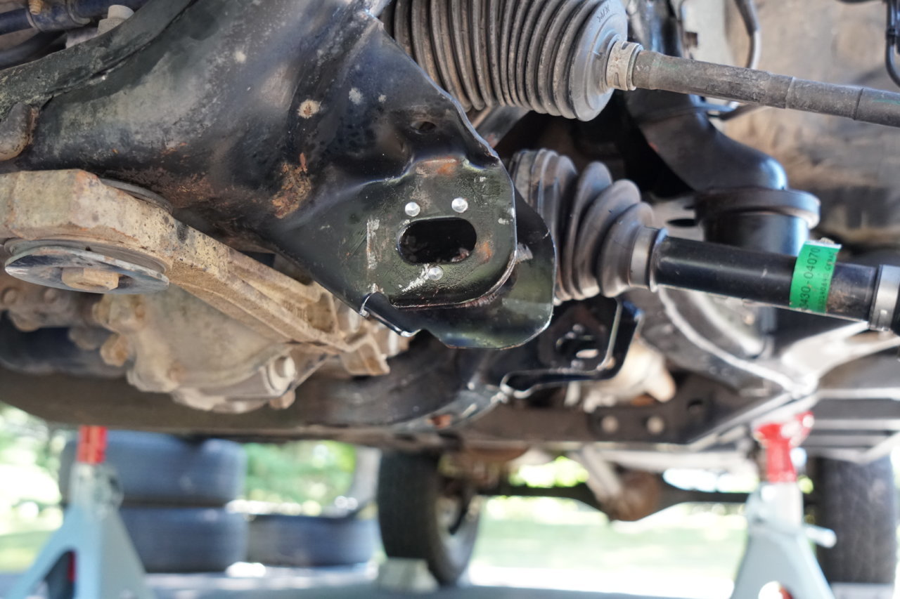

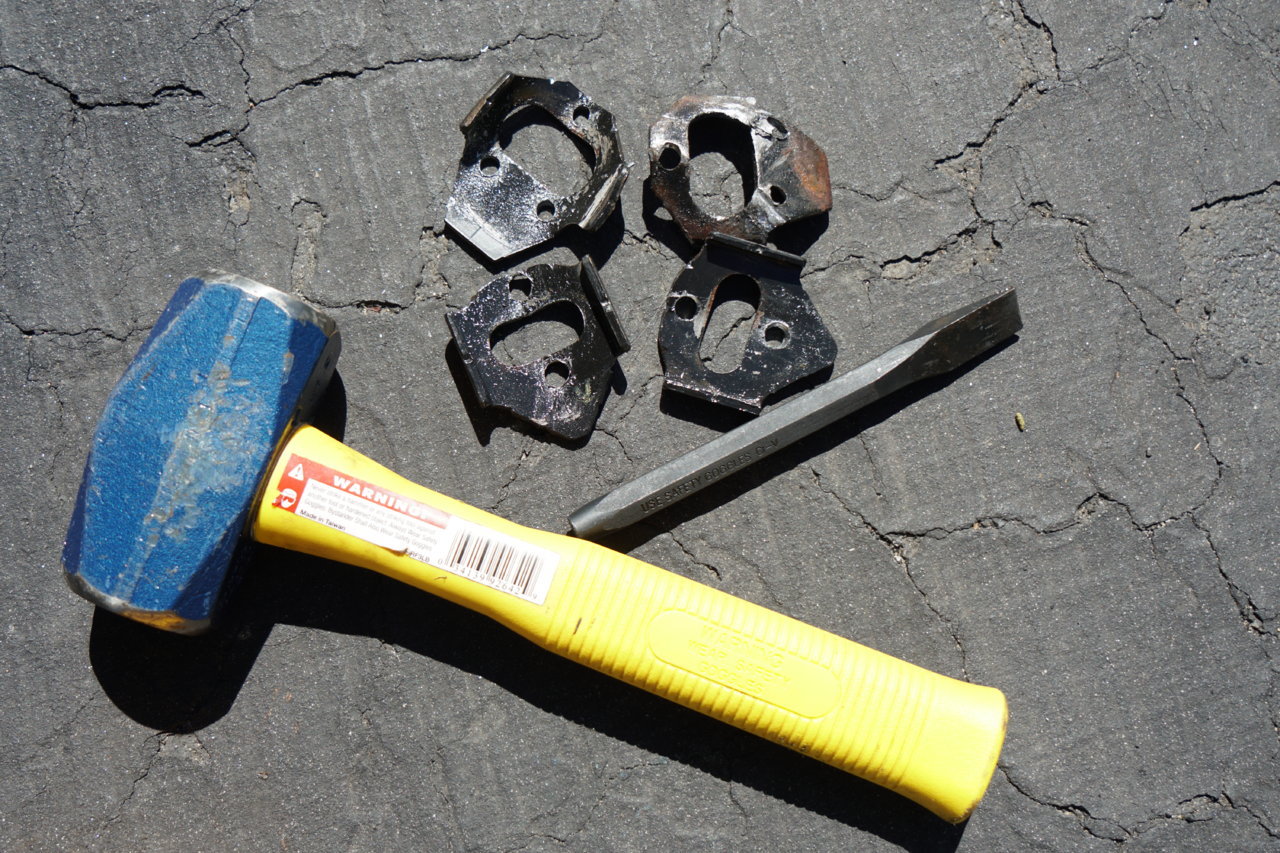

    Fixing Flat Cam Tabs:
    Remove the LCA's. Inspect the carnage.
    Drill out the spot welds and remove. One of the cam fix scenarios was to remove the OEM tabs, fix and weld them back on the truck. Although doable, the Total Chaos cam tab kit will be a cleaner solution.
    Still need to fill in the divots.
    Total Chaos Cam Tab Kit has arrived. Ordered Aug 27, shipped UPS Aug 30, arrived Sept 7. Set of 8, in 2 sizes, front and back.
    Weld in the tabs from the back.
    Run a bead on each side.
    Grinding and abrasive flappy wheel clean up.
    Installed
    Final coat of paint

    How bad of a job is cutting the Cams out of the LCAs? My cams are seized and I need to do this, but I’m skeered…
  15. Sep 14, 2022 at 6:21 AM
    #75
    rnish
    rnish [OP] Well-Known Member
    May 9, 2014
    #129450
    8,553
    Peoples Republic of Maryland (USA)
    Tacoma 2nd gen
    King's, Camburg UCA, Dirt King LCA, armor
    Absolutely get a carbide tipped sawzall blade. This is some hardened steel. Most of the bolts came out easy enough with a 18” persuasion bar. Both caster adjuster’s (L & R) had to be cut out. I burned through a couple quality bimetallic blades before I got the “Diablo” carbide blade. The part# of the blade I used is listed above.
