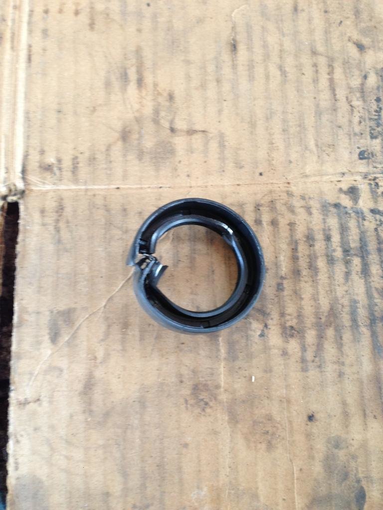

    Yea mines leaked for years. I guess the yoke for the tranny messes up the seal

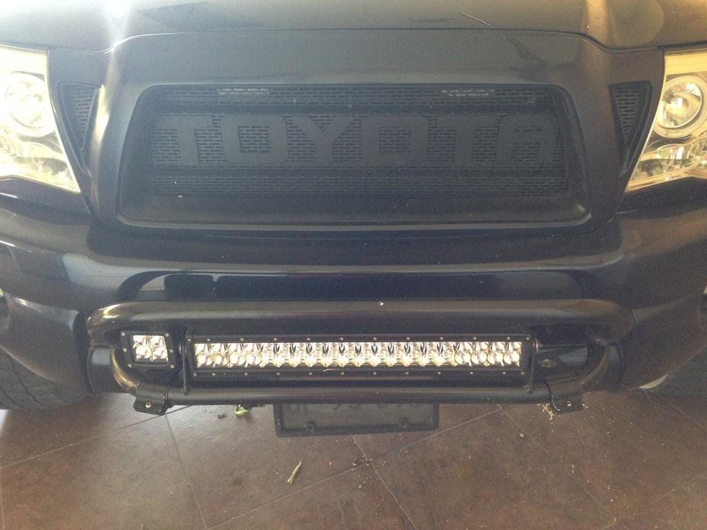

    How did you make your grill?
  3. Jun 9, 2014 at 9:12 AM
    #243
    tacomonazul
    tacomonazul [OP] Well-Known Member
    Mar 4, 2012
    #74163
    3,384
    Luis
    SOCAL
    07 DCSB LT/4LINK
    http://www.tacomaworld.com/forum/2nd-gen-builds/227832-my-never-end-build.html

    Ill change the seal today and see if the leak stops

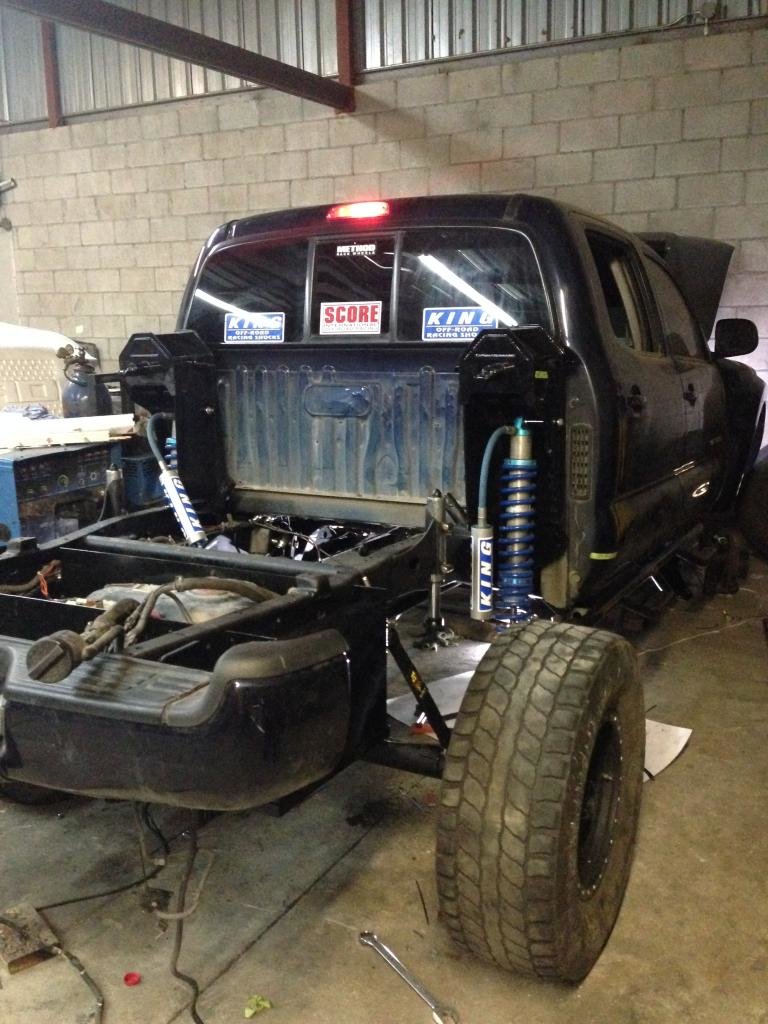

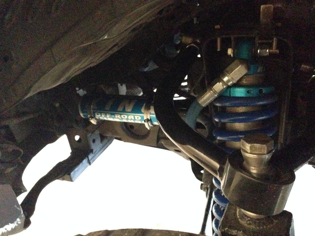

    Heres an update

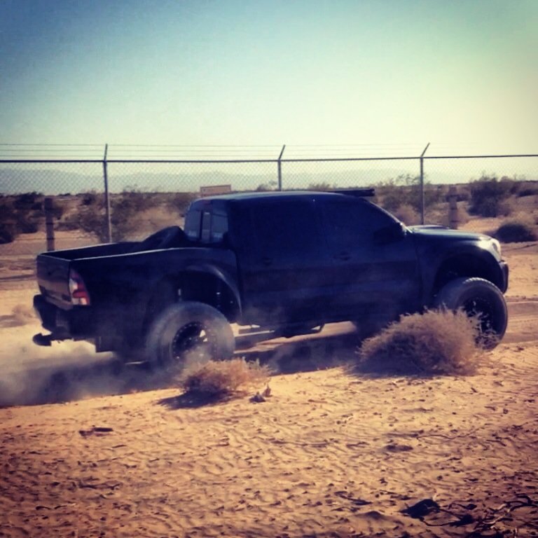

    Did some testing yesterday everything went great! Suspension is smooth, just need to play with valving in the front. Only bad thing is that I lost a rigid dually while pre running didn't noticed till I got home, here are some pics trucks all dirty from yesterday
    missing dually

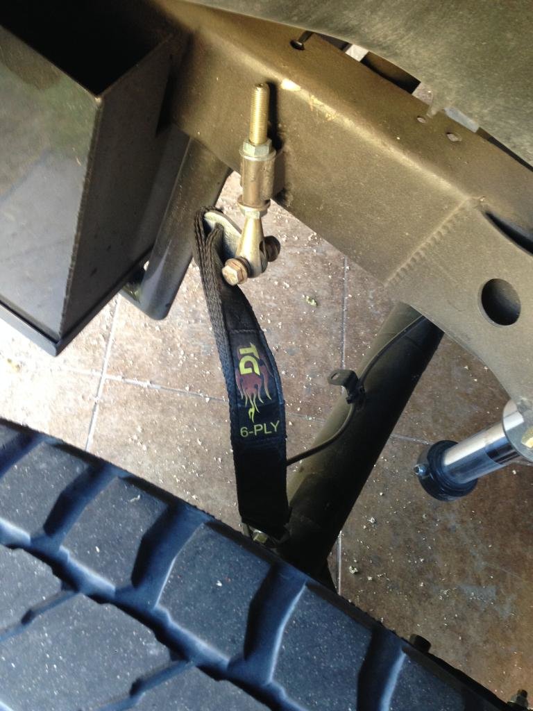

    Front bumpstops, powder coated front suspension black to match the rear
    Relocated front reservoir
    Rear bumps
    Rear limit straps with clevis
    Trimmed bedsides to clear travel

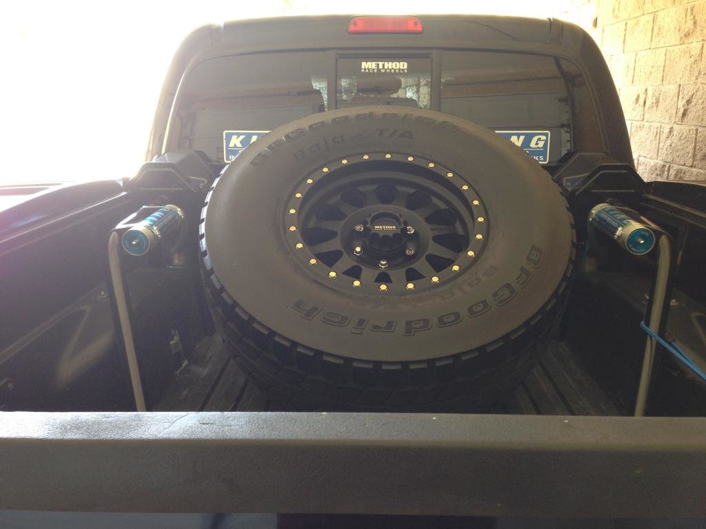

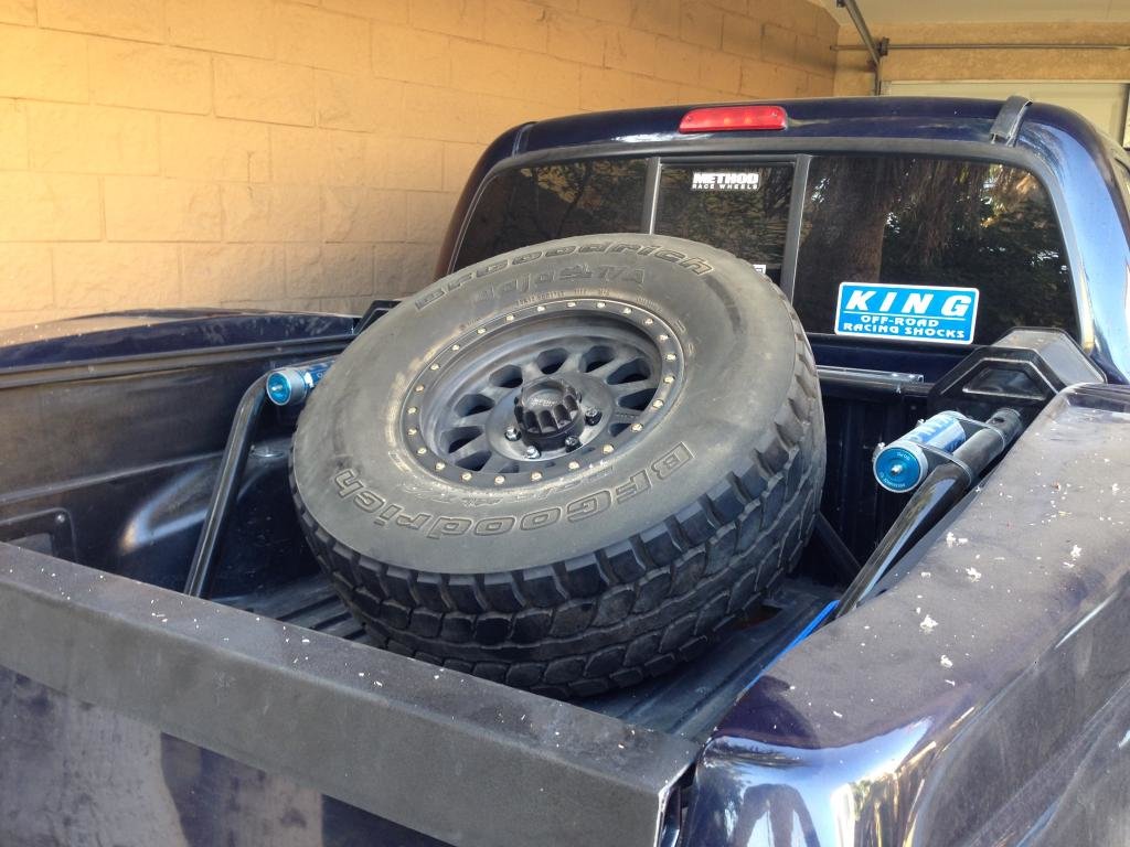

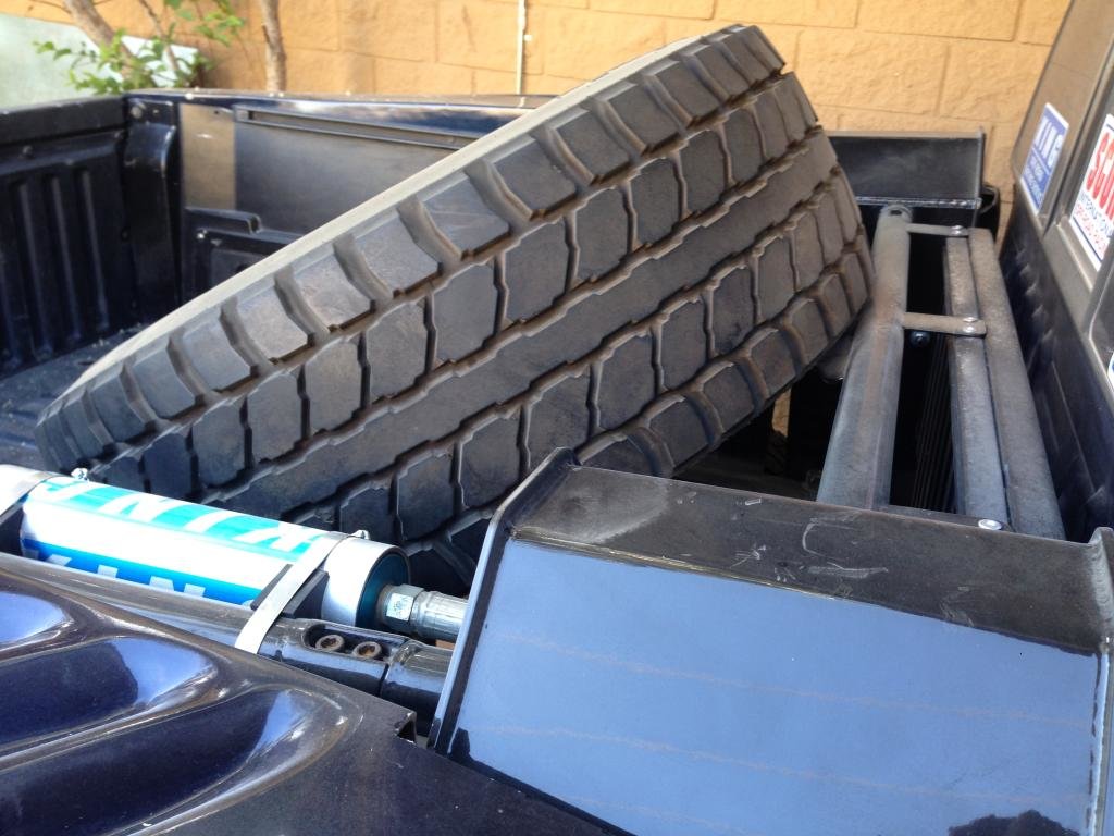

    Spare tire mount and bed cage, mounted reservoirs on bed cage
    Shock towers

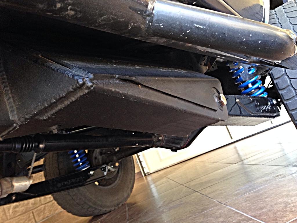

    How much travel did you end up getting out of the rear? Any pics of the tank install?

    Some videos of yesterdays testing

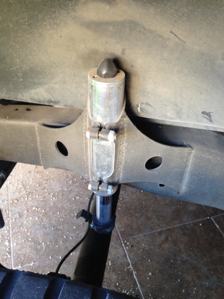

    Pulling 21'' travel bumped and strapped, here's a pic before mounting the bed. Fabbed a skid plate for the tank.

    Close up pic

    Also replaced output shaft seal

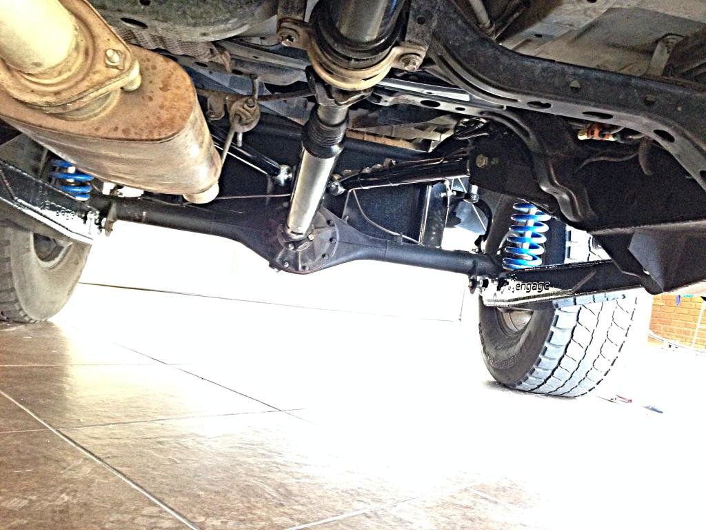

    Where did you mount your fuel nozzle? Also, do you have more pics of the 4 link setup from underneath the truck or something? Can't see the whole setup.
  12. Jun 11, 2014 at 11:02 AM
    #252
    tacomonazul
    Mar 4, 2012
    #74163
    3,384
    Luis
    SOCAL
    07 DCSB LT/4LINK
    Its in the bed at the moment, Ill relocate it to the bedside. Ill take some pics of the whole setup when I get rid of the step bars.

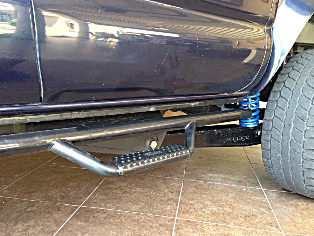

    Changed my mind on taking off step bars, here are some pics

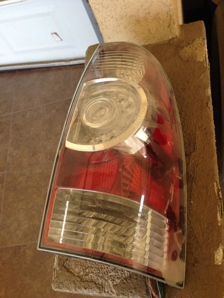

    Got a new pair of duallys spot
    Ill put the 2 new ones in front and the old one in the rear as an amber light
