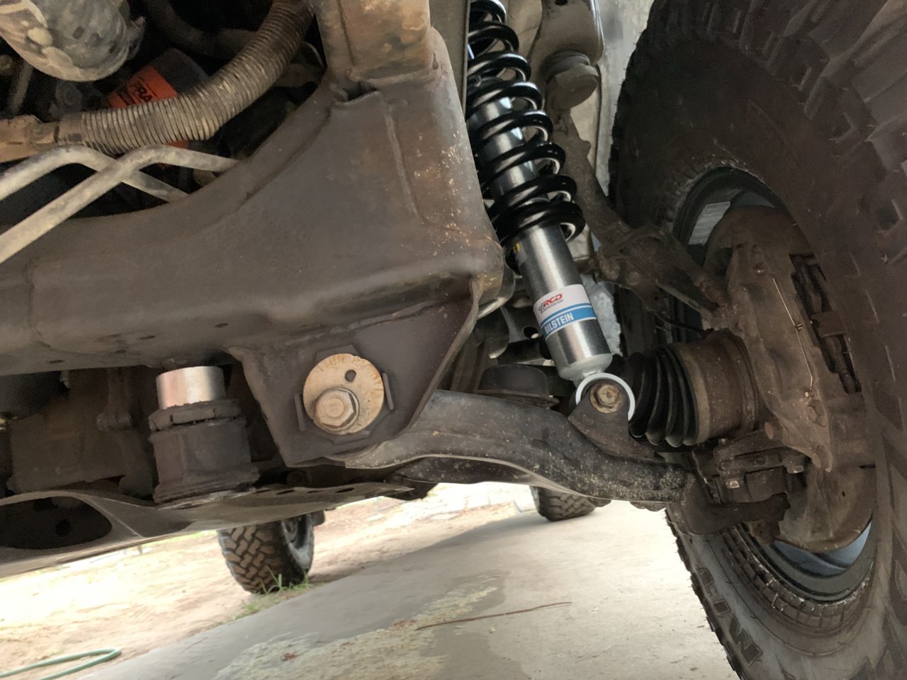

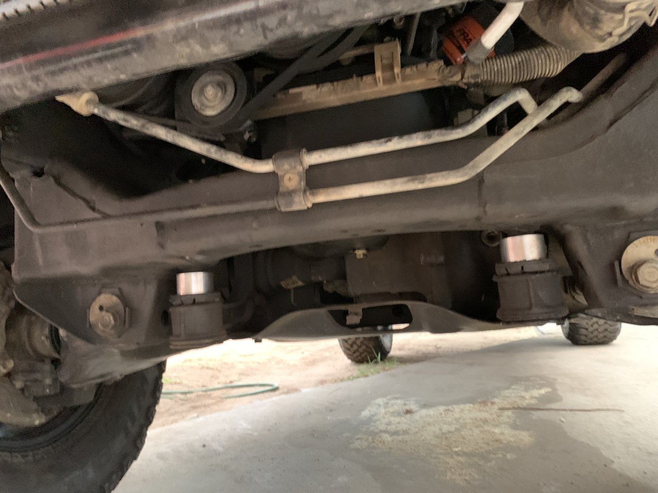

    The lift kit i got came with a pair of delrin spacers for the diff drop. Although I’m sure they would work fine, i decided to make some out of 6061 instead. Came up with a simple drawing in solid works (added about 250 thousands of thickness) and had them machined.

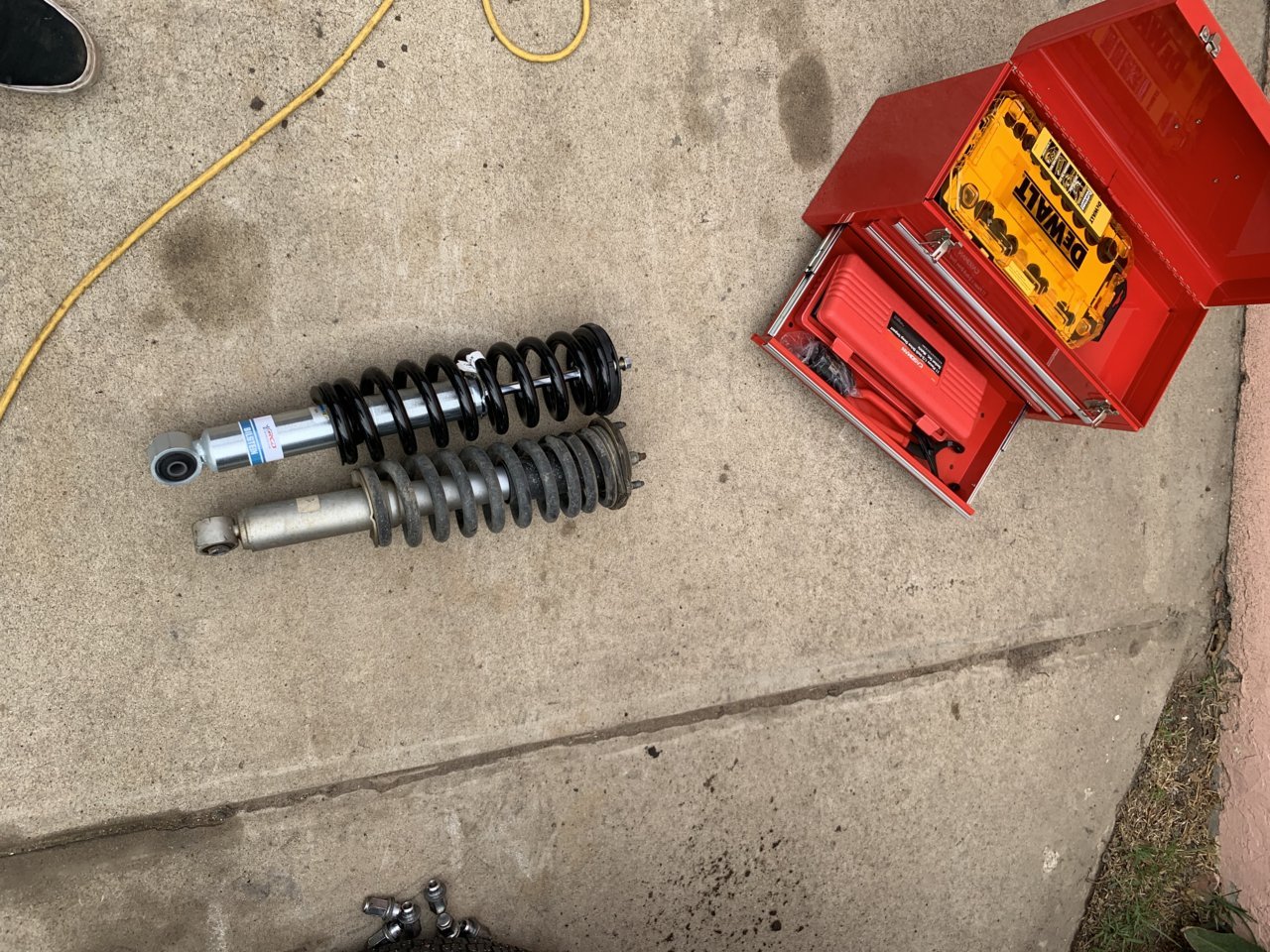

    Also I think it’s worth mentioning that I was able to install the new coilovers without separating the upper or lower ball joint. Just used a larger tire iron to pull down the UCA and that gave me enough space to slide the new coil over in. Took maybe 2hrs for both sides.

    Saw you skipped the whole shop thing and installed the kit yourself, super easy right?
    Ball joints never have to be separated when installing coilovers and shocks on these trucks.

    I didn’t realize that until yesterday. I would always take the 4 14mm’s out of the LBJs to get the coils in or out. This time just realized I probably didn’t need to do that and saved a lot of time!
