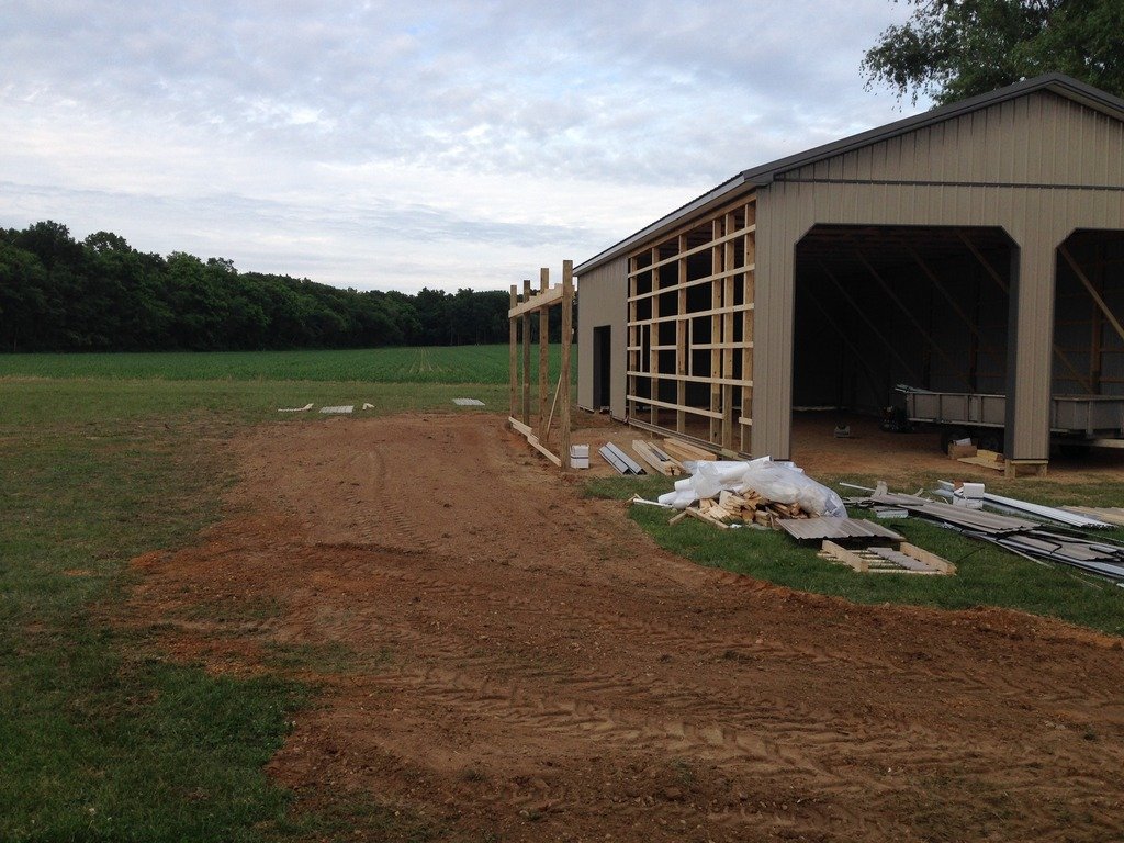

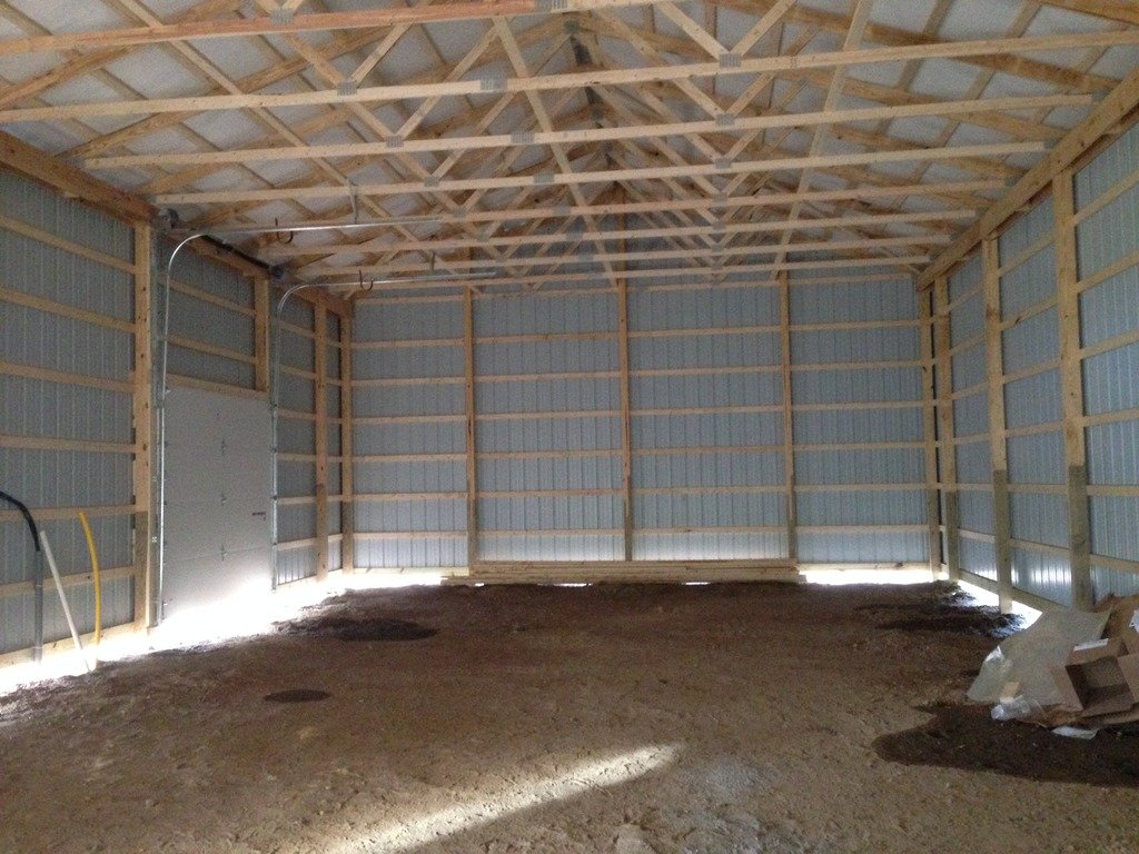

    Made alot of progress today.

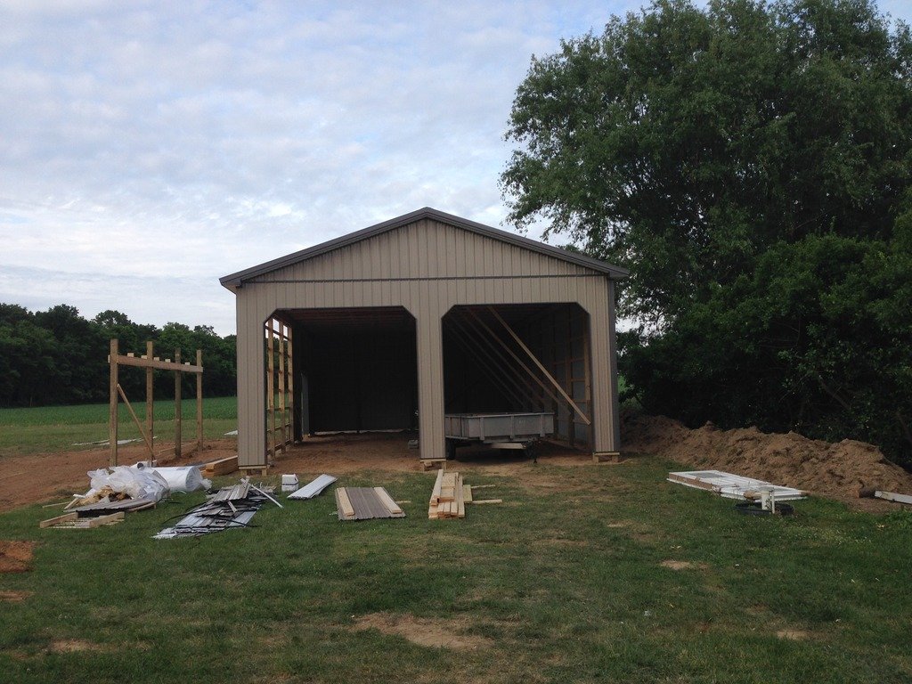

    Roof trusses all set
    1BE85E0D-3B0A-4FAE-B0D0-E1945F8DA085_zps_3a32b61a6ef2f14256b20b89397ab56a5ccf5eb5.jpg
    3F50D710-A89D-4E3D-8416-40A0AA19561D_zps_42b6d8ed7e8c577b5b1a71655138494aa49ce55c.jpg
    Metal installed on the roof
    5429F2AD-F14B-45B2-9FFD-28DF6DB92B15_zps_963659549b6e2bfb743a955e16ea4306b666b2ec.jpg
    My dad came by in the afternoon to help me run all the lines, we kicked some ass today

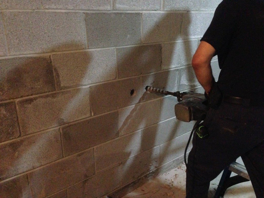

    Boring the holes in the concrete blocks in the basement
    4A6CC186-CF9D-4832-ADB6-ABCB6548EC2D_zps_13539229fdfd685686a1bd8c01c5ccd88158c2ff.jpg
    B89F9DB4-790D-4B1A-A32C-F1C03EE63D2C_zps_9af50c193c849e52b763affd752d832e011448e6.jpg

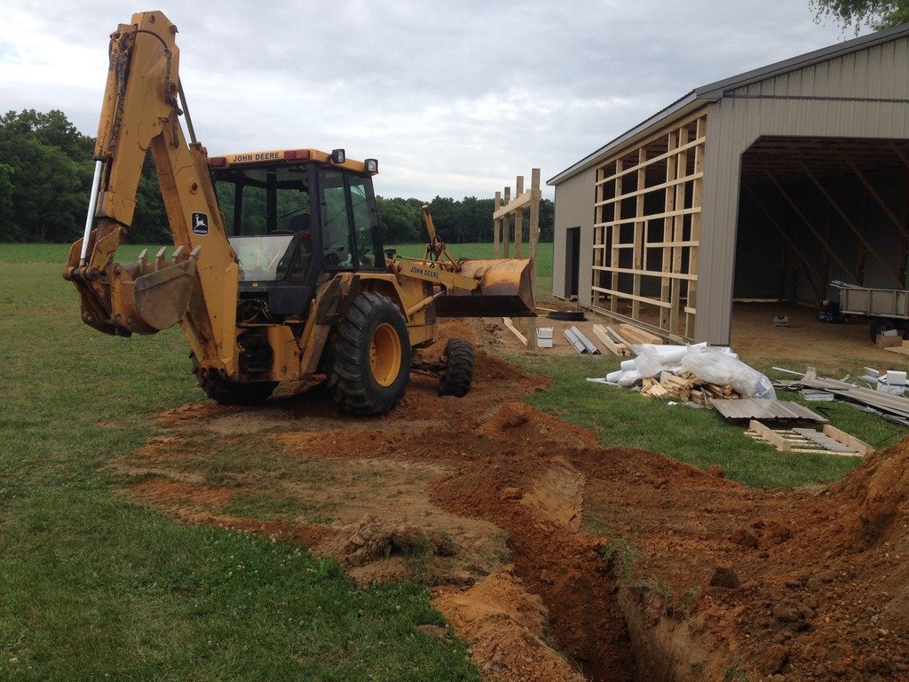

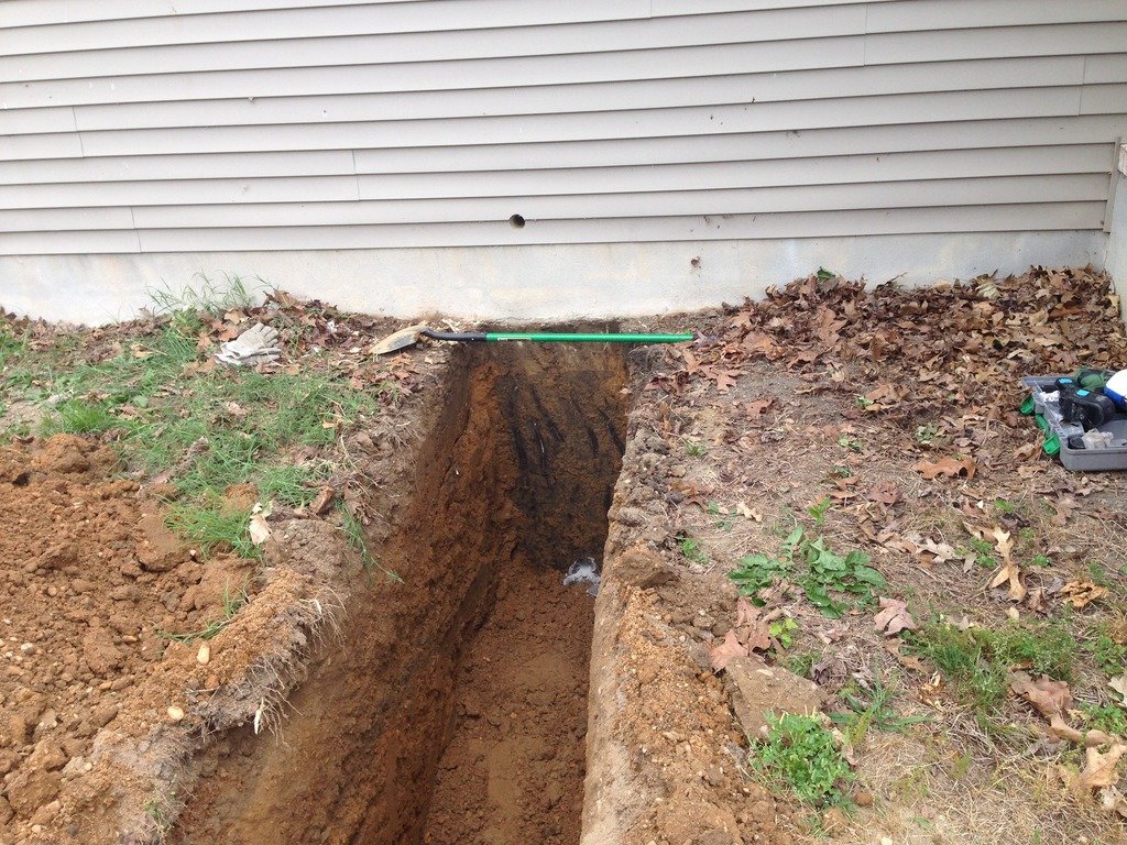

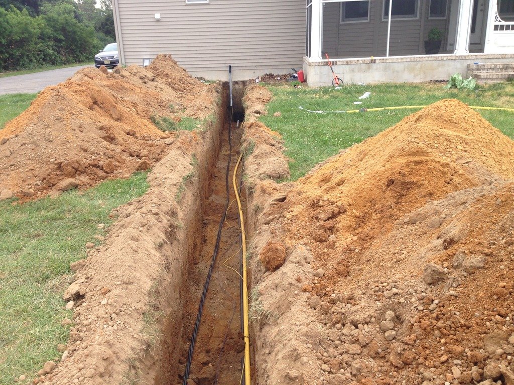

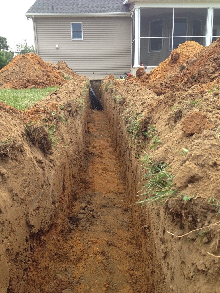

    The start of the ditch, 42" deep per code for the water line
    332C3FA6-9CFC-4075-AD53-9D2341B511AF_zps_6623a9d430daad5ed41e93fff9838163d7d16508.jpg
    89A49AB0-AA55-4D1E-8D63-06290075824E_zps_03518ba906a000469cb18d79f4111d030139fa8f.jpg

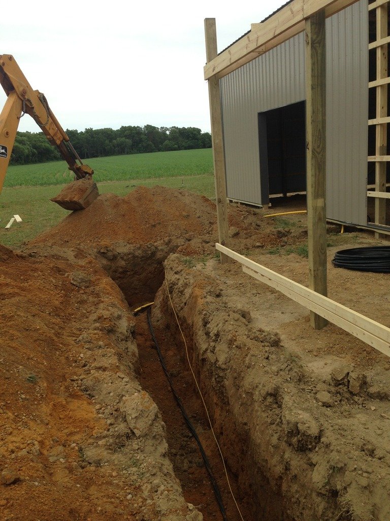

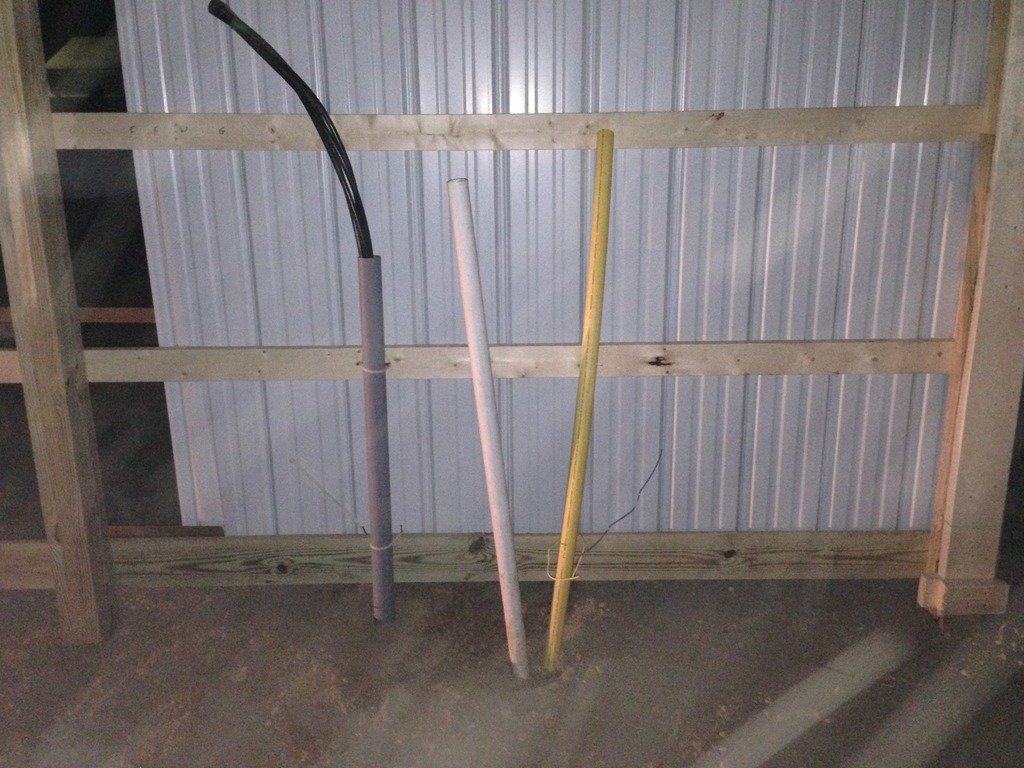

    Electric, water, gas, and a spare chase ran
    C14AA538-7252-4F44-8B5B-3E752E918602_zps_fa8accd06bedeca7674fa37111fbe97e5ff3f162.jpg
    Backfilling the ditch
    9EE71356-CDD6-4C32-93D3-21C5AEC5998C_zps_e46f5aaf20741b028db123123f75fab3c5ea0718.jpg
    Finishing up the siding
    80ACABA1-2F49-4310-8AF9-571362AC156B_zps_6b7684842d962e2bf501988e9320978ae6f69d04.jpg
    More backfilling
    94822D87-572B-46D7-8273-F8C71B1428ED_zps_fb7155ca876ce933fc4036cd5c58eedb393ff3f0.jpg
    6BCE5EE4-A496-4B27-94C3-096C3B0F656A_zps_b2e195dc558591133192656772b4d077aa511b04.jpg

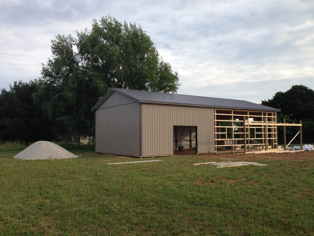

    Front siding and trim all finished
    BED29991-29D9-490B-9A6C-39A04F1920BC_zps_da3b7e71fb144f20ba56e13a6dab38f75d5de820.jpg
    Electrical ran into the basement, gas line still needs to be tied into the house, made the change from poly to black iron pipe
    8A4CCCF2-15EA-4981-97C0-285C620EE886_zps_68f575d3ee0d079cb813b071926959705b757abb.jpg
    All filled in and smooth again, now for the weeds to start growing again :D
    69F8A5C9-E897-417C-8093-CDDF37BA2F0A_zps_c2926d9b10cddc5b68c358436a9e865f58b2cc0c.jpg
    Side
    FF7678C8-B97C-4C6C-9447-4AC8E3C229F0_zps_a8726a8140595dbd3f16d1338abce3d4e054c738.jpg
    View from the back
    354AA498-964E-401E-9188-4178B7C2455A_zps_7f39937be3763edf768d14c809cf1fdc5dc8809c.jpg
    Water, gas, and electric ran under the structure and into the garage, the gas line will be ran in from the outside per code
    9E894FE9-9A01-4A4D-8973-557C526FA1BC_zps_1754d40620417bb6e0b289cbff0b8ae13ec3571f.jpg
    Tomorrow we should be finished with the lean to and the rest of the siding and trim work, then it's time to spread the stone to prep for pouring the cement pad :cool:

    How deep is your water line? From the pics it doesn't look to be below the frost line...at least in my area.

    code is 42", the trench we dug was right around 50" so it should be plenty.

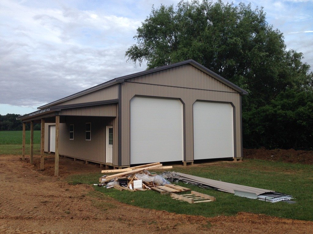

    The lean to, windows, and and doors are all installed :cool:
    0CF804CE-A99A-428C-B991-BDE066CA2548_zps_f3b8b46953ce9fbd24c1d03d45a04206e068c351.jpg
    BB772CC9-B04D-4D27-B226-8BEBCDAE6D28_zps_702aa640a7ce4895ccea5489020ac2b2defd9830.jpg
    835E5F63-0B17-44B2-9097-55921E35792A_zps_7524e92498b9b5c1f8bb361064b502fceb44c85d.jpg
    374D496B-351A-4F0E-AE13-81E90F33BD9E_zps_d48e65e873fec87c1e649fff6eeb030766024538.jpg
    9005E7BB-135C-4D90-9E35-B2209FCC97BE_zps_8c185e26d71e8a6723f9a691fa29baef131b43ba.jpg
    Next up will be to spread some stone and get the slab poured and work on getting the sub panel and other utilities fully connected into the garage.
