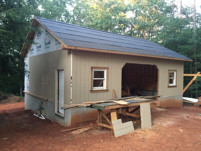

    Teaser:

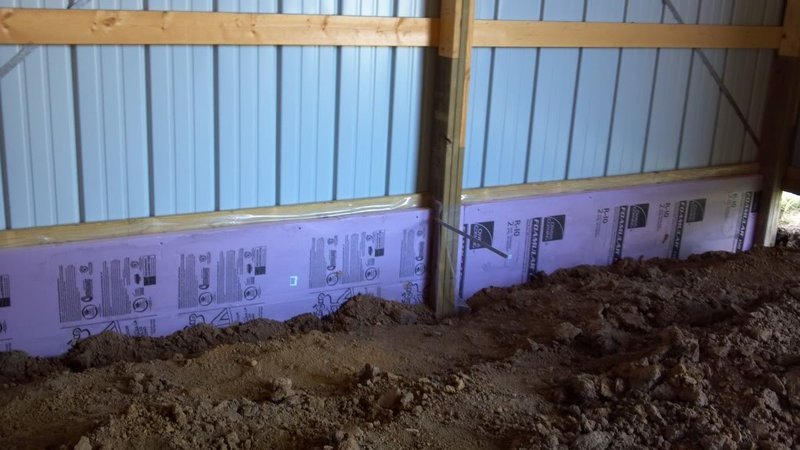

    Ok well the better half of my conscious has voted to do radiant heating, I was swayed both ways but for a little more in material I think it'll pay off in the long run. I got some progress done today, not too much but I was just working by myself.

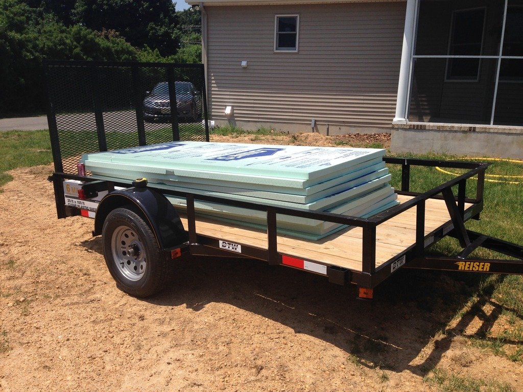

    Grabbed some 2" 4x8 sheets of XPS from lowes
    5034FA04-3576-47DA-982A-E40F012211B3_zps_91d89ea8798d8a2e7a528671868f56ab09164ab2.jpg

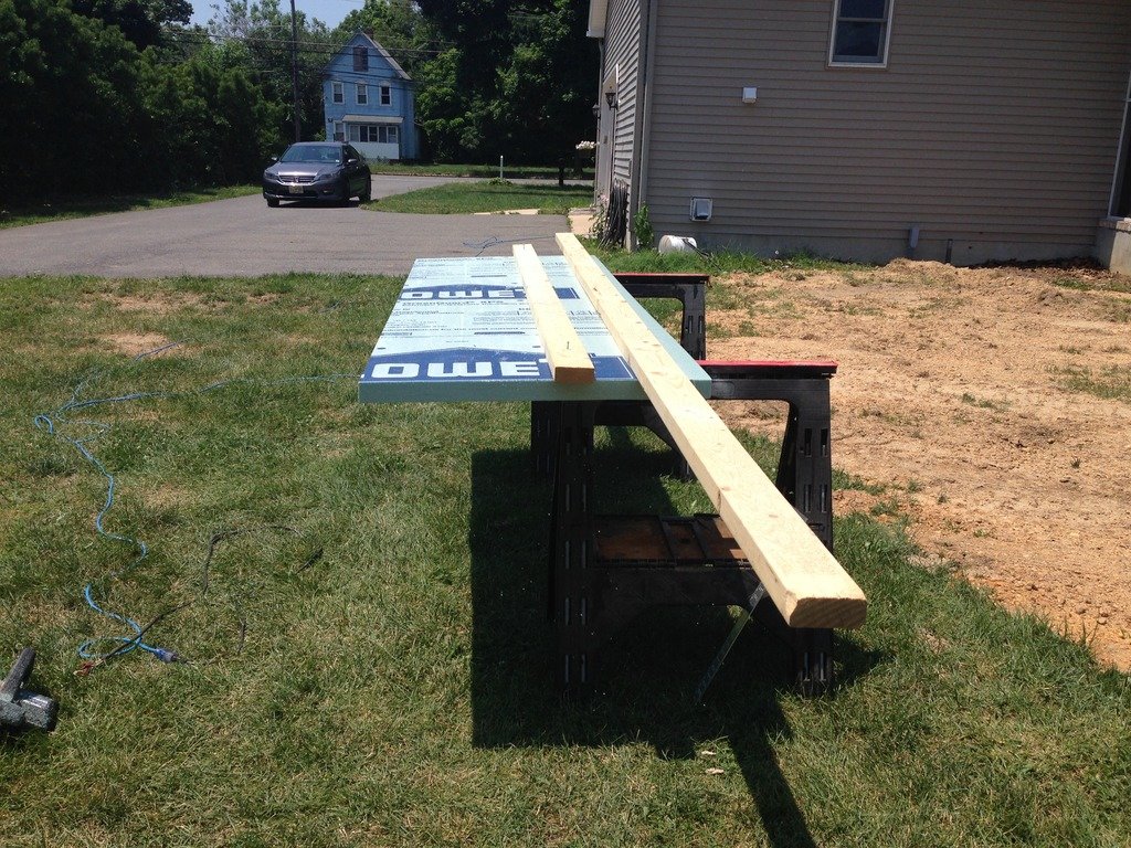

    Set up a little jig with a 2x4 and some nails and split the 4' section in 1/3s for a 16" height.
    E44A1767-5C49-41A6-AD1F-2BB9F9AF4BC4_zps_dcef03440c7459072af2b3eb5298c22f7919bf46.jpg

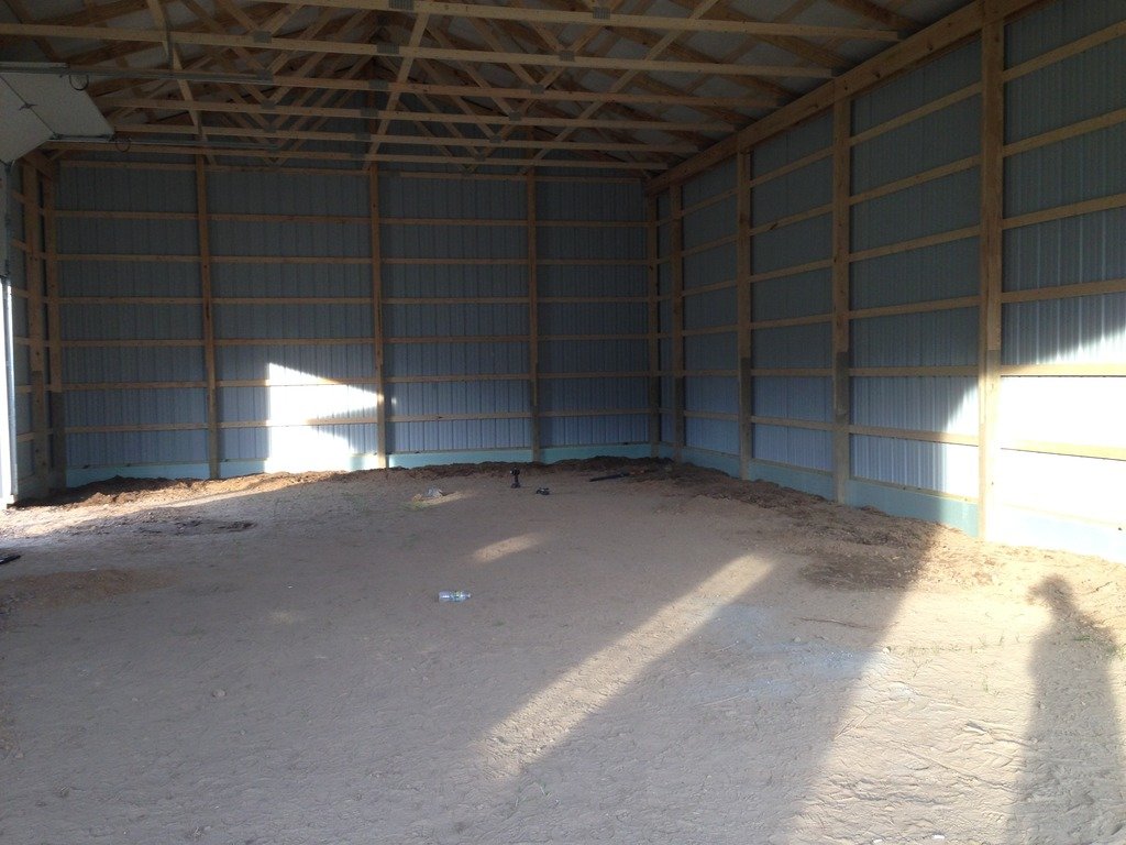

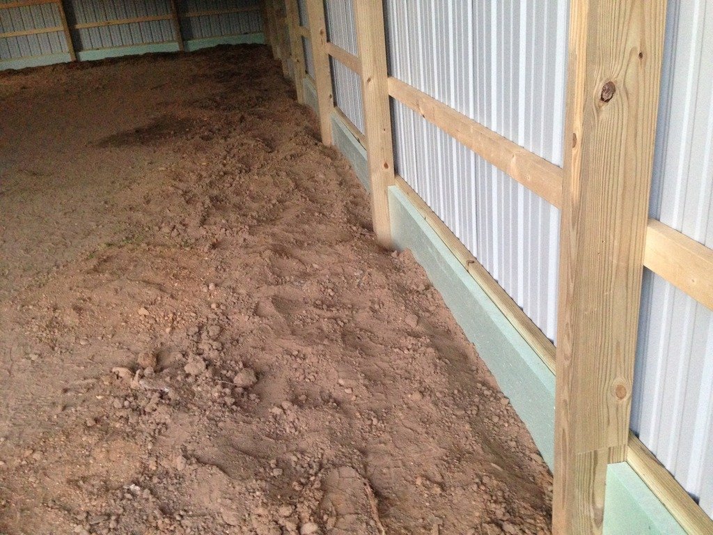

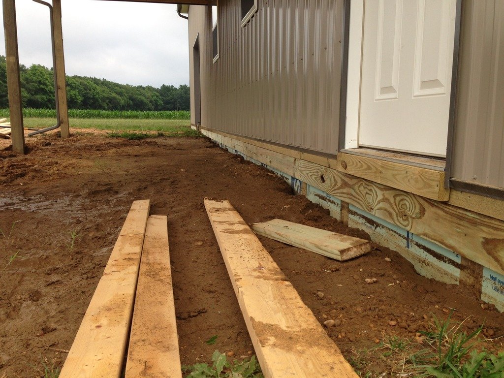

    Dug out around the skirt board and mounted the XPS where the finished floor will go to
    CB888C24-DD1A-4BD8-BC4E-AF839191AB7B_zps_79932f9283a06ba0a4ce0541f1d8a7f4a5251f69.jpg
    DBF84A0C-CC91-41A7-B076-6DA1D214E375_zps_5b4d672a2793a314e784d6a04516a17418723974.jpg
    5B32F6E8-BF10-4E84-98FE-044316E01E20_zps_74c8c3cca9e35f26cb13f1e6cea7fa0fdd919474.jpg

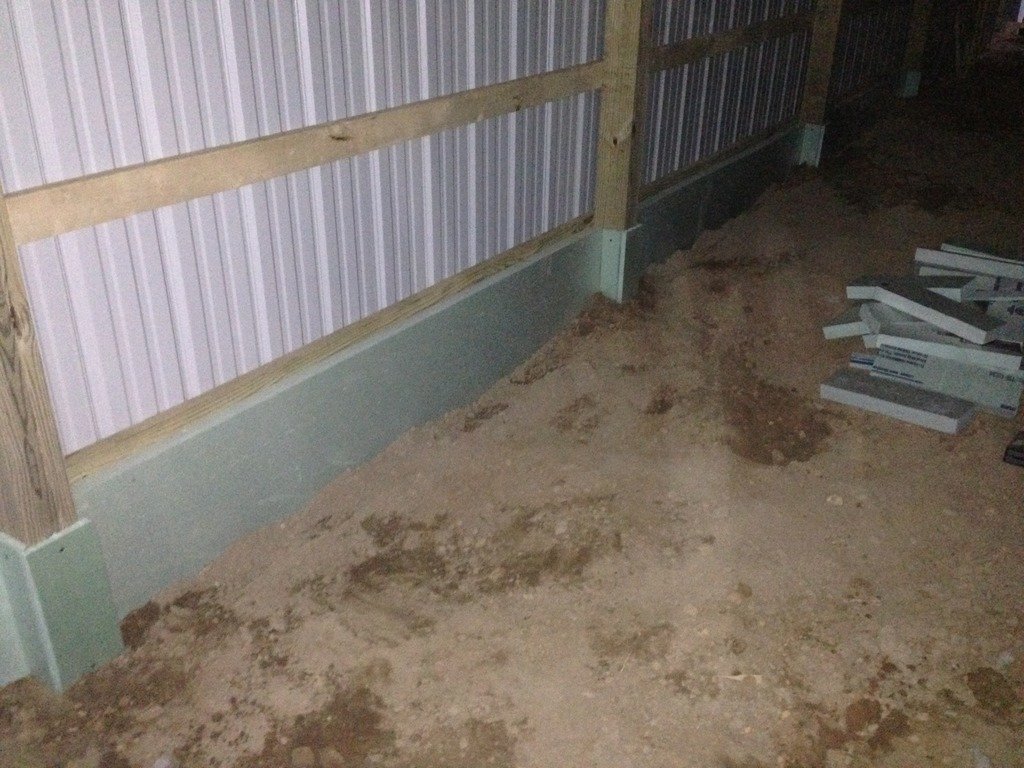

    Next up I have to put some 3/4" XPS where the poles are, that should go alot quicker since the soil is softer where they dug for the poles and it's a lot less area to do. After I knock that out I'll spread the stone, more XPS, a layer of vapor barrier, then prep to mount the pex with some wire mesh and chairs

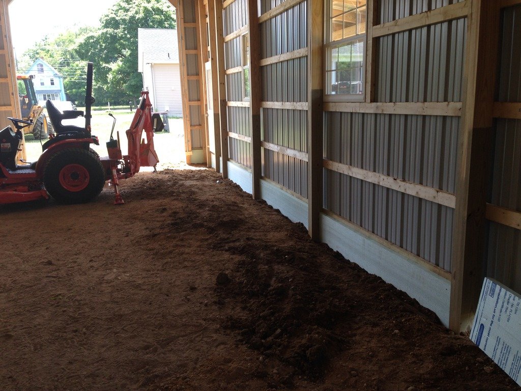

    Today after work I finished putting up some 3/4" XPS on the poles, next up will be setting the stone, hopefully I'll get to that on Saturday. Just placed an order for all the PEX parts
    8F99064E-C02A-417A-9560-BD9395658FF7_zps_635f5d398aa629e66e03c84ce0fd4542b2c60c0f.jpg
    I'll also likely mount another 2x6 below the existing skirt board to cover up the insulation and then add some dirt up to the trim so that water will drain away from the building.

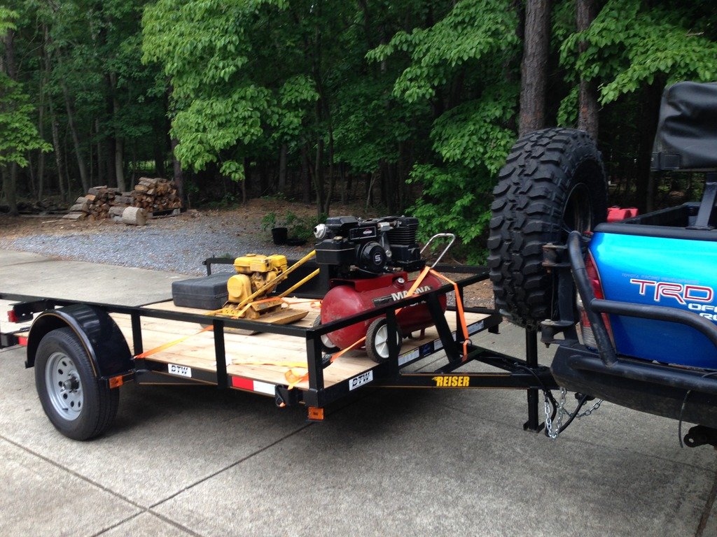

    Stopped at my Dad's today after work to pick up a tamper and gas powered air compressor so I can continue on with some progress

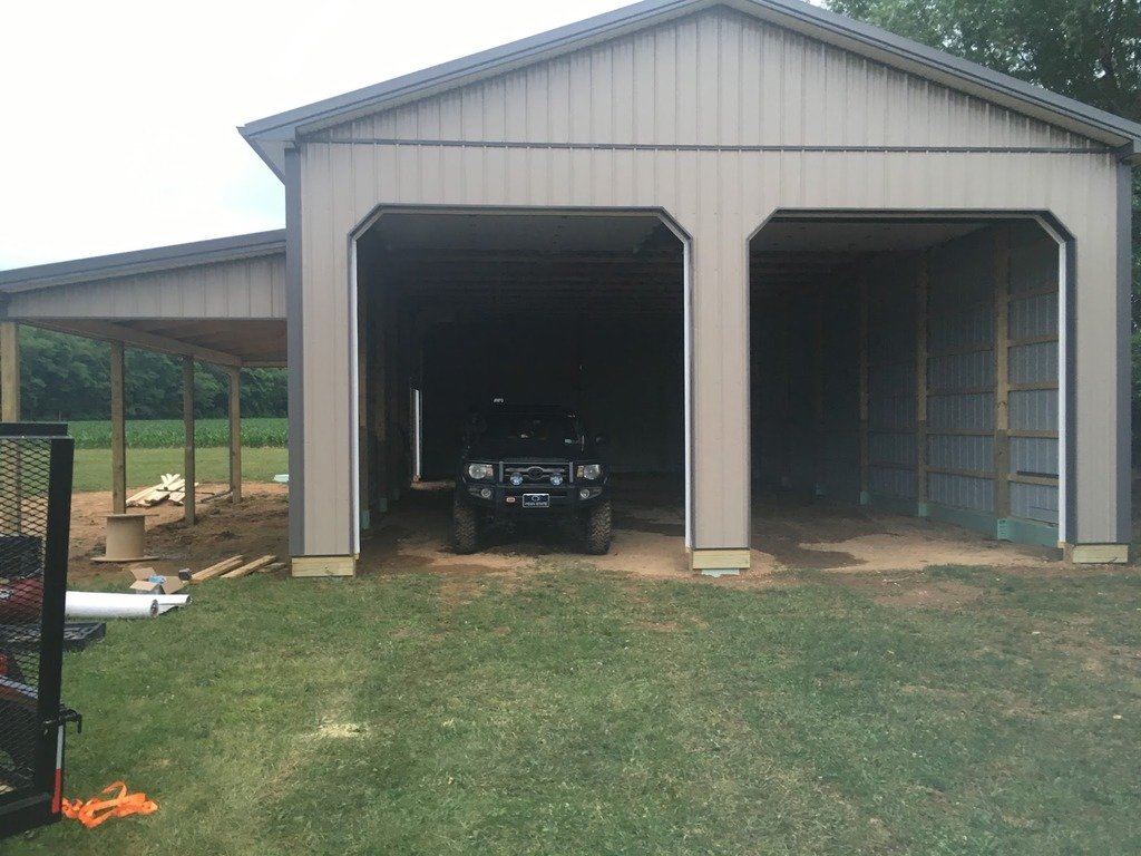

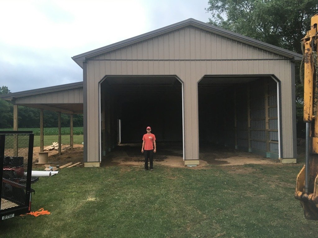

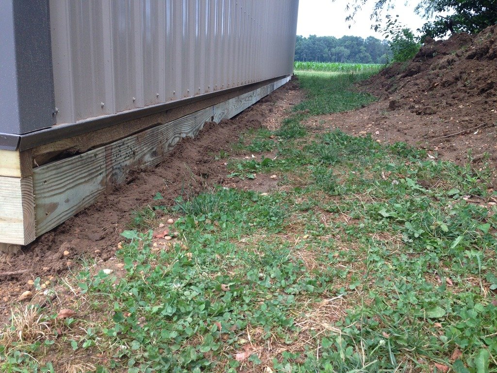

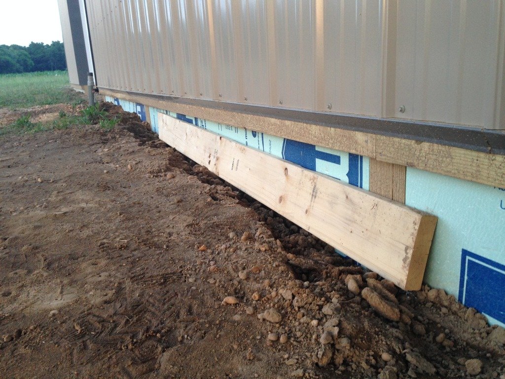

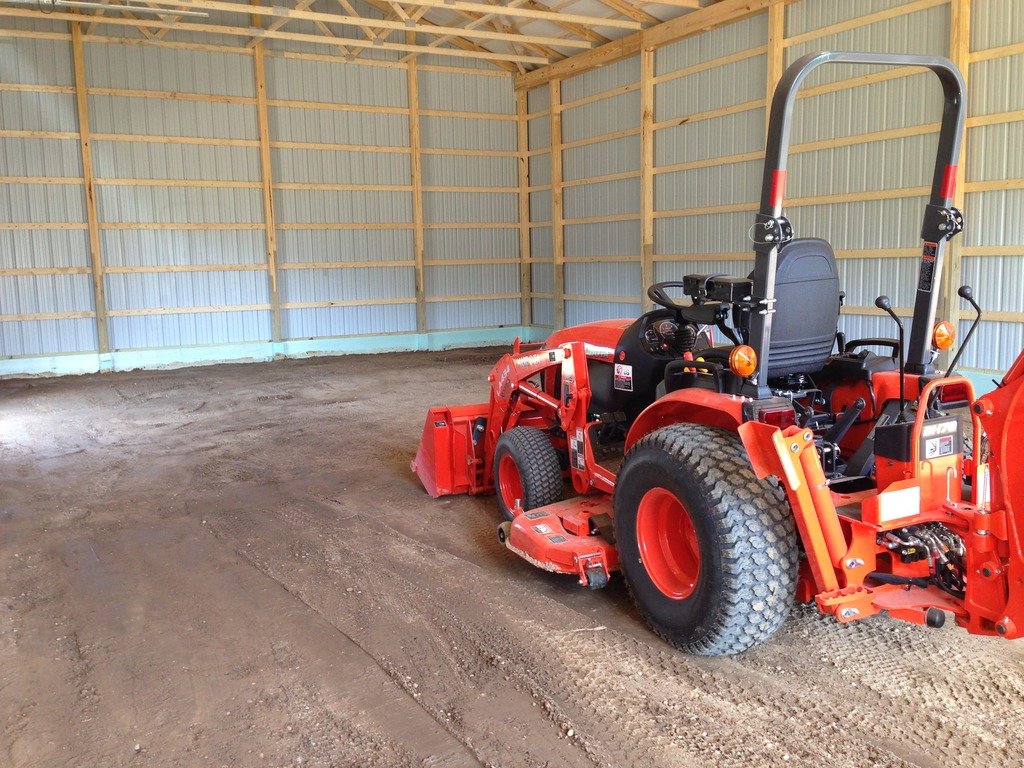

    Got a little more progress done today after work. Added another 2x6 skirt board all the way around, pretty much brings it even with the grade now
    5FD67170-7074-4A40-AFA5-730AE7676F78_zps_005b0a146d0e1c59844bbeb444c4598370e21d69.jpg
    D6956DDF-AF30-4E55-B874-5721F538B28E_zps_370037eaa66e21fcae6b3c6b58856583ff94eb1d.jpg

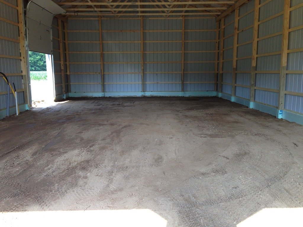

    Graded the inside a bit in preps to spread the stone tomorrow
    CFED7DD4-4FC6-4327-91DE-D800BCED7041_zps_ebd4de91b66b3606692c206eb0994189c34f8fec.jpg
    My buddy @planters15 stopped by tonight to test it out :D
    7BB97AFD-E3FE-4E20-885C-19DB16B35E55_zps_9999e455b9189d095ed2ec816bc2390addaae965.jpg

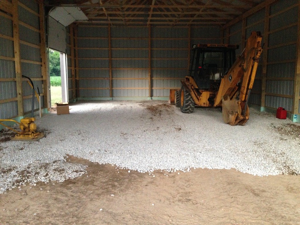

    A little more work done today.

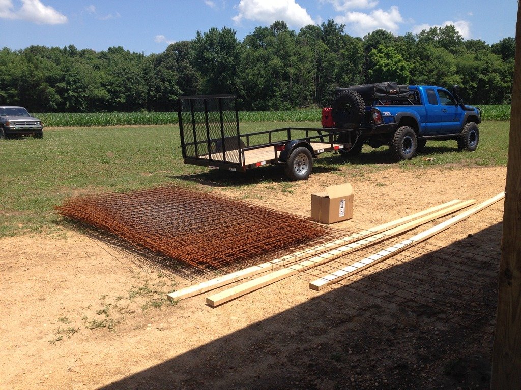

    Picked up 50 sheets of 6 gauge 5x10 mesh for the reinforcement for tying the pex to
    1C681CDD-4E0C-4C42-8F06-B84CD80156E8_zps_19bddbd9398c0b06eea953e3d2a1ca87151cdbee.jpg
    Finished grading the inside
    12E545D8-C78D-419F-8B02-1EE707412F2A_zps_408fc30367ce3d880651068fa521cd5ed5a8aa93.jpg
    694902C8-5231-41C6-B9FC-27BD2BBBEA6C_zps_c58de110b800f66e00df6a0776f09e21a97dd52f.jpg
    25 tons of stone didn't go far, looks like I'll need a bit more :D
