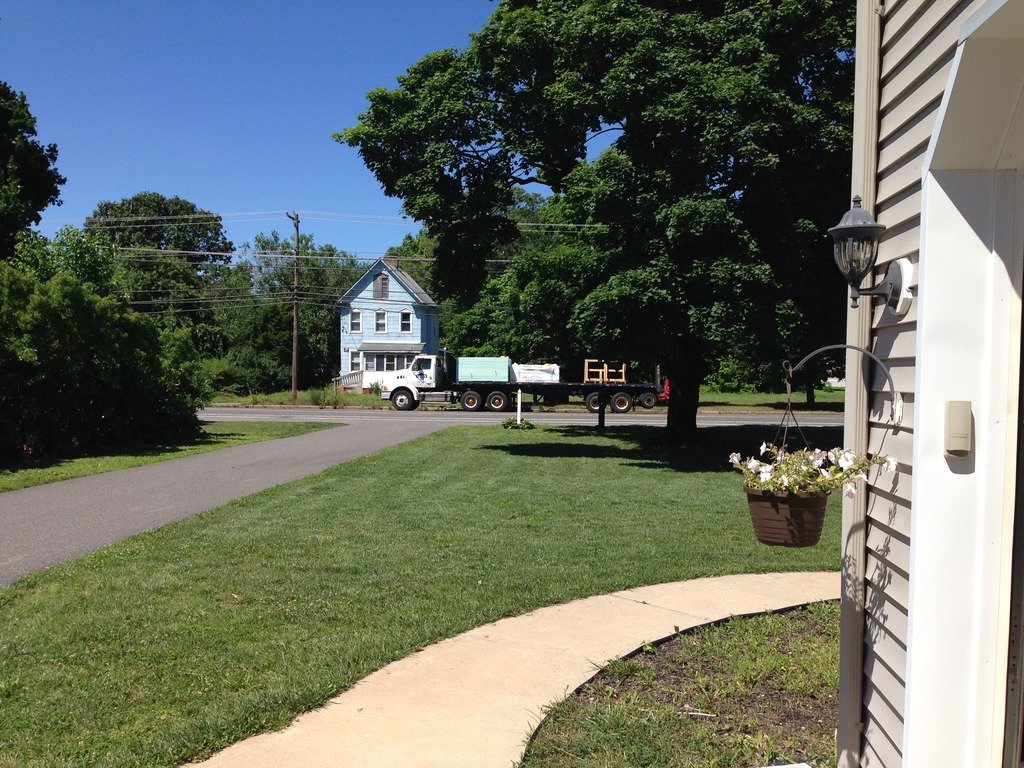

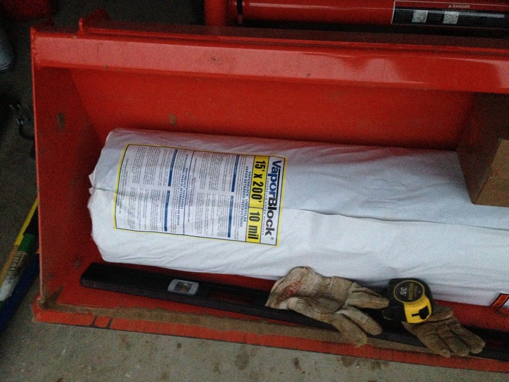

    Today I picked up a roll of vapor barrier from a local construction supply, damn this shit is expensive LOL

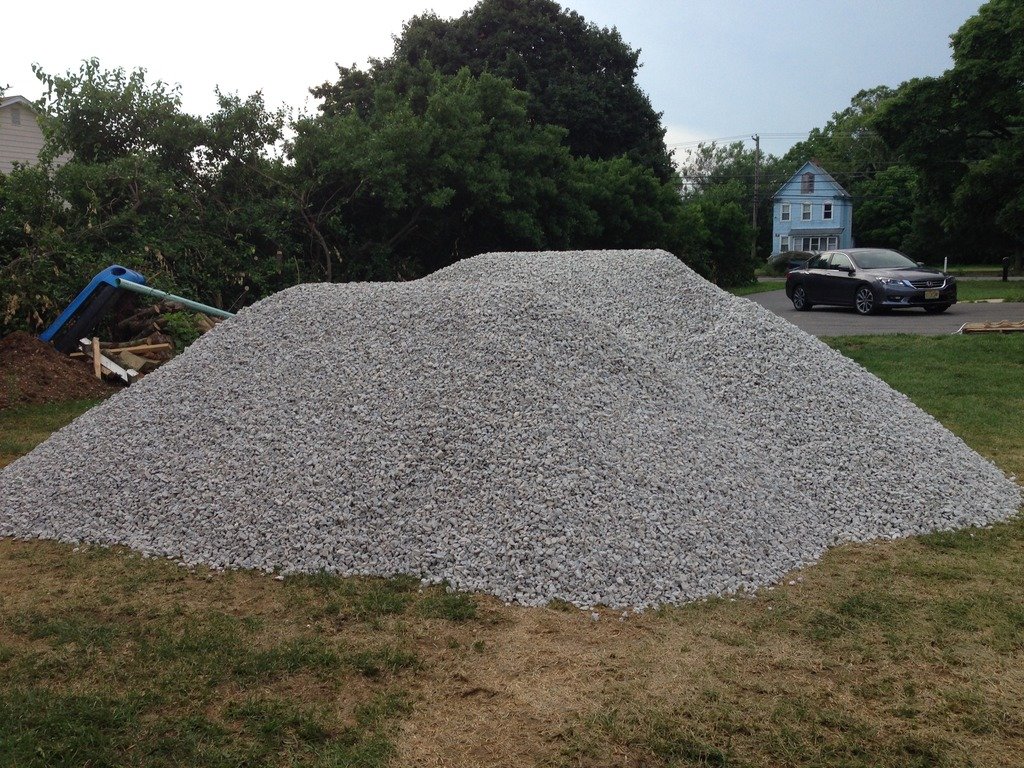

    Two more truck loads of stone, this should keep me busy for another day or so
    53DD72B8-F5C8-47C4-BB5B-F4E271C9912A_zps_410acb170aa9b7b4617de1a90b9f3c92a67922a5.jpg
    Also ordered the remaining insulation, 60 more sheets of XPS, damn I never realized how pricey insulation is :eek:

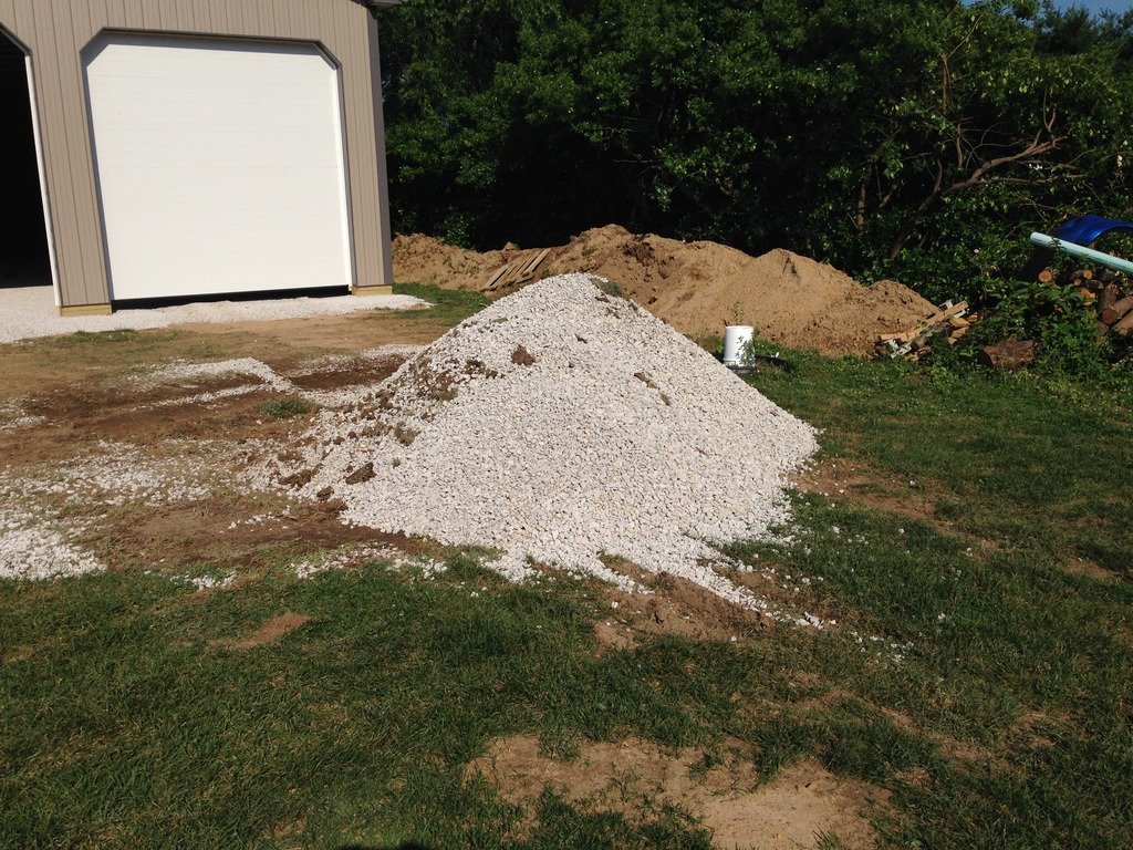

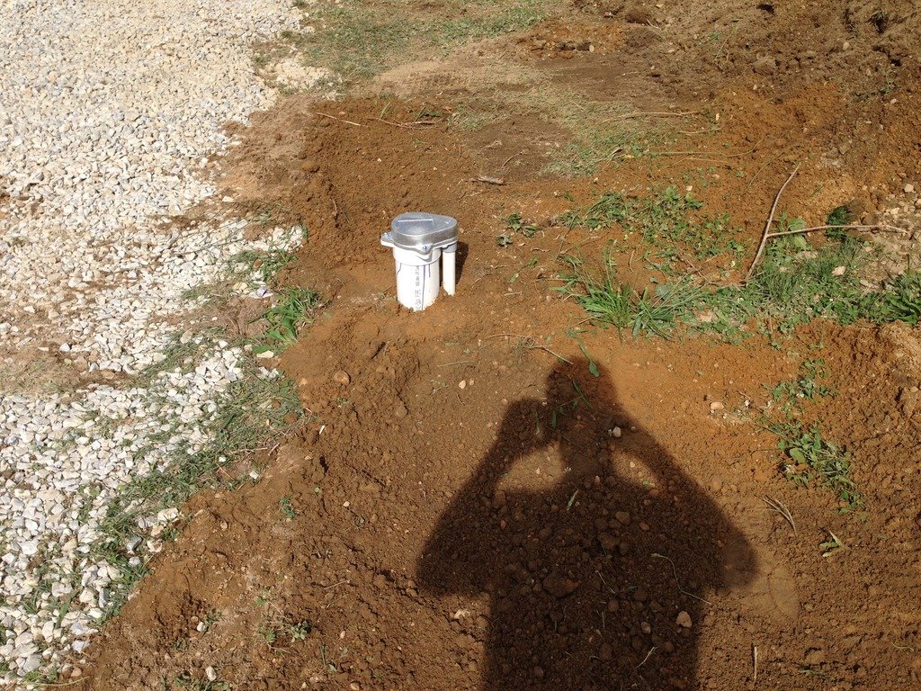

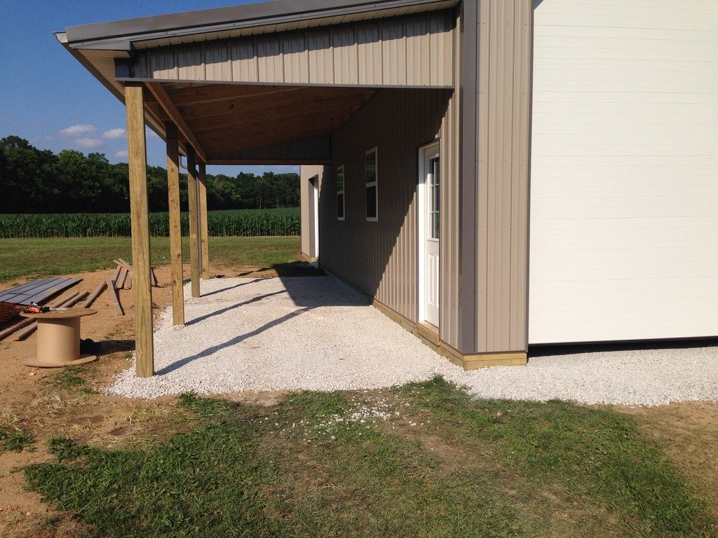

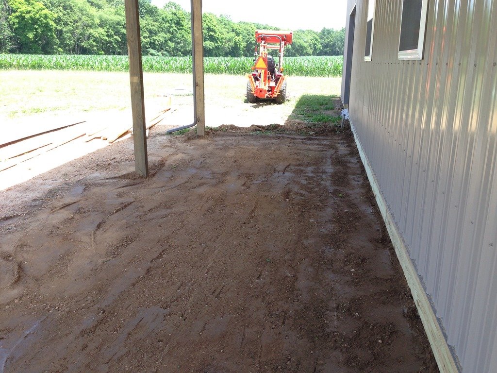

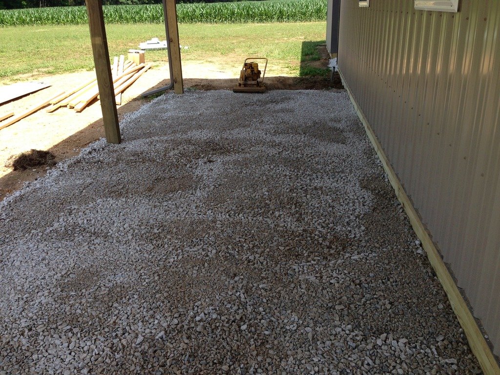

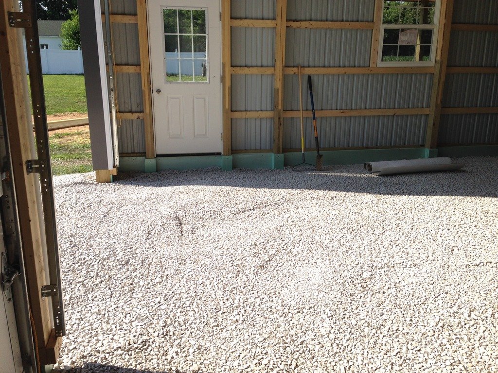

    Got the rest of the stone spread today, started by grading and tamping the lean to area
    09F8BD67-F3C6-4979-845B-CE7FB74B74BE_zps_18903378a8e26144598ad80fe5605968103fcdc7.jpg
    Spreading some stone
    5647B8A9-D679-4479-B210-7860C591F371_zps_c34f244649a985aace9e0d5dbda3831be4a8f097.jpg
    Lean to area finished and ready for concrete
    02151B9B-BD7B-4643-B0A3-4BB3503149F4_zps_8bbe5ae35ef7286bc0df79fadfb9436abd9866c2.jpg
    Inside stone is finished
    0AB7F340-C5A3-434B-812E-4F732DCCF069_zps_a58308cedd15b2d416a0610b5ada2985a3fdf498.jpg
    0F44E7CE-0356-44D3-8175-8219B804612F_zps_4380b211646e5c98b21aafcf1e9cce974b602ed6.jpg
    Left over stone which I will likely spread in front of the entrance of the garage for now to keep from tracking mud in there until I get that black topped in the future.
    36582448-BBD0-4F92-9731-F6DF5A811BDD_zps_523e787ed791761e938500ce2feeb5a8a44c143e.jpg
    Tomorrow I will lay out the vapor barrier. The rest of the insulation should be delivered next week and I need to find some plastic chairs for the mesh sheets to elevate them, haven't seen any good sources yet so I'll call a couple local places tomorrow and check the interwebs

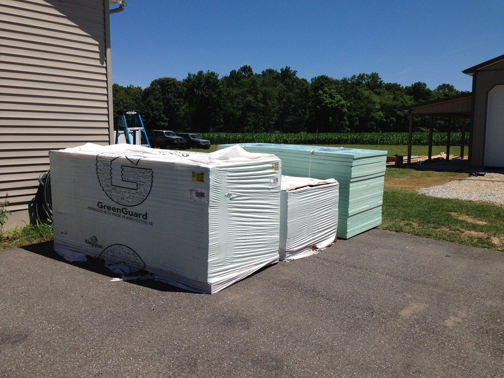

    Dropped off 60 sheets of 2" XPS for the floor insulation

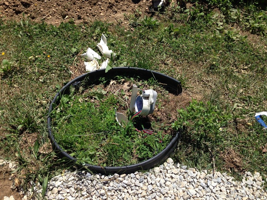

    Then I had a little accident with the backhoe moving it around, as I was turning the bucket smacked my well head and cracked it :mad:
    474D32BA-0957-4CBB-894D-5EED8AC3C35E_zps_95d68f7a35aa018fcc147cecfaddc2fe57d39c35.jpg
    So I spent most of today repairing that
    83075BAC-F77D-4067-8304-40FB3346E13A_zps_6d4b2d2cad1e3385d450a9f9477108ff144ee10b.jpg
    4B63F55C-C84A-4A65-9D15-BA240A059A6D_zps_a2906a25a0dc9a1f9cab09cb7f3fc618447359d8.jpg
    2D2FE210-40FE-4F79-986D-FE5B848E4FEB_zps_c1c78faf88f6a3e85f3b5e717998e03f2db52547.jpg
    I'm going to add a cement pole in front of it to keep that from happening again. I was real careful the whole time but the one second I let my guard down that thing exploded when the bucket hit it haha.

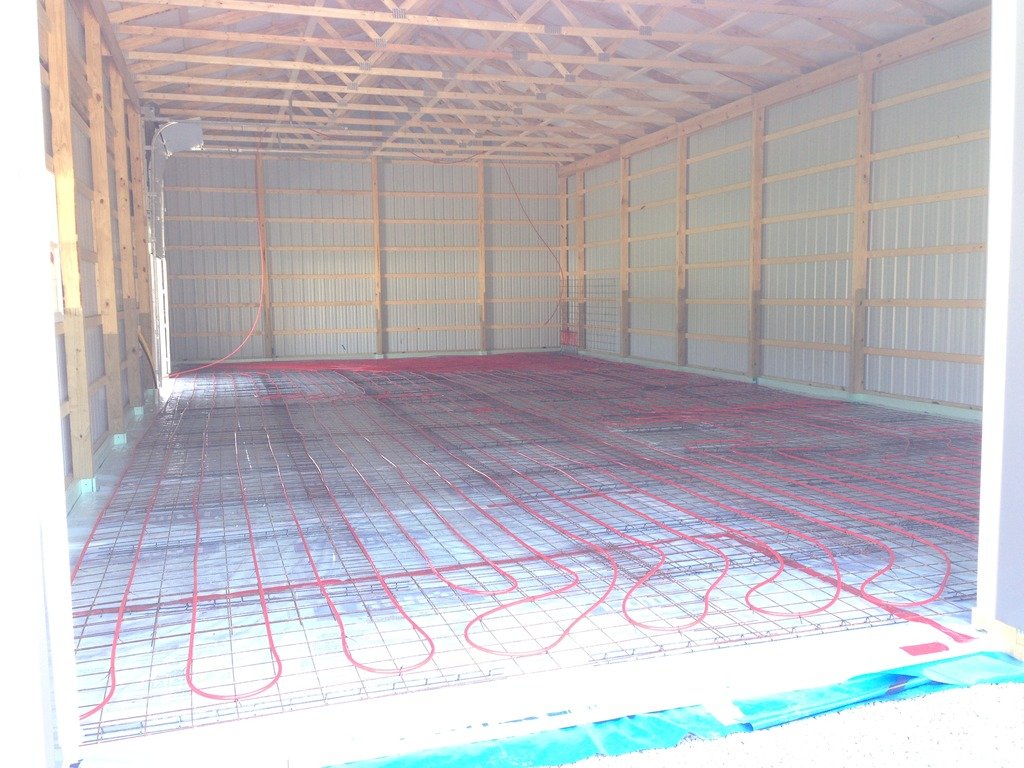

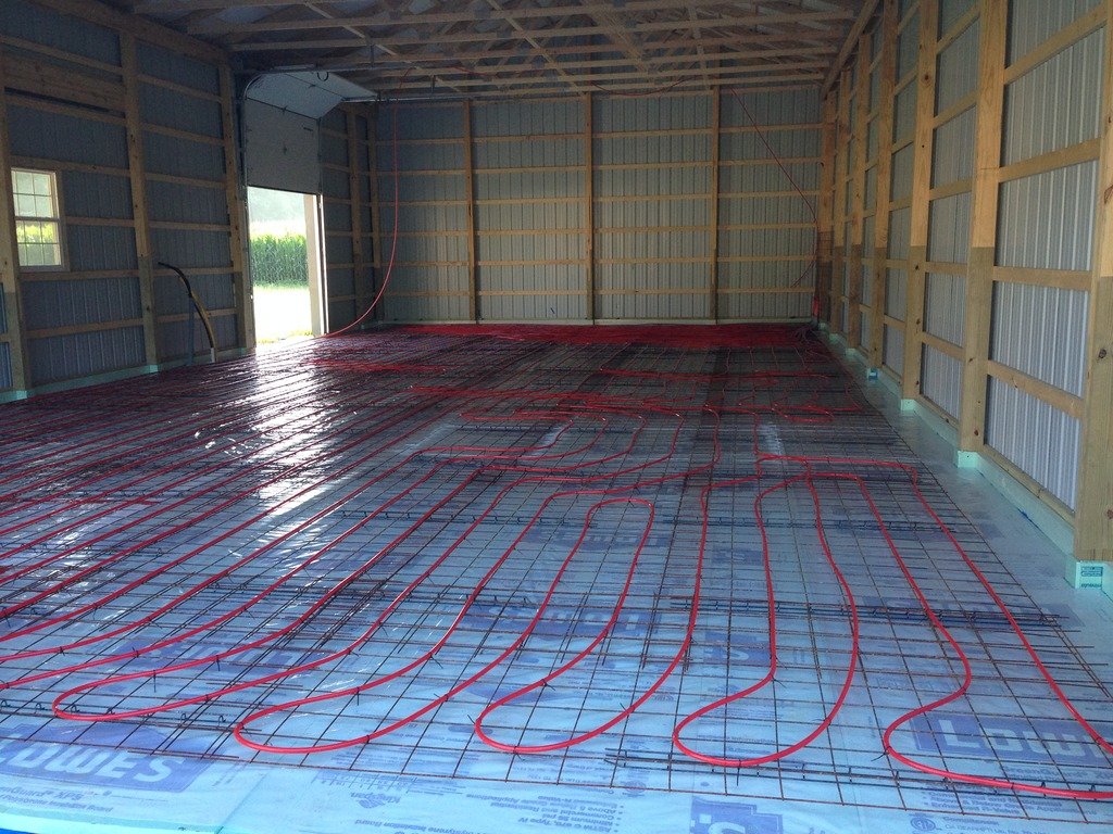

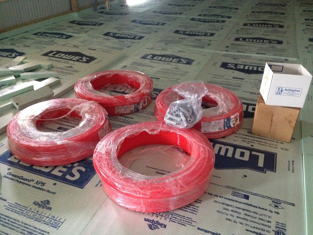

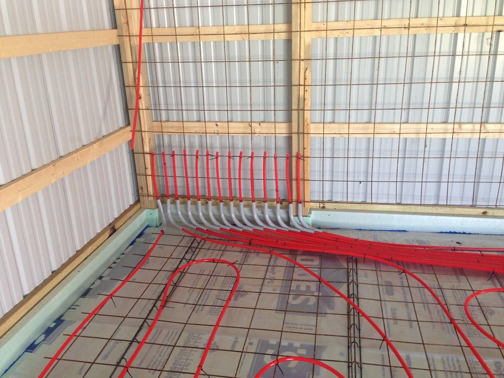

    Picked up 2000' of pex the other day, ended up using 1750 ft. seven 250' loops fit nicely.
    971AD914-535B-4465-9889-AE535185A5EC_zps_c2bceef8bba5ba1e1cdaa53ce88ac29971c52b3b.jpg

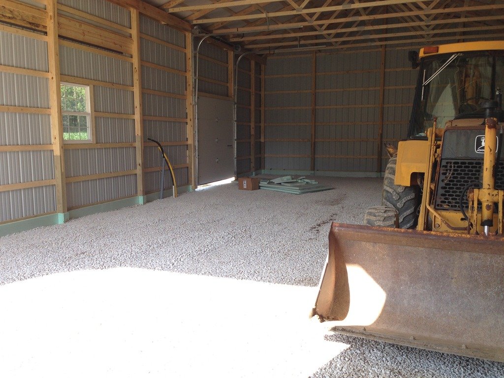

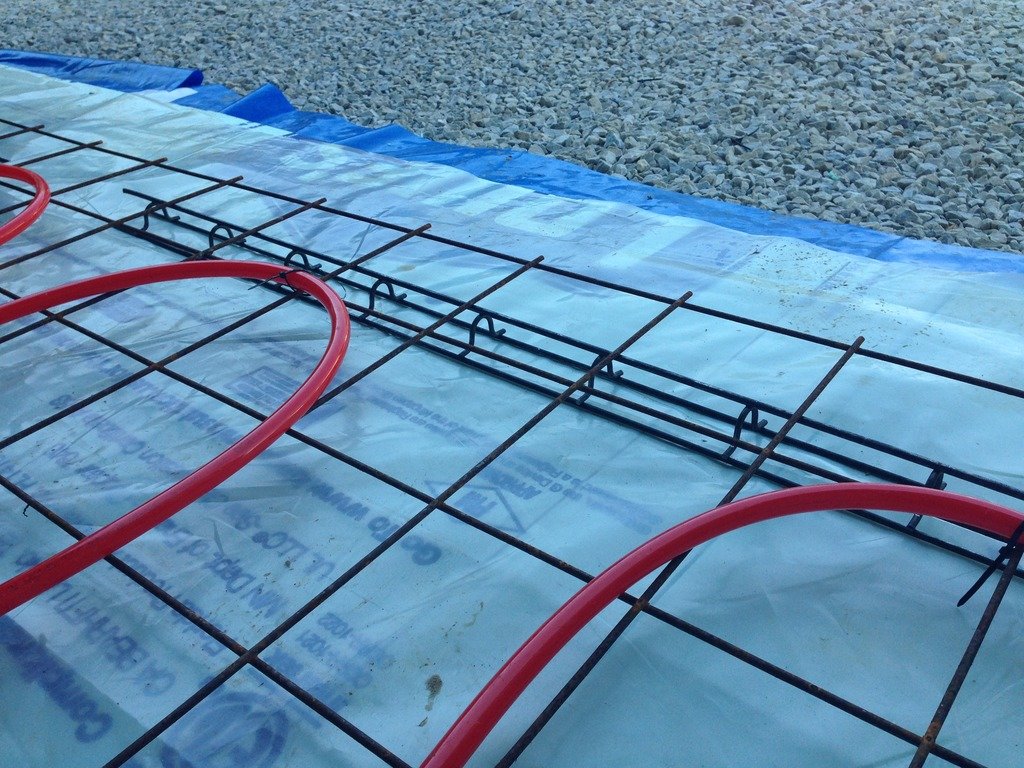

    Vapor barrier placed on top of insulation, then placed down the sheets of 6 gauge wire mesh (5'x10' sheets) on 1.5" slab bolsters.
    5007B039-9F98-4D66-BD9E-1AF33C3B3802_zps_2cd8c5757261f3163651ced6fb813c0b24f7a4ce.jpg

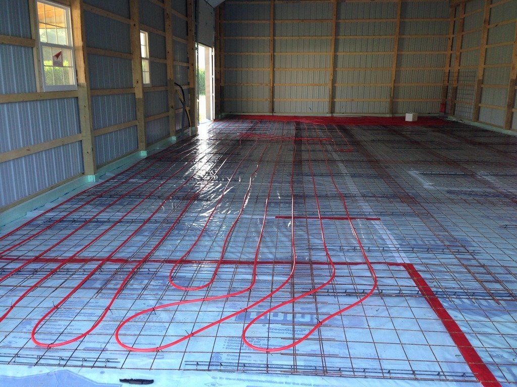

    Start of the pex run, secured to the wire mesh with zip ties, ended up using close to 1k zip ties! The loops are spaced 12" from each other.
    8C3E1885-83AB-4738-8BA2-496CE651960F_zps_20ddc2bfa33c3067e60f152779ff610a62ee676c.jpg
    Here are the bolsters, worked out much better than the plastic chairs I originally had in mind and were cheaper in the long run
    5922A790-0A94-4F1C-A2A0-B4C7136E3D0A_zps_49bb3531ba4cea9036018b4abb18576e850e3148.jpg
    Finished
    6C12D629-994F-4B30-9578-99646D8CD620_zps_33679f39d1b6a46022a2d304d5c7ec95b0cdbf42.jpg
    6A16F675-56E2-497B-BFA9-6529FDF908A0_zps_2a7472fb19cfe1446186cc6b319a788f4716d51e.jpg
    In the corner of the shop is where I will build the manifold. 7 feeds and 7 returns for a total of 14 pipes that I placed in sweeps to get secured during the concrete pour.
    329DE296-78C2-41D2-B058-698FE74F7713_zps_d25592907457d7332d84084aa94a123550894977.jpg
    Next couple of days I will build a mock up manifold and place a pressure test on it to check for leaks, then keep it pressurized during the pour in case a leak develops so I can repair it. Concrete pour is scheduled for Thursday :cool:

    I'm of no concrete knowledge, but is there a reason for the tubing not all running parallel but instead having the I'll call them bends to the end?
  16. Jul 18, 2016 at 7:55 PM
    #76
    PSU Taco85
    PSU Taco85 [OP] Señor Member
    Jun 21, 2014
    #132394
    2,011
    optional
    '10 TRD OR mostly stock
    Plasti dipped hootus
    Yes, reason being is that all the loops must be the same length so that it gets heated equally since water takes the path of least resistance. So to get each loop from feed to return as you use up floor space they don't always end up even like that. Really makes no difference as you won't even see it once the concrete is poured. I had to also route the tubes around a square section where the lift will be going since they will be drilling anchor bolts there.

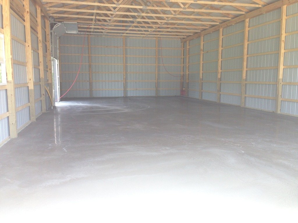

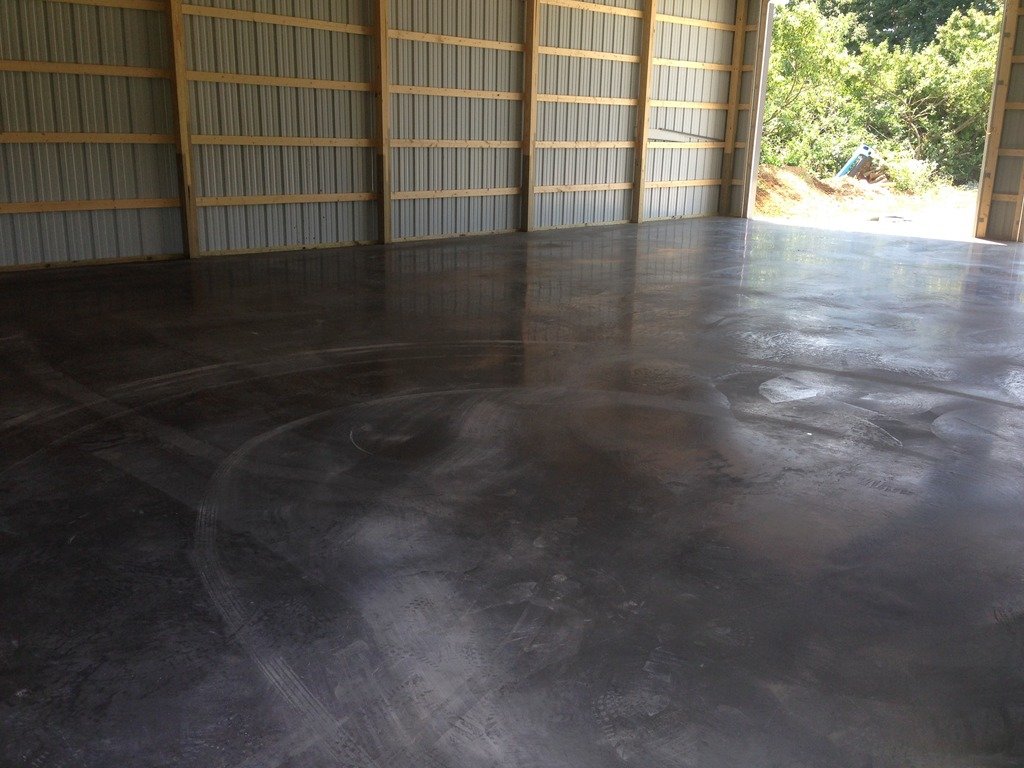

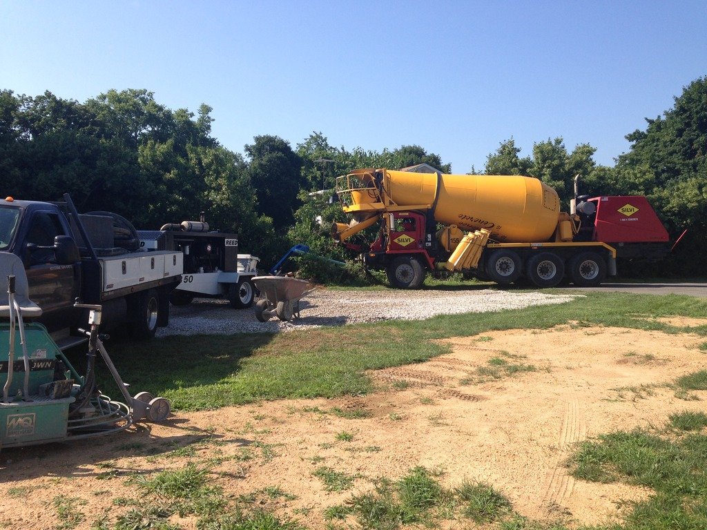

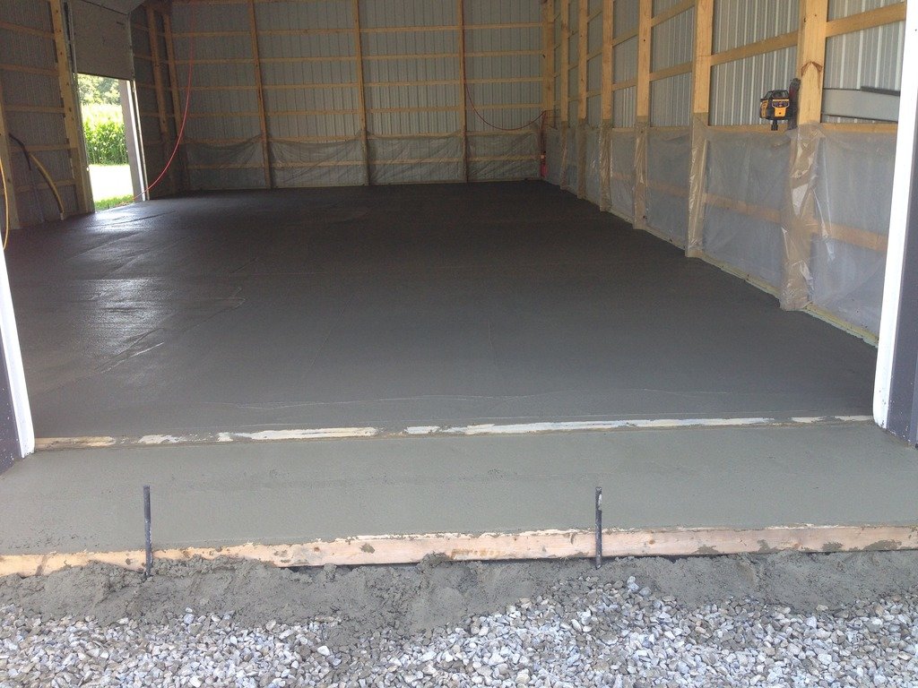

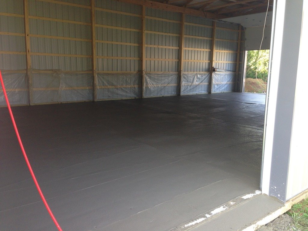

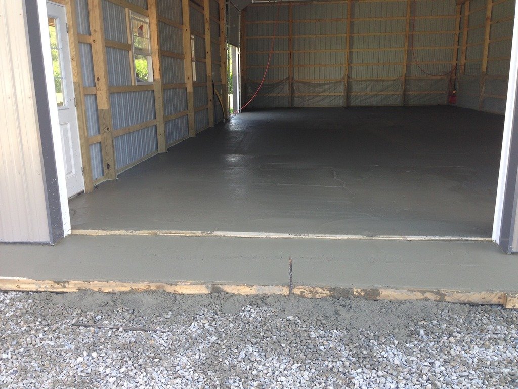

    The concrete fellas came out last week, they did a real nice job. 4 or 5 guys were here for almost 9 hours working away.
    45FC1326-D45A-4DDD-ADC1-4A29CAFD705E_zps_8d693e0f11176e1b15ba50756c279e35b5caf79d.jpg
    CD3AA83F-C7C1-4C51-870B-127676C269A1_zps_10560705da1988f1a00117ec549b94dff0389842.jpg
    C748F043-1052-43E0-A14D-C8F1E5A9B1EC_zps_968e6d6c5dce2d15e9b52ccb9c5cf1c06c3ed9f8.jpg
    87D6B150-7F82-4A82-9637-C9CBA6BE6B7C_zps_dd143a68cbd74681c94d4405fe7e4b4550b5b0c2.jpg
    63D5F388-9930-4872-A0CB-FCC5A53CD891_zps_8050133ca4f56c84ce379c3a9b667c42b4c15f95.jpg
    21F2816A-19E5-448D-B7F2-0CEFA4F20227_zps_2089a6d59c80b26bfd202e44581e83dfc80c60b3.jpg
    I need to get another load of stone out front to bring the grade up to the front apron, and then spread some dirt by the lean to area to grade that as well. While I wait for it to cure, I will get the electric finished up and inspected, and go purchase the sealant for it.
    I plan to etch it then use this stuff, anybody have any other thoughts or recommendations on sealant/waterproofing? I don't want to paint the slab just seal it up, this stuff seemed to have gotten good reviews.

    Just a hint, there's different concrete sealers. Be sure to get one that resists oil and gas spills because the stuff on our garage floor gets eaten away by gas
