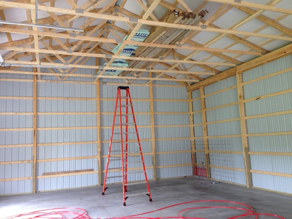

    Put all the extra boards and insulation up on the ceiling joists to get them out of the way
    D3F151F9-B58F-471C-9F4A-2B5ACB576AEE_zps_805dd9695865ab4cd40ee483d1d9058432d0f560.jpg

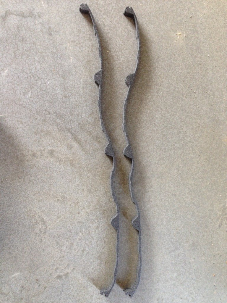

    Also picked up a bunch of foam closure strips, these fit the contour of the metal nicely.

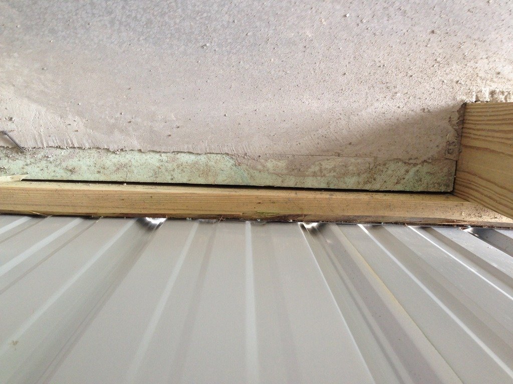

    You can see before putting these in the air space from the small gap between the bottom trim and side panels where insects and air can get in quite easily.
    60990927-1AAE-4AA8-8500-93B0AE2D4484_zps_299e95d65cfaaf2d79d9731459bca6c0c33debb5.jpg

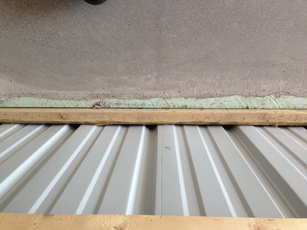

    I took the bottom row of screws off the side panels and installed the closure strips all the way around, afterwards it's nice and sealed up
    7B7735D5-C07B-4DD0-9283-C9B9B5E69DC2_zps_912cf9d873b8ec725a14ce129cd21a0deaafd241.jpg
    5FD67170-7074-4A40-AFA5-730AE7676F78_zps_005b0a146d0e1c59844bbeb444c4598370e21d69.jpg
    Between the bottom trim that's mounted outside and now the foam, that should keep most of the drafty air and any critters out of the inside

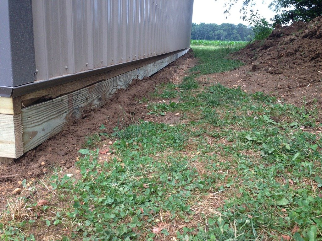

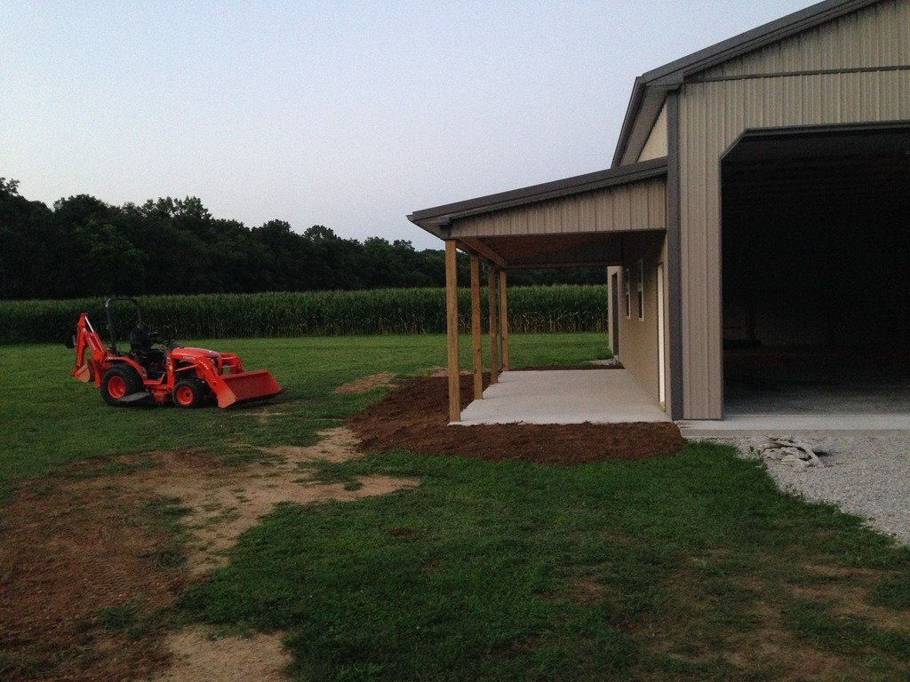

    I then took some top soil and graded the area where the lean to is, next up will be to get some more stone and grade up to the apron, there is currently a 3-4" elevation difference between the apron and driveway area
    38EFFCA7-A391-48D1-91E9-B731A4E278F9_zps_fcc9e44d8cdeb3419544f98f8e8e42b6ddab50b6.jpg

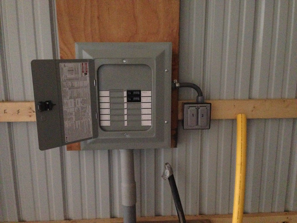

    Got a little more done today, garage now has powa!
    3F741820-02FA-40E2-AC72-840A5AFEFBAF_zps_2c7f525c09553d6e9a75b75a77e6e1968b107c89.jpg
    Ran a big old fat gray cable to the pull box
    713C4AAD-222B-40B8-B16A-773842682DF9_zps_f37e7d98a4eb22743f18e8861b5bbd72ecb50fb5.jpg

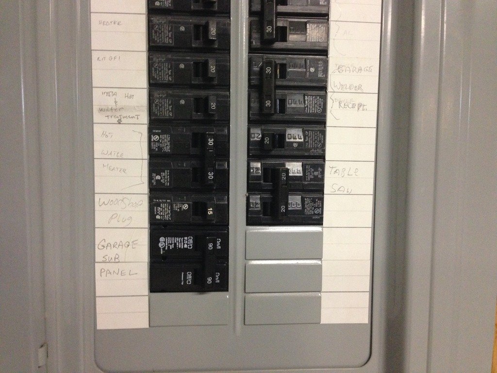

    100 amp sub panel with two 20 amp GFIs for now, I'll add the 220V stuff and then I can start running some wiring for lights

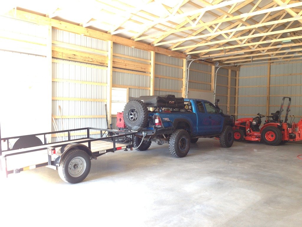

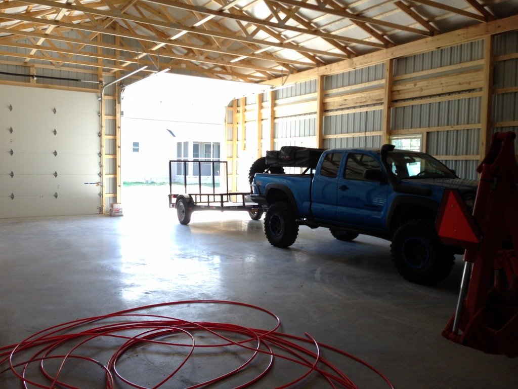

    Thanks fellas. Took some time to re-arrange some stuff today. Can finally get my car back in the attached garage LOL. Next up will be to etch the concrete and apply the sealer. Hoping to knock that out next week as I'll be busy at work all weekend unfortunately. Got another 20 tons of stone delivered and spread that today, and looks like I will need one more load of stone to even everything out.
    68344DC1-526A-40CB-8A7E-DAEEAF22CBAA_zps_f14c07b9afa75b13ddef1bdb1c6e0f5de6360621.jpg

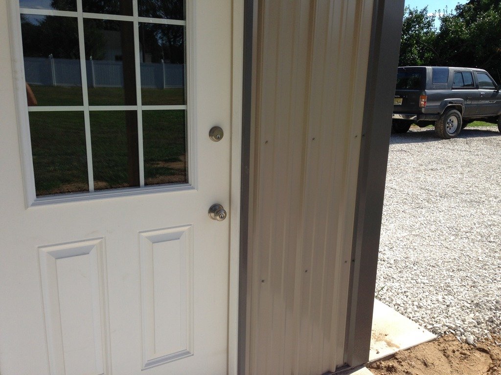

    Added a deadbolt
    D2450A4D-B70B-45C7-92E5-0567BE708303_zps_a1e8352e1d2fc05fb1e452ebaa075cee28f50de4.jpg

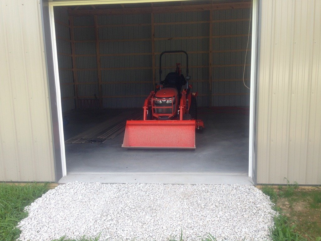

    Got the tractor in its resting spot
    BD8EE6D2-DD1C-42C4-857F-5B049B424AC5_zps_45176f1e072fbe2c46b18188af75457c72658c30.jpg

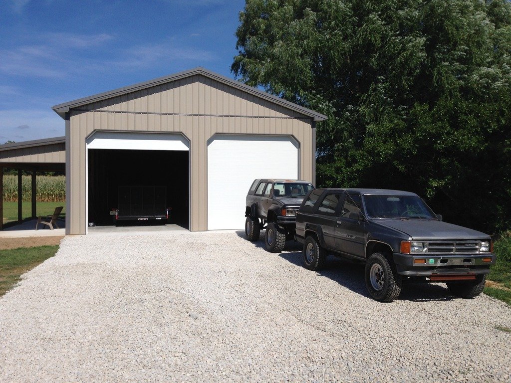

    Taco fits in here with the 6x10 trailer with plenty of room to spare!
    87969EBA-2545-424E-9CFF-DD0A0F5BECCB_zps_0607913bf250d2203f15c87a46a210b2505fadac.jpg
    57BD1A38-D52C-4F92-8B51-8717B88AA6F2_zps_c967cf086967ee9c4b1f4560f5cc25d08e171392.jpg
