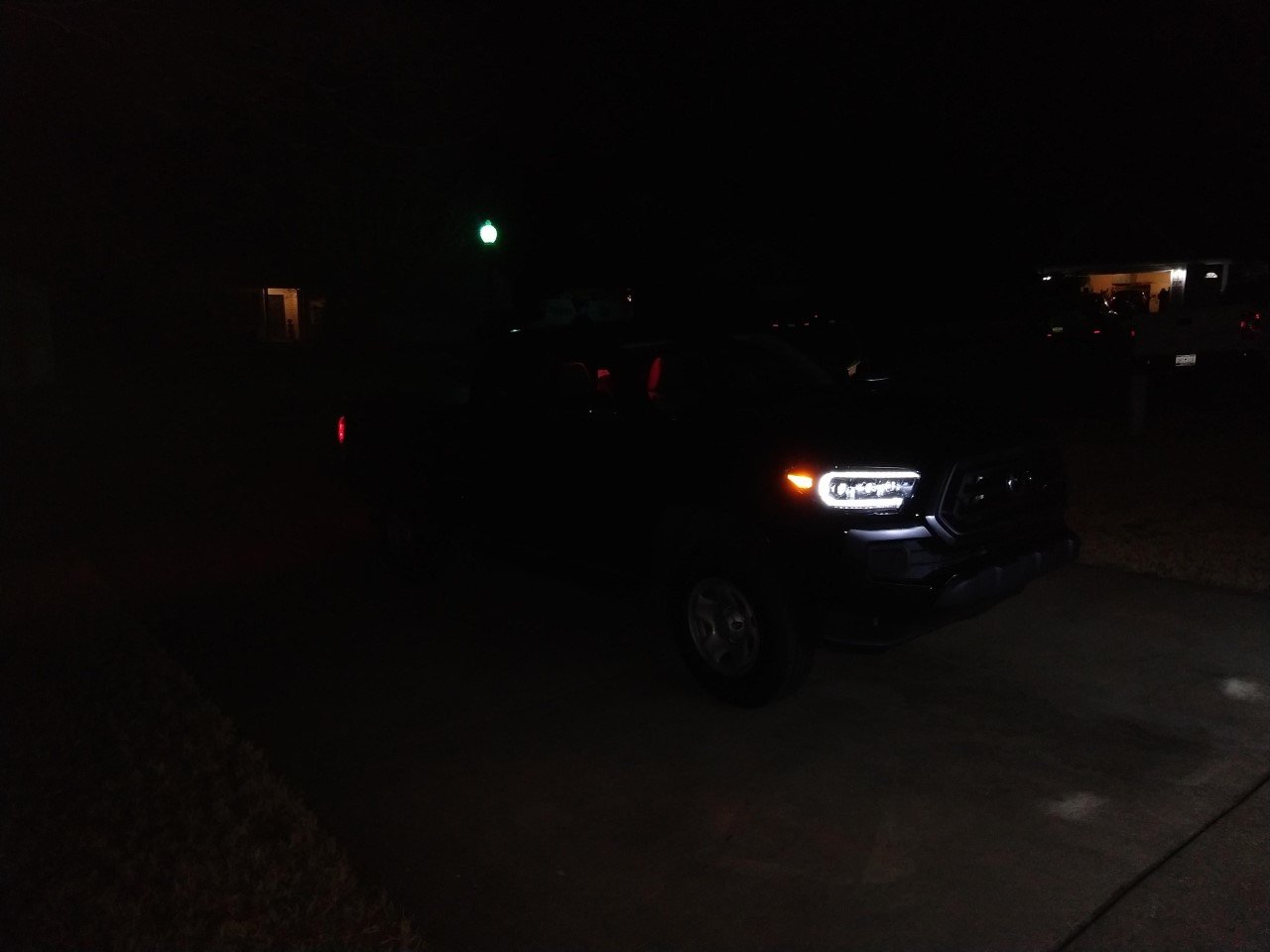

    Has anyone else installed and have these running ?

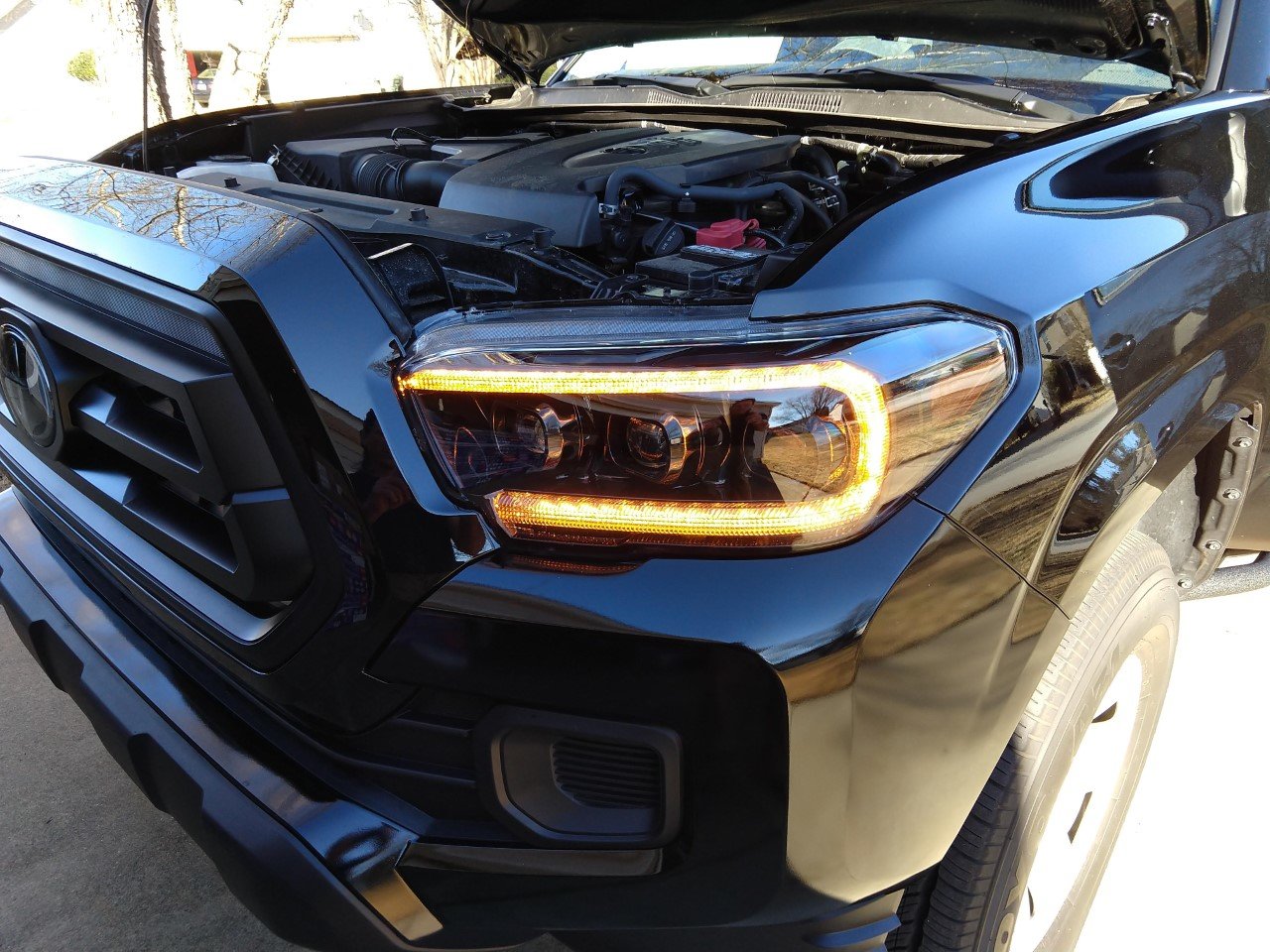

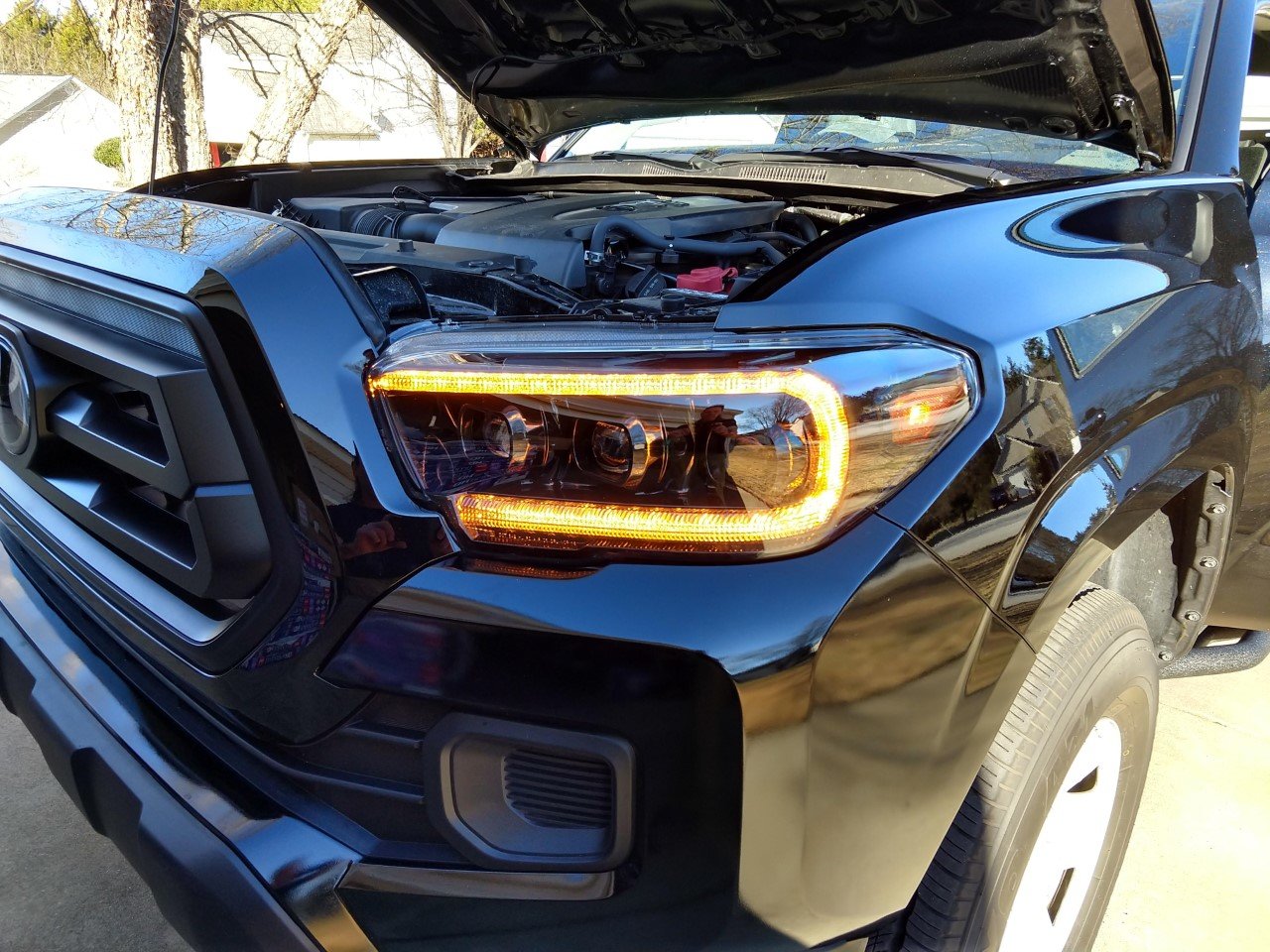

    One thing I didn't realize was my non-LED (Orig) with Auto/DRL Off option
    Would still run the DRL's in Amber...still pretty
    Running or Park Lights with side marker
    Low Beams

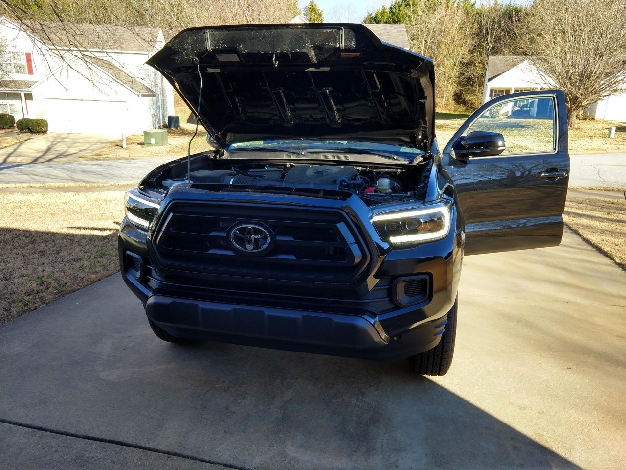

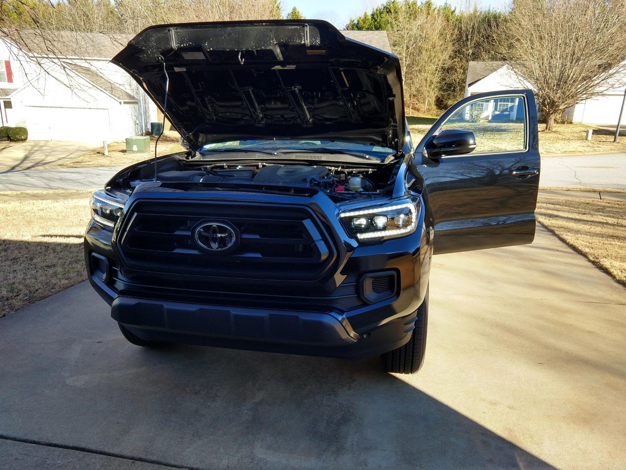

    DRL = Off for those Bright DRL Running, they are Auto when using the EFI circut

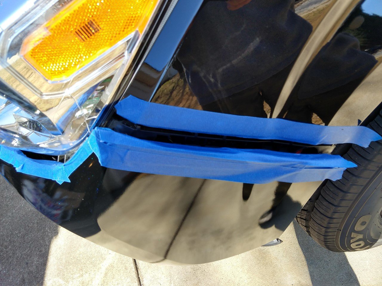

    BTW...make sure you do this, just so you don't scratch your paint... when doing this solo, deff helps

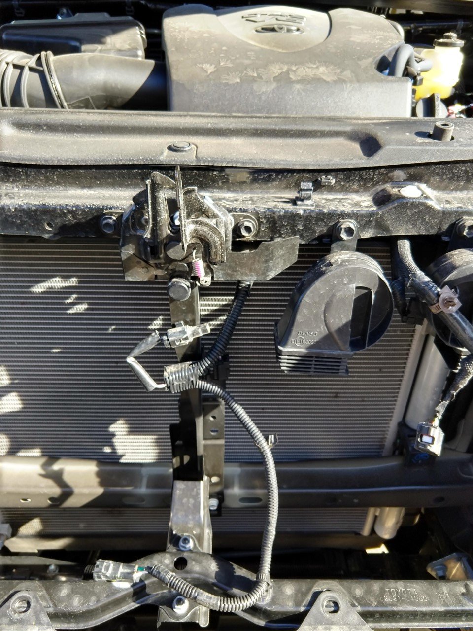

    anyone know what the lower/mid connector (nothing plugged into it) im thinking fogs pr front cam prewire ?

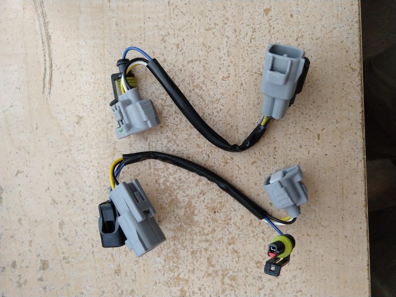

    I was actually pleasantly surprised to see these in Amber...i thought they were all white unless you modded them. However, when i saw the Gen 2 vers that used 6 low beams and 4 high.. i was careful to order the latest edition of these.
    They come with these connected...so i believe these are for the TRD or possibly OEM LED setups, looks like they combine the DRL along with the side markers
    I think the SR and SR5 are wired the same and use the same housings/connectors...
    When I use my "Auto" lights function on the stalk the DRL and Park are amber. When using left or right turn signal, that side will go off and flash/seq bright amber. When I lock or unlock after just getting out of the vehicle or at night...again flash/seq amber. At night...the headlights come on, they turn from amber to normal white. DRLs go off and H/Ls come on
    I have to turn my stalk to "DRL off" (with the DRL split/tap connected) to get the DUAL bright DRLs in white, which work great through the EFI circuit.... w/o this tap, there is NO DUAL bright white DRL!
    I think with the gen 2 vers and the way they are wired for SR or SR5 this is a go forward.
    the black connector with the yellow boot and blue wire is replaced with the DRL split/tap on the new housing

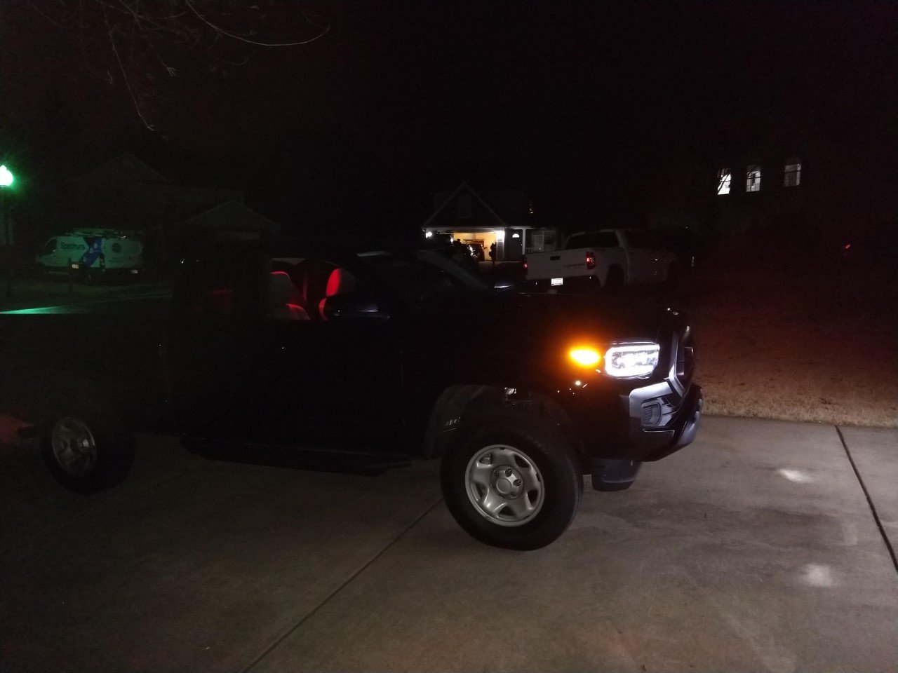

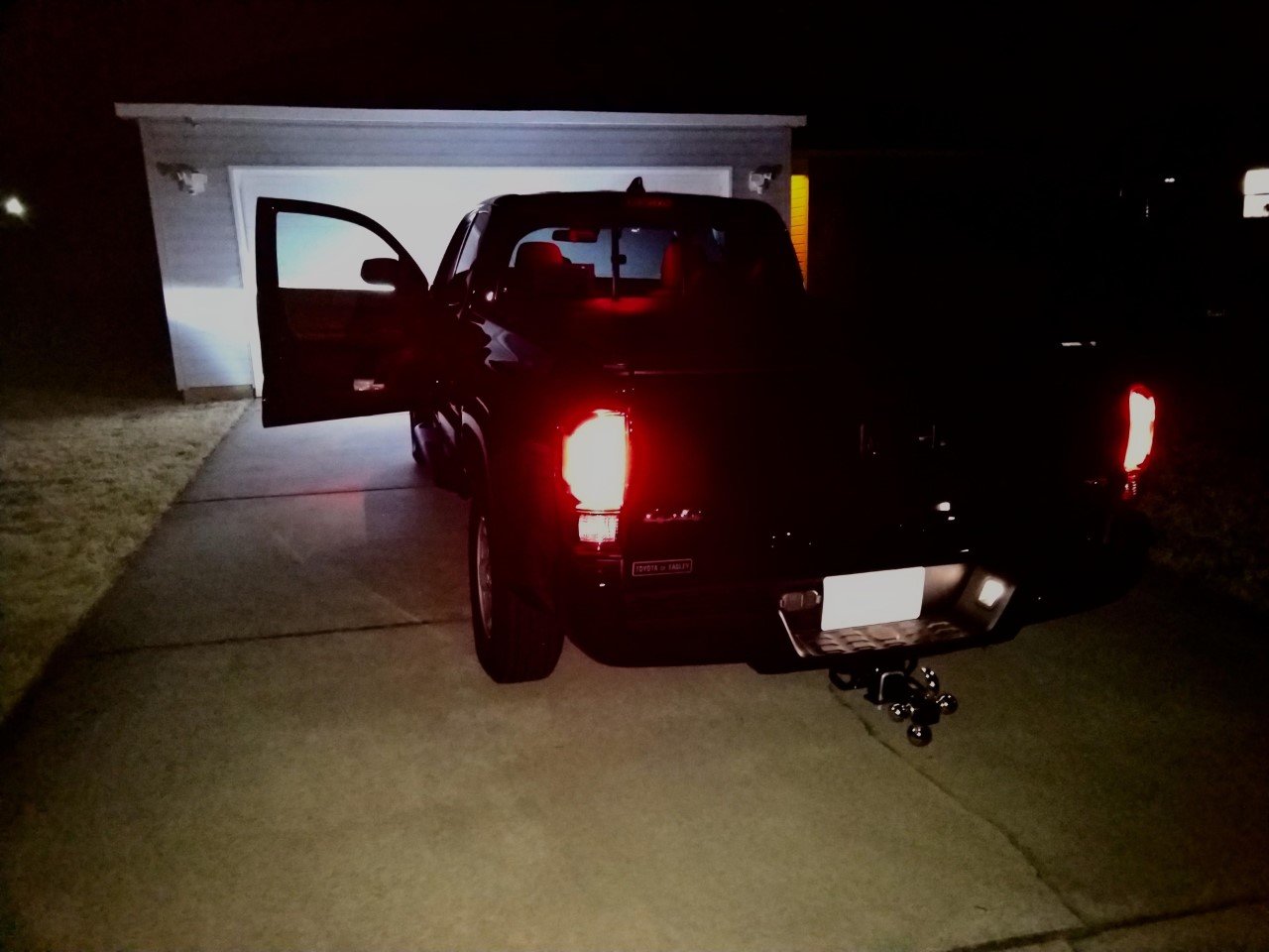

    Some night shots for you guys with lights on "Auto" unlock of course was amber

    I saw the same plug on my 2020 TRD OR and I am curious as to what that is for? Connected to the park lights or some other part of the lighting circuit? I hope someone can answer.
