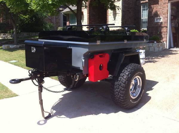

    We only have a rear stabilizer, because the front leg on the tongue of the trailer acts as the stabilizer for the front. See pic below
    Correct, the rear stabilizer bar is not attached in any way to the trailer; its simply placed in the rear, under the frame and as you tighten the lower portions of the legs, it wedges itself under the frame. All it is used for is making sure the trailer doesnt tip backwards while your in the tent. We carry it in the trailer, then when we need it, we pull it out and use it. As stated above, the front is stabilized by the swing down leg on the tongue of the trailer.
