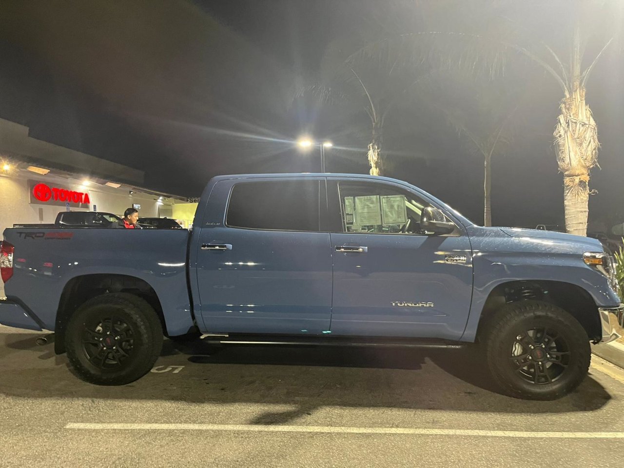

    Hey guys I purchased a 2021 tundra crew max limited trd off road the other month had 11k miles, 33 inch wild peaks trd pro bbs forged wheels and trd pro exhaust and eibach stage 1 suspension
    I’ve owned a few 5th gen 4Runners a 3rd gen Tacoma trd off road and currently still have my 2nd gen single cab 5 speed Tacoma
    I’ve only put a few hundred miles on it and I’ll try to be unbiased as possible
    The fit and finish is almost like a giant Tacoma I do think the soft text or fake/real leather in my limited tundra is better than the softext that comes in the Tacoma and 4Runner premium models
    has a jbl stereo system from the factory which sounds like trash and I’m not a huge audio guy at all and that’s why messing with the settings in attempt to make it better
    otherwise pretty plain which I can appreciate and definitely eons of space larger than my 3rd gen taco was
    now the almighty 5.7, so the allure of wanting to buy this truck in the first place was this motor, 99.9 percent the reason to buy this truck otherwise buy something else. And if you do buy it get the trd pro exhaust trust me on it best sounding exhaust since my ls1 days when I had a borla catback and a flow master
    now for the weaknesses of the motor, obviously the gas mileage is atrociously bad I don’t care what anyone tells you otherwise. Going to work if I keep it under 70 I can get 16mpg which honestly is what I get in my 4cylinder regular cab Tacoma. Going home sitting in traffic I get 13
    now here’s what to really be aware, everyone swears this motor is bulletproof they all mention that one single individual who drove his 5.7 over a million miles but there is one huge fatal design flaw I was utterly shocked by which apparently everyone has a different opinion on…the cam tower leak
    for those who don’t know for reasons beyond me Toyota never used a gasket between the cams and the head instead just using grey silicone, yup that’s right just silicone. As a result oil pools up and causes it to leak on both driver and passenger side
    to fix it the stealership needs to pull out your motor or lift your cab off the chassis and touotas solution? Put more albeit black silicone
    Now here’s where it gets dicey, on tundras.com there are people who get them with their 2007 all the way up to 2021 so Toyota never fixed it, it costs about 2k to up to 7k from your local stealership to fix it and guys have gotten it as low as 5k miles on their brand new engine to at 200k miles
    You won’t notice it until it either gets so bad it (oil) drops down to your exhaust manifold and you smell burning or you look between your wheel wells as it’s the only place to visibly inspect it
    now here’s where it gets really bad, if you have it and even if under warranty you can ignore it or if it’s extremely bad and have no choice to fix it there are countless stories of the stealership fucking up the motor for life as most of the techs have never done it and it’s an extremely labor intensive job so basically you’re fucked no matter what
    now most people will never notice because it won’t drip onto their exhaust manifold and they never heard of it and never check between the wheel wells so is ignorance bliss? I’m extremely neurotic and ocd so had I’ve known have bad of a design flaw this engine has im not sure if I would have bought it
    Don’t get me wrong I love the torque and how smooth it is and the sound of the pro exhaust, it’s a very beautiful truck and a comfortable ride
    For family hauling obviously tundra is a better choice, the payload is actually 200 pounds less than my single cab 4x4 which in all honesty did suprise me, in fact I dunno maybe I expected too much for a half ton but I expected the payload to be at least 2k pounds not the 1185 indicated on my door jam
    The lack of 4x4 goodies suck since it is a trd off road no locker no atrac etc just plain 4hi and lo but I get it this truck is so damn massive and long it really shouldn’t be on anything but some fire roads but there are guys on you tube who wheel their tundras pretty hard so mad respect
    lastly after driving my tundra all week and driving my Tacoma it was night and day how much tighter it felt driving my Tacoma meaning the steeering felt like I was driving a formula one car and the tundra steering felt like I was driving a steam boat down the Mississippi
    my tundra is a crew max so it is a 5.5 bed I would have liked a double cab for the 6foot bed but my Tacoma is a 6foot bed I haven’t used the tundra bed yet so can’t really comment
    in conclusion the tundra just like the Tacoma and every other vehicle ever made has it’s flaws but the main reason I bought the truck overrides it in my opinion (the v8)
