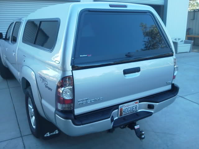

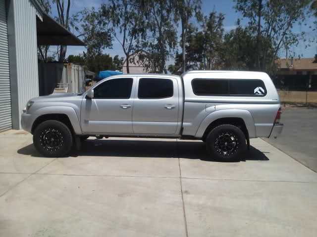

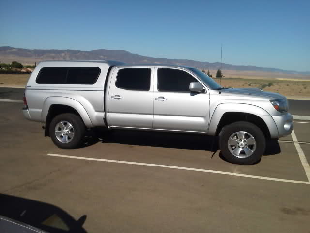

    So after having more cars in the last few years than you can imagine, i finally bit the bullet and spend some big bucks on the truck i always wanted. i purchased a 2011 Tacoma Double Cab Long Bed TRD Sport in silver. the truck is 4x4 and had 15,142 miles on it when i purchased it from a elderly gentleman on the coast. The truck was completly stock, and ready for the transformation that soon came after. First comes first: a camper shell for it. I am a avid hunter for any fowel or big game, hunt all over CA and have a cabin in Montana that i take my bird dogs up to and the camper is essential to keep the dogs comfortable. also i got my Weather Tec Digital fit floor mats for front and rear. GREAT investment! I have no pics of the truck without the camper, but you have all seen them without it so here is what she looked like last week....

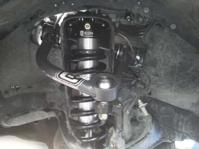

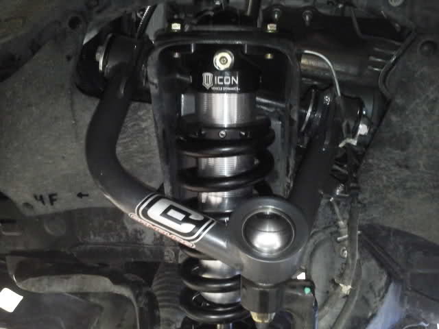

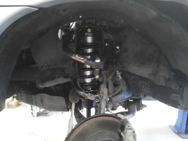

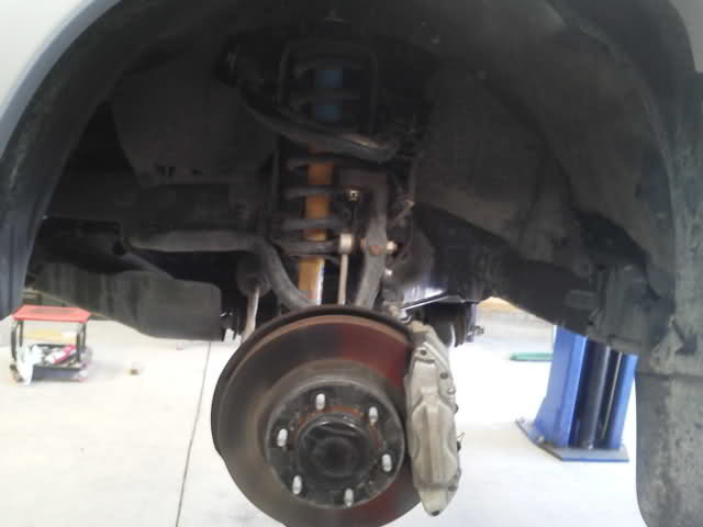

    In the shop on the lift... Ordered Icon 2.5" coilovers, Camburg UCA, Wheelers 3 leaf add a leaf and Billy 5100 for the rear
    Front end with the wheel off

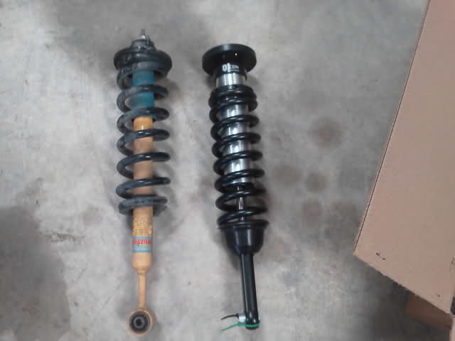

    Factory coils vs new icons

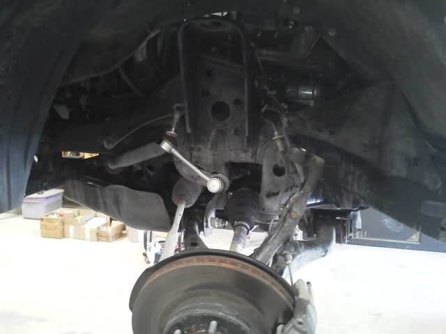

    Front end gutted

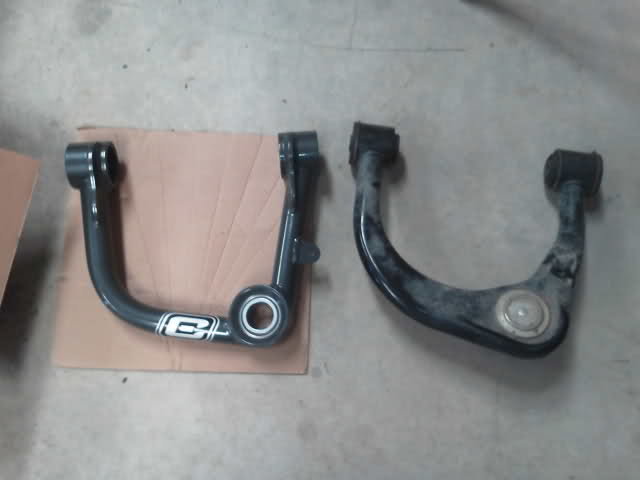

    Old UCA vs Camburgs
    Mostly all in, just buttoning up...
    closer
    and closer...

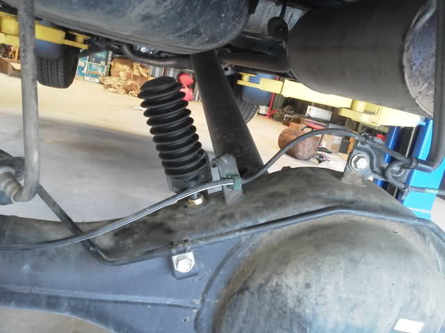

    New rear diff breather from Trail Gear here in fresno
    Lift kit installed, i left the factory overload on the rear with the AAL. I had not researched to much into the rear springs, and after looking here on the forum, i found out about the rear spring TSB, so the aal and rear shocks are going to be coming off soon to get the warranty work with the 4 leaf pack installed.... The front is at the 2" adjustment they came with from Wheelers, waiting from my spanner to crank them up a lil bit more.
    Also notice it has been de-badged and tinted.... looking better and better!!

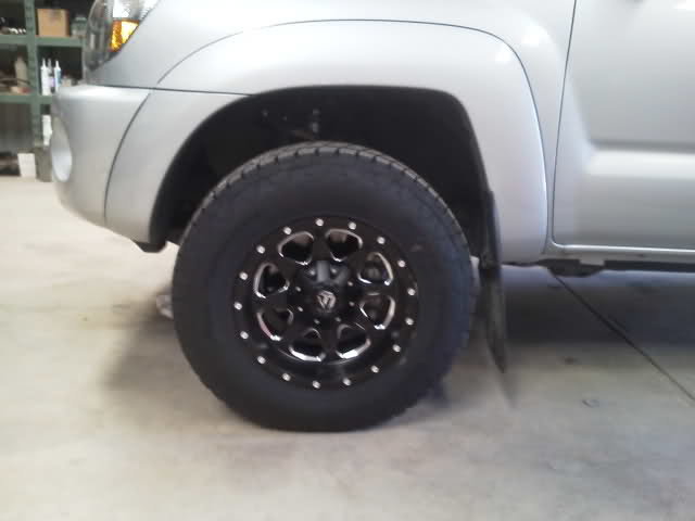

    Wheels and tires installed! Fuel Boost 17x9 with Nitto Terra Grapplers in a 265/75r17. 4.5" Back spacing, and wheels are hub centric so they have no vibration. makes it look to short, still waiting on the spanner...
    New wheels.... i love them

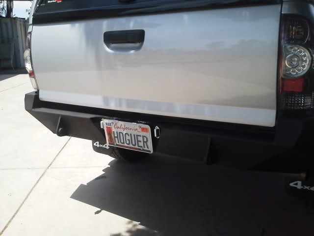

    All Pro rear bumper. Made the mistake of undercoating it. finish is going to scratch way to easy... waiting for sliders and front bumper to take them all in for powder coating....

    Thanks. So far so good. Icons ride a little stiff, and now doing some research I see I might have been happier with a progressively valved coil since I dont do any high speed off-road. My driving is mostly on road and low speed, rocky trails and forest service roads. Hoping the front bumper and winch weight will help a little though. I chose the all pro rear bumper because they appeared to be the only high clearance rear bumper that had a matching hitch available. I was disappointed to find I could not keep my spare tire mounted. I didn't read anything about that on the listing. I'm probably going to cut off and relocate the trailer light mount so I can put the spare back on

    What kind of shell is that?

    Snug top Hi Liner. It is not the most sporty camper shell, but when I'm hunting or camping the extra room is invaluable.

    Awesome build man. Ill be getting a used pair of those icons pretty soon from a buddy. How do you like em?
  12. Jul 15, 2012 at 9:29 PM
    ff.hogue
    ff.hogue [OP] Well-Known Member
    Apr 29, 2012
    #77834
    63
    Redwood City, Ca
    '11 DCLB 4x4 Sport
    and it begins...
    They are stiff. Waiting to get my spanner wrench from wheelers and bringing up another 1" in front and then putting my skid plates on, hoping the extra weight softens the ride. Also going to be disconnecting the sway bar so the front end will actually articulate some. For a DD if I did it over again, I would have just stuck with the ball joint UCA for noise free ride bit increased strength and no alignment issues, and have a progressive valved coil, as I am not ever going to be jumping this truck, mostly fire roads and trails.
