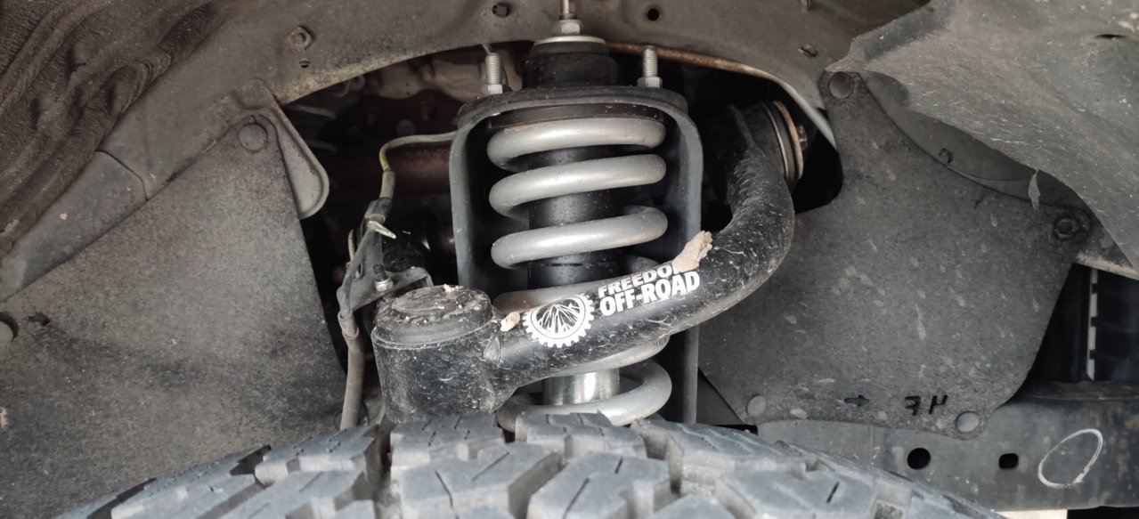

    Just installed them. Driving to alignment shop. It drives better than ever since I’ve owned it since January!

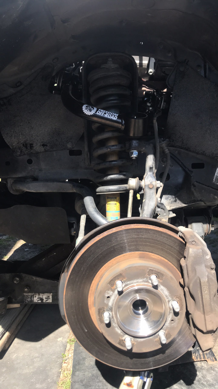

    I just installed these about a month ago with bilstein 5100s.. I’m pleased with them as well.
    Edit to add: don’t forget to pull the rubber covers off and grease the balljoints

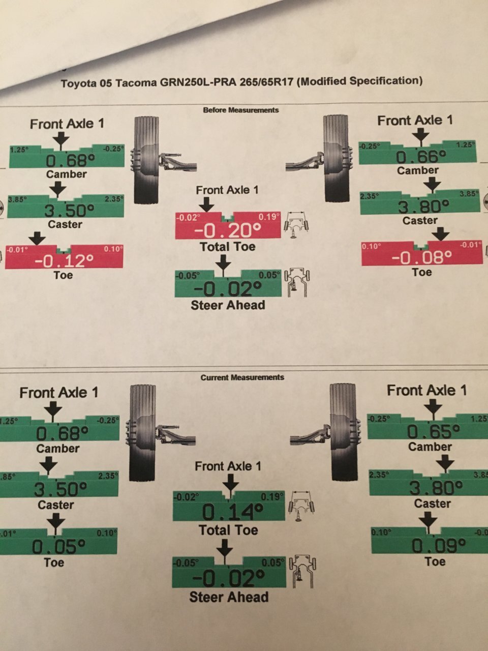

    let us know what caster numbers you were able to get with these please

    I bought these about 6 months ago for my 2015 tacoma toytec lift, couldn't be happier, work great for HALF the price! Congrats!
    Here are my alignment numbers before and after :) I'm rolling on stock Limited wheels, 18" with 265/70r18 Wild Peaks

    For all questions about them look up online for freedom tacoma uca’s installation video. It will explain a lot. ! From what u understand that they are all stock style press in bushings and ball joint
    And the install vids also say to torque them. Will full droop
    And per my alignment guy i didn’t get numbers for caster but he told me it was well worth my money that it made a big difference between stock uca and these uca
    My alignment was done before and after uca install. So he could see difference
