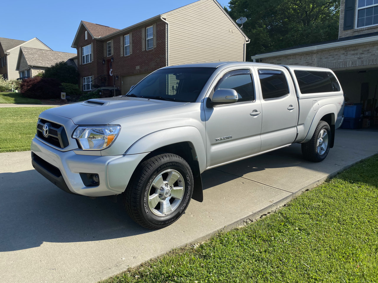

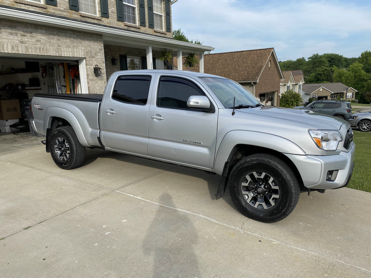

    Here she is in my driveway the day I brought her home:
    I removed the SnugFit topper (sold locally, sorry!) and replaced it with a Tyger Auto roll-up soft top. I stumbled upon a set of 3rd gen OR wheels for a steal locally that I couldn't pass on, so those went on the truck as well.
    Maintenance-wise I had my hands full. After a couple days of driving I knew something wasn't right. Under hard acceleration the truck was rumbling and bumbling quite bit. Long story short, it was diagnosed as a bad torque converter. Cool, now I know why the truck was traded in. Replaced that, problem solved. But while underneath I found a cracked leaf spring. GREAT. Suspension rebuild time as well. I went the whole 9 yards and replaced the shocks and springs with those from a 3rd gen TRD Off-Road, leaf packs, sway bar links, sway bar bushings, inner and outer tie rods, upper control arms, and lower control arms. I also went ahead and did a tuneup (plugs, air filter, cabin air filter, etc) and found that it still had the original plugs with 167k, nearly burnt to a crisp with gaps only rivaled by those found at the Grand Canyon. No idea how this thing was running as well as it was but I suppose that's a testament to the reliability of these rigs. Don't worry sweetheart, you're in good hands now.

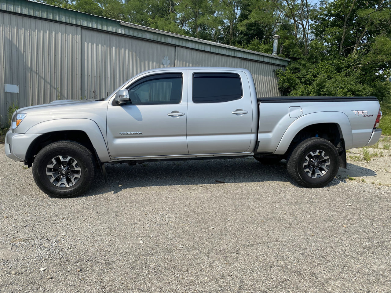

    So here is how she looked at this point after initial maintenance, repairs, and a quick glow up. Just a little different and still pretty boring:

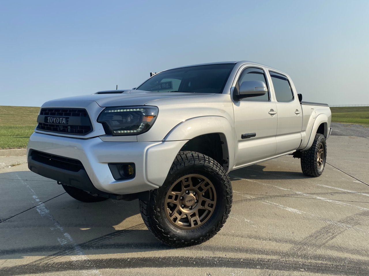

    And this is where the tinkering and modding began! I'll keep an up-to-date pic below, followed by a complete list of CURRENT mods/parts used:
    - 17" TRD SEMA wheels in bronze
    - 265/70/r17 Falken Wildpeak AT3W's
    - Bilstein 5100s
    - Eibach 2.5" Lift Springs
    - General Springs HD Leaf packs
    - TORCH Off Road front diff drop
    - OME carrier bearing drop
    - New OEM UCA's
    - Mevotech LCA’s
    - Mevotech inner tie rods
    - Mevotech outer tie rods
    - Mevotech sway bar links
    - Moog sway bar bushings
    - Alpharex Pro Headlights
    - Diode Dynamics SS3 Sport amber fogs
    - Akkon (Amazon) LED Tail Lights
    - VIPMOTOZ (Amazon) Smoked LED Side Mirror Signals
    - TRD Pro Grille
    - Black TRD Sport badges

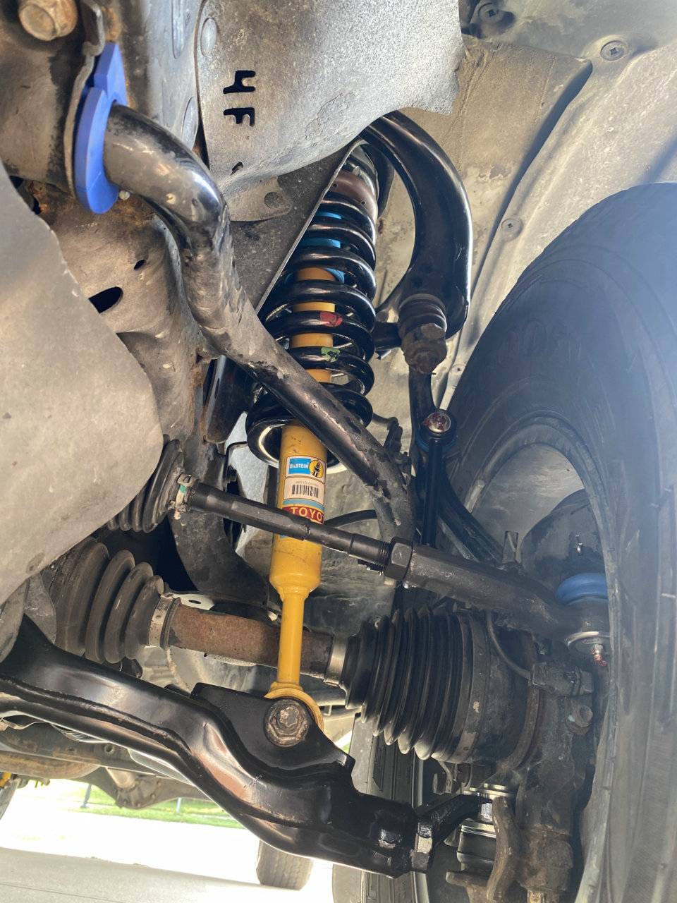

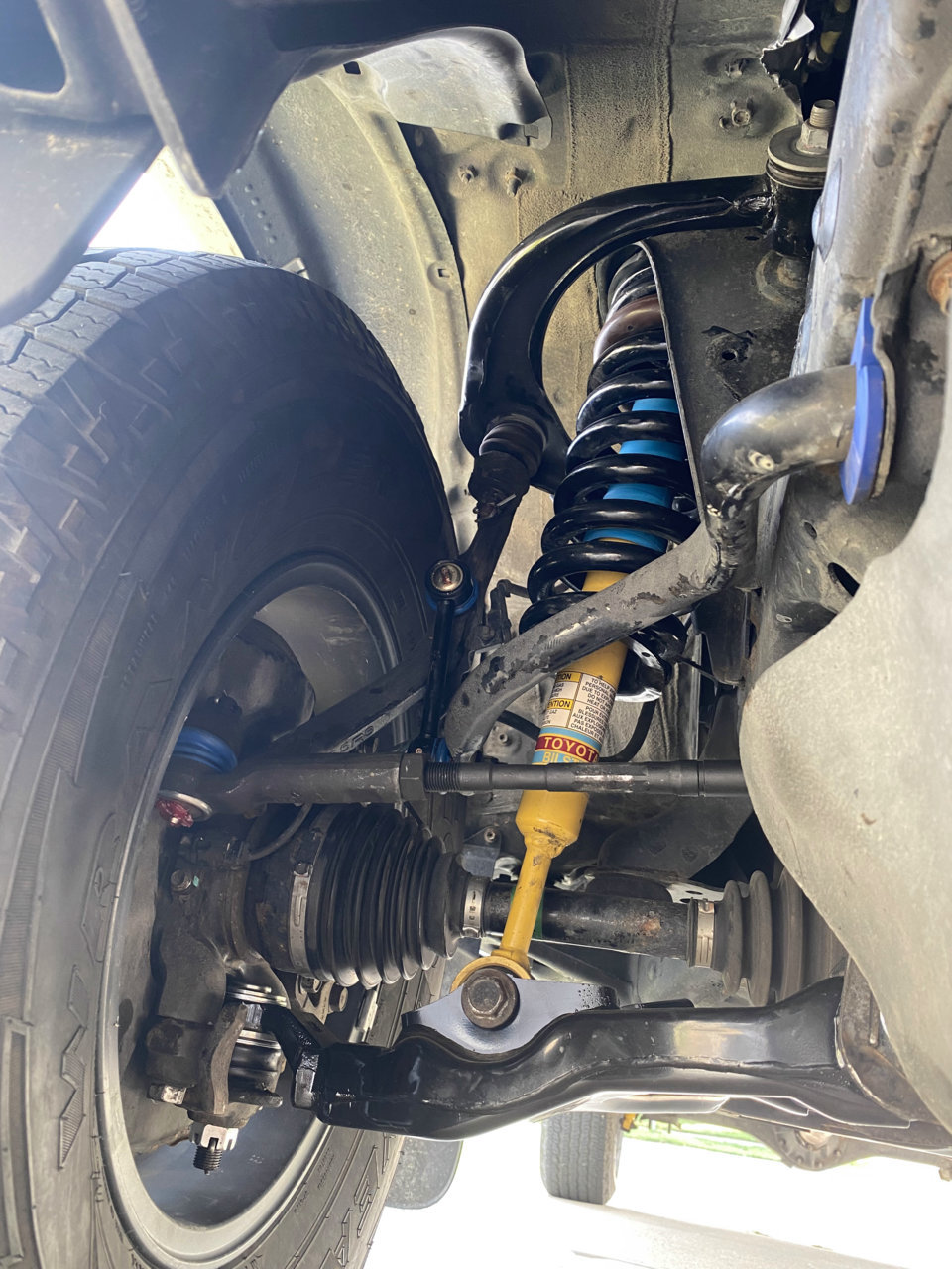

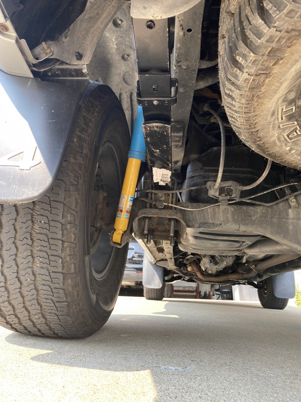

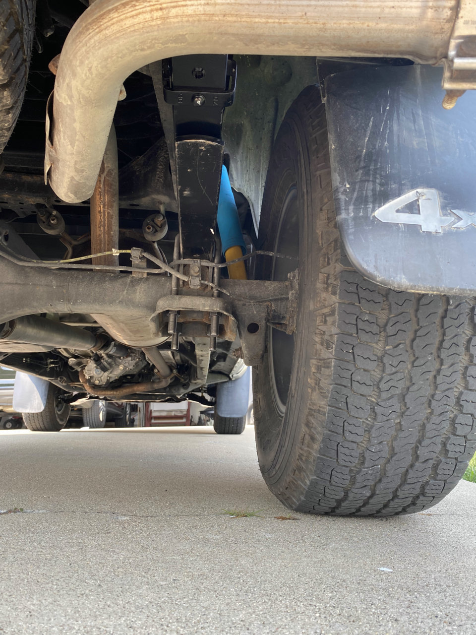

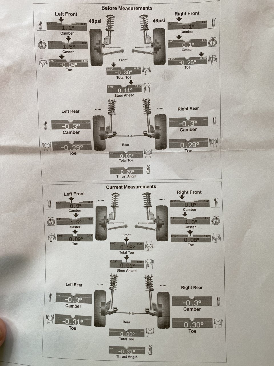

    Suspension rebuild is complete and man, what a world of difference fresh components make! Took a short test drive because the truck still needs to be aligned, but I can for sure feel that it's tighter, smoother, quieter, and it sticks to the road the way that it should. Feels like a brand new truck. I wish I would have taken measurements before and after the install, but by my eyeball guesstimate it looks like I got close to 2" of lift in the front (I added the 1/4" spacers) and more than the 1" lift in the back that I was expecting from the HD packs. I'm sure it'll settle some over time. I don't regret my decision at all to go with the 3rd gen OR suspension, it makes the truck look and drive great for my needs.
    Before:
    After:
    Just look at all the freshness underneath:
    88D4AC9A-8E9F-4608-9B8A-378C08480D6D.jpg C66114E5-3975-496C-A4D1-96731BF4A59B.jpg DBA7E7B1-28F5-4AC8-966F-2DFBF97A94C5.jpg E2C8F942-1A83-40AE-9653-87C08D03A14C.jpg

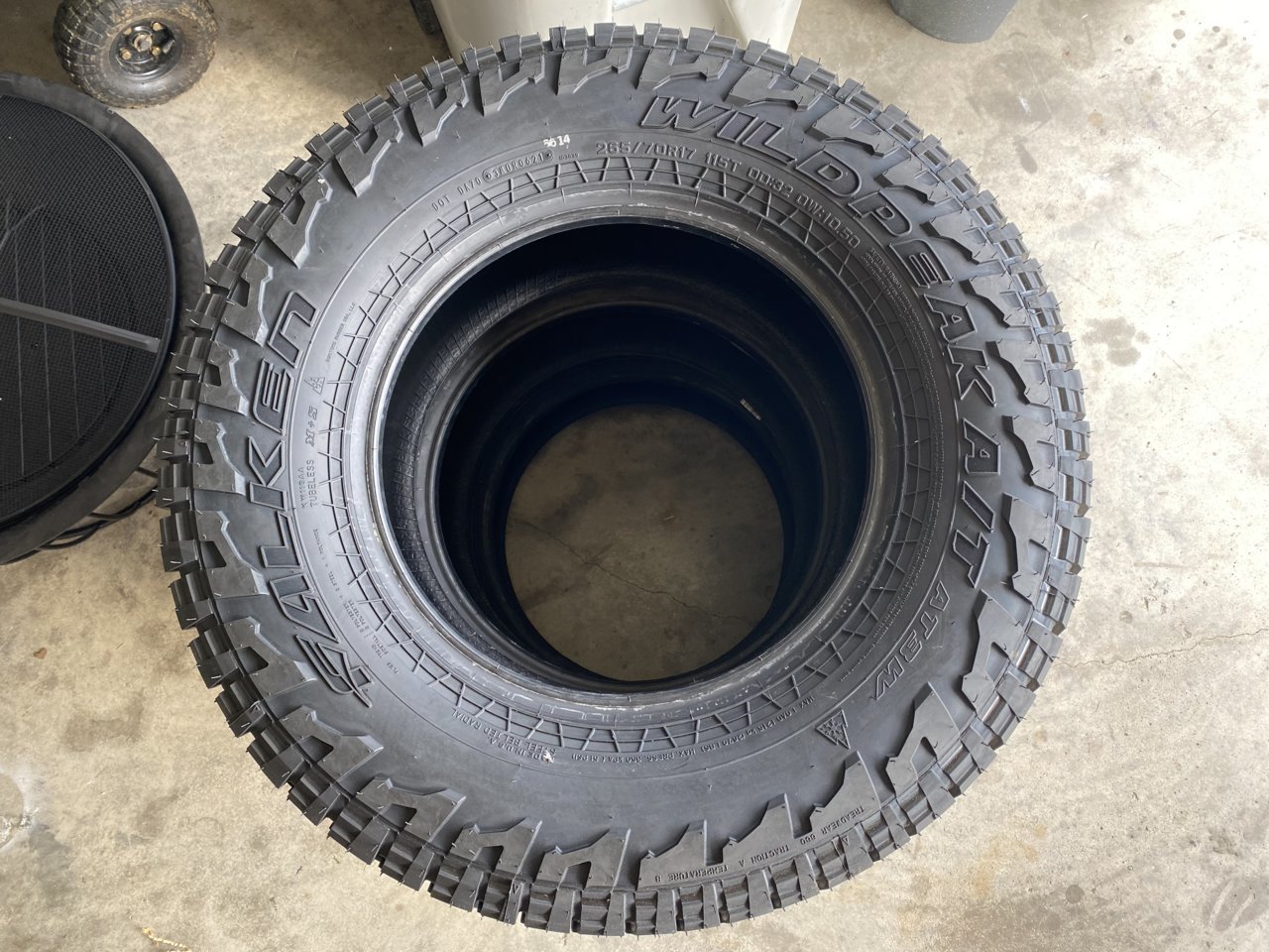

    My wheels are supposed to be ready for me to pick up today, and my tires are supposed to be delivered tomorrow. I'll take them in for mounting and balancing ASAP and wait to do the alignment at the same time.

    That stance looks great!! Were you following a write up on here for the suspension install? I didn’t realize you could do that, where’d you buy your stuff?
    that sounds perfect for me, a little lift but still rides like stock!

    3rd Gen shocks, springs, and leaf packs are direct bolt-on replacements on the 2nd Gen. Pretty easy and straightforward install. Plenty of info out there on this, especially here on this forum. The parts are pretty easy to find as well, either in TW classifieds, Facebook Marketplace, CL, or OfferUp. Most people report a lift of about 1" in the front but they won't raise the rear.

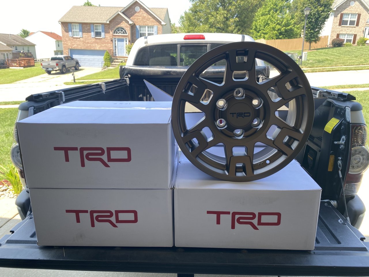

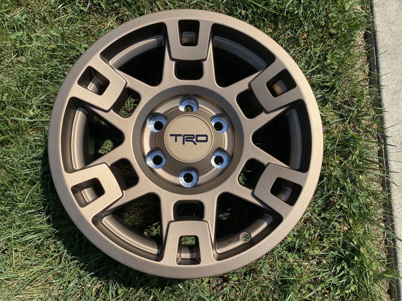

    Picked up my bronze SEMA wheels from the dealer after work today. These boys are SHARP.

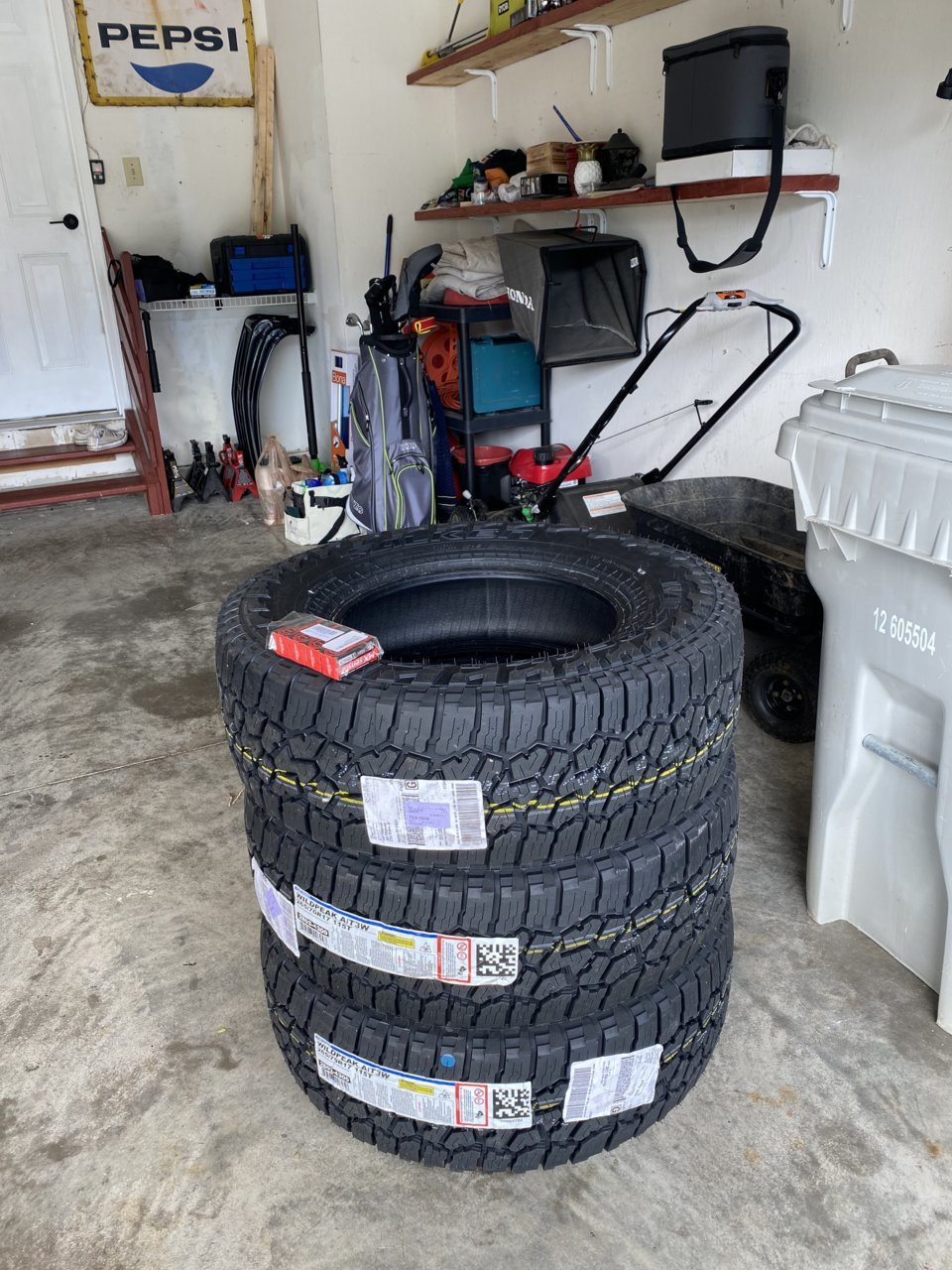

    I was also surprised with a FedEx delivery. Tires weren’t supposed to arrive until tomorrow…but…errr…only three? :pout: Hopefully the fourth shows up tomorrow because my mounting and alignment are scheduled for Friday.

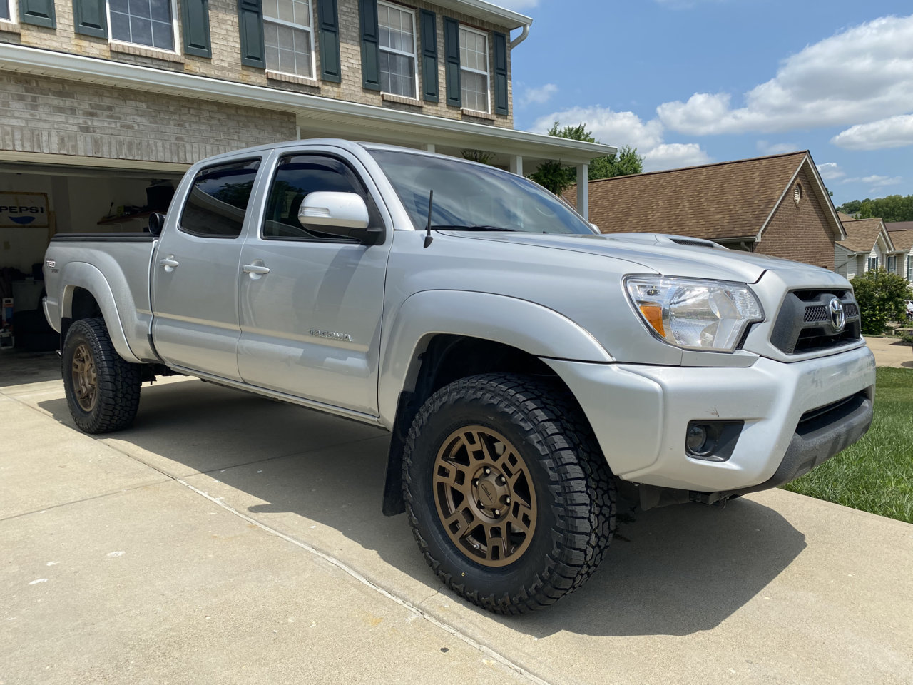

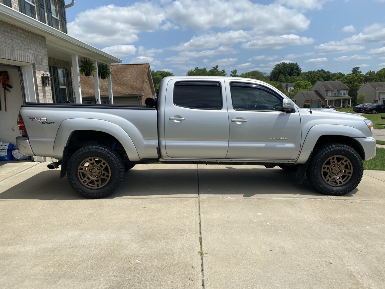

    Wheels and tires are mounted and the truck is aligned. I heard no popping on my short drive home, so here’s to hoping the alignment fixed whatever I was hearing before.
    Nowwww it’s starting to show a little attitude. :devil:

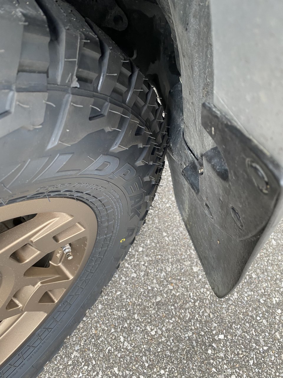

    Mud flaps were going to come off anyway, but I guess it’s happening sooner rather than later!
