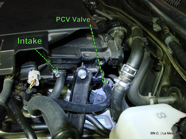

    I recently learned of the merits of the oil catch can from CayucosTacoma's thread here And just about any vehicle with a motor can benefit from one. In short the catch can keeps some seriously nasty stuff from being recirculated back into the intake manifold. I searched for a high quality one and settled on one called the Stealth Catch can from 42 Draft Designs.

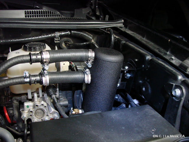

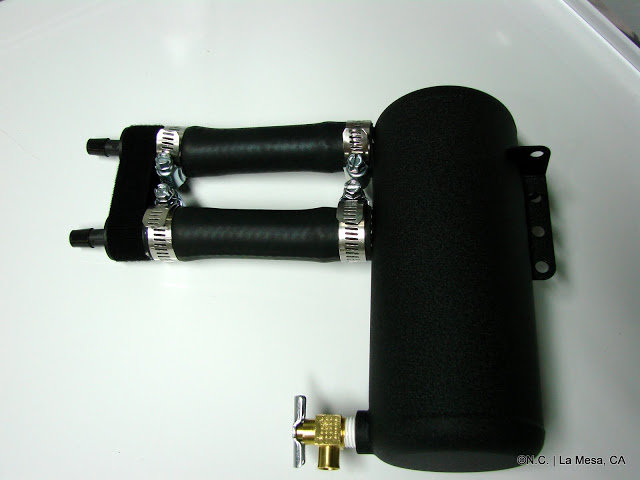

    Here is what the Oil Catch can looks like. It's rather large. The can is on the expensive side, but I do believe it is of high quality and I think you get what you pay for. I think I paid just over $100, and I got it from etektuning.com
    Here is the filtering media in the inside
    DO NOT USE REDUCING COUPLERS LIKE THE PICTURE BELOW. THEY CAUSED AN ISSUE FOR ME. SEE THIS POST FOR DETAILS.

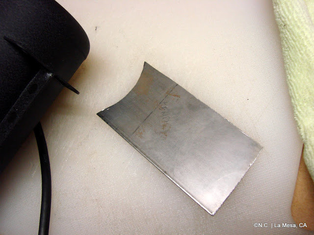

    Next I had to fabricate a bracket. I used 16 gauge steel I found at Home Depot. They stock it in the isle where the angle iron is. Had to search for it as it was sort of hidden and out of sight. I measured and cut the bracket from the steel with a Dremel fitted with a cut off wheel.

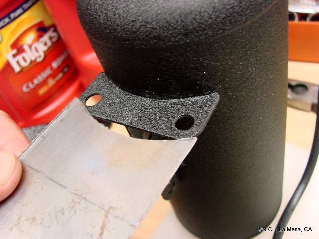

    Test fitting

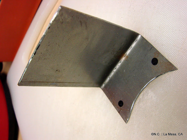

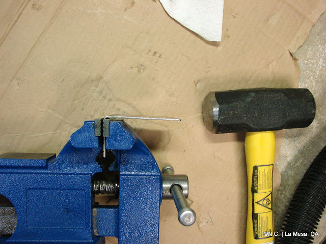

    Test fit complete, put bracket into bench vice and made a nice 90 degree bend with a 4lb sledge. :D

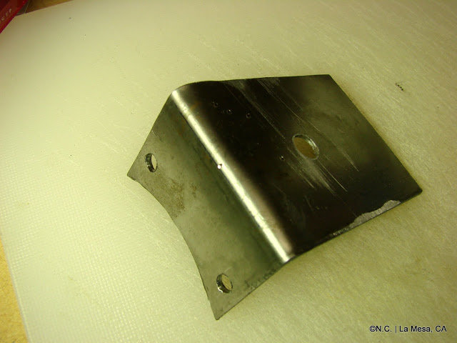

    Hole pattern transferred.
    Holes drilled.

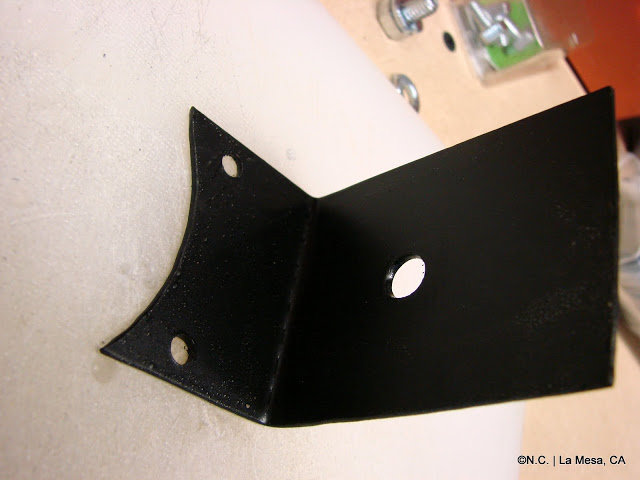

    Bracket painted

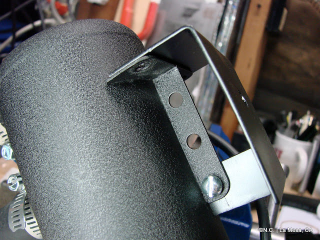

    Additional test fitting and stub piece installed to act as a stand off for more support.
    Hoses routed and installed. I used standard 3/8" fuel line for hoses.
    Catch can installed in final location. I used an existing factory bolt hole. I think the bolt I used was an M7 x1.25? I found the bolt in a box of four at O'Reilly Auto parts.

    I'll have to update my setup with a picture, but the reducing couplers I used were actually problematic. I've since thrown them away in the trash, put some electrical tape on the end of the hose to build it up a little bit and make it snug and put it inside (1" or so) into the catch can inlet and exit spout. I used more electrical tape to secure the fuel hose. No hose camps are needed. I've operated this way for several thousand miles on and off road through cold and hot weather and absolutely no problems. The catch can is also doing it's job of catching shit that would otherwise go into the intake.
