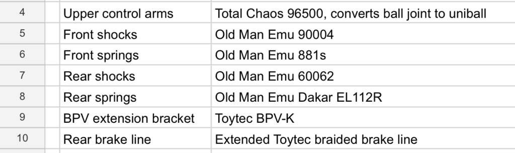

    Yea that’s exactly what I’m running, with the 881 coils and Total Chaos UCAs. Got my kit from toytec but I dont see it listed there anymore.
    You’ll also want a BPV extension bracket and extended rear brake line

    @oldgreg, your going to have to help me with the abbreviations buddy. I got the UCA’s, what is/are BPV?
    Edit, nevermind I see your truck.
    Your running the stock leafsprings?

    BPV = Brake proportioning valve Running Dakars

    Awesome, stock control arms with new OE style ball joints? @oldgreg

    No, Total Chaos uniball UCAs. Don’t know how necessary they were but they kept my alignment in spec without the shop changing anything, so I’ll take it as a win.
    Fixed the screenshot above

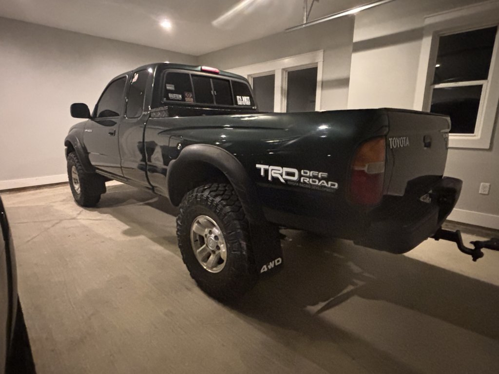

    also left the overload leaf in with the aal.
    it is more rigid in the rear end and handles trailers and loads with out sagging much.
    the 5100,s are adjusted to the 2" lift setting and the rear is 2" higher as well with setup we have.
    the pics i have are with 33' tires.
    no rub and a ride that is firm but forgiving. definitlety not the 'boat ride" feel of stock ride
