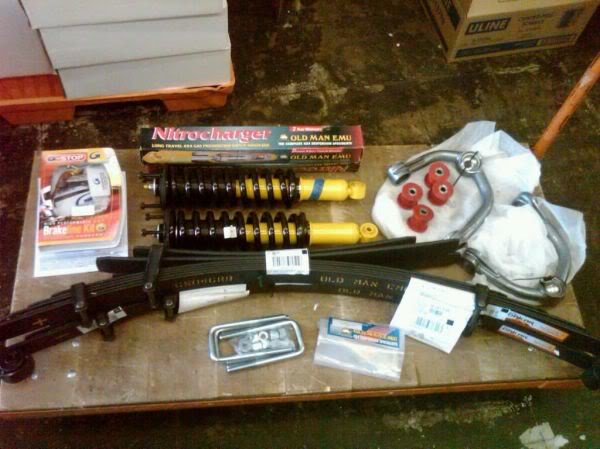

    I'm undecided between the 881 with the top plate spacers or to get the 883 med springs w/ no top plates and also between the AAL or the dakkar leaf pack
    Ill post a picture of the rear leafs, they might be sagging a little, need a expert opinion

    The 881 is the medium spring. I believe that the 883 is second gen. I think that you will find the ride jarring with the heavier 882 springs.

    Deck plate mod, rhino lined, A.r.e. flush glass shell, 265/75/16 Duratrac's, MB72 rims, Full OME lift, Dakars in the rear, Tint allround
    OOk yea 881's it is, Ill just throw it out there, But half the people i talk to say Dont bother with the UCA's and the other half say go with them, id like to save the 5 bills for LR uca's but i dont want shit to be screwed up down the road, since its only a 2.5 " lift, whats the bottom line....

    IMO the ucas are not necessary. I got them because i liked the boing and well because i am stupid. I was terrified of overextending a ball joint, I since. Discovered that was highly unlikely. They do look nice though.

    883 springs work on both gens and were designed for both as well. They aren't exacty Cadillac ride worthy on the street if you don't have extra weight up front but I would do it the same way if I had the chance. The 881 springs and 883 springs are the same height but the 883s have about 50-60 lbs heavier spring rate. The 882s are 20mm longer than the 881s but have the same spring rate. Hope this helps

    Bilsteins are a stronger monotube design that will resist fading much better than the twin tube design of the nitrochargers
