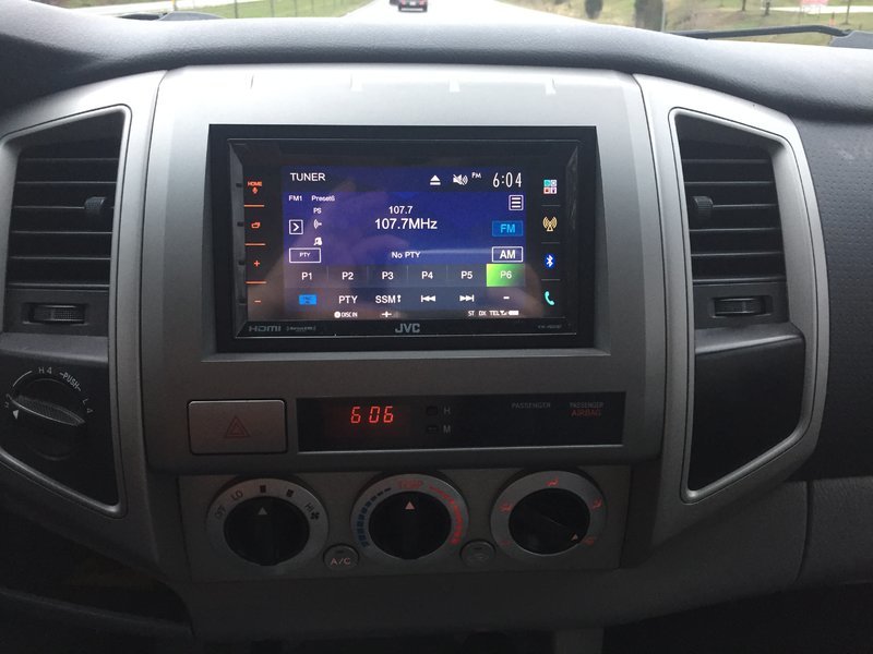

    okay a few comments about the radio... i love it! i picked up at the apple store the lightning-HDMI AV adapter and connected it to the radio, now the radio mirrors whatever is on the phone, i can watch youtube videos and hopefully stream my direct TV to it from the direct tv app (untested as yet) right on the radio and since i have AT&T, the direct tv app uses NO DATA! the radio is windows CE (i believe) based and the menu/functions are very intuitive, super easy to navigate. the manual is very clear and concise, easy to understand. this radio is LOADED with features, im still learning.
    the amp... i wanted to be able to add some power besides the HU power for the component sets i will be getting, and because we all know there isnt much real estate in our trucks for a bunch of amps i decided a 5 channel with a small footprint would suit me best, this one has 75w x 4 RMS @ 4 ohms and one channel for the subs that is rated at 600w x 1 RMS @ 2 ohms, PLUS... its 1 ohm stable (i have no idea what i will output @ 1 ohm). since i have 2 DVC subs with 4 ohm voice coils, i can create a 1 ohm load on the amp.
    the headunit install kit went together very nicely as well, very simple and looks great, i had read other people saying their flasher switch and stuff didnt work well with their install kits, my flasher and clock install perfectly and works good.
    NOTE: i was a little concerned when i went to slide the radio assembly in, i started plugging in connectors and ended up with one left over factory connector from the factory radio that goes to nothing now... i have no idea what it did, but everything seems to be working fine.

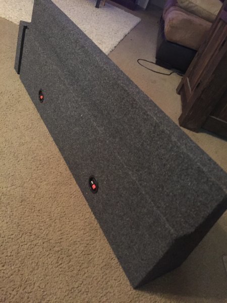

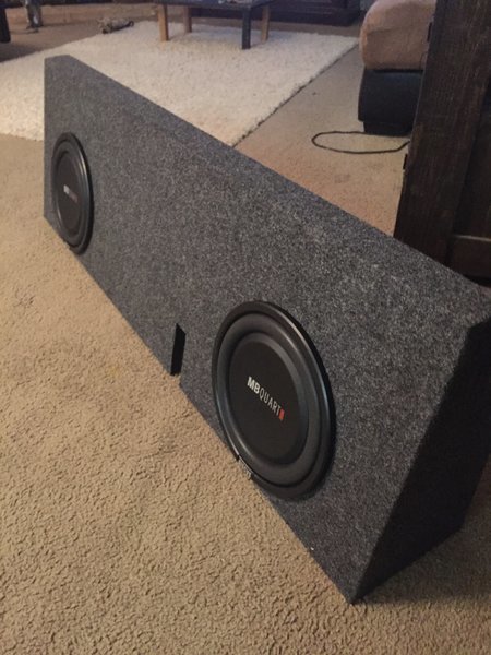

    The sub box showed up today, it has some very specific looking notches and recessed places. I hope it fits the truck as nice as the subs fit the box.

    I hope the box works out for you. How's the box in person? What you expected? Looks decent in pics.
  11. Mar 8, 2017 at 5:03 AM
    TacoSupremeo
    TacoSupremeo [OP] Well-Known Member
    Jan 13, 2017
    #207427
    274
    Michael
    2005 Tacoma Double Cab 4x4
    i was actually very impressed, the quality looks nice, good MDF, nice sealing, nice carpeting (i know that means nothing to function, but its nice, lol) all in all it looks well thought out, we will see when i try to install it, right now its in my back seat. sounds good, no rattles so far.

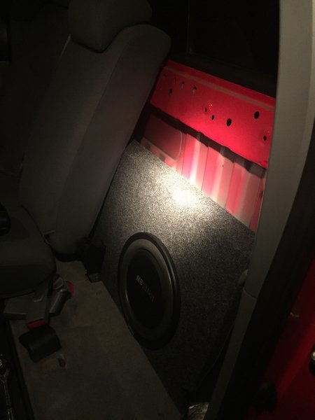

    Not a great picture, but you get the idea. First step is to remove both rear seat backs, then remove the inserts behind the seat backs, slide the box in (don't forget to connect the sub wires), remove the rear panels from both seat backs, then reinstall the seat backs... done.
