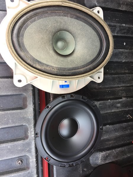

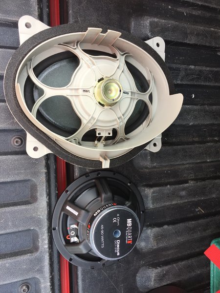

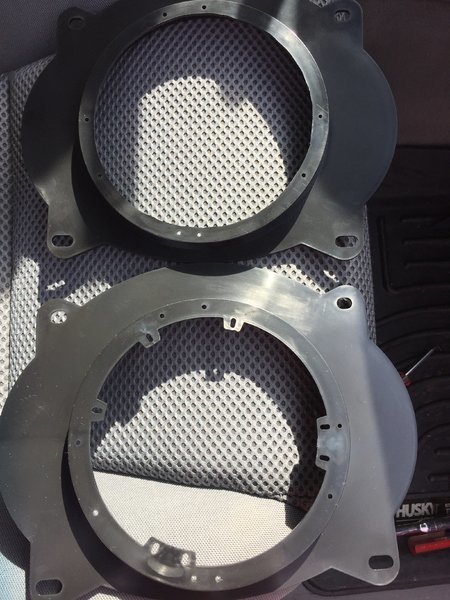

    Update: everything finally arrived for the front step speaker replacement. First, i an SHOCKED at how crappy the factory door speakers are, the magnet on the factory tweeter was larger than the one on the woofer. Here is a comparison of the stock woofers to the MB Quart replacements.

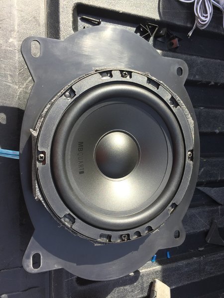

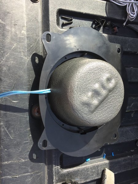

    I ended up having to remove some material from the adapters for the woofers to seat and fit properly using a dremel with a sandpaper roll, but all in all it worked out well. Basically removed those tabs and about another 1/8" around the circle.
    I also used some foam baffles to protect the speaker from the elements and ended up with pods to install like this.

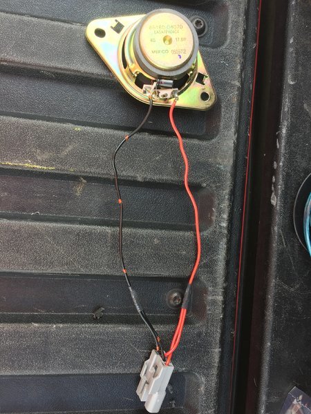

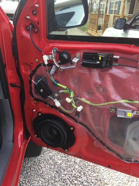

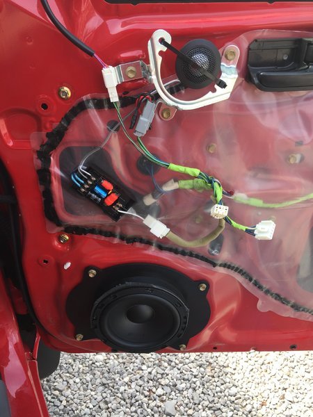

    I know I am a little anal about a lot of the stuff I do, friends make fun of me all the time, but I got a little ghetto with my tweeter install, I wanted simple so one zip tie each did the trick. Lol!
    As you can see, I found a place behind the door panel where there was room for the crossover, so I basically made some slits in the plastic barrier and touted the wires thru the slits which hold the crossover in place.

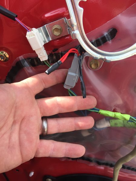

    I found that the stock harness went to the tweeters first and there was a connection in the tweeter harness that fed to the woofer below, so I basically clipped off the lead the went to the old tweeter just past the shrink wrap and taped it off, then below at the wire going to the woofer I plugged in my wire adapters and routed the wires to the crossover, then from the other side to the new woofer and tweeter. IMG_3491.jpgIMG_3492.jpg
    And the completed install...

    FYI, the old tweeters make great mounting points for the new tweeters. basically just need to remove all teh tweeter material from the bracket and mount the new tweeter to the bracket.
