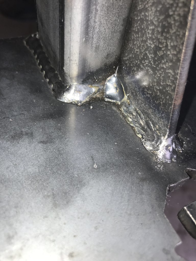

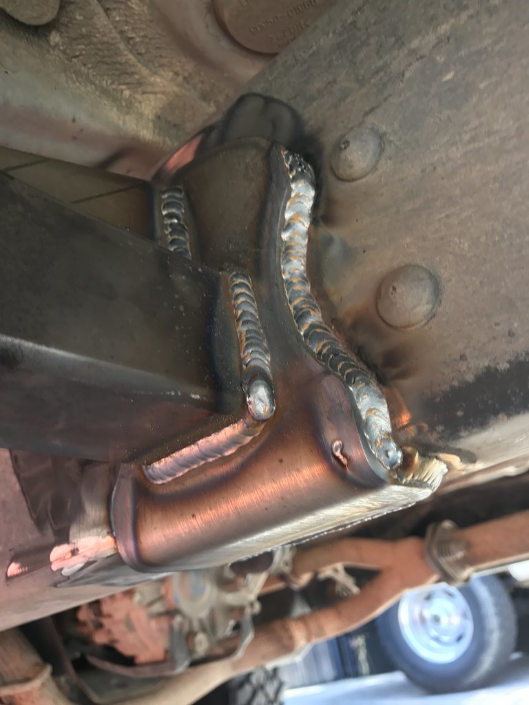

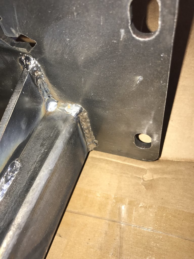

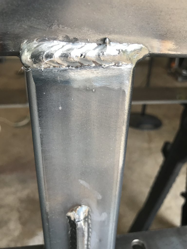

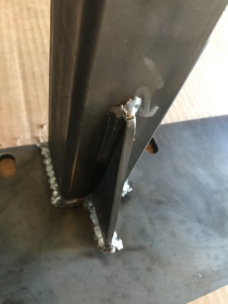

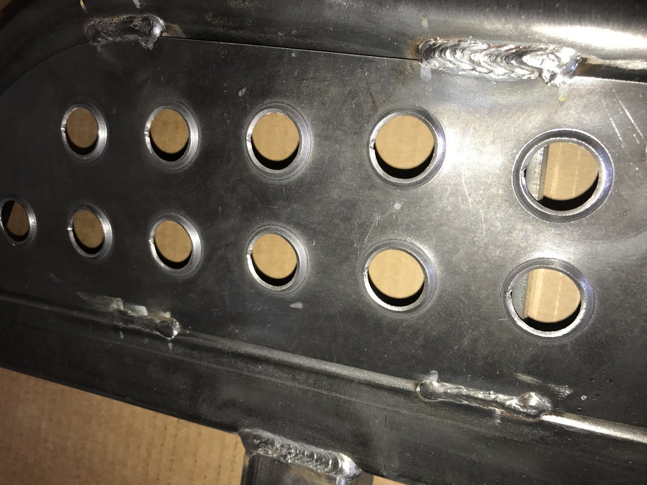

    It has also become apparent that the build quality on the sliders I received is mediocre at best. I'm not a professional welder, but I noticed the welds on my sliders looked messy. Everyone who has seen these pictures agrees. I emailed Josh a few of these pictures on June 12th, looking for an explanation on why my sliders have questionable welds. I have still yet to receive any response from RCI. I have also attempted calling with no answer and no returned phone calls.

    For the amount of time they had to build your 5th gen sliders, they are poorly done! As you said much room for improvement or at least more attention to detail.

    My 13 year old welds better than that shit show. Hope it gets resolved for you.

    Wow those weld look like shit! I can weld better than that...those are some cold ass trigger beads.
    Glad I went with bamf

    Thanks again everyone for the support and replies. How much do y'all think these welds question the durability and functionality of these sliders? Should they still be safe to use as a hi-lift jacking point? (RCIs website states they are a suitable hi lift point)

    I wouldn't trust the welds on the legs
    Btw these welds on mine were done by someone who is not even in the welding industry and welds just for fun.....this is what I would expect from rci if not better

    wow I would expect at the very least a response, and yea, those welds probably wont last, doesn't look like very good penetration.

    Former AWS CWI checking in here (American Welding Society Certified Welding Inspector).
    The pictures may be a bit misleading. Those welds aren't horrible at all. I see maybe a couple rejectable discontinuities, but nothing that I would flip out over.
    The worst might be the welds at the bottom of the first picture, but they're out of focus so I would only be guessing at what they really look like.

    I don't like those welds.

    Agreed....looks like dog shit. MIG welding isn't exactly rocket science
