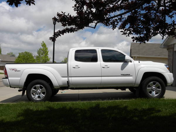

    On the way home i could notice that it was indeed a bit stiffer but not bad at all, actually more happy with the ride. i could also tell that it was taller. Wich is also good cause i am not initially planning to put on the TSB AAL from toytec.

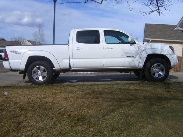

    I measured and took pictures before and after. here you go....
    fr left before 34 3/4" after 34 3/4" fr right before 35 after 35
    bk left 36 1/4" 37 3/8" bk right 36 1/2 37 1/2"
    Back left difference 1 1/8" back right difference 1"
    Here are the pics
    Before:
    After: (also notice the front windows tinted to match the back)
    So there you have it. i have to say that boulder toyota has been nice to deal with so far and that it pays to be educated on the issue and also to have the TSB in hand when you go. i dont know if having my friends in the back helped or not but it didnt hurt. i did see the imprint of the bump stops on the leaf so i'm sure they saw it too. hope this helps someone else.
