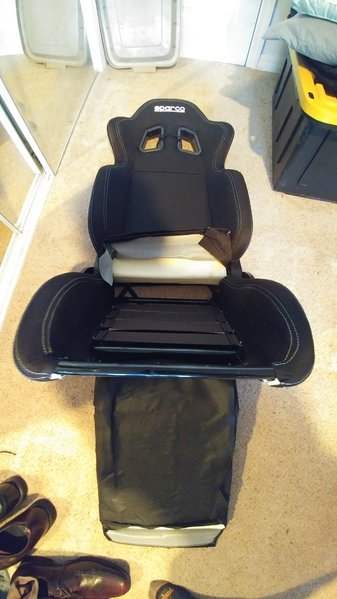

    The seat heater arrived, installed it in the seat then went to town getting it into the truck.
    Bolted right in just like stock. Lost maybe an inch in height but feels comfortable.
    I also gained some room behind the seat since it's not as thick as the stock one.
    The whole assembly i would say is roughly about the same weight as the stock one. A lot less bulky, probably a few pounds lighter but nothing to write home about.

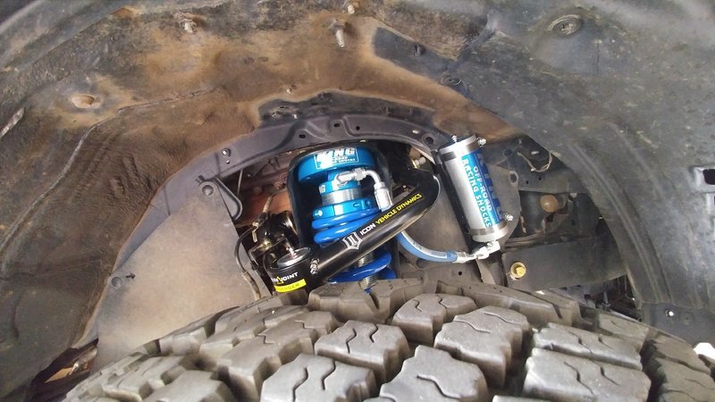

    Installed the extended 2.5 Kings front and rear as well as the icon Delta joint UCAs. I figured since the suspension was going to be pretty well dialed in, i would ditch the sway bar.
    Install went well, minor bending of the fender wells and both UCAs went in pretty easily compared to stuff I've heard. Thanks for all the help!
    I set the fronts at about 22-1/2" fender to hub.
    Driving it up the canyon it definitely has the initial sway but then seems to lock it up and not go very far. So it'll just take a little learning.
    I bombed up the driveway at a very good clip since it's dirt and also decently rough due to getting torn up by the heavy snow storms and quick runoff. It was MUCH smoother, and the sway was there and I'll have to get used to it but I'm pretty thrilled with the difference on dirt.

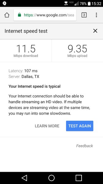

    Went to AT&T and got it activated. Popped it in and it worked! It'll be $25ish/mo after taxes...a steal for unlimited data. Going to a corporate store is advised, 800 number was quite a waste of time.
    I think this'll be plenty good for my needs. Sure it'll go up and down depending where I'm at. That was in the bottom level of the belmar parking garage.
