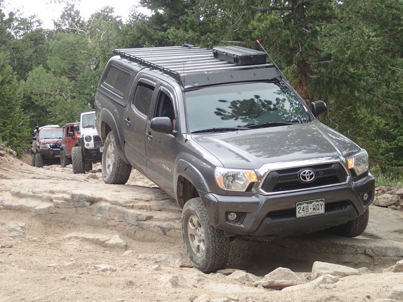

    Prior to the Taco, I had a 98 Cherokee lifted a few inches, rear locker, 33's and just finished an OBA setup utilizing the stock a/c compressor which was very impressive. I do miss it... since I couldnt care less about breaking or smashing it into something. I purchased it mostly done although it had 35's with no room for suspension travel and 2" spacers which came off as soon as I had the chance. Tore out a hundred feet of old wiring and cleaned it up, added a badass roof rack and then needed a pickup truck.
    I did not want to give up exploring the back country (or I would've went with a silverado/sierra), so my only option was a Tacoma. I wasn't thrilled about the crappy gas mileage and power for such a little truck, but... oh well.

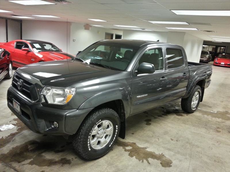

    The night I picked her up... 6 miles on the odo. Tried to trade for the Stingray behind it since they were the same color but no dice.
    The next night, I picked up a topper, and on the way home from skiing not long after I was killing time looking up roof racks, saw a group buy on a Prinsu rack... and since it was on sale, of course I needed one.
    Looking back, I wish I would've went with the HD bars that are black... but oh well (for the black color, strength of these has been fine). Its a great functional rack.
    I also swapped over the CB setup from the Cherokee which just so happened to be the one radio that also fits in the center console of the Tacoma. Strange how that pans out. :)
    First trip out to Utah, SW of Goblin Valley.

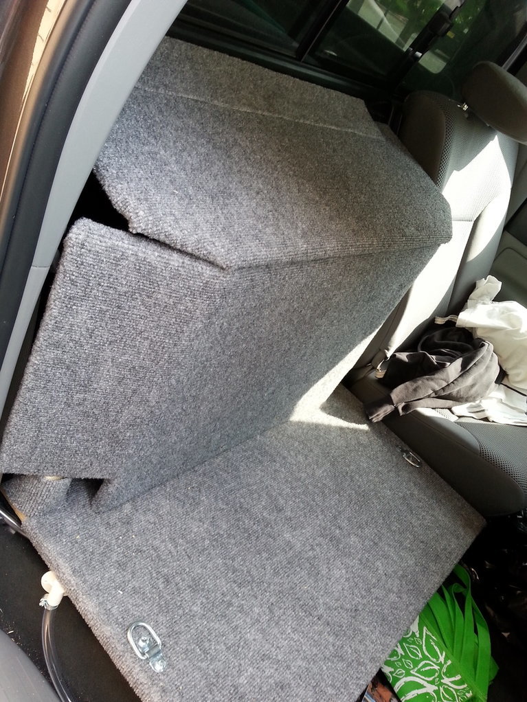

    Next up was the on board water setup. I didnt really see a need for all the rear seats, but needed all the bed space, so the water tank setup went in place of the rear passenger seat. It will serve an additional purpose as a spot to mount a fridge which I will most likely add this coming year.
    12 Gallon tank, faucet and hose are located in the bed for washing off bikes, dishes, refilling water bottles. I use it SO much more than I ever imagined.
    Waiting to make the final climb up to the top of Red Cone. Yes the antenna is way too tall, if anyone has a 3' they would like to swap out for the 4' I would be more than happy. It was originally mounted on the front bumper of the XJ so thats why its so tall.

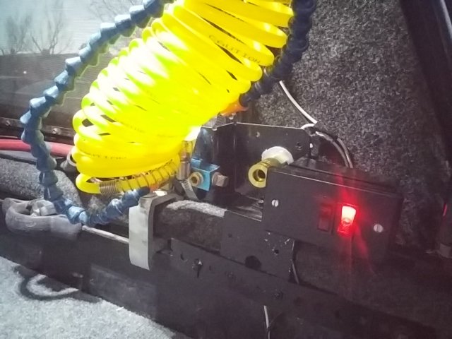

    Shitty picture of the OBA/OBW distribution center. Switches for the water pump and the bed lights.

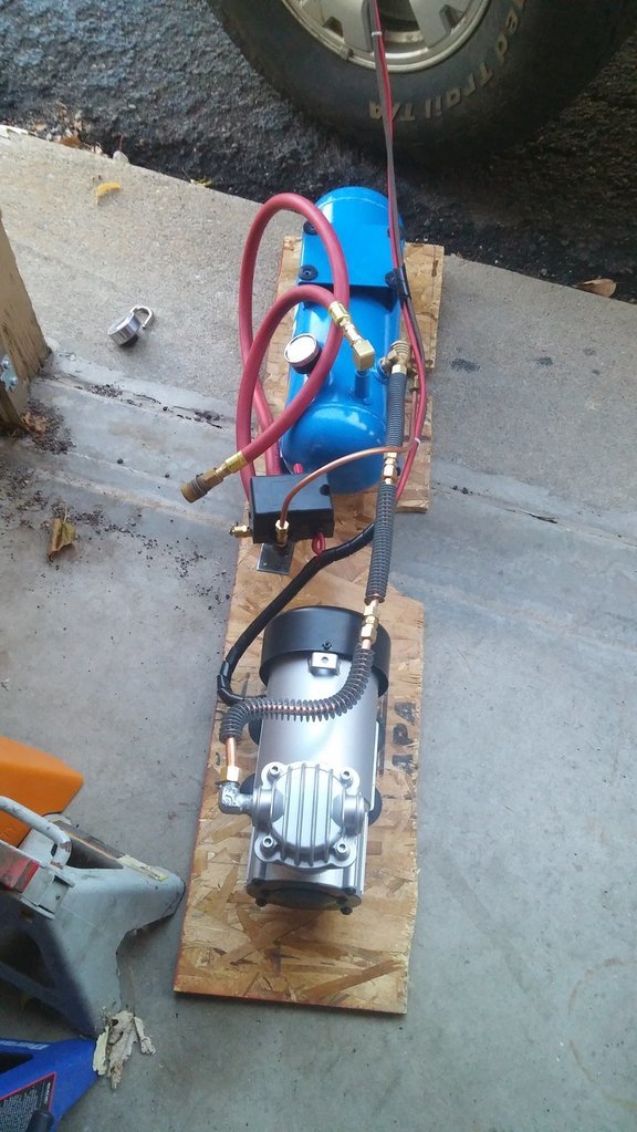

    Testing the OBA setup prior to mounting it in the bed. Puma PD-1006 air compressor, 1.5 gallon tank. Its very fast at airing up the tires. And very quiet, inside the truck with the truck running, you have to listen pretty hard to hear it running.

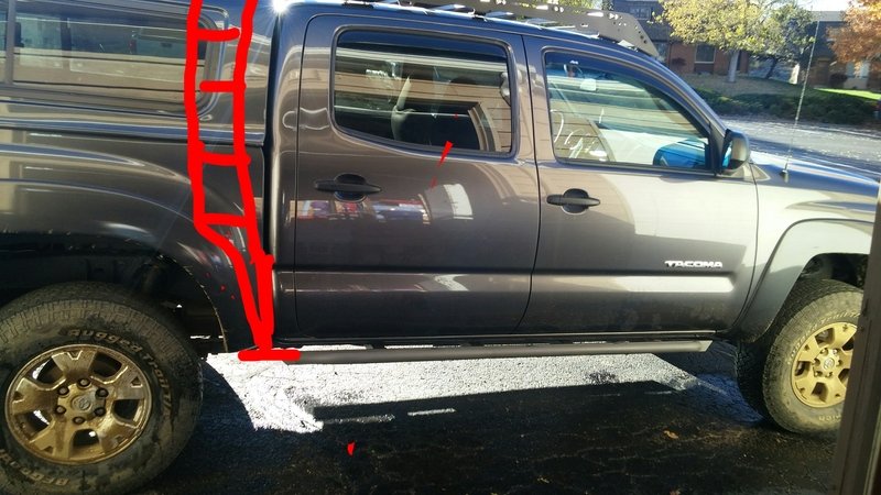

    No problem... I would like some sort of ladder up to the roof rack, but there's nothing to attach the lower part to. If it were to connect to the rear of the slider kick out and then to the rack on the topper, the issue would be the different flex between the bed and the frame. Unless there was a simple solution to make one side of the mounts have some give to them.
    Like a u-channel that would slip down from the top over the side rail of the roof rack with rubber between the metal to keep it tight but allow it to shift. Hmmm.
    Something like so... Nice and tight to the truck. The lower mount would need to go horizontal for 6" or so to the rear to not get in the way of the door, then just shoot up to the rack.

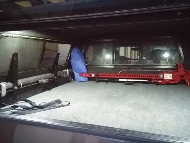

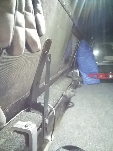

    In preparation for the maxtrax arriving, I built mounts for them.
    And these are my bed lights in use. Its just two small 4 LED pods leftover from my rock lights.
    I'll bend the inner ones to where I need them once the Maxtrax arrive and then they'll be secured with a bungee.
