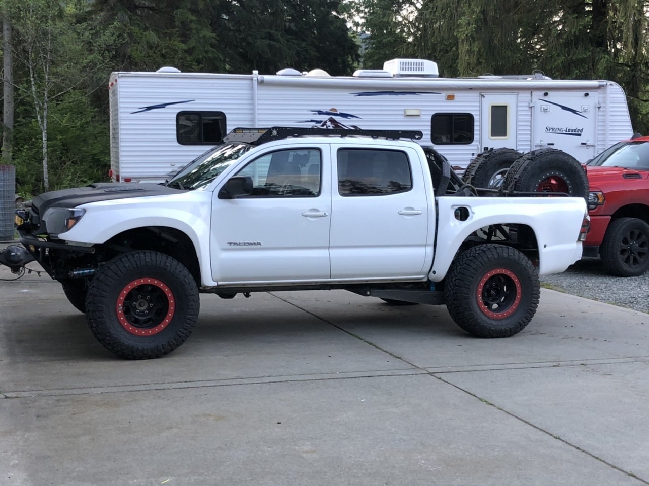

    Update April 2022:

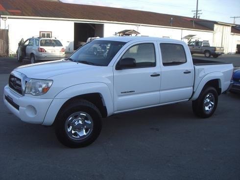

    I guess I'm finally gonna post a build thread for my truck. First the hashtag was my buddy who can't spell, but apparently I'm the only one who's used it on instagram so I'm sticking with it. I bought this Truck 11 years ago with 160k miles on it for $11k. It was used as a Penske fleet truck. My thought was since a similar year truck with low mileage was almost 30k i could have toyota replace the engine and transmission for still less than another truck. Luckily the engine lasted me this whole time all the way to 269k miles.
    There she is the day i bought her.
    I will keep this first post updated with how shes going as i get more pictures uploaded....got about 10 years worth on my laptop i need to sort through.

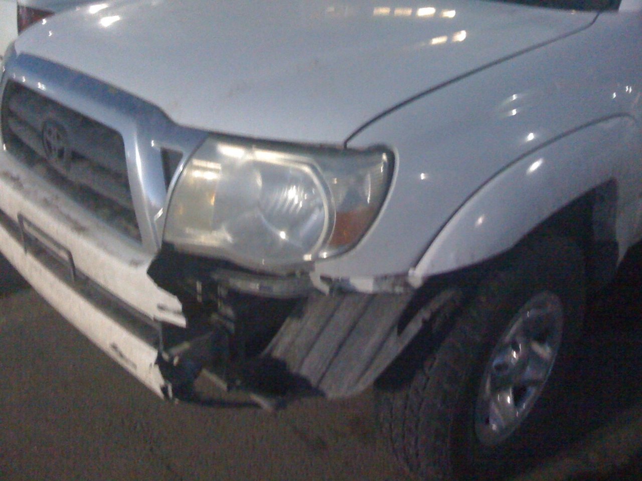

    And the first thing i really did to her was slide her sideways across I80 and hit a cable gaurd, turns out the tires it came with were shit in any kind of slick condition.
    But luckily for me i was able to find a white bumper on ebay and have it shipped via greyhound and was able to swap it out in the parking lot of my housing so it didn't look terrible for the remainder of my school.

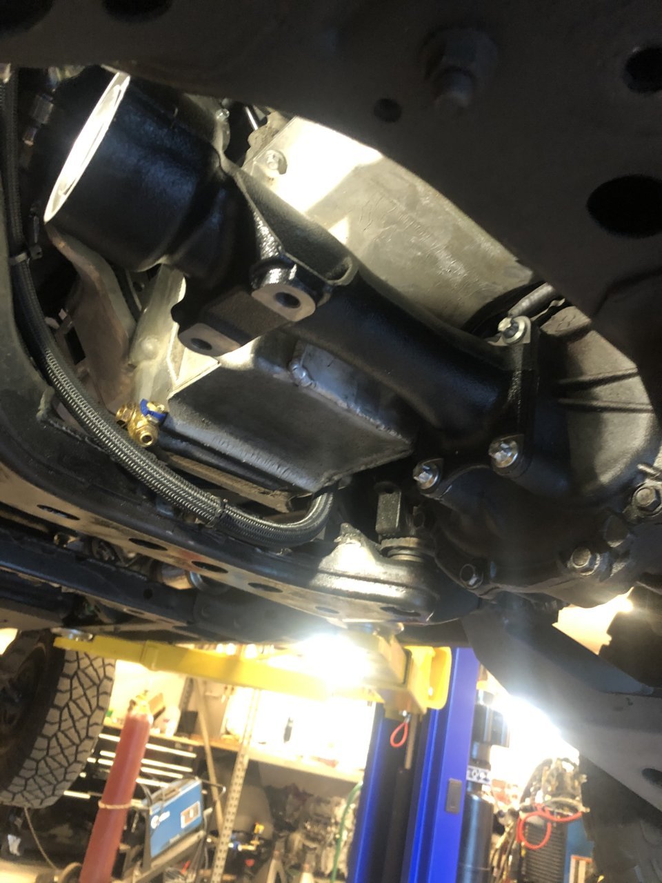

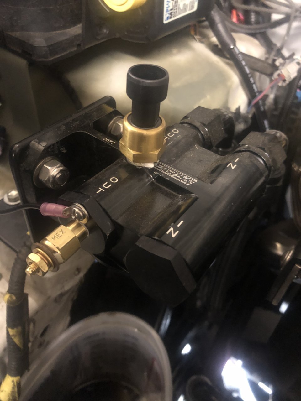

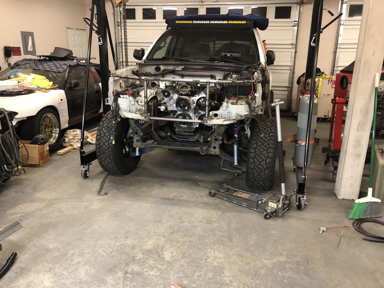

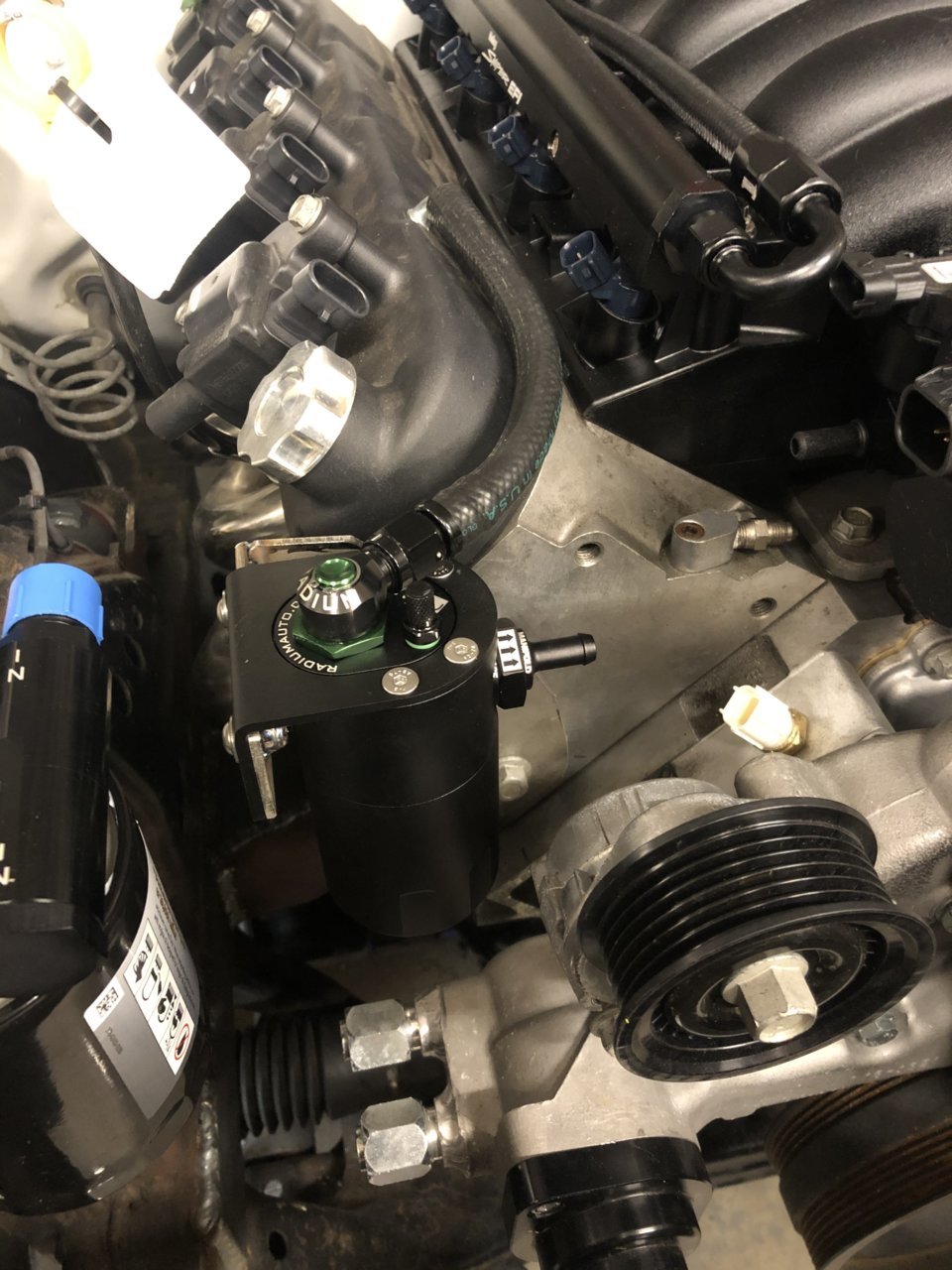

    Little Picture Dump update from when i did the Engine swap back in Dec/Jan of 19/20
    dborrer, Hayrider, Slashaar and 6 others like this.

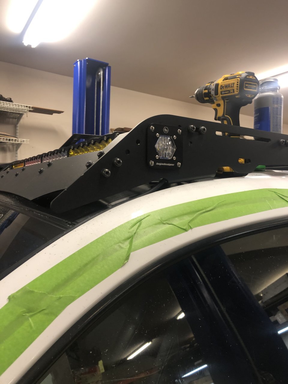

    Threw a PRP Seat in the drivers side
    And installed some Baja Designs S1's in the side of the prinsu rack

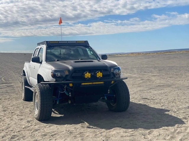

    And an Obligatory Moses Lake Dunes Pic

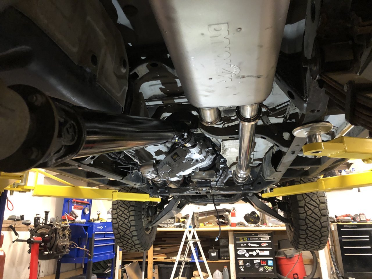

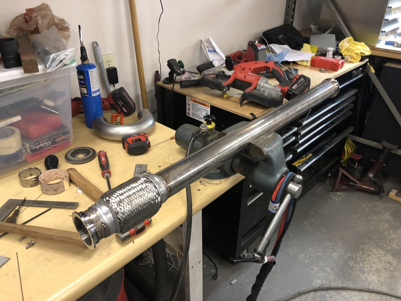

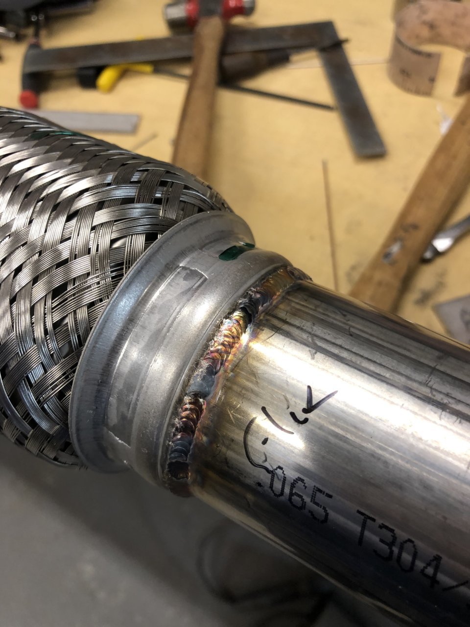

    Some pics from piecing my exhaust together, there are three mufflers and two cats in it and its got a really nice tone to it and isn't too loud.

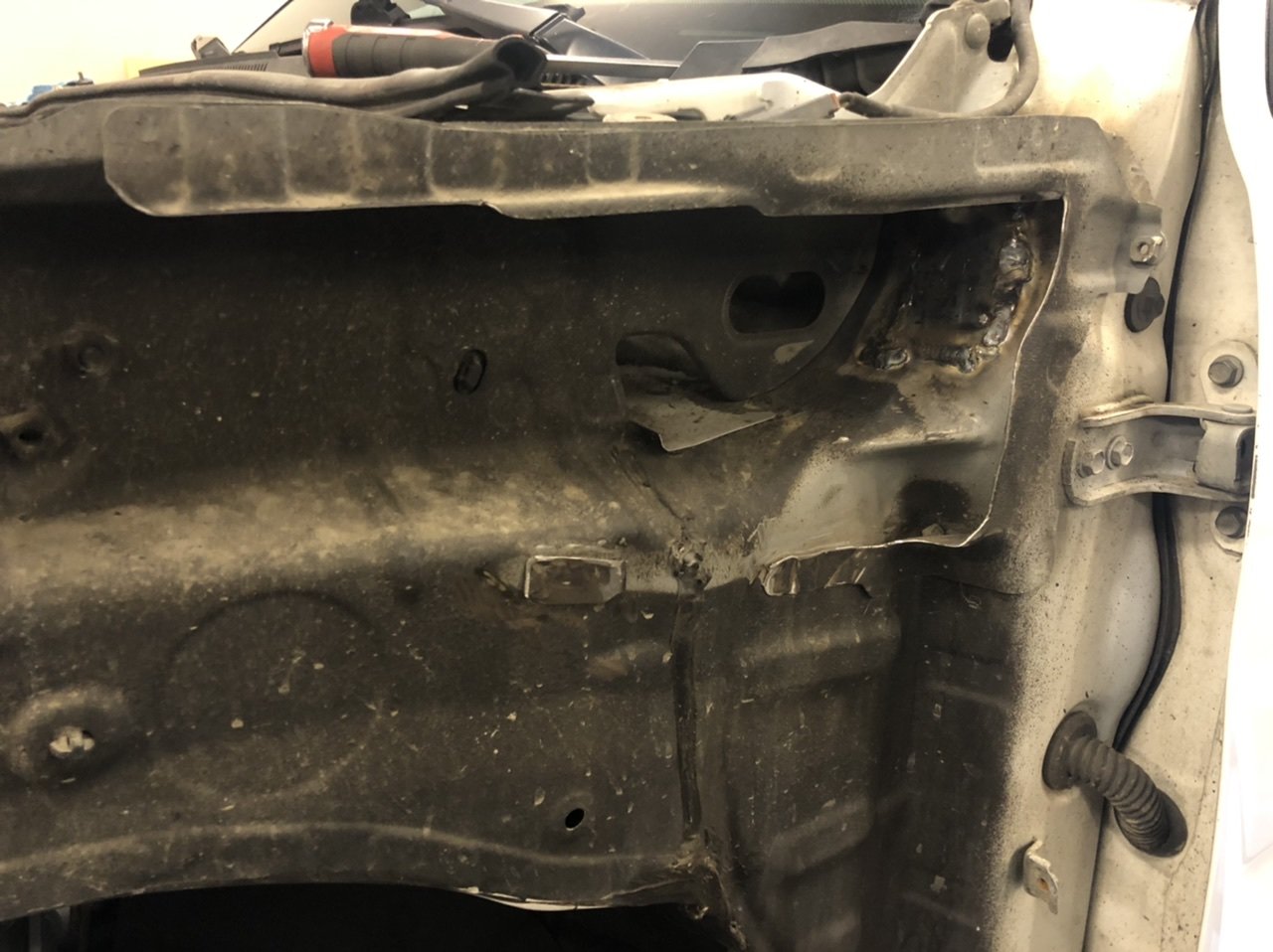

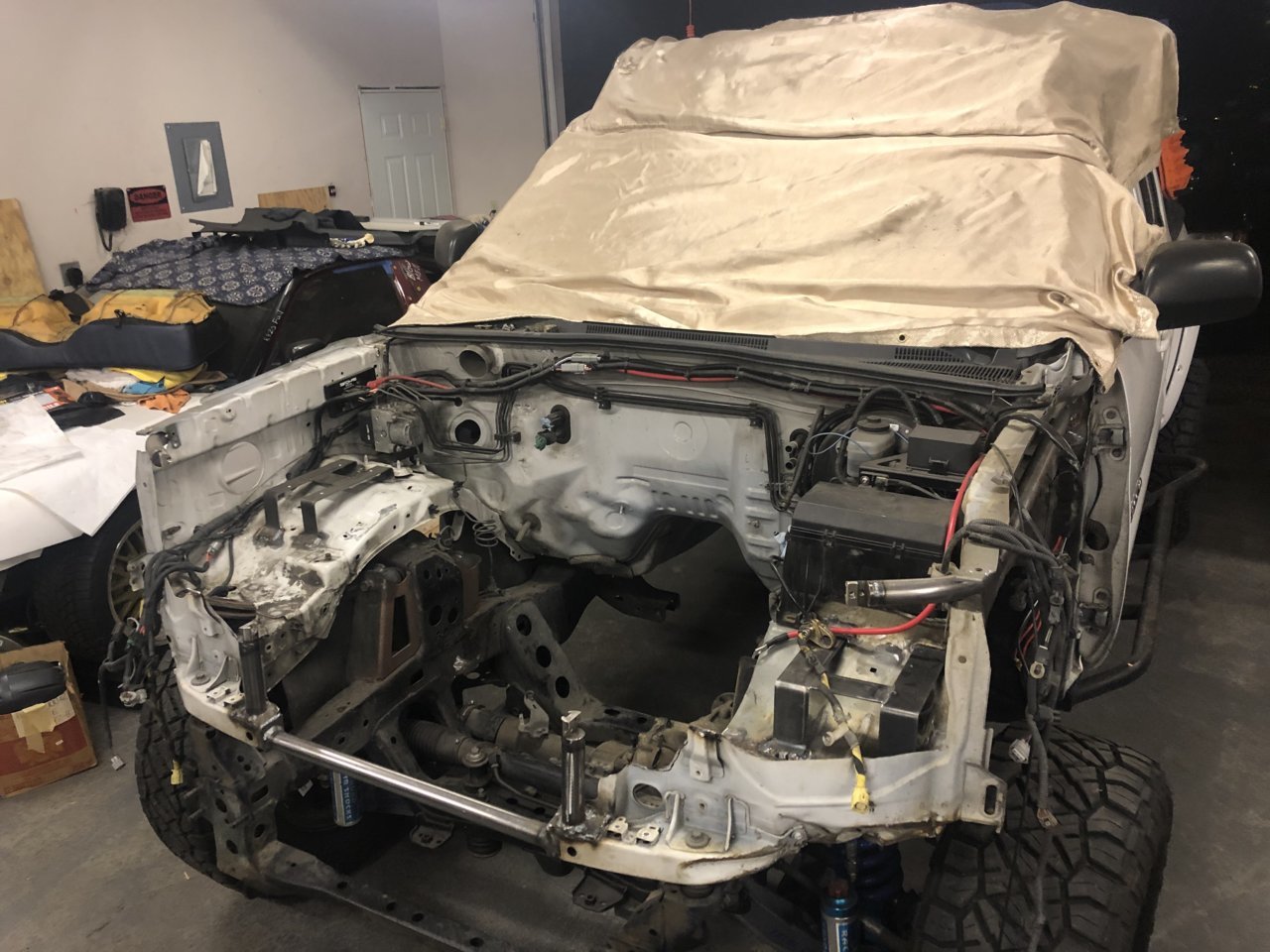

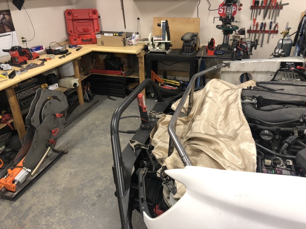

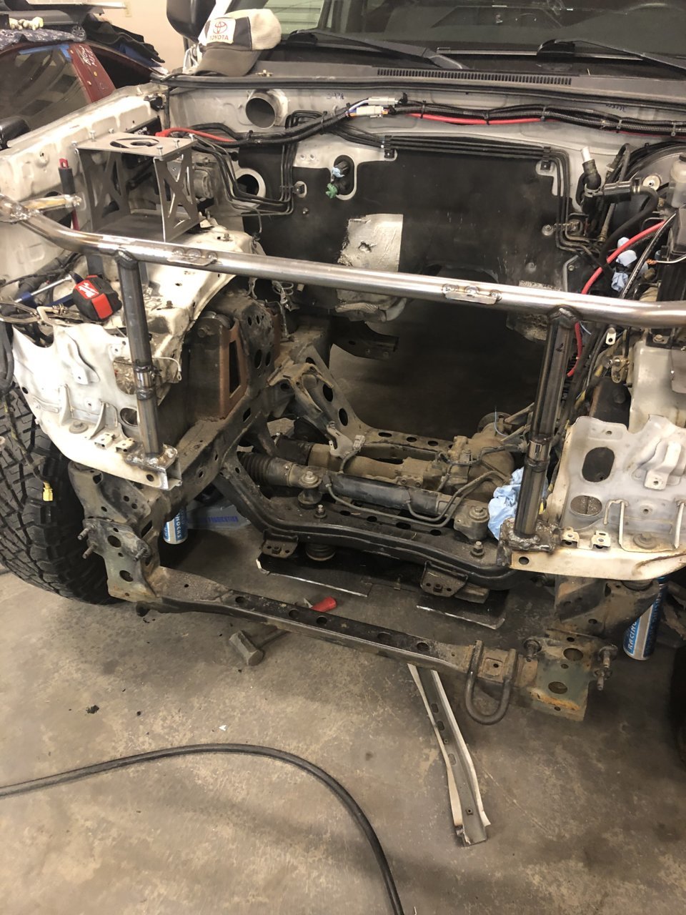

    Nice man, Can i get some more info on your core support fabrication? Any more pics?

  11. Dec 11, 2020 at 3:44 PM
    tacotunner06
    tacotunner06 [OP] Well-Known Member
    Sep 2, 2017
    #228857
    2,076
    Edmonds, Washington
    2006 White Tacoma
    LS Swap with RSG Tranzilla, Custom hi clearance front bumper, Relentless: Slider's, bed rails, rear bumper, Prinsu with 40" BD s8. Dirt Designs 3.5 LT. Archive Garage rear towers/shackle flip/SUA. King Air bumps. King LT Coilovers in front. King 12x2.5 in rear. ARB rear air locker and twin compressor. SCS f5's with 33" Ridge Grapplers. 20" S8 mounted in bumper, squadron sport fog lights, squadron pro backup lights, LP6's bumper mounted.
    Here’s a bunch more pics of it. Originally I only did the top with the lower cross. This time around since I was taking out the wheel wells I fully took it out minus the small area where the cab mounts to the frame, where the headlight brackets mount and the airbag sensors. If I was to do it again I would probably use different tube break clamps. These ones are threaded and use two Allen’s from each side. The ones I would use are just slotted both sides and you use nylocks on whichever side you want and the slot keeps them from spinning.

    awesome progress on the radiator subframe! @Arcticelf @Subway4X4 @ovrlndkull
    Could you show more of how you mounted the tube to the firewall? What size tube did you use?
  13. Dec 15, 2020 at 1:39 PM

    I was planning to use 1.25x1/8 HREW.

    its 1.25 Dom tubing, wanna say .12 wall. I cut the little bracing off the outside where the upper fender support comes togethor at the a pillar. Then I welded a doubler in and then welded the tubing to that.
