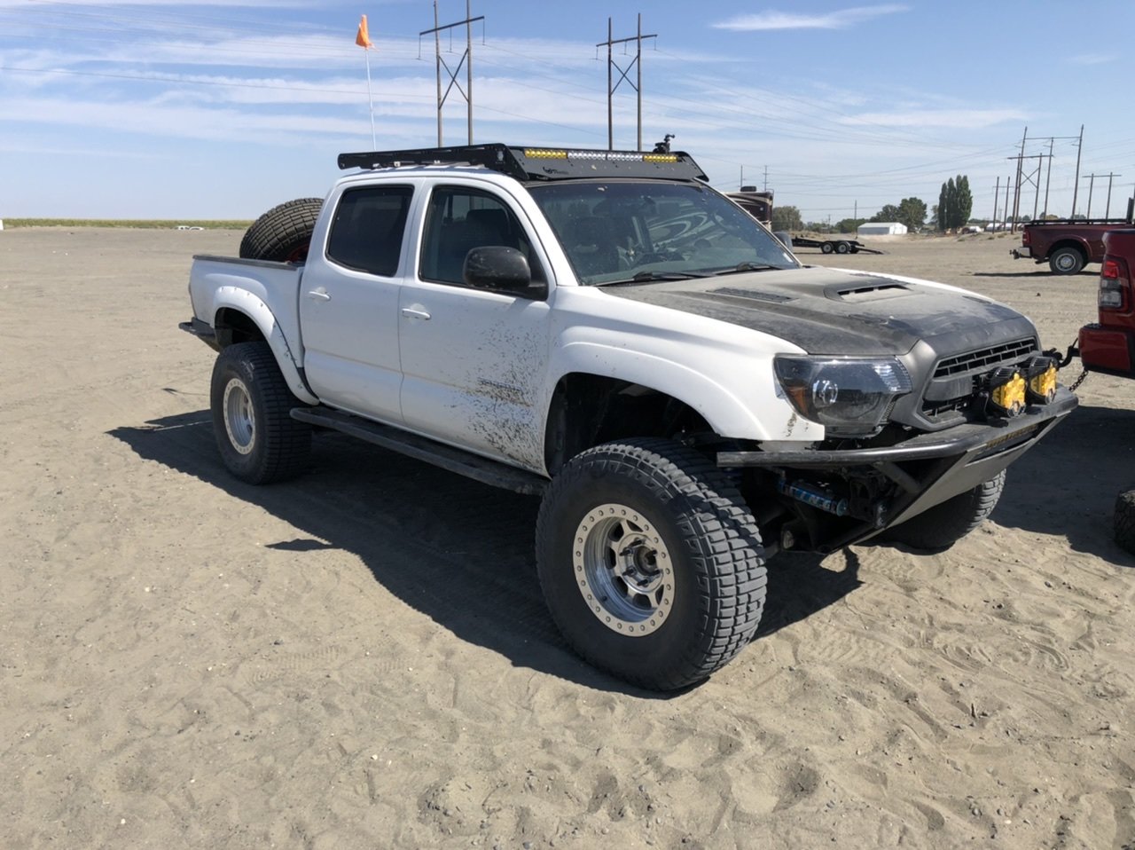

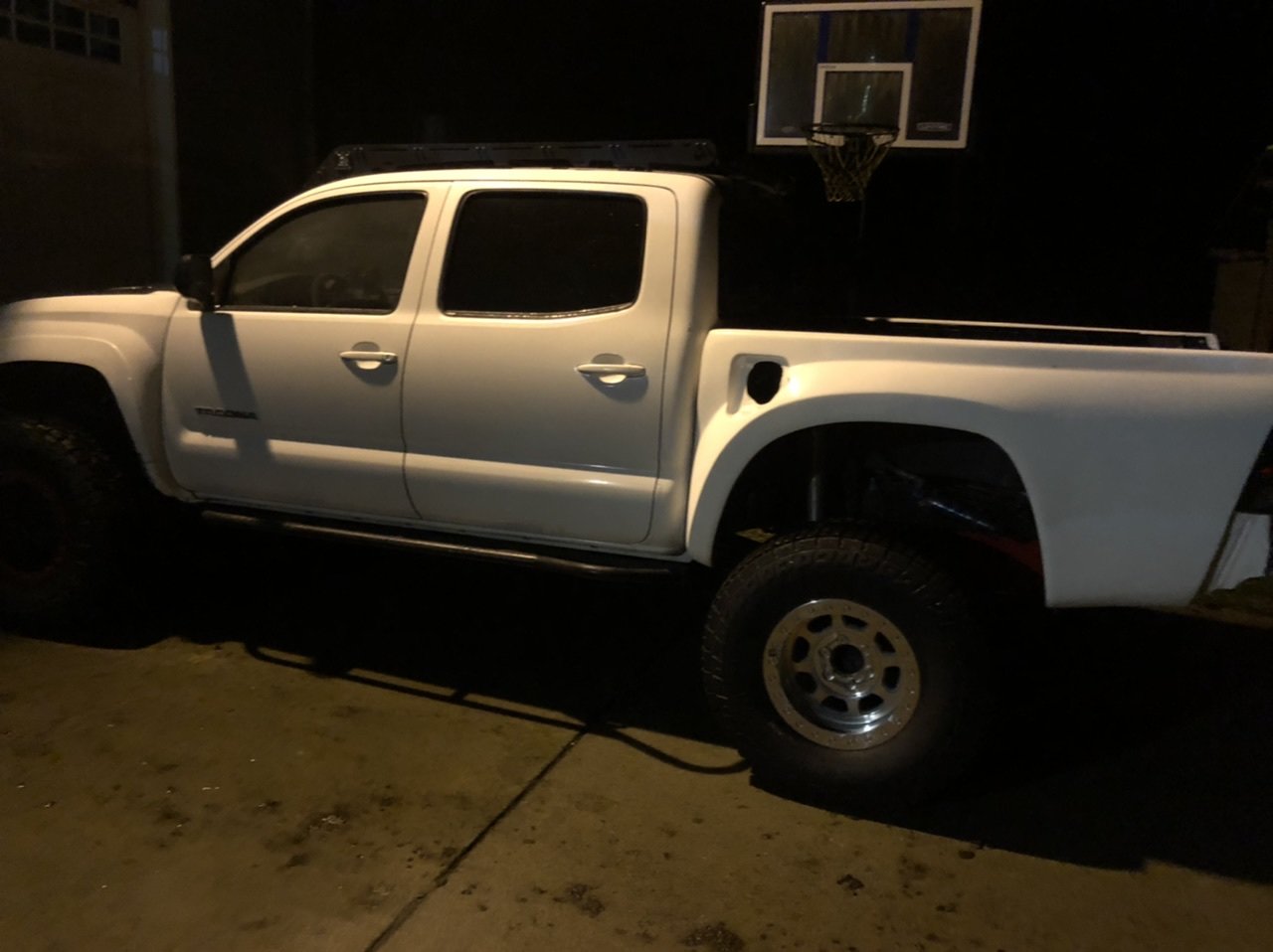

    From today out at Moses Lake dunes in Washington.

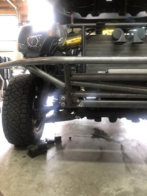

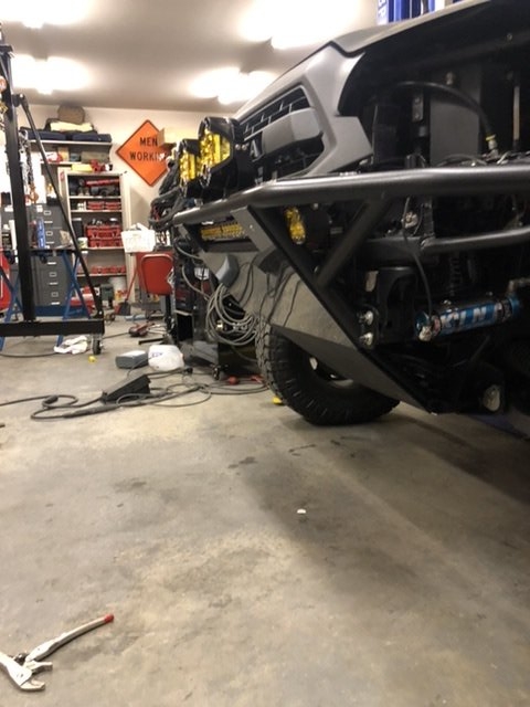

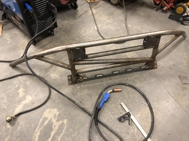

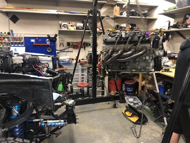

    So this winter I took off all the bed rack stuff since i wasn't really using it ever and decided it needed to go to go faster in the desert.
    Had a small break to work on the truck in May so chopped the bottom of the front frame crossmember and raised it like 4.5" for better approach angle and built it from tube and then added some UHMW skids to it.

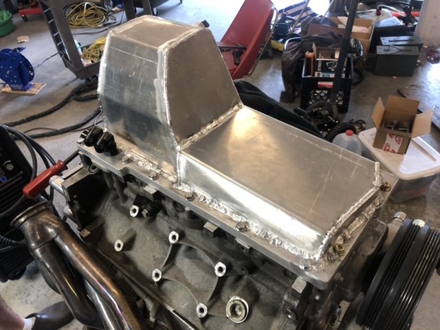

    Then this summer when i got home from fishing i tore the motor out for my 3rd oil pan design (this time it works and yeah i know dry sump...dry sump...dry sump....and no not going there).

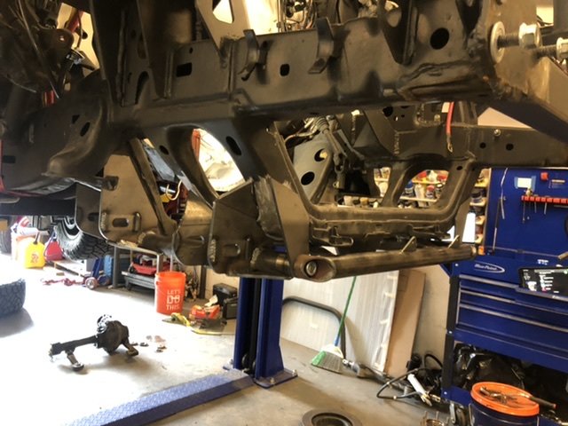

    and while the motor was out i chopped out the lca mounts and threw in the JD Fabrication lca mounts/skid.
    then took it to Moses Lake and beat the piss out of it.

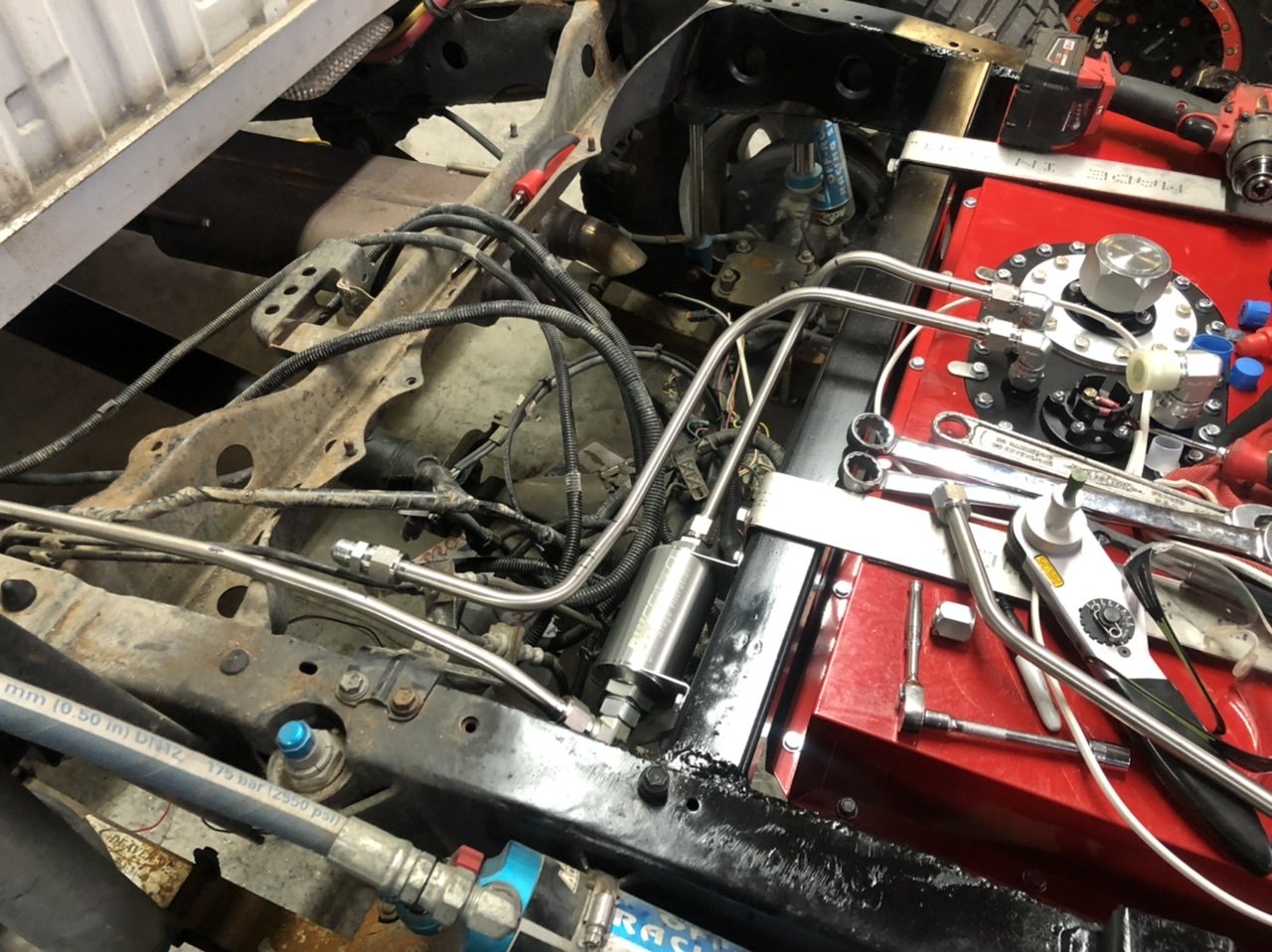

    Pulled the bed off and installed a jeepspeed 32 gal fuel cell in with a deatchwerks fuel pump. And finally threw my adv bedsides on, now just need to swap out my Mcneill +2 front fenders out for the Adv set i got sitting in the shop.
