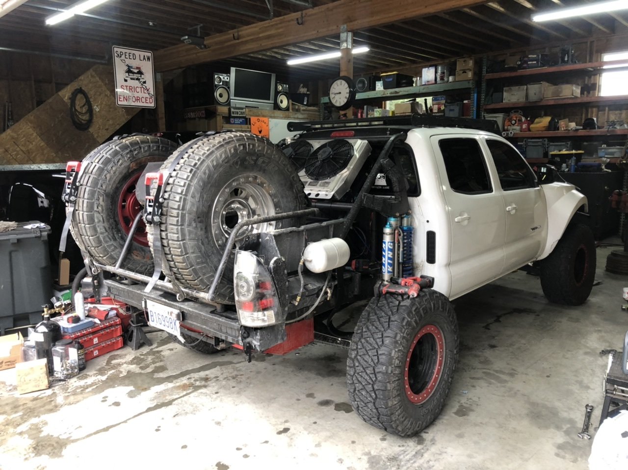

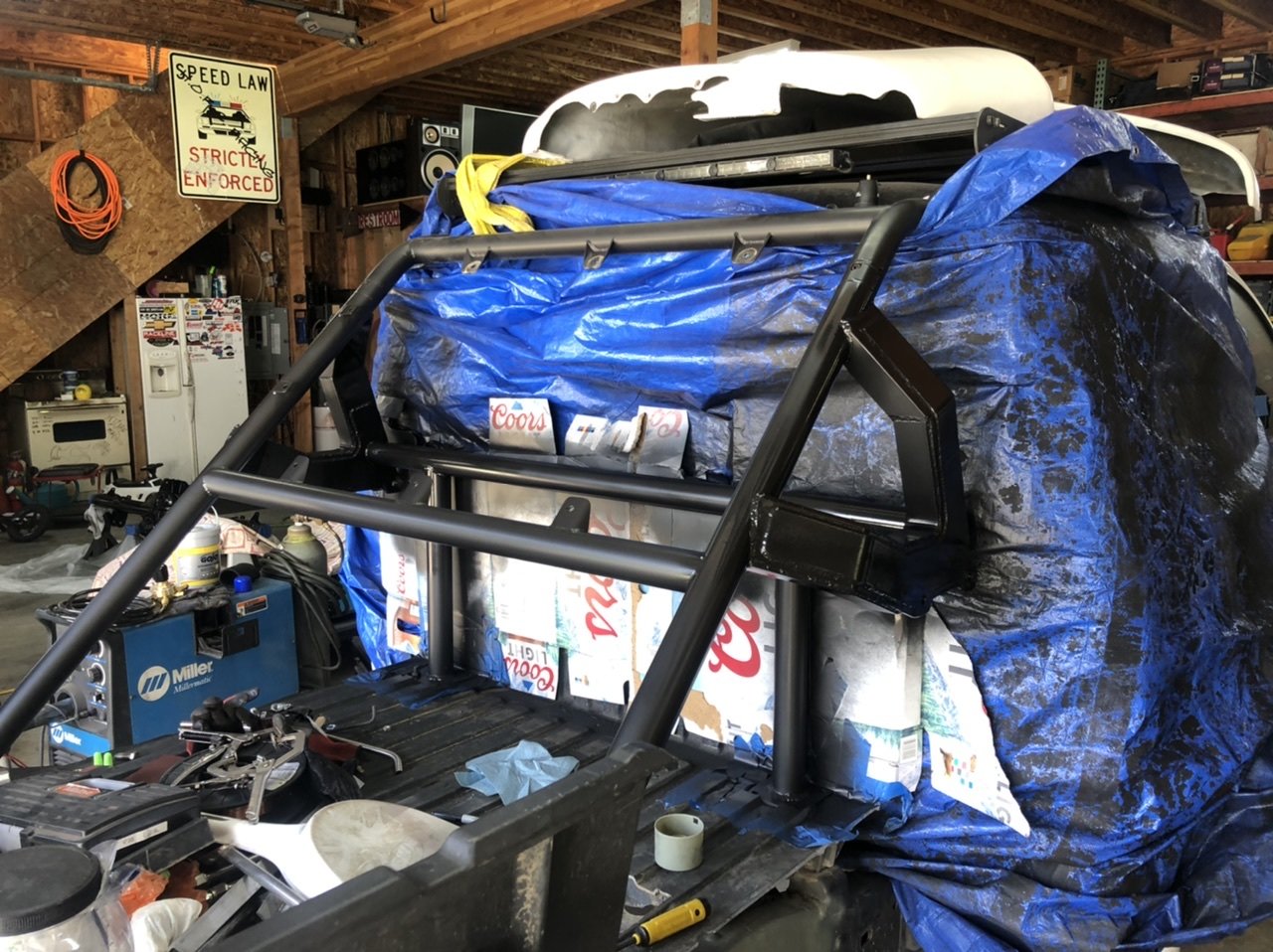

    The one for dual spare tires.

    I have, each has their own pros and cons for sure. One thing I like with the rogue is I don’t have to have it bolted to the floor to bend a long piece.

    thats a big deal to me too and why I am leaning that way. Then I can take it from my shop to my friends or my garage at home without needing to bring a drill and anchors.

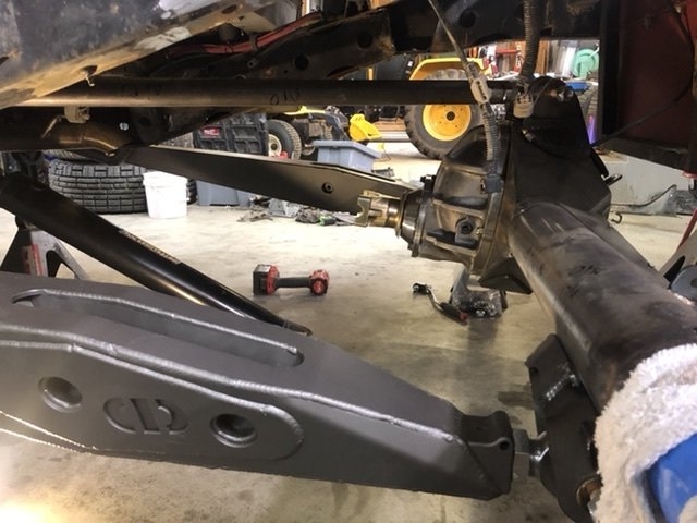

    Figured more photo dump time from installing my 4 link

    Jesus Christ guy nice work‼️…
    And that sure in the Hell doesn’t look like a Tacoma rear diff…

    thanks, and it’s a camburg ford 9”
