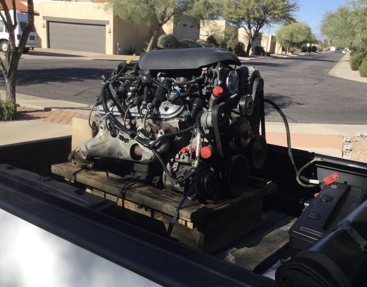

    Figured I would see if you had a build thread instead of clogging the Lt thread with engine talk, then realized I've posted in here before.
    I'm trying to find a decent lq9 but they have been hard to come by locally. A couple solid ly6 around that im thinking could be a good option, but I would have to recam or figure out the vvt. but like I said, I don't know a lot about LS's at this point. Still lots to learn. Aiming for around 500hp ideally.
    Also curious about your front suspension setup
    tacotunner06[OP] likes this.

    man too bad you didn’t have time to swing by to grab that oil pan….woulda been great to talk…oh well. Yeah vvt is easy to deal with, just change the cam and tune it out with hptuners. Yeah being in Canada seems like it makes it harder with parts and what not. But like I ordered valve covers/fuel rails/intake manifolds off Amazon. And summit racing became my friend.

    But either option should give you a good base to start with, just know you’re adding a decent amount of weight in an iron block. I think even an aluminum block is 30 lbs more than the 1grfe.

    I too I’m curious why an iron block? Save money? Just FYI the iron block is just over 100 lbs heavier than the aluminum block. Plus I’m guessing you have extra weight of a 4x4 system and extra armor. My advice is to save your money because the parts add up quickly very quickly. I’m second guessing myself now, but this will hopefully be in the front someday.

    Just go LS3. Ironblock V8 plus winch, armor, front diff is way too much weight for the front of a taco to enjoy off-road, imho

    All good advices, thank you, I was wondering about the weight, but the LS3 and other aluminum blocks are super hard to find around here, and very expensive when you do. Obviously preferred though. I thought that the ironblock LS were roughly similar to the 1gr-fe, but I guess that I was probably comparing fully dressed weight of the 1gr to just the motor of the ls. Hard to find real weights.
    @Hayrider are you saying to save money and not bother with the swap? I don't think that's an option anymore after riding with the JD guys :oops:
    @tacotunner06 Which oilpan is that? I will likely be at KOH for the last few days for my first time next year. Sounds like you might be around? Would be stoked to meet up!
