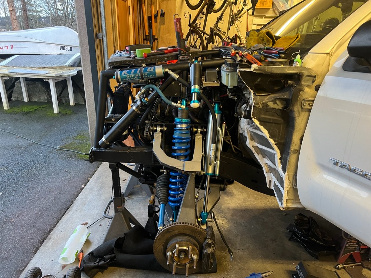

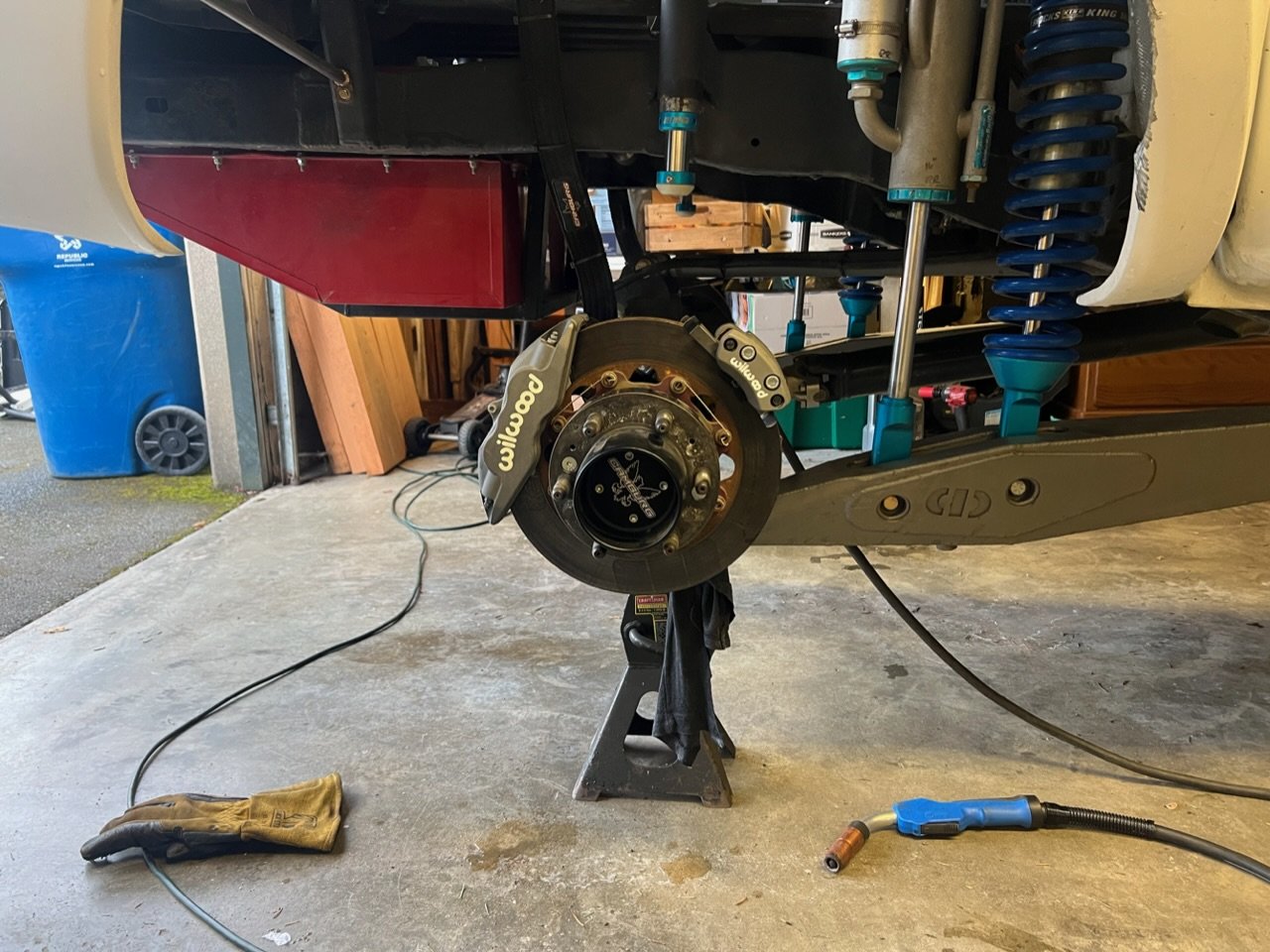

  12. May 2, 2023 at 4:44 PM
    #112
    tacotunner06
    tacotunner06 [OP] Well-Known Member
    Sep 2, 2017
    #228857
    2,254
    Edmonds, Washington
    2006 White Tacoma
    LS Swap with RSG Tranzilla, Custom hi clearance front bumper, Relentless: Slider's, bed rails, rear bumper, Prinsu with 40" BD s8. Dirt Designs 3.5 LT. Archive Garage rear towers/shackle flip/SUA. King Air bumps. King LT Coilovers in front. King 12x2.5 in rear. ARB rear air locker and twin compressor. SCS f5's with 33" Ridge Grapplers. 20" S8 mounted in bumper, squadron sport fog lights, squadron pro backup lights, LP6's bumper mounted.
    Here’s fitting the rear ebrake, tubbing the front and cleanup after hammers though.

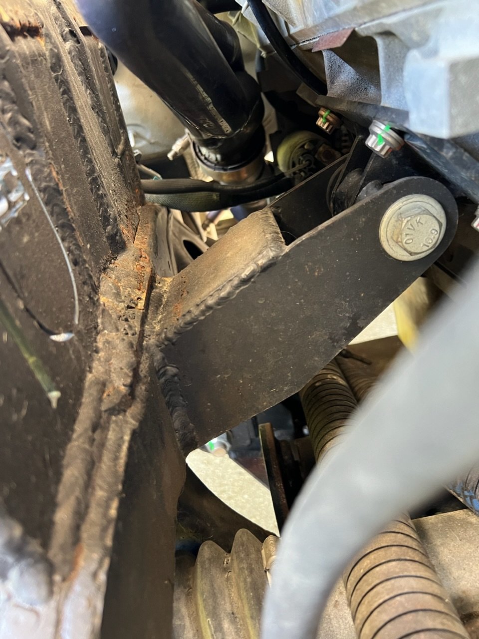

  13. Aug 6, 2023 at 9:23 PM
    #113
    hayrider2.0
    hayrider2.0 Over the hill and going down fast!
    Jun 30, 2023
    #427944
    407
    Hey You
    2 Centimeters from Hell 200 Miles from Water
    05 & 07 White Reg. Cabs w/ sticks
    05 Magnuson 07 LS Swapped
    @tacotunner06 / Chris,
    I looked thru your pictures and couldn’t really see what I was looking for. So may I ask, how far is the backside of the heads / valve covers from the firewall? Also if it’s really close is there an issue reaching the bolts on the transmission to pull the engine, changing the starter or doing maintenance? Sorry but the gentleman I have doing mine is reluctant to move the engine any closer than about 2.5” from the firewall. Thanks in advance, Randy
  14. Aug 6, 2023 at 9:39 PM
    #114
    tacotunner06
    Sep 2, 2017
    #228857
    2,254
    Edmonds, Washington
    2006 White Tacoma
    i can get you an exact measurement in the morning but its pretty close. i have my engine pretty low as well. but once you take the intake off getting the trans bolts out are pretty easy. plus the starter is underneath on the right side so thats a non issue.

  15. Aug 6, 2023 at 10:10 PM
    #115
    hayrider2.0
    Jun 30, 2023
    #427944
    407
    Hey You
    Chris,
    Thanks! Yeah he has it approx or should I say the heads/valve covers off the firewall about 2.5”. He told me that @munkeywrench was off about 4 inches. And I told him that it was there because he didn’t want to modify the OE transmission cross member and just drilled a hole to mount the Chevy transmission.
  16. Aug 6, 2023 at 10:11 PM
    #116
    tacotunner06
    Sep 2, 2017
    #228857
    2,254
    Edmonds, Washington
    2006 White Tacoma
    yeah problem with being that far forward is your really pushing it for space to fit a radiator and fans as it is.

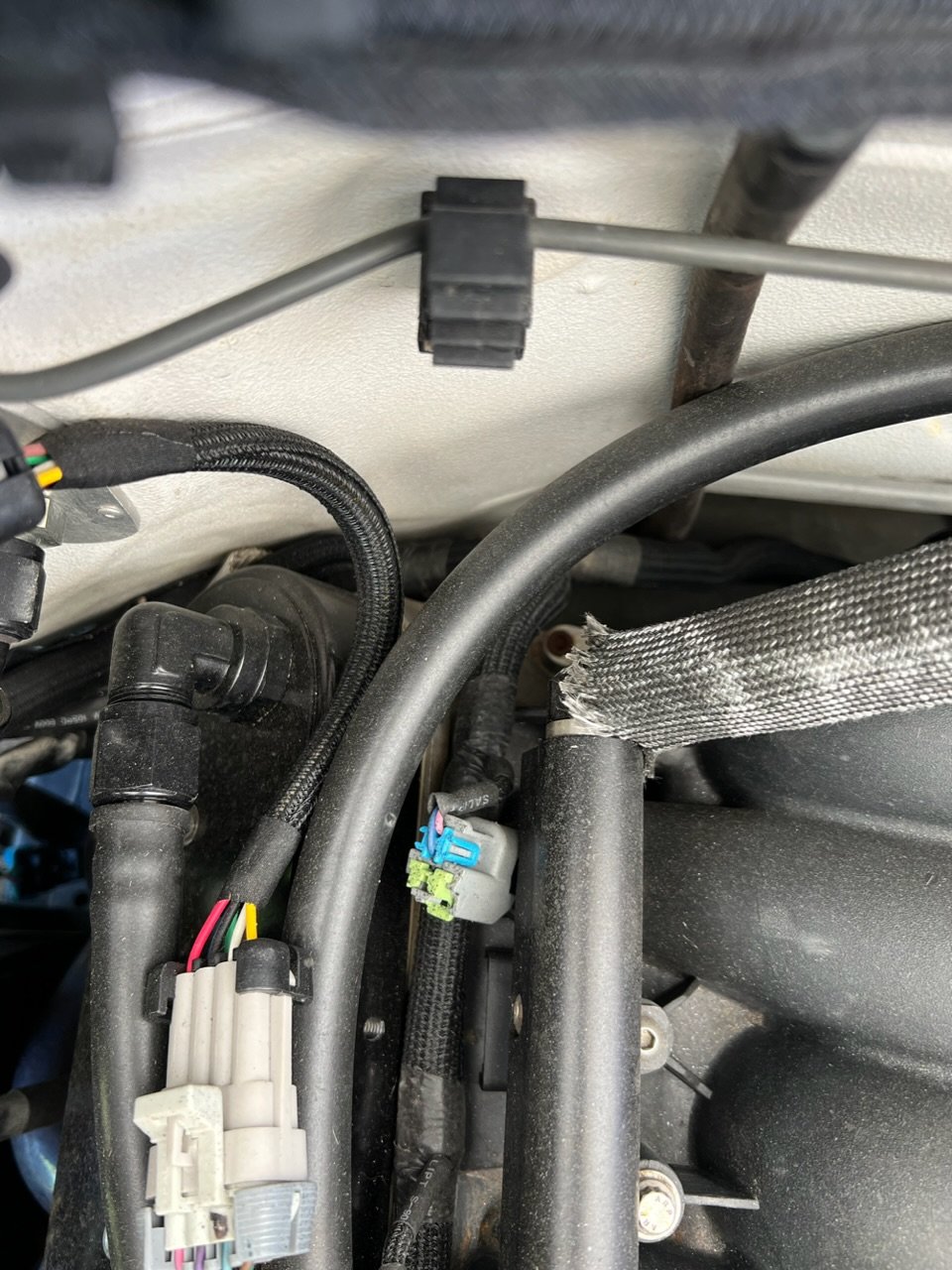

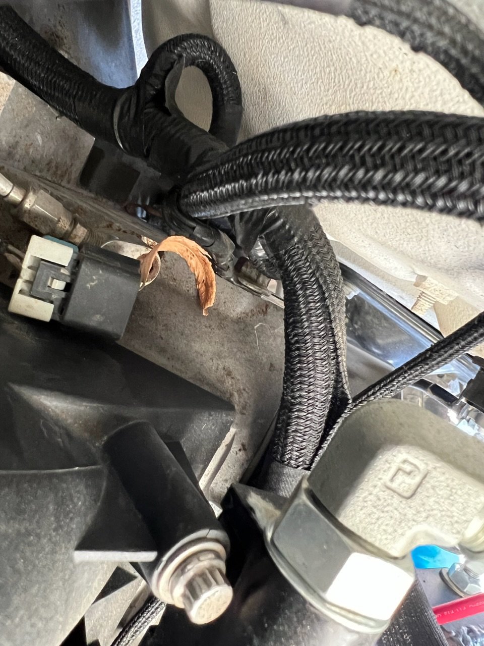

  19. Aug 8, 2023 at 12:12 PM
    #119
    tacotunner06
    Sep 2, 2017
    #228857
    2,254
    Edmonds, Washington
    2006 White Tacoma

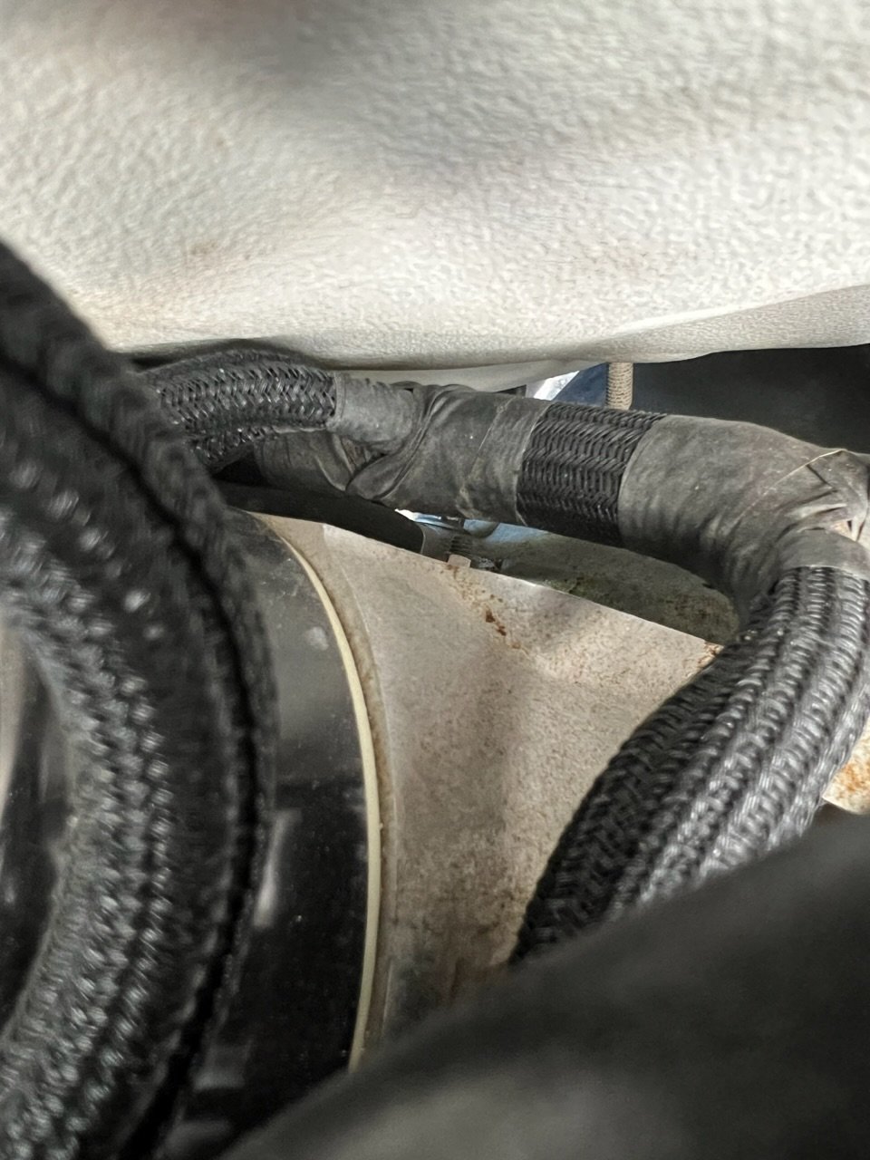

  20. Aug 8, 2023 at 12:14 PM
    #120
    tacotunner06
    Sep 2, 2017
    #228857
    2,254
    Edmonds, Washington
    2006 White Tacoma
    The drivers side valve cover is about 1.5” off the firewall and the pass side is about 5/8-3/4”. I would say the cylinder heads are similar but it’s hard to tell on the pass side since my wiring harness is tucked back in there. I can say there’s just enough room that the harness doesn’t rub.
