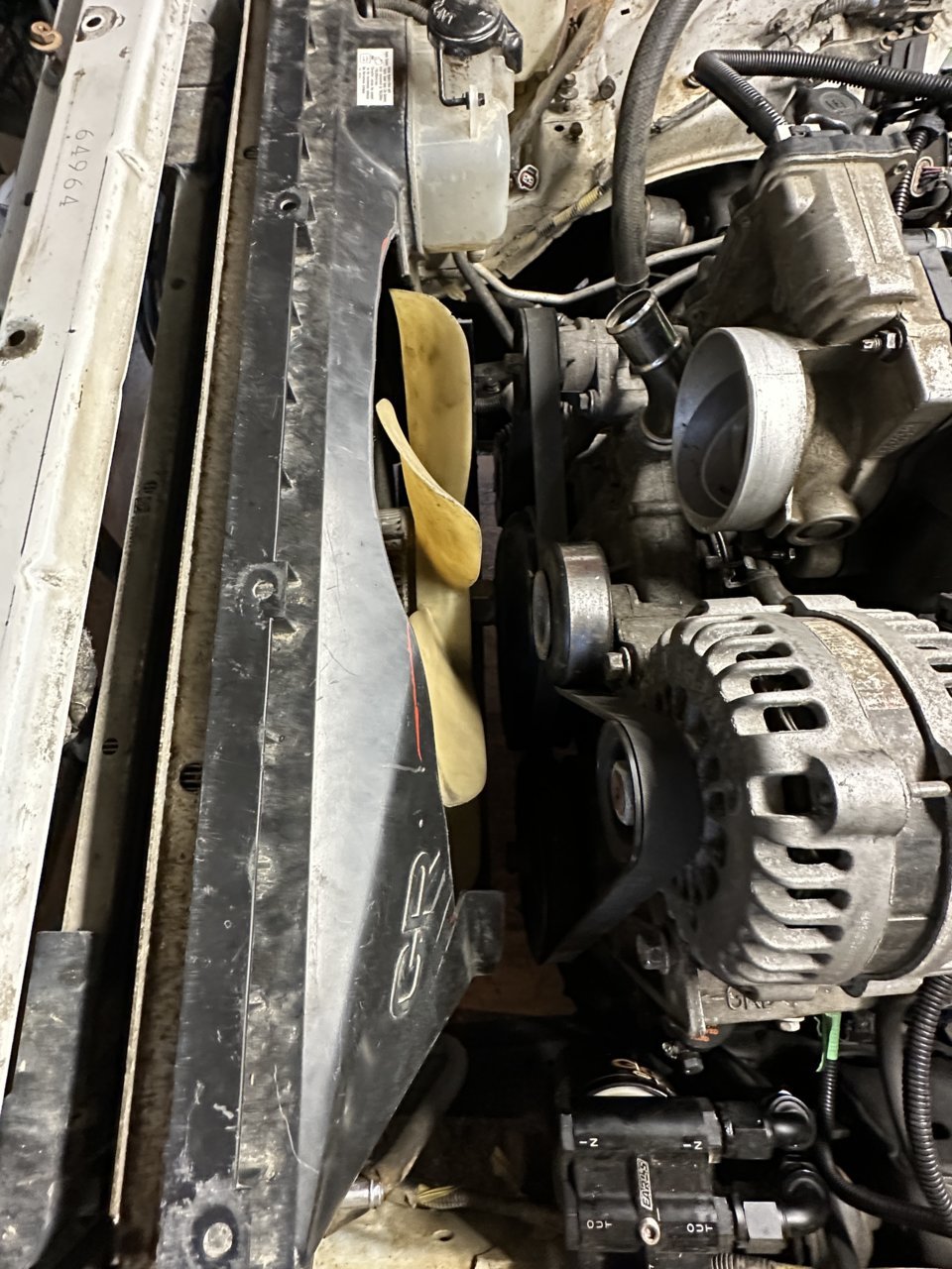

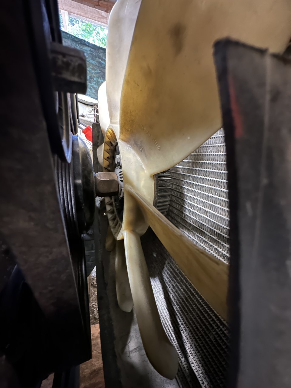

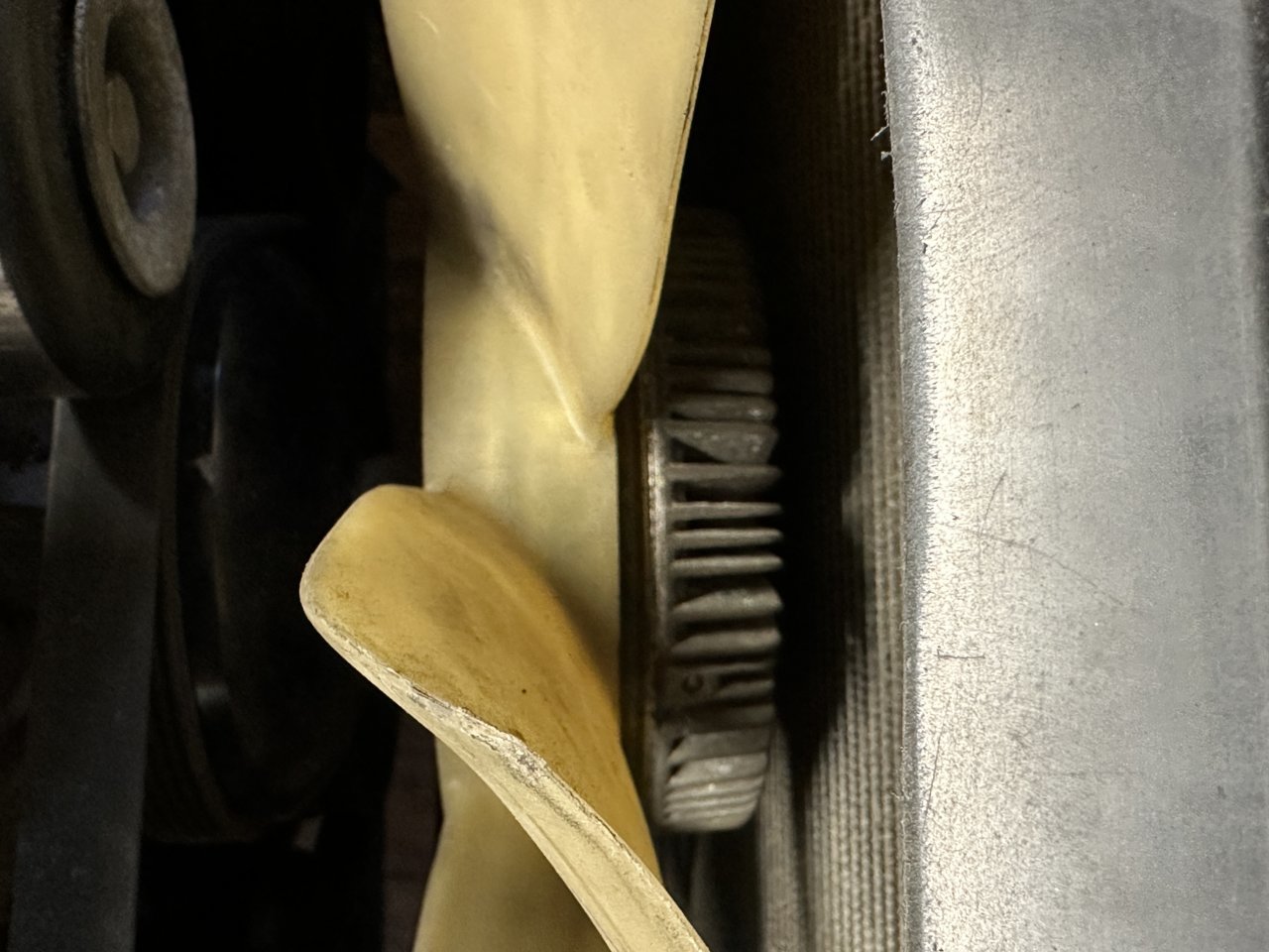

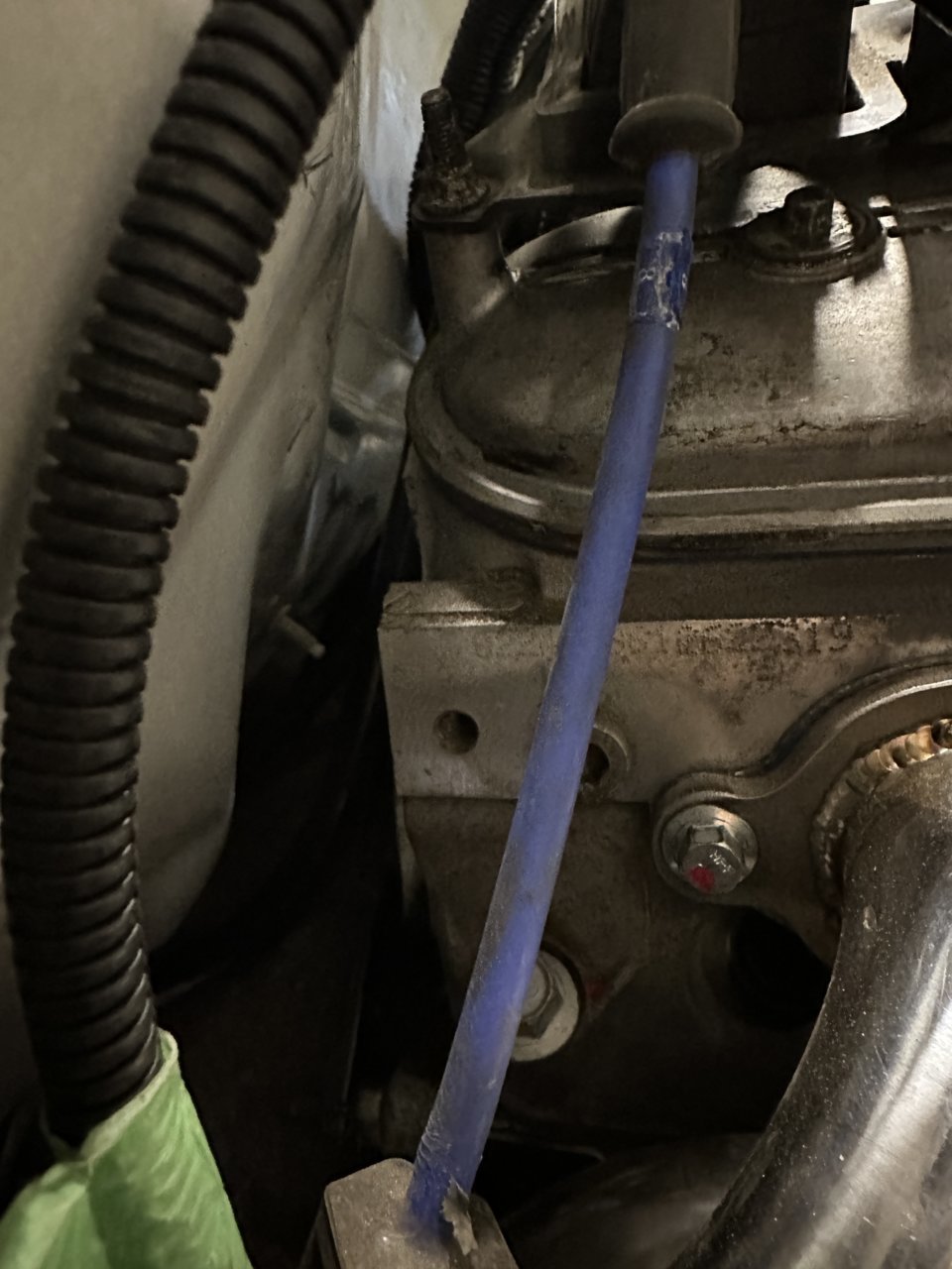

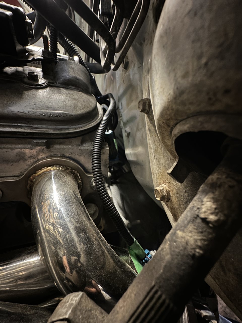

    My heads are approximately 1" off the firewall. Also some photos of the rad/shroud and fan. The shroud had to be modified to clear the fan, at a later date I plan on changing the setup to electric fans.

    Are you using the OEM / stock radiator? :confused: :eek:

    No problem.
    Yea just to get the truck driving around and then it will be changed.

    @Camazon,
    Thanks for the pictures it’s much appreciated. Now I’m guessing you have the truck accessories package as in WP, Alternator, PS & etc… now I’m not trying to tell you what to do but if you get the Vette accessories that will give you an extra 1.5 inches. Again not telling you what to do but I’m using the Mishimoto OE drop in radiator. I measured the radiator size in the Silverado my 5.3 came from and the Mishimoto radiator has more capacity than the OE Silverado radiator. I don’t have the welding equipment or skills to fabricate mounts for an aftermarket radiator. So you might be able to just get another OE fan shroud.
