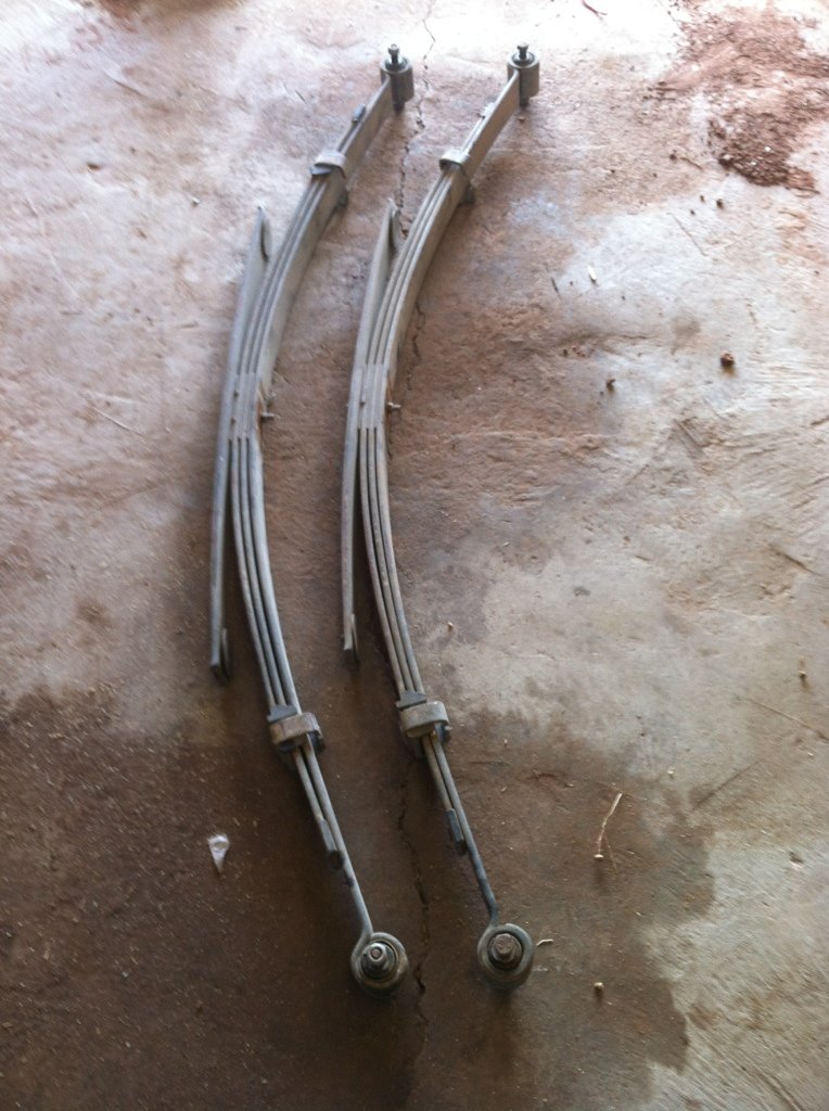

    Now to figure out which of the many ways to mount these Chevys.

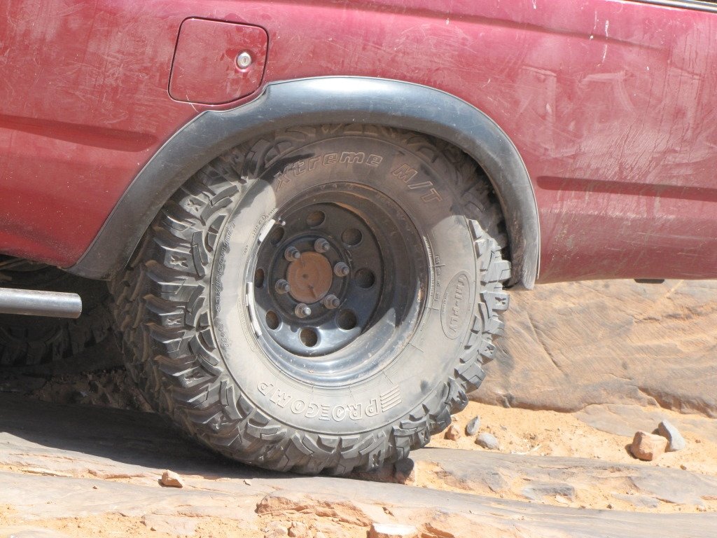

    That should be about it. Tires might rub at full stuff (mine did).
    From Moab 2012:

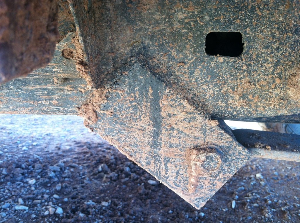

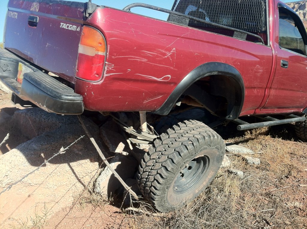

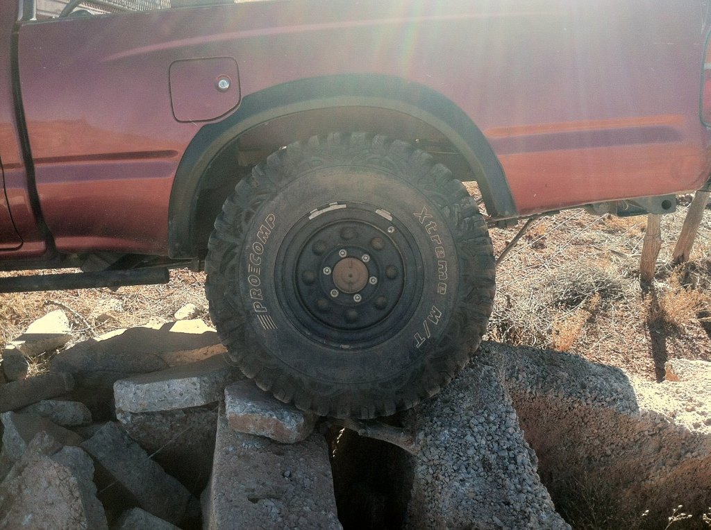

    After thinking it over I made my front hangers for the chevys out of square tubing. I placed the hangers ~7-2/1" forward.
    2A9F34FA-5BBB-4FCF-820A-52F9ED3D5E9A-213_a2584f5638120e0edb11691772badf1d1c18298a.jpg

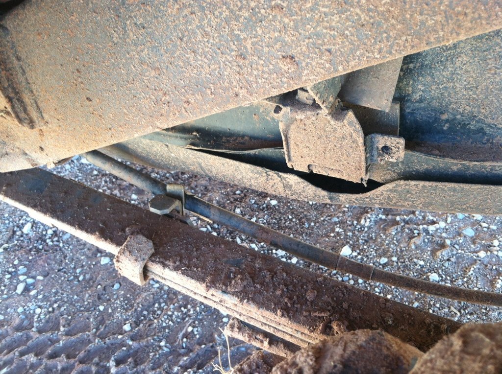

    Moved the rear shackle mount 1-1/2" to the rear due to the stock shackles hitting the aftermarket hitch mount that I cut for shackle clearance for my OEM leafs. Now the shackle angle is better and the springs can fully compress. I have yet to get longer shocks but will update when I do.
    I moved my stock E-brake cable down to follow the springs. In the stock location, the cable would hinder full droop.

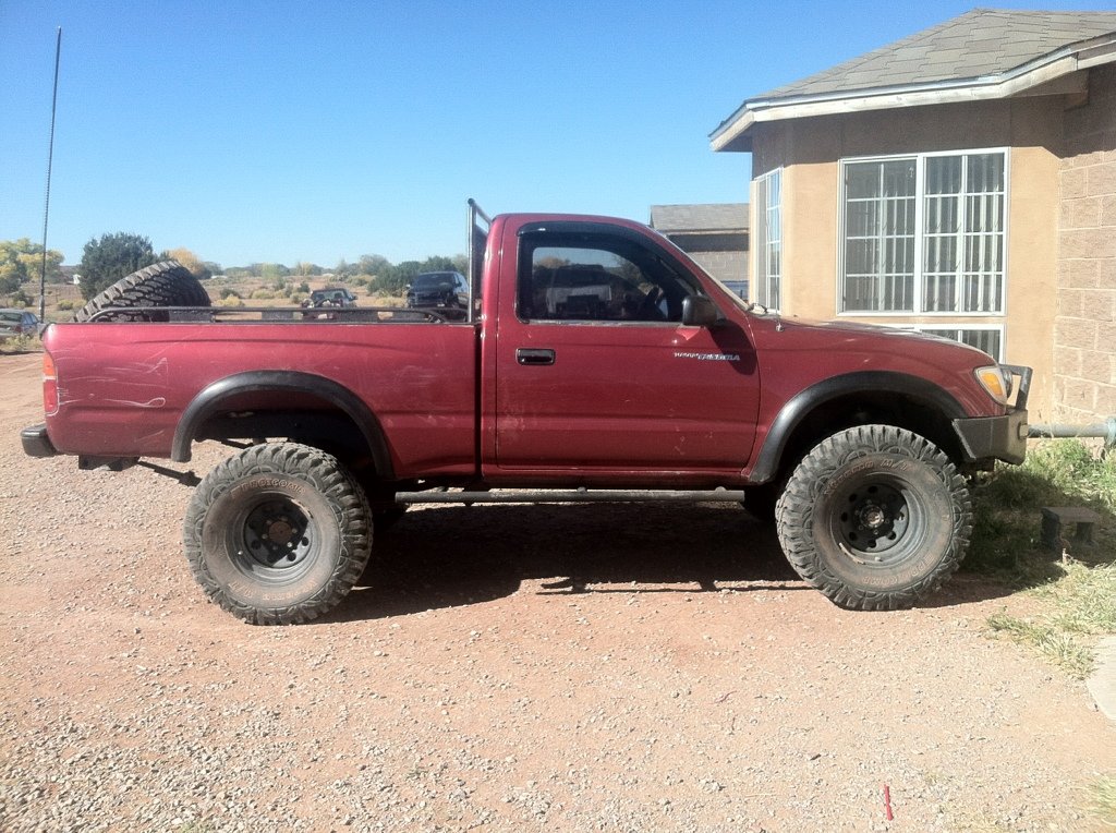

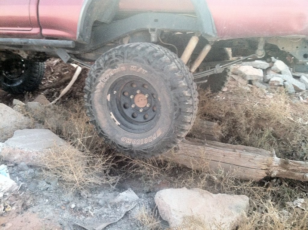

    Short shocks at almost full droop.
    C61F33B2-625D-4A6F-ADC2-E6942623ADB5-213_d83573974bca53a562a6a49e878b507d4318c0a3.jpg
    43586A12-2B24-4082-8911-DF8B73D60FE4-681_3a6920e37ab2c389c0264576e0920671aaf93a37.jpg
    Sitting next to a stock GMC Canyon.

    Location of the tire at stuff.
    42D8B863-1777-41D0-B4AF-2848B8D2BB2C-681_561e8ffa264c6132b37ad7b8553ebaaff4ae33f6.jpg

    I like what you did with the e-brake cable, I've been running into that problem...
