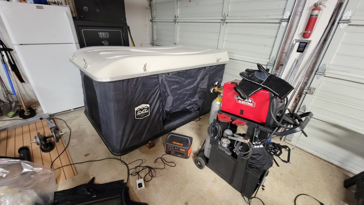

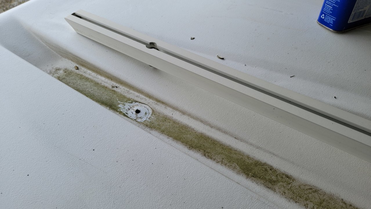

    Smell gone, time to investigate the problem. Pulled the top rails off, now these rails I was told not to use because they would leak if you did, which already told me they were a problem. 20210402_173453.jpg
    There was the smallest amount of sealant around the holes but nothing in them.

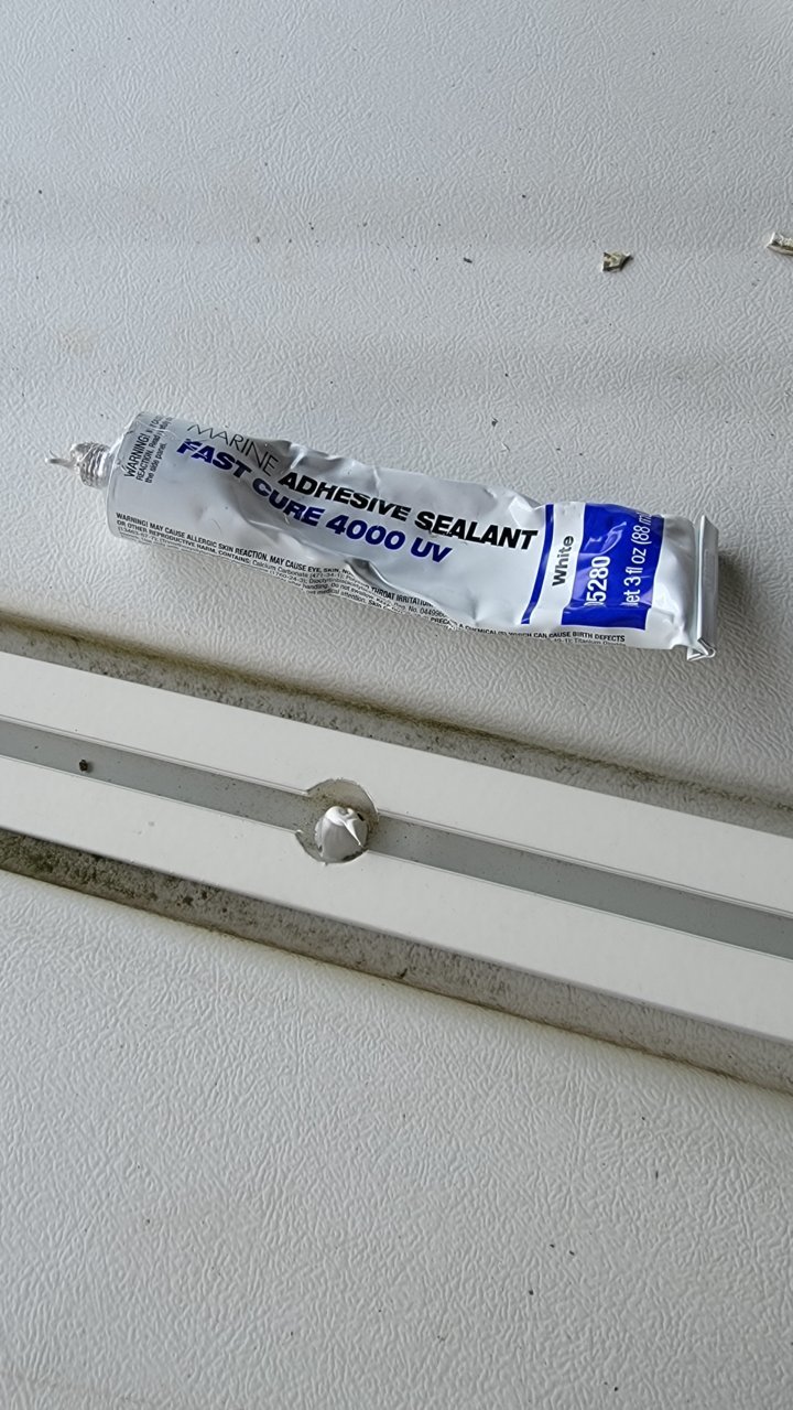

    Cleaned them up, removed the old hard whatever it was they used, and ran a strip of UV stable 4000 and filled the holes, put bolts in, pulled em out and filled again. Not going to leak anymore.

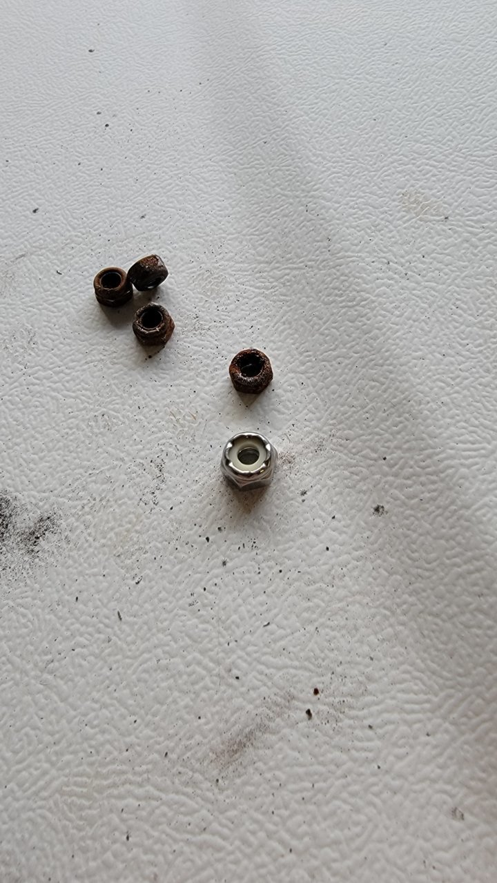

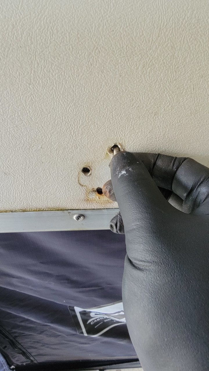

    The latches were my other concern. 8 latches, 24 holes. Whomever did this was an idiot. The holes are 1/4" and 10-32 screws, way too big hole and zero sealant, plus they used regular steel nuts which rusted. Not much room back there but I managed to replace them all (minus one that stripped, the last one :-/) with SS nyloc nuts with a healthy smattering of 4000.
