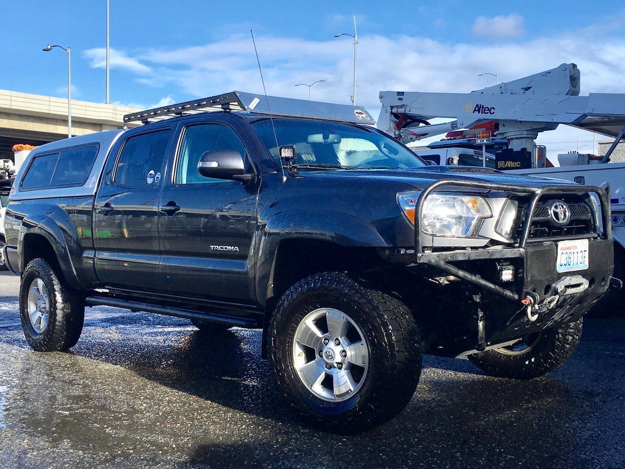

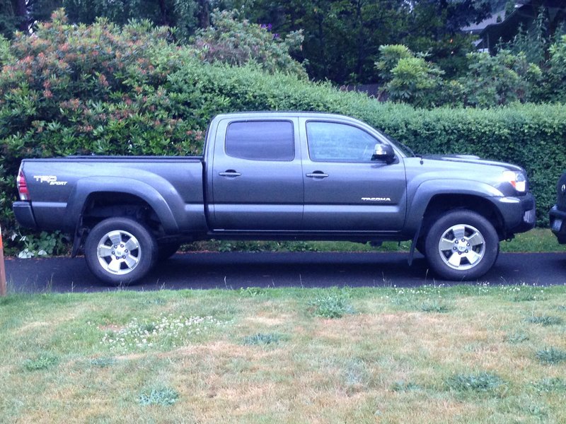

    As of 7/13/17IMG_0405.jpgsmashed up body parts and all.
    Suspension:BP51's, Dakar leafs, Camburg uca's, big ass daystar rear bumps and energy front bumps.

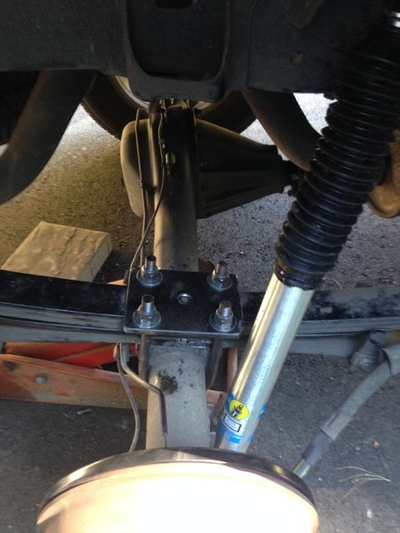

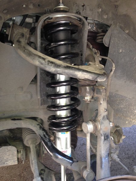

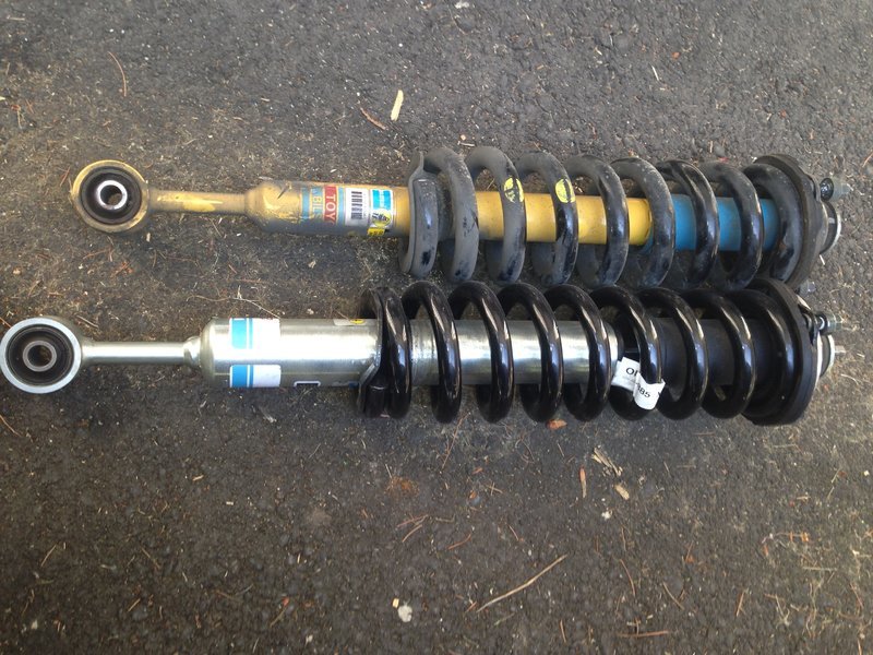

    image.jpg image.jpg I installed those this morning. Plus the rear 5100's

    Good way to start

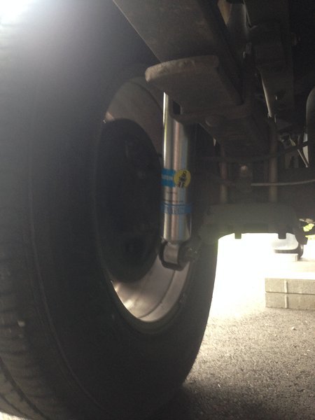

    image.jpg Ran out of time to install add a leaf and u-bolt flip kit. So gonna have to rock the bro lean till fathers day weekend. Also have diff breather re-route parts. And new bumps stops if I can find where my 3 year old hid them.

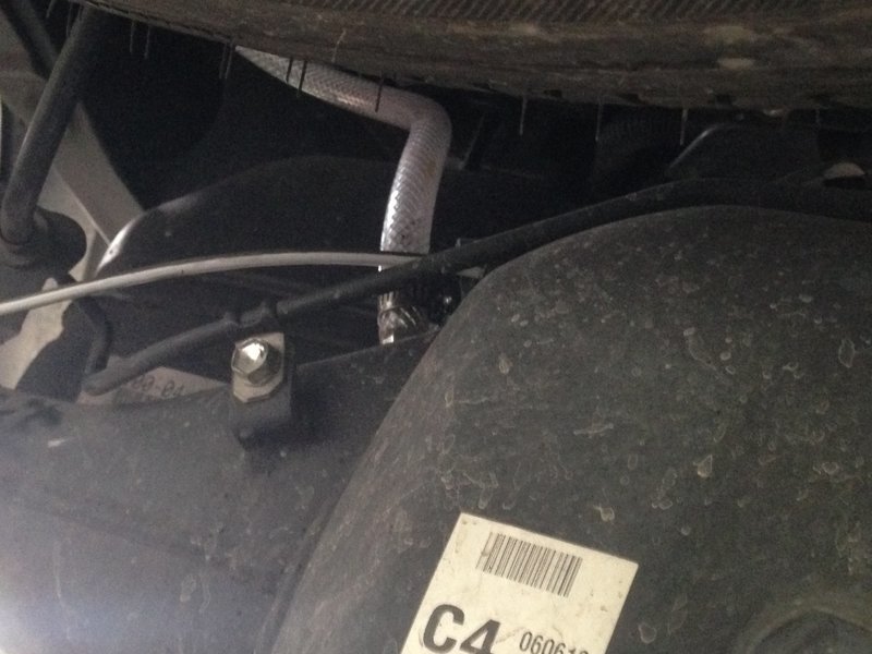

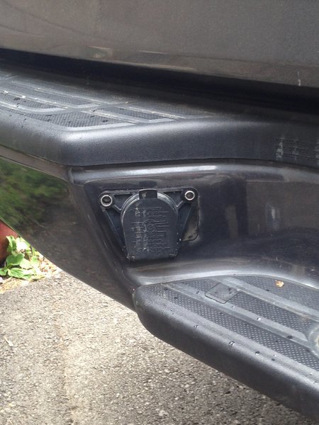

    image.jpg Ok, now I'm really done for today. Diff breather done. Trailer plug relocation almost done, need some nuts for the bolts. image.jpg

    Diff Breather - easiest mod I've ever done! LOL

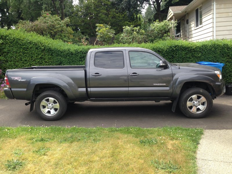

    image.jpg I installed 2" add a leaf and ubolt flip yesterday. After driving it around today it has a very slight vibe at take off. Going to measure drive line angles tomorrow and see if I can remedy that. I also have a selection of spacers to try up front. I would like it a little higher. image.jpg Over all I'm pretty pleased with the end result. Need tires to show up!
