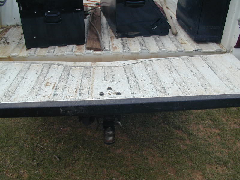

    Just found this. Not a tacoma, but same location of the damage as the tacoma. (for some reason all the tacoma bent tailgate pics have been sucked off the net....) This one didn't bend at the top, but you can see how it bent at the bottom. All you really need to do it bridge those two sections with a stiff bar to keep it from giving out, and distribute the weight over the whole tailgate.
    Using a ramp helps, but then you have to make sure nothing rides on the tailgate. If you reinforce it, then no worries! lol

    That tells me what I need to know, you cut the tabs and glued in place. Thanks.

    Yeah, and the plastic cap takes some work to stay in place. I used gorilla glue, but it made a mess of things. Also came apart with the dealer went to do the original tailgate TSB. Their glue didn't hold so I put some construction adhesive down, then did the bolts! :D That sucker ain't coming off! I did that after I went and ripped everything apart again, chiseled off all the gorilla glue and put the second brace in at the bottom.
