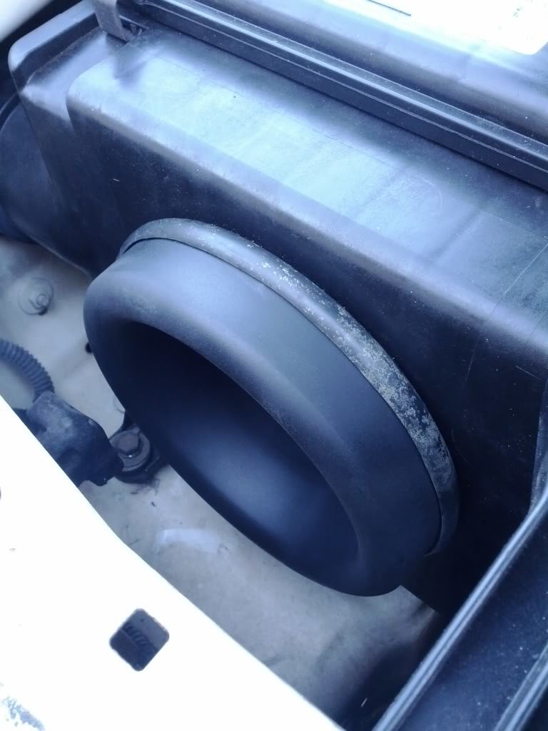

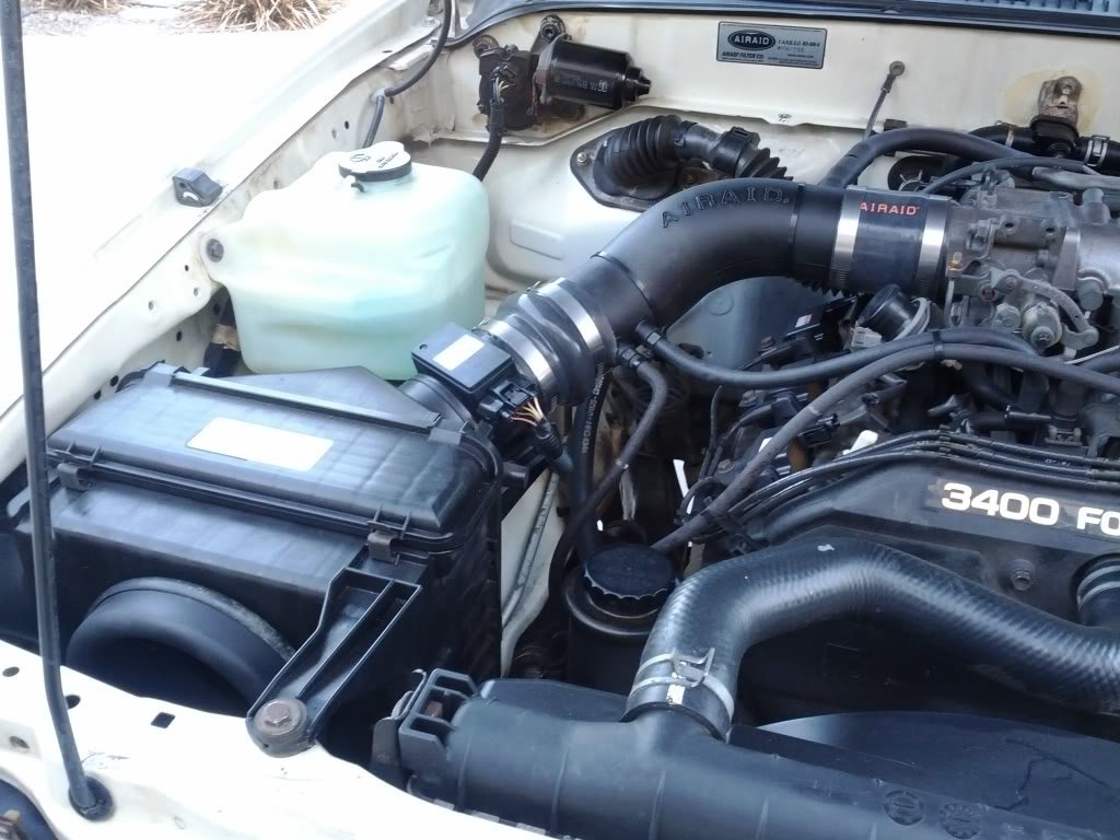

    Decided to use a 4" composite velocity stack from Blox Racing. Also installed the Airaid intake tube and panel filter today. Intake roars now! Butt dyno says this mod WORKS. :)
    -Matt

    Clean handy work. Are you able to still plug the hole back up?

    Not without something custom, no haha. I'll probably only ever need cover it temporarily when I power wash the motor. But I'm not too worried about it, even in the rain. Got a buddy with the deckplate on his Taco and runs it open in the rain with no problems.

    Just went to the Blox website. Where do I find the parts?

    Nice simple do it yourself set up how much was that air aid intake tube

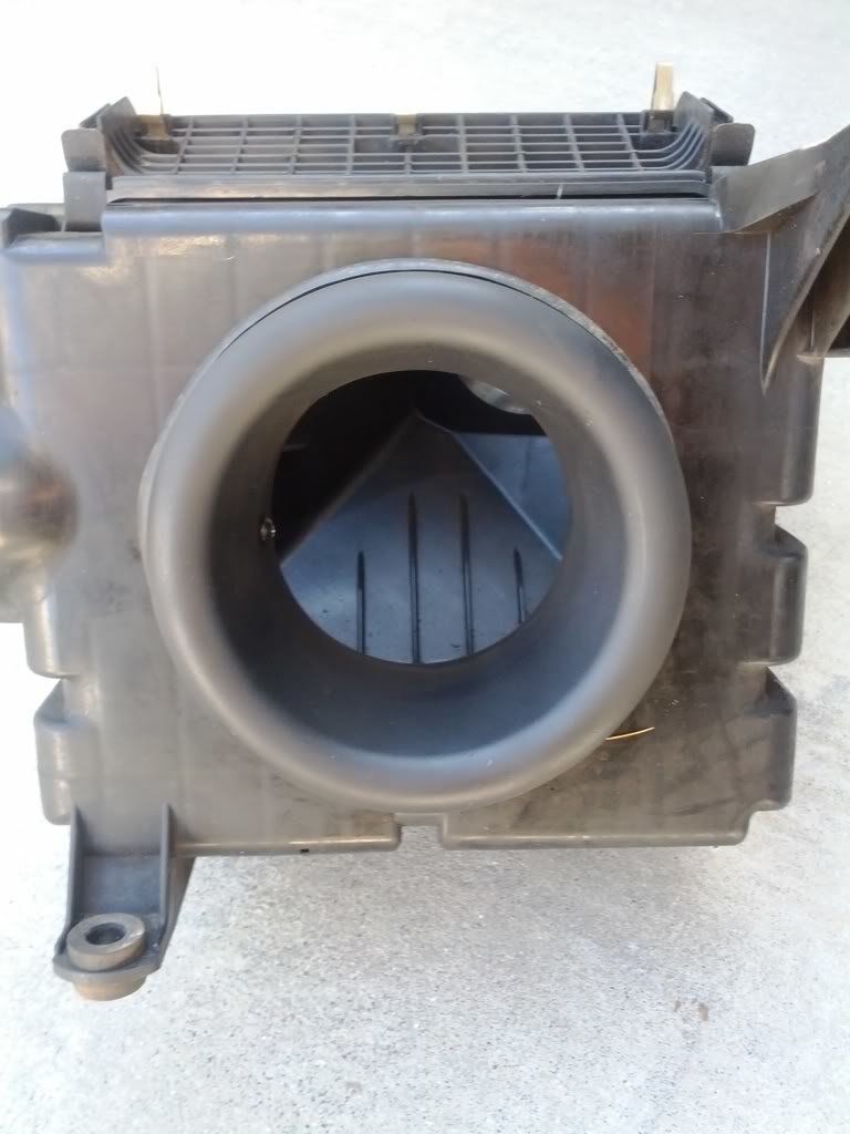

    Here ya go:
    http://www.bloxracing.com/bloxshop/index.php?route=product/category&path=20_46_95
    Used a 4" drill saw to punch out the hole, and then used a file to accommodate the full inner funnel body(ever so slightly bigger than 4") so that I could snug the velocity stack up flush to the airbox. It shouldn't move anywhere with the snug fit, but I decided to put a set screw for peace of mind. You might be able to see it in the pics. The rubber grommet was simply made from splitting a small hose in half.

    Not to bash, it looks awesome, but I think the essence of the deckplate mod is that you can plug the whole back up. :)

    *IF* your plan is to cover the hole up, then the deckplate mod is certainly better. I, however, have no plans to ever plug the hole....so I just improvised :)

    What was the purpose of getting the new intake tube? not trying to be a dick im really curious

    To be honest, I'm sure it has minimal gains over the stock tube. When I did my initial deckplate mod research on the forums, consensus was the Airaid intake tube + deckplate had the best gains. I would've loved to dyno prove it but Im hours away from the nearest dyno. :(
    It looks better, if anything. Haha!
