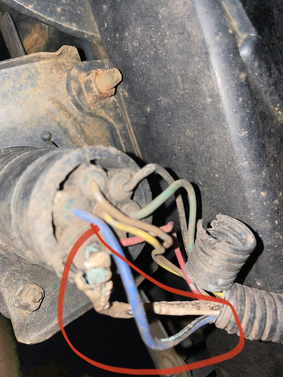

    So I’m pretty upset this happened. I traced down the frame wire and it only went a couple feet down by the left rear tire and can be easily re wired I think. Could someone send me a wire diagram and tell me what that gray/black does and how I can get another one.
    2008 Tacoma 4x4 Trd tow package
    Vin : 3TMLU42NX8M018449
    I believe it’s called frame wire #3 or part number 82169
    Thanks :/

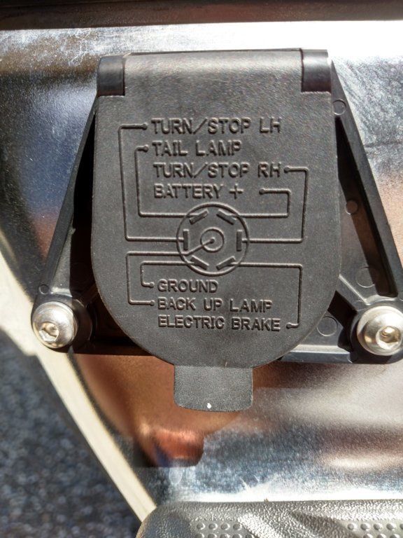

    Can't tell by pic but if that 7 pin still has a few inches of wire use a heat shrink butt connector (or 2) and fix it and/or add new piece of wire.
    While you have that connector unplugged (your 2nd pic - up behind bumper rotate latch and pull apart) time to move the 7 pin from underneath the bumper to into it - just drill a hole and bolt it in as the stock location gets beat as you saw. You can fit it between lic plate and lic light or pull a lic light socket out and drill/mount there as only required to have 1 light.

    Are you sure you don't have too big of fuse installed somewhere? Factory wiring shouldn't melt like that if the correct fuses are used, the fuse should blow first.

    If there’s enough wire and you can reuse the harness, you can probably go with a unit like this:
    https://www.amazon.com/CURT-58150-Vehicle-Side-Trailer-Connector/dp/B001EP0G72
    If you need a pre-wired unit, something like this:
    https://www.amazon.com/Poweka-Connector-Electrical-Converter-Mounting/dp/B089Y3Z7XG
    You’ll need to replace that bad wire as @TnShooter suggested and use better connectors than the included butt type. Something that seals up around the wire, and maybe add heat shrink tubing on top of that, plus the wire loom.
    And these may not fit in the factory position, if so you’ll be following @TnShooter’s other suggestion regarding relocation.
    Good luck!

    Thank you guys for the suggestions!!! I just ordered those 2 things I linked cause after researching some reviews it’s plug and play. Then going to re wire the main wire frame which only fried to about the rear tire luckily. Forsure going to take the idea and mount it on the bumper not under cause when I do climb big stuff you are so right. It gets smacked and bent/ have to bend back

    All that blueish green shit is corrosion of the copper wire. May have been enough to cause a high resistance connection at the spade. Which led to the localized heating of the wire. Id also check the factory fuse for any signs of overheating. Ive seen that once before where it got hot, but not hot enough to pop..
