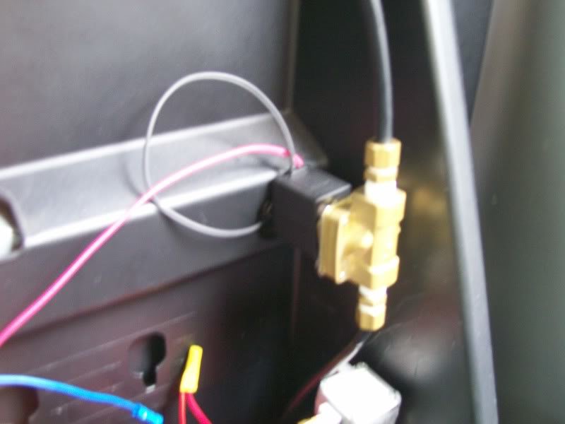

    This little guy is called the silenoid. Its basically an electronic valve that opens with the push of a button, allowing air to flow from the compressor to the horns. I used self tapping screws to mount it in a convenient place.

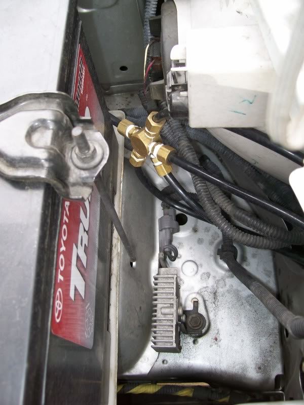

    This is the splitter that joins all the air lines. Each trumpet uses its own air line. And yes, I do know that it should be closer to the compressor for less resistance and more noise but the air line is expensive. So for financial and simplicity sake, its in the engine compartment=]

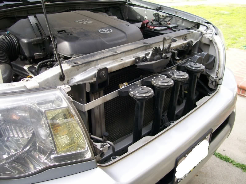

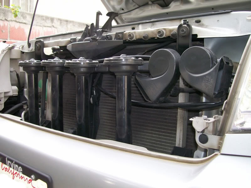

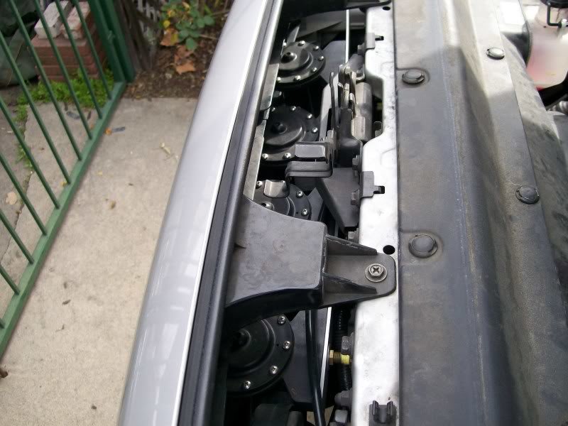

    Finally, The Trumpets!!
    4 giant trumpets. Courtesy of HornBlasters. Theyre made of super tough ABS plastic and have stainless steel disks. I made the little mounting bracket out of some scrap aluminum we had.
    I had to put the OEM horn on the bracket as well so everything would fit.

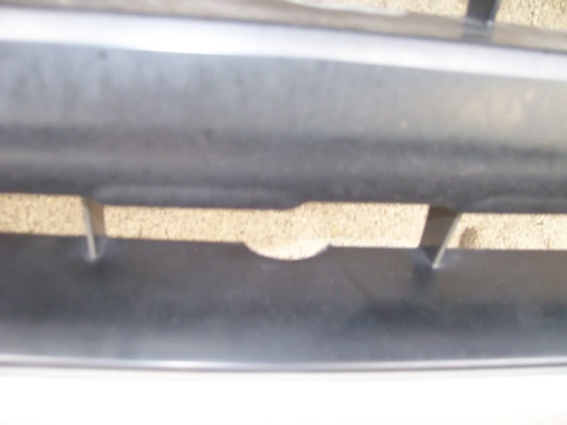

    I finally encounterd a problem.. The grill wouldnt fit. The bell part of one of the tumpets was hitting a cross member, preventing flex.. Solution.. I took a metal pipe with roughly the same diameter as the trumpet, heated it with a blow torch and made an impression on the grill where contact was being made.
    Now she fits

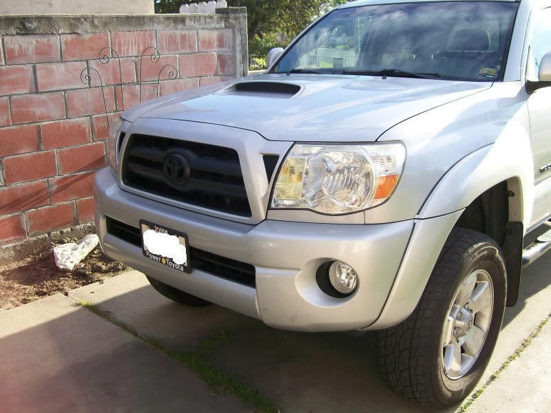

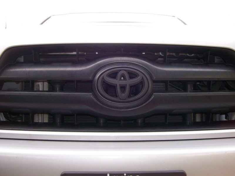

    If not for the flash, theres no way you can tell the trumpest are back there. It look absolutely stock.

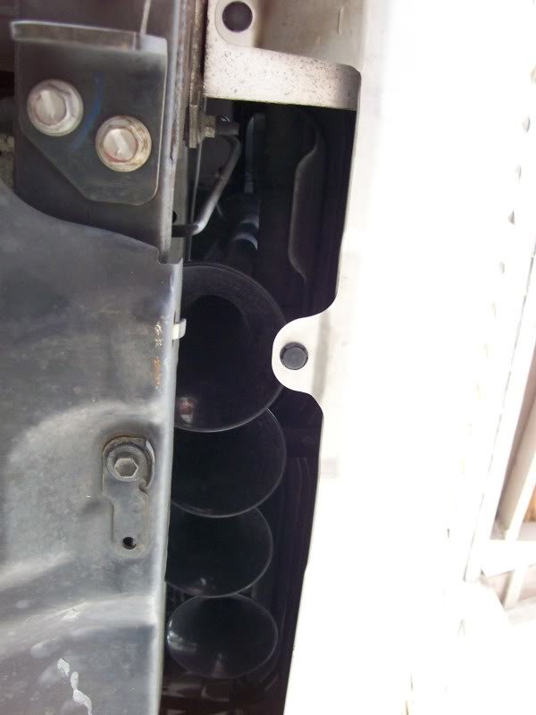

    View from underneath the truck
