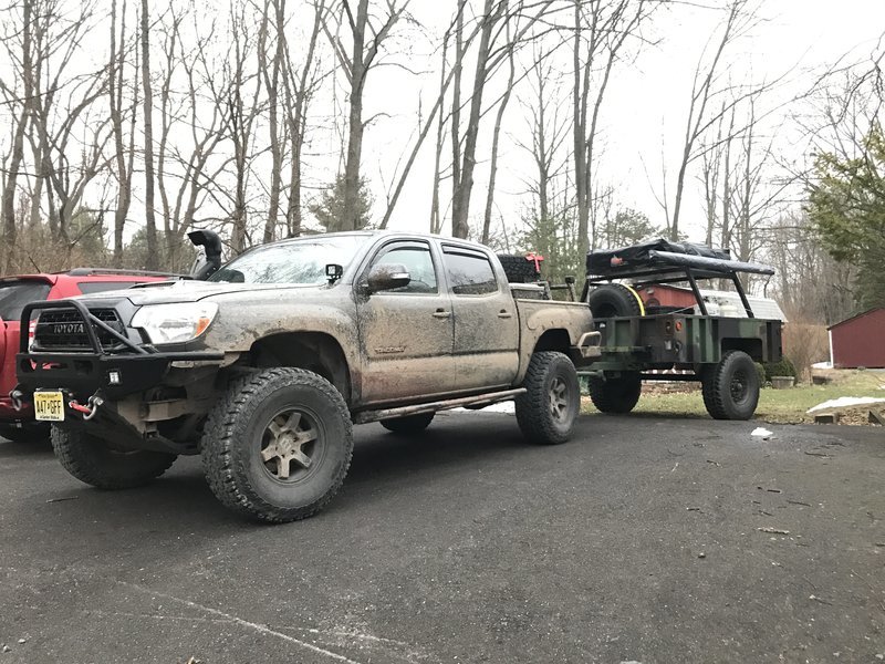

    Since this thread popped up again, I'll give a three year update. The fan and cooler are still working perfectly.
    As you can see, how I use my truck has completely changed...
    With the bigger cooler, I've never used the fan on the trail. I do use it occasionally while towing my trailer.
    I used the fan a LOT when I had a 14' tandem trailer that I did firewood with.

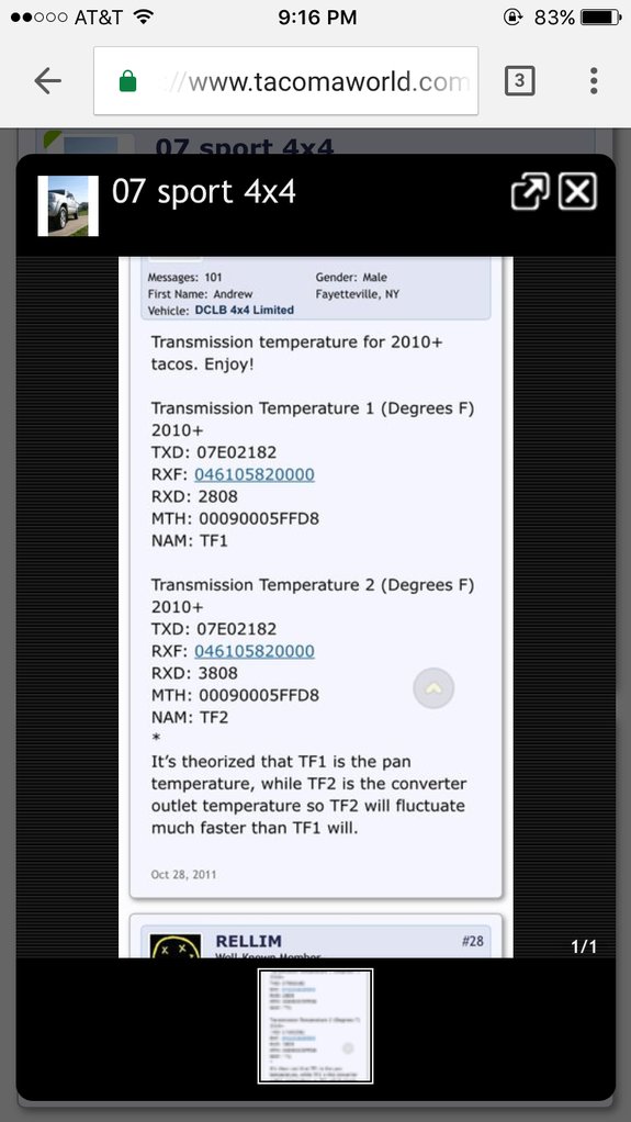

    how do you know which temp is torque converter and which is pan?
    My scangauge has a couple of codes I can program in to read ATF temp but doesn't say where they read from.
  15. Jul 15, 2017 at 5:23 PM
    #55
    07 sport 4x4
    07 sport 4x4 Well-Known Member
    Dec 24, 2010
    #48165
    1,453
    Blake
    Southeast
    2017 Duramax
    The pan is more stable than the converter. They'll both read about the same when you're cruising. When you accelerate or sit stopped in gear the converter temp will creep up.

    I'm at a thing... so I can't tell you the codes.
    But, the converter temp is the one that rises fast when the clutches start slipping.
    If the trans is hunting, the higher temp is at the converter.
