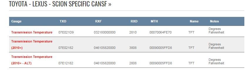

    wonder if there is typo in that pic or on the Scangauge site: The TXD and RXD should both differ or just the RXD?

    Not sure, I have an ultragauge. The people I've given those codes to say they work.

    If they're the same ones I have, they work.

    thanks guys. I'll update it to those codes tomorrow and go for a drive.

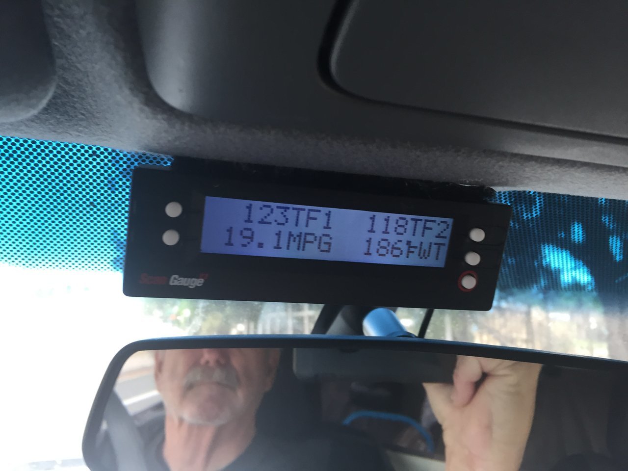

    The code on the scan gauge site for ALT is wrong, it sends a request to the wrong place:
    Use the screen print, those are the correct ones. It is the RXD - return code that has the info about temp, the TXD needs to be the same, it then displays the RXD info.
    Works great on my 2015 sport

    I've had both trans temps up for a year and a half.
    TXT both need to be 07E02182. The site is incorrect. I tried to let them know - to no avail.

    they updated the site. supposedly some subtle variation in code between different models using the codes.

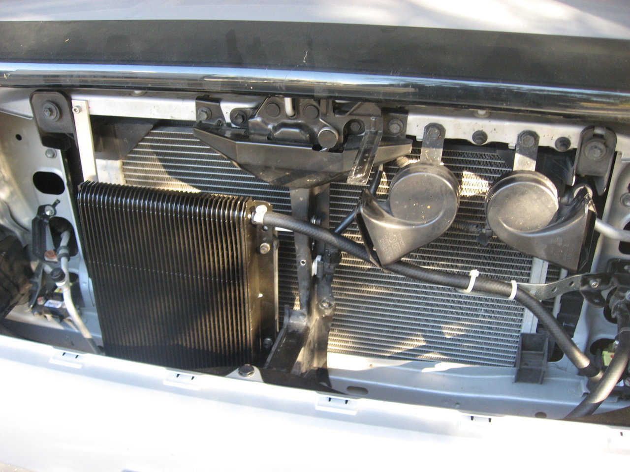

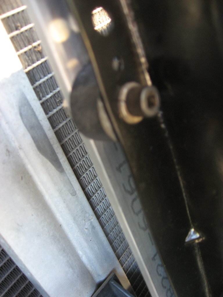

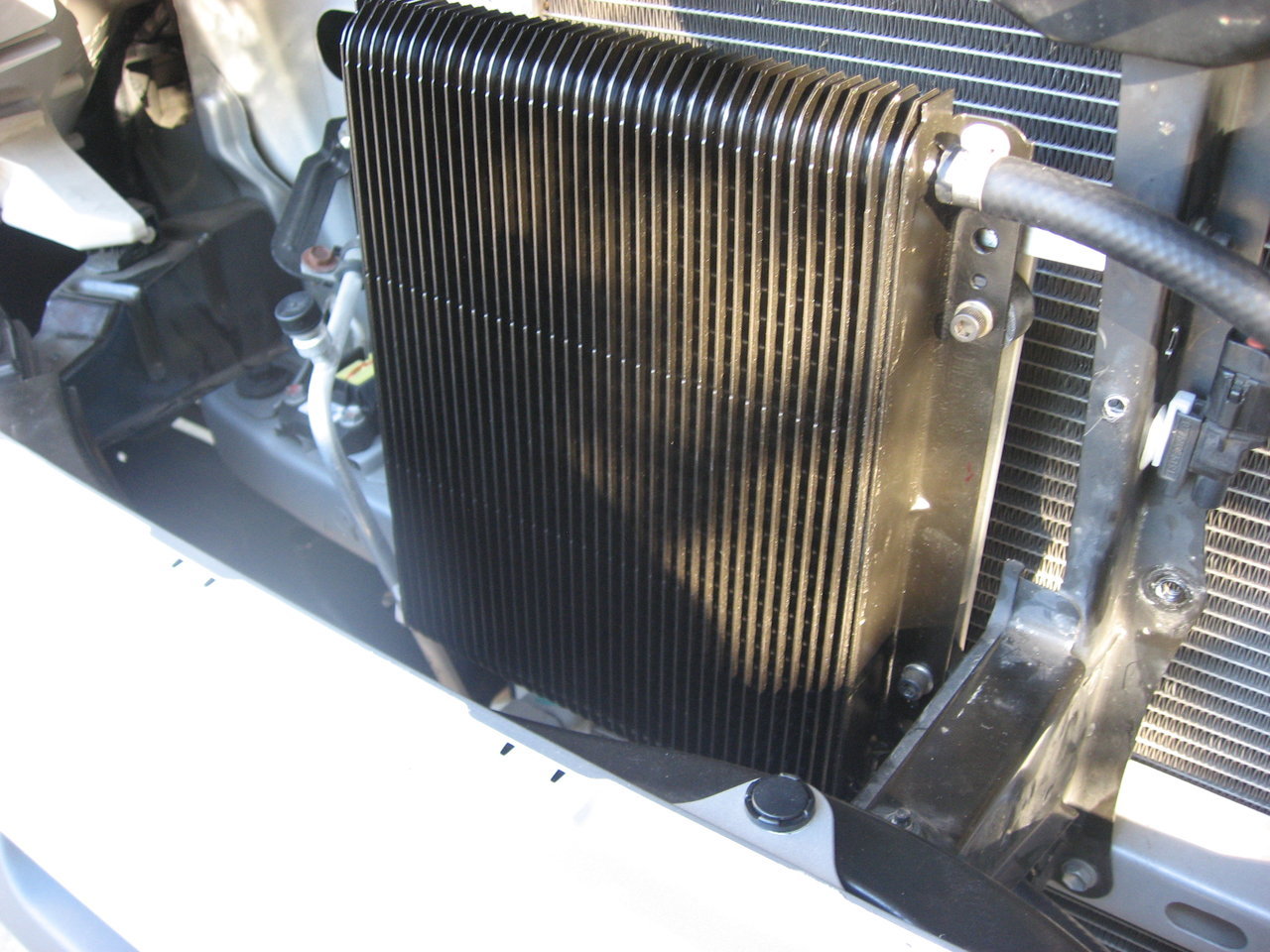

    IMG_1344.jpg IMG_1343.jpg IMG_1342.jpg 2012 Tacoma Double cab long bed which has a factory tow package. We are planning to tow a travel trailer which loaded will weight around 3800 lbs. I felt the transmission cooler wasn't up to the job on a few trial runs in 90 deg + weather so I decided to install a larger one. I chose a Tru Cool 4589 which seemed to work well for the OP. I started to install on where the factory cooler was but then noticed that the air flow was restricted by the front plastic stuff as it hung too low. I switched to the other side like the OP had done. I bought 4 rubber vibration dampeners and had a short piece of 1/4 x 3/4 alum. laying around the shop, some 1/4-20 nuts and lock washers to bolt the dampeners on. Some #10 self tapping screws to attach the framework to the truck. Fairly easy assembly once I figured out where to place it. The factory kit has stuff to attach the cooler but suggests a more robust mounting for the larger coolers. Big thanks to the OP for his words and pictures, and a big thanks to the transmission Guru guy, hate to call him old cause I am.
