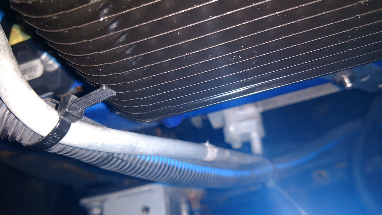

    It's tight but fits. Had to remove the plate in front of the hood latch. Never got around to posting a thread on it. But I'll look for pics in my phone.

    Here you go. Before I ran the lines and you can see the tight clearance with the a/c lines. A little creative mounting and use of other mounting points from the bumper bracket was used if I remember correctly.
    jpereira2 likes this.

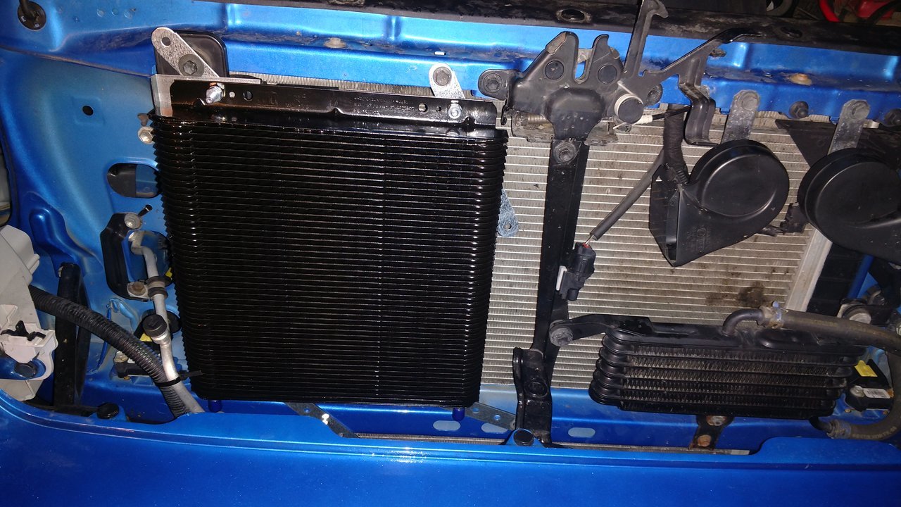

  7. Mar 11, 2018 at 9:27 AM
    #87
    Bunkin
    Bunkin Member
    Mar 10, 2018
    #246910
    24
    2007 Tacoma
    Great info!
    I’ve read through the thread and didn’t see this mentioned, for those of us that do not have a stock trans cooler, do we completely bypass the rad and run lines direct from the tans to the new aux cooler?
    Also, with the new bigger cooler in front of the Rad, is there any concern of reducing air flow to the Rad and potentially causing problems there?
    Thanks!

    Today I installed a B&M Supercooler and Derale external Trans filter. Install went kinda smoothly. Completed a trans drain and the fluid was pretty brown.
    [​IMG][​IMG]
    Right now I have the factory trans aftercooler bypassed, I just left it in place for now.
    ARoman83 likes this.
