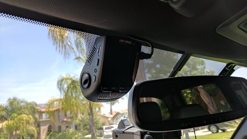

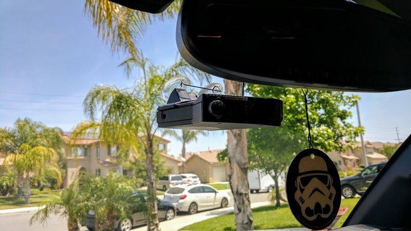

    Got it home late that night so I didn't get a chance to play with it. The next day I started the process of hardwiring my Valentine One radar detector and my Rexing V1P dashcam.
    The radar was actually a pretty easy installation. I had this RJ45 connector with some hard tipped prongs on the end that I just plugged into the back of the rear view mirror housing's connector. Found the right wire and it was set. I may end up getting a radar mirror mount that will clamp on the arm of the rear view mirror so it's off the windshield.
    Installation time 5 minutes, 1 star (1 being easy 5 being difficult)
    Next came the dashcam. I wanted to tamp off a fuse that was hot all the time because I wanted the cam to record while it was parked. So I located the dome light fuse and tapped into that. Routed the wire along the A pillar, headliner and tucked excess neatly away under the dash. Found a suitable location high enough and out of my line of sight and was done.
    Installation time 15 minutes, 1 star difficulty

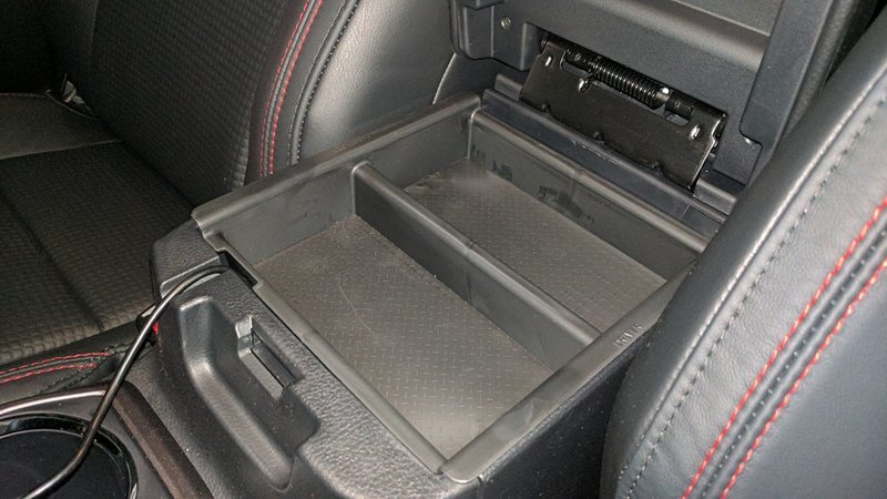

    Had some Amazon credit so I ordered and recieved the OCD center console organizer today. Just the little things.

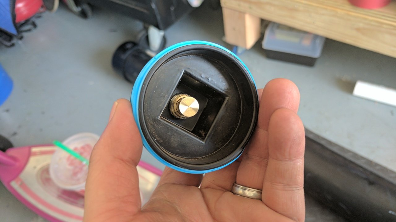

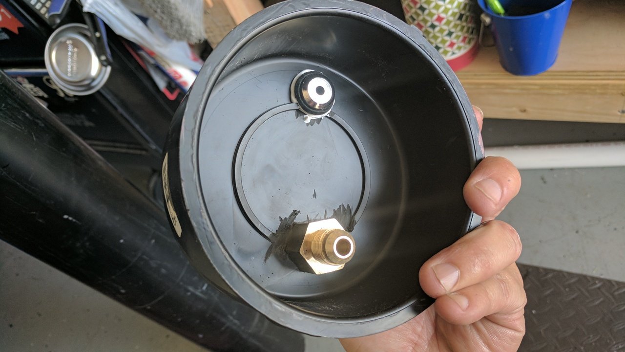

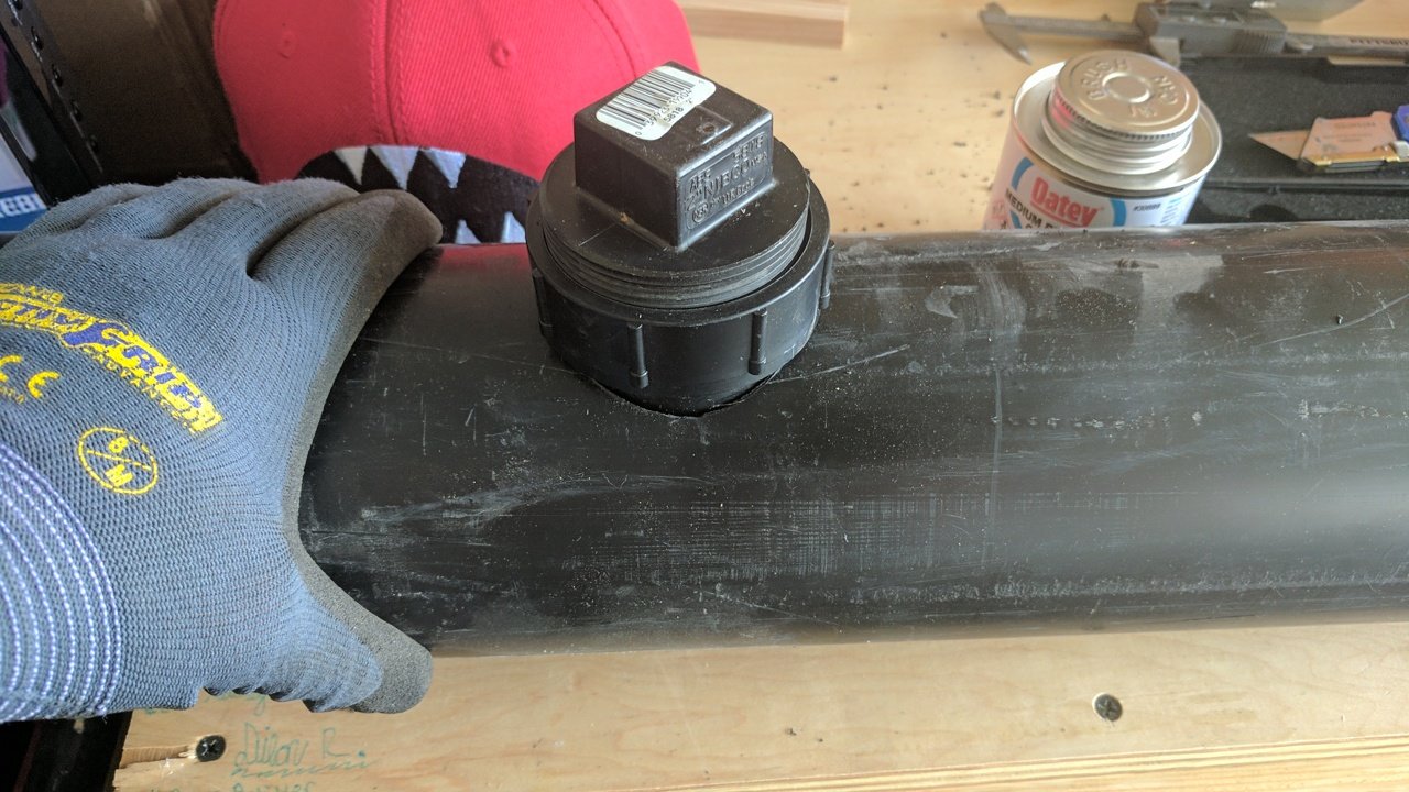

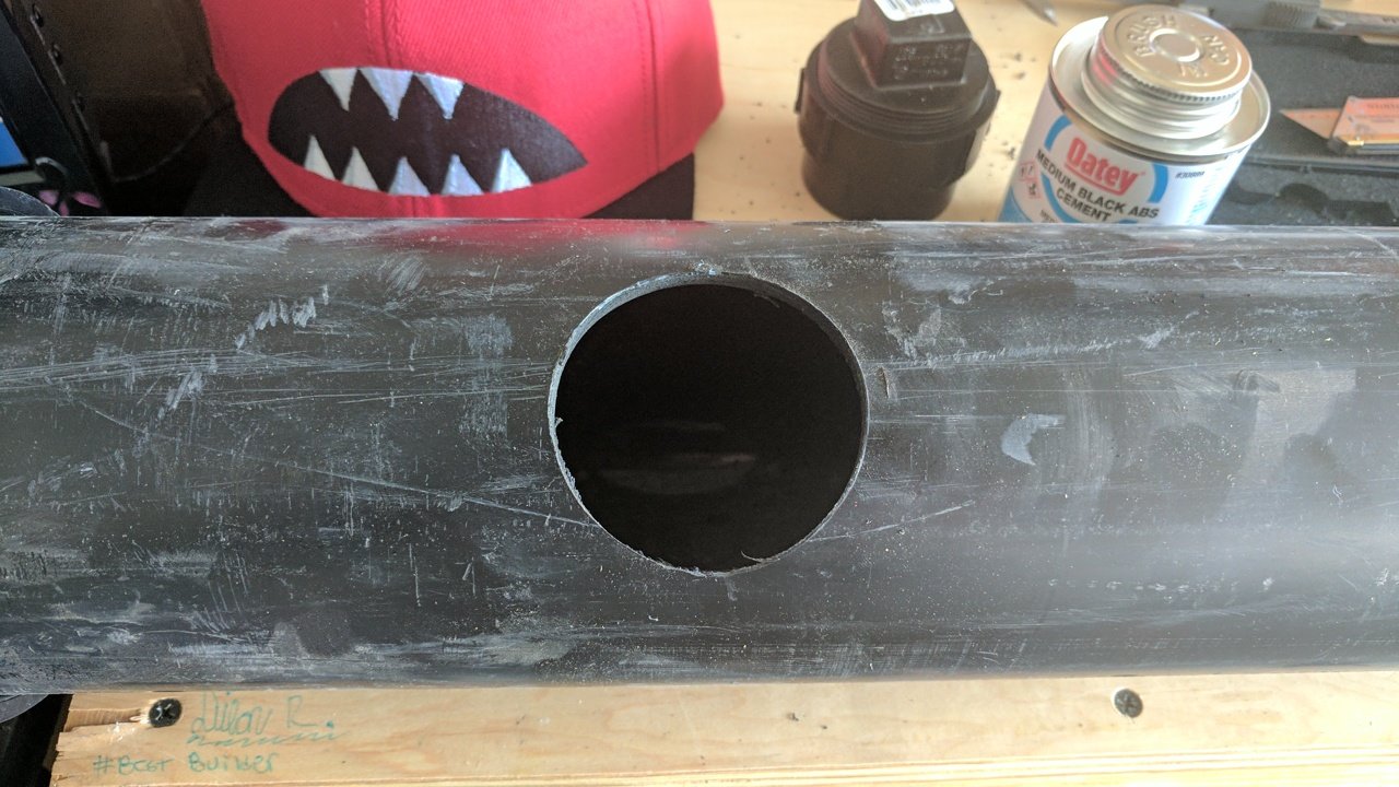

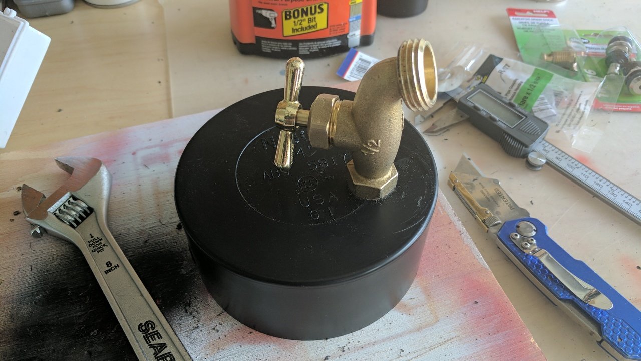

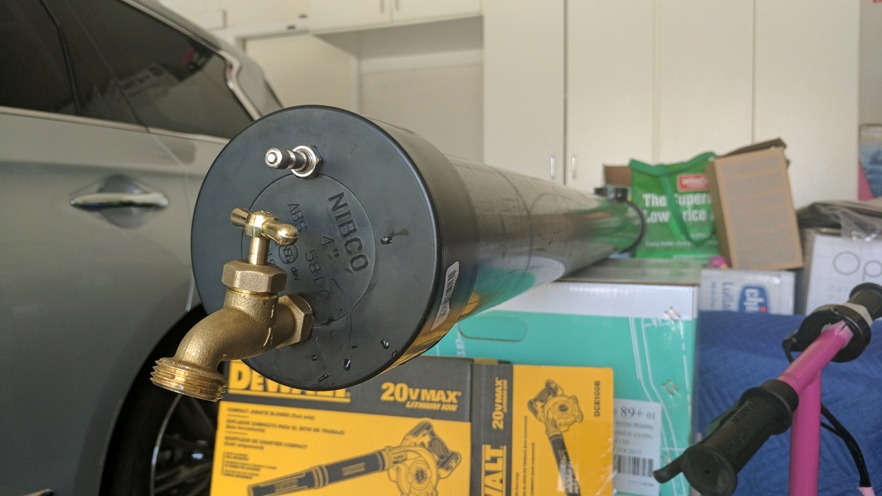

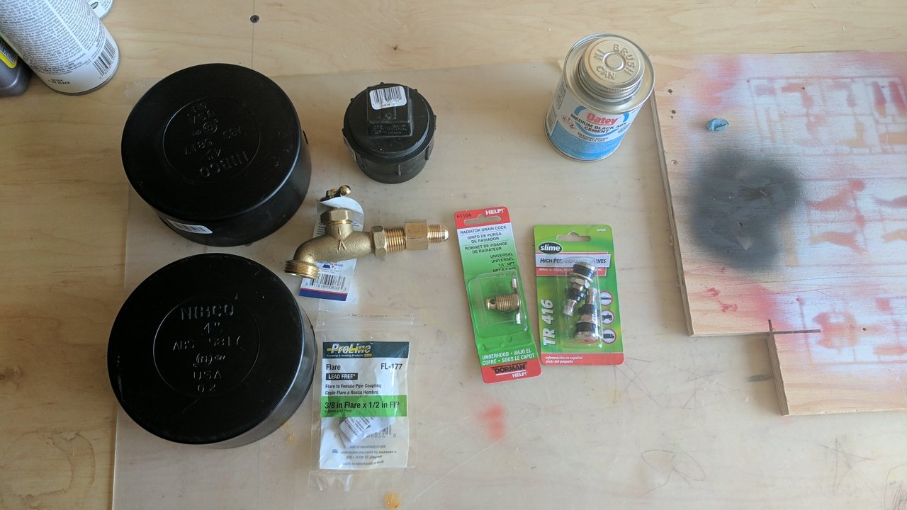

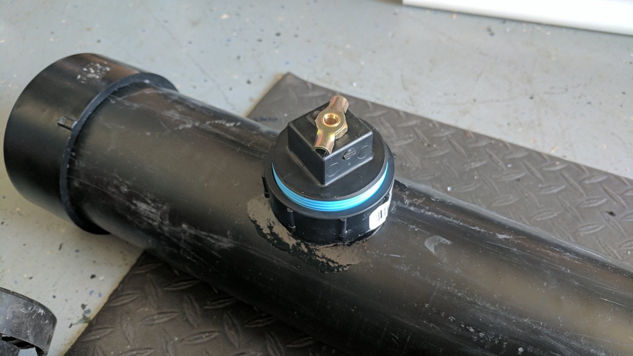

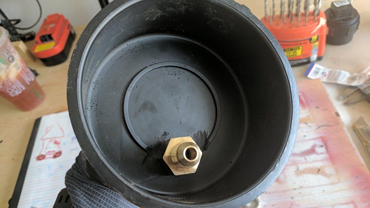

    Finally got around to building my on-board ABS pipe water system yesterday. I was inspired by this video on YouTube
    Purchased:
    - 5' x 4" wide ABS pipe
    - 2 4" end caps
    - 1 threaded 2" stub
    - 1 2" top cap
    - 1/2" hose bib and retaining nut
    - 1 package of threaded valve stem - the one i purchased from Vato Zone was from Slime comes in a pack of 2
    - 1 radiator drain pipe
    - 1 can of ABS cement
    Since I have a shortbed, a full 5' pipe wouldn't fit in the bed of the truck so I cut it down to 4.5' and accounting for the hose bib it fit perfectly in the bed. If I had a bed rack I would most certainly have kept it the full 5' to get a little over 3 gallons of hot water storage. It'll do for now.
    Took me around a good 2 hours to work on this and the hardest part for me was having the patience to wait for the cement to cure before pressurizing it. I didn't wait and pressurized it and sprung a leak at the junction where I drilled a hole in for the fill cap. So i repaired that and let it sit overnight, I'll be testing it again.
    BTW I want to attach this to the built in rail on the passenger side, if anyone has any ideas on how to go about this, input is much appreciated. I was looking at some adjustable clamps/straps just not sure what size T-nut or tab that will fit in the rails to slide them in and attach.
