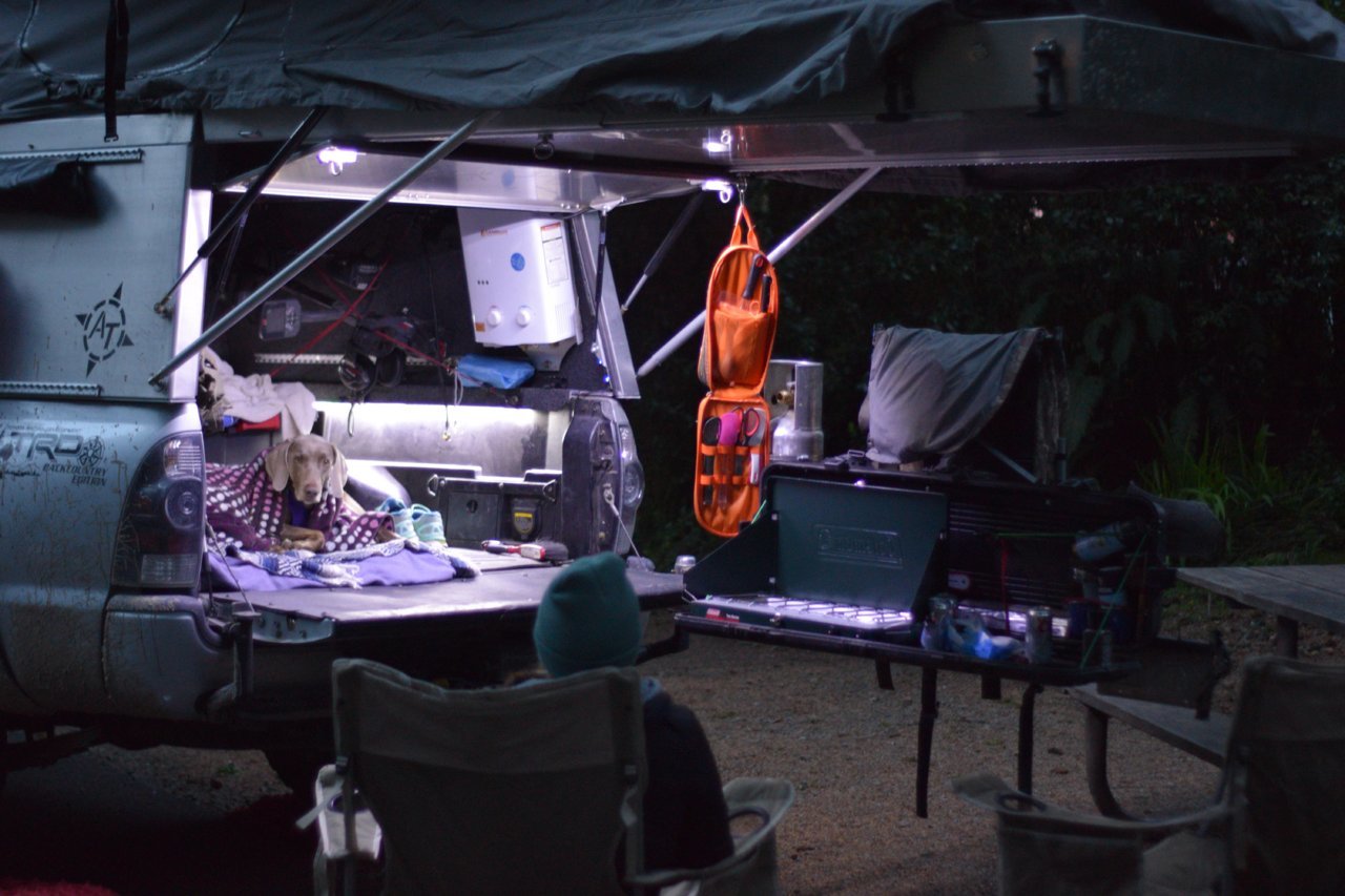

    I was also originally thinking heat exchanger but the instant hot water with truck off is way more convenient for our particular setup (you can see heater installed on shell wall here:
    Drilled and tapped this switch into ABS with appropriate 1/8npt tap and ABS glue. (guess it was 20psi not 15)
    Installed with a 2 pin pigtail to my compressor toggle switch so when I plug the pigtail in it automatically charges tank and shuts off when it reaches 20psi

    Yes Viair is hard mounted in engine bay. I have heard good things about that litttle compressor you have, and it would be the same functionally for this application as the viair.
    Basically I just remote mounted the Viair on/ off switch to my truck bed near tailgate, then ran a second pigtail with a waterproof two prong connector from ebay that can be connected to the tank's 20 psi switch when we want water pressure. When the pigtail is plugged into the switch it completes the circuit and powers the compressor, when the tank reaches 20 psi the switch shuts off the circuit and the compressor shuts off, when water pressure drops below 20psi during use, it automatically kicks back on.
    The sensor I just mounted near the water fill hole and tapped into the ABS. Don't have any good pics of that particular part handy. In the picture of tank I posted earlier you can see the Blue air hose quick connect, right behind that is the pressure switch.
    I ran an air line from the viair in engine bay to the rear bumper with a quick connect at rear bumper, and quick connect on water tank, so I can run the same coiled airline that I use to fill my tires to pressurize tank.
