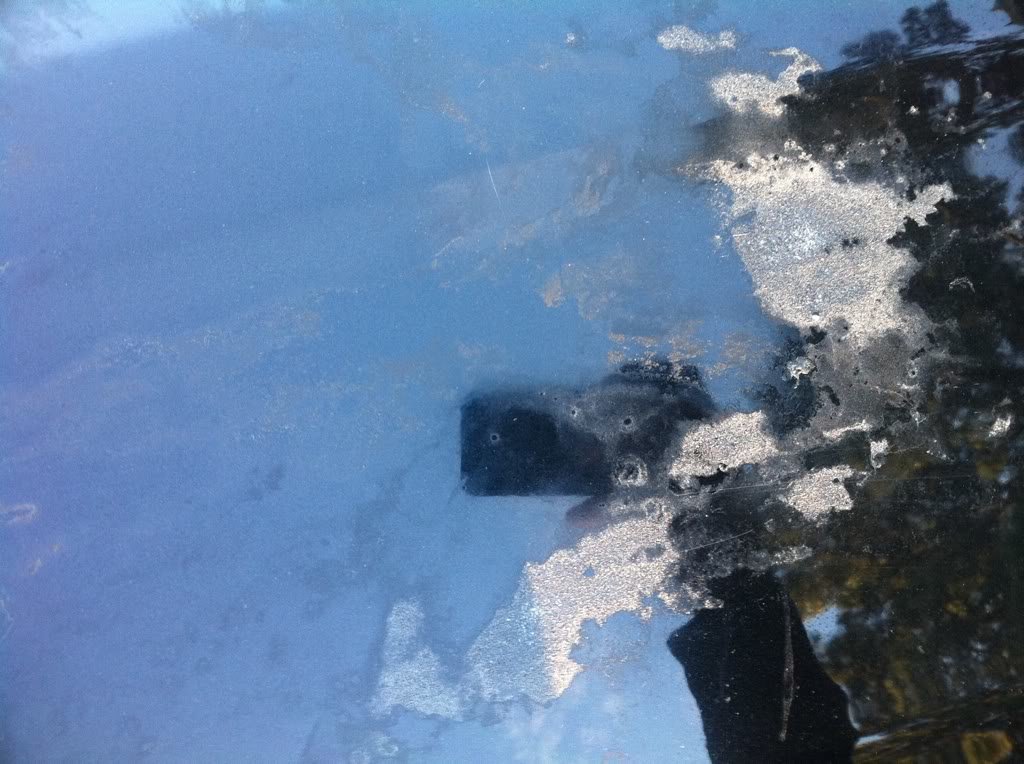

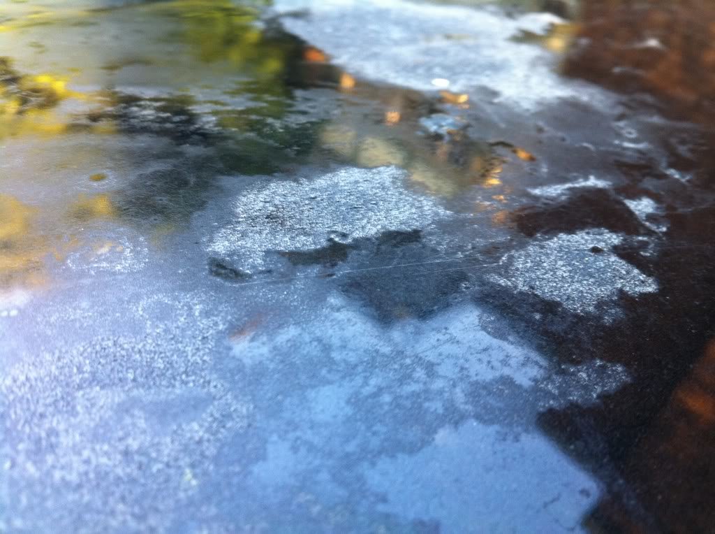

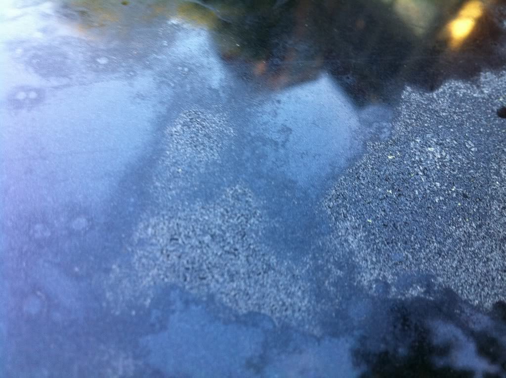

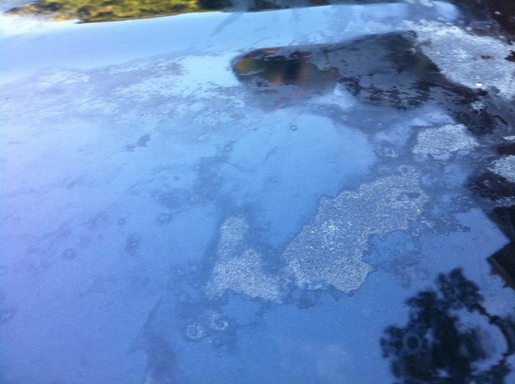

    So I have the same problem, except the egg has been sitting on the roof for some while now (a few months). So I finally had the chance to wash it yesterday and it did not come off at all. I'm hoping it didn't eat all the way through the paint. It's a little rough when you rub you fingers over it. You think some goo be gone stuff would work, like mentioned? Any advice?

    Holy shit.. that's some damage.:eek:

    Dang man you definatly shouldn't have left it. I probably has eaten through the paint. Best thing I can tell you is to get some rubbing compound might help you out.

    I hate to tell you this, but your paint is in huge trouble. A few hours is all it takes for the egg to start eating the paint. A few months:eek:.

    Don't know why you left it. Get that crap cleaned off asap
    in that pic you can see the paint is eaten away, there are visible holes and it just looks eaten away

    My brother-in-law who I showed your pictures to is a manager of a body shop. He is saying that your clearcoat and paint is ate up. What you should do is go to a paint shop, have them sand your roof and repaint it. Any paint shop should be able to blend the new color of your roof into your old paint.

    Get a quote first. Also since you really can't do any more damage. I would try a few of the things mentioned in the thread. Might be worth 20 bucks to give it a shot.
