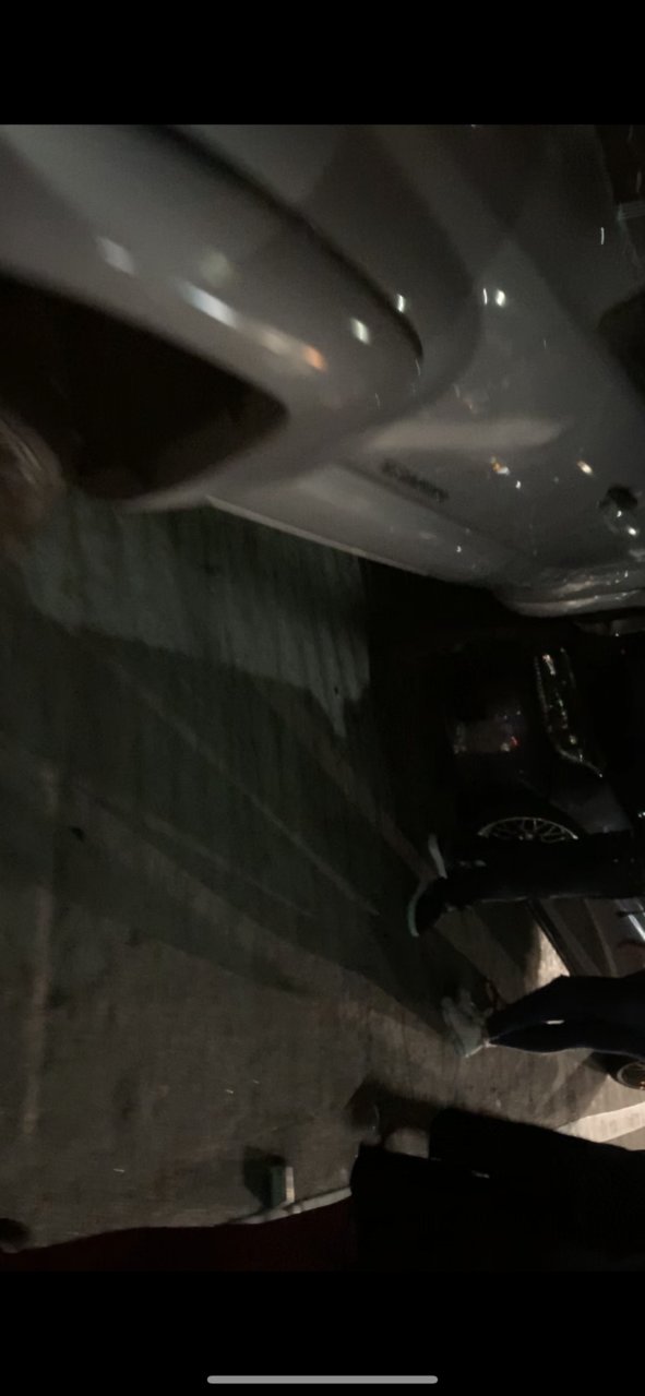

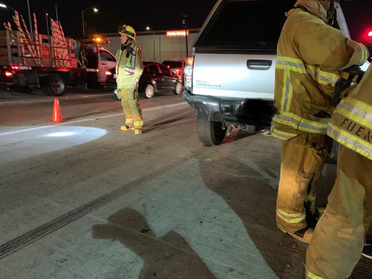

    Hey TW.. hard times for me right now and just wanted to get some input on this.
    While I was fully stopped on the #3 lane on a red waiting to make a right, my wife and I were waiting for about 30 seconds for the red light. We then heard some loud tire screeching from behind us then a boom and looked at each other with this face of “oooo someone messed up” towards each other and about 3 seconds later BANG!! We were struck from behind... my wife and I sort of blacked out for a few seconds from impact and surely enough someone was lodged underneath my truck. I thank god my wife and I are okay along with the other parties involved. I didn’t happen to hit any cars in front as I was pretty far from them when the collision happened. So all damage was made to the rear of my truck. Now, since this happened on Thursday and the party at faults insurance is still on standby for accepting liability I haven’t been able to determine by the insurance adjuster what the condition of my truck is. I made a claim with my insurance as well against the other party and my adjuster will be checking the truck out Monday - Thursday.

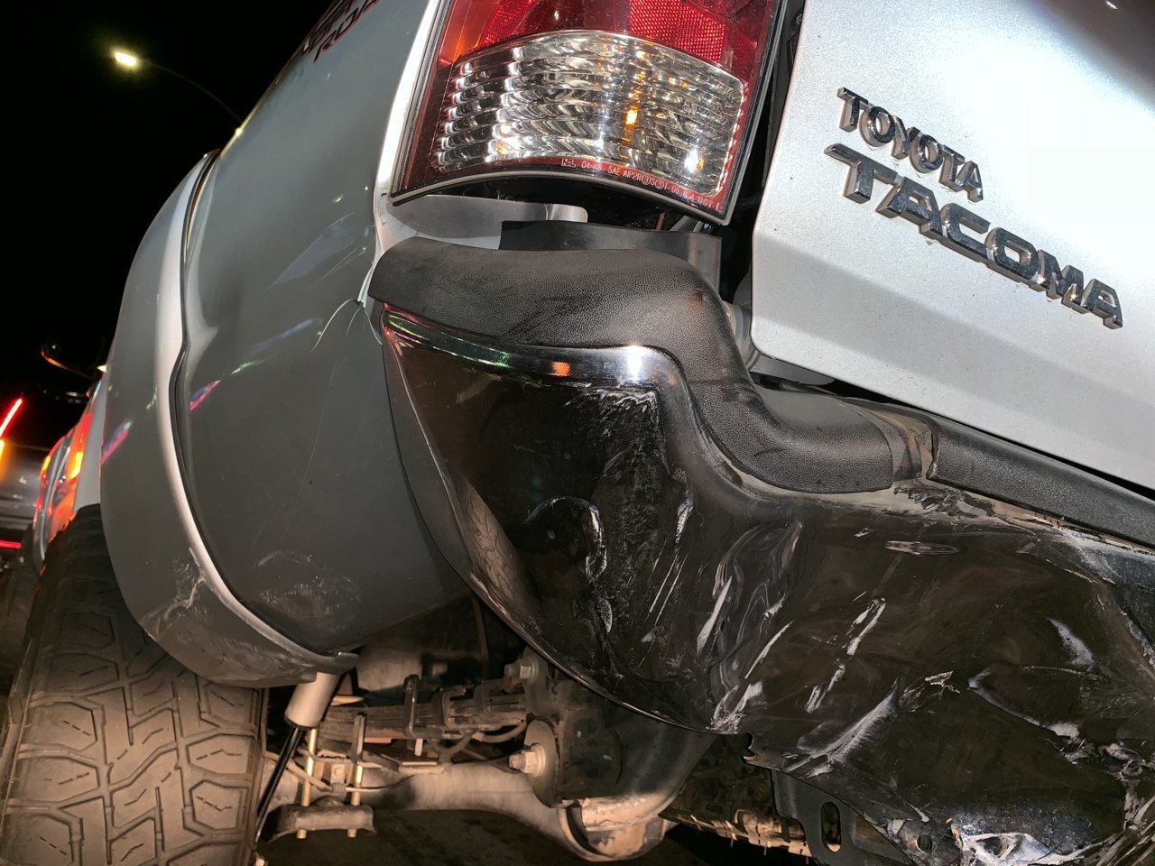

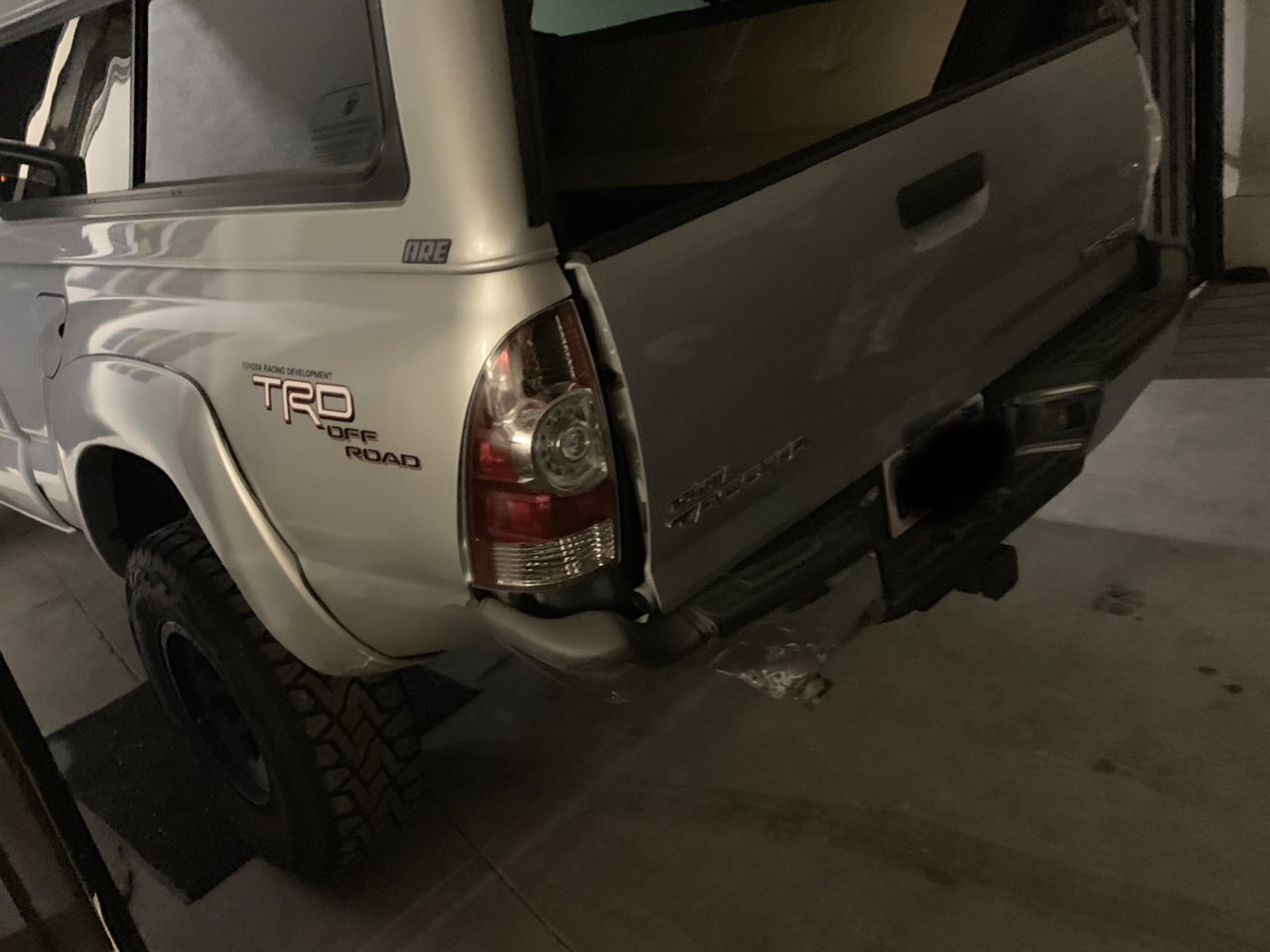

    Now from what I’ve seen on my truck this is the damage I’ve noticed.
    -rear driver bedside
    -rear bumper
    -tailgate
    -tow hitch bracket
    -leaf springs and brackets
    -axle
    -shocks
    -driveshaft
    -transmission

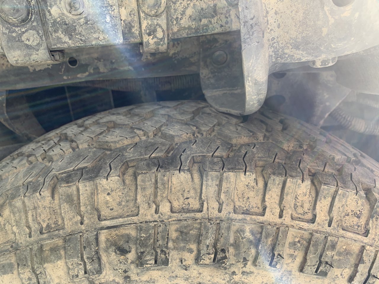

    So here’s what I can say about those items. The rear driver bedside is pushed up, in and out towards the left. Rear bumper is pushed inwards and up. Tailgate brackets that hold it in place is broken off. The towing package that whole bracket is pushed in and up. The driver leaf spring is pushed forward and bent out of place. The driver leaf spring bracket for the rear of the leaf spring is pushed forward and up which bent the frame of the vehicle where the bracket is. The rear axle is pushed forward on the driver side which pushed the driveshaft forward which pushed the transmission I’m guessing cause now my transmission is squeaking a lot (maybe the bellhousing shifted or bent?). So with that which I’ve seen visually I do not know how much it will all cost to fix. From what I’ve been told, it might be a total loss... what do you guys think???

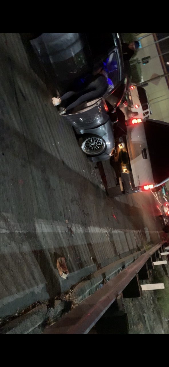

    Here are some photos of the accident and some photos I was able to get of the damages. Some photos are stills taken from video, sorry if some are blurry.
    78BDB9F1-4740-49E0-8940-E3466439CF06.jpg 2858DB4F-BCBD-4274-B15B-020ABE93EBFD.jpg 46786A66-5BCA-4B61-99DB-4FCB616DD240.jpg 4FAEEE83-7689-4106-B8E6-A80358F28C61.jpg E7F7D440-7EC7-415E-8BB3-0DD5EA94E959.jpg2B674706-E85C-4519-806F-6B850FE115FC.jpg

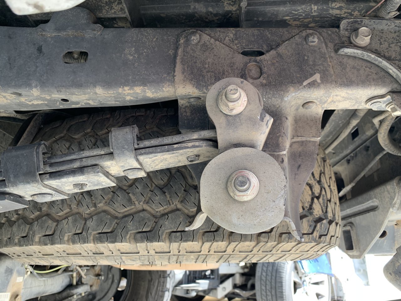

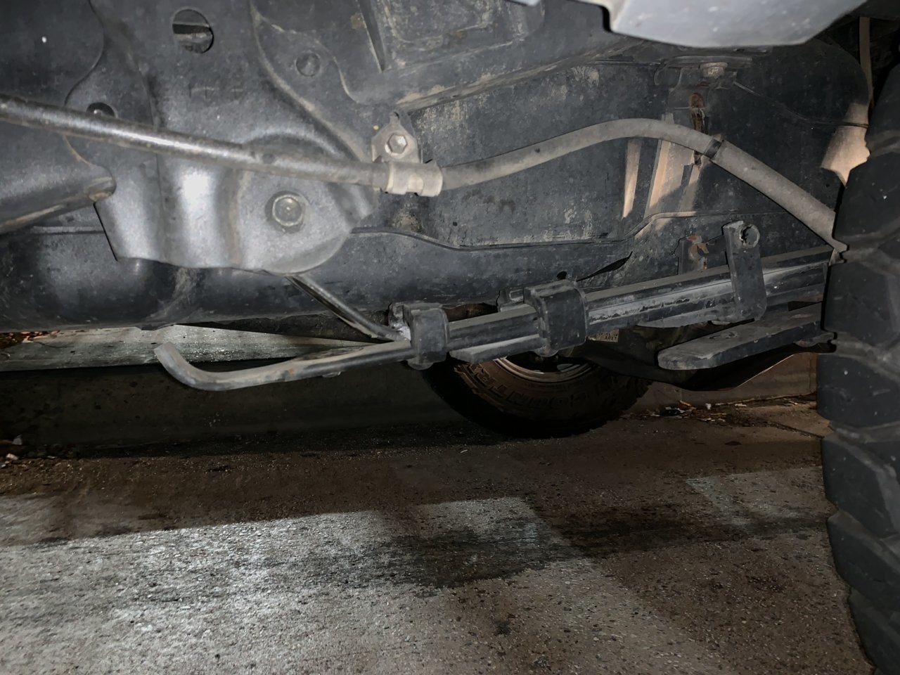

    This is where the frame is bent
    68B5DF2E-704E-445E-85DC-24E1357397DF.jpg A1FF4DF7-276D-47B5-AAB8-CB0E0805E16C.jpg

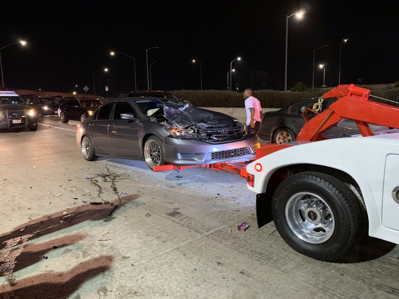

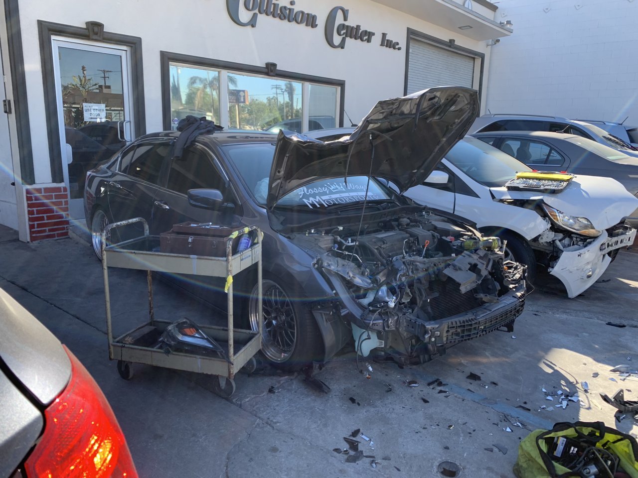

    Here’s the other guys car the one that rear ended me
    1934FF8A-E084-4E85-904C-074205AD95DE.jpg 25626E16-2ED2-41D1-8955-1EAA8DDA7B82.jpg
    Yup. I just want to have an idea as of now what the outcome may be as far as fixable for my truck or total loss...
    Anyone that has input on what it may be please chime in, thanks TW.

    By the Shop touching it they may be trying to make it look not so bad to the Adjuster so they can get the work (just my opinion) BUT they should not touch it until the Adjuster has seen it and you have Decided Where you want the work done..... personally (again my opinion) I would take pictures of it at the shop and asked them to cease work until adjusters from Both insurance have have viewed and made the offers to you.

    Once your insurance sends the information to the collision shop of choice, the collision shop will then "tear down" your vehicle. This allows for all of the damage to be seen and an estimate to be written. The adjuster shows up, reads over the estimate written by the collision shop and verifies with the damage seen on the vehicle. Its normal practice for a vehicle to be taken apart before an adjuster shows up. A lot of times, pictures are sent to the adjuster, and they'll approve work over the internet.
    Personally, I think your truck will be on the line of totaled/fixable. I would lean towards totaled, but I have personally fixed worse. Nonetheless, glad you're safe and good luck with the outcome!

    Not quite. I was rear ended last year and it bent the rear of the fram inward and rotated it a few degrees down. It was cut out and replaced with a section sent from Toyota. All in all, around $10k in damages to my 5 month old 4R
