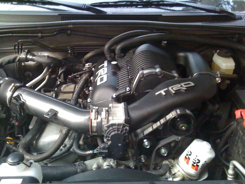

    Hey there everybody, I recently just put on the TRD S/C:yay: And i am wanting some exhaust to match with it. Is there any special kind of exhaust to use with the forced injection engines for the most power. I have been looking at the URD 3 inch, and it says that it works best for supercharged applications, but is it that superior to say the TRD exhaust. I have been looking at headers, but i am in Cali and the CARB regulations are bad, so unless i find a super deal on some long tubes, i would get the short tubes because they are CARB approved. :D
    Here is my beast now :)
    PS I already have AEM CAI and the URD Maf cal
