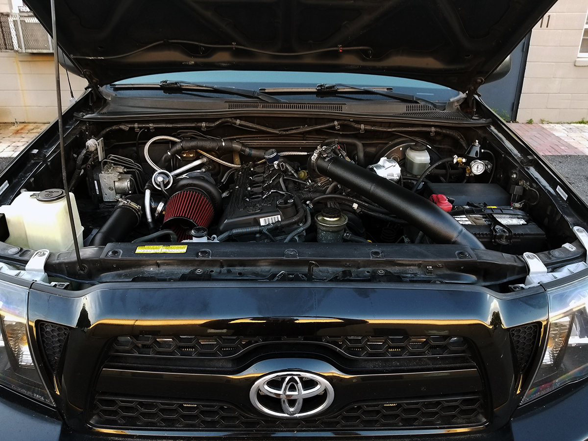

    While I love my truck, merging onto the highway with the 4 cylinder purring under the hood really gives you some time to reflect on all of the poor choices you have made in life before you get up to speed. All it is really missing for me is some low/mid range torque.
    Decided to pull the trigger on the ozboost kit as a baseline. In my opinion this is a good starter kit but very far from what I would consider complete.
    Here is the turbo after being completely torn down, internals replaced, balanced, wastegate port ported, and coating.
    Intercooler fully mounted. The grill fits perfectly over it and the hood latch works like factory.
    Added an AEM fail-safe wideband gauge to the factory exhaust piping which I will be retaining as this will be a low boost application.
    Next up is drilling and tapping the upper oil pan for the turbo oil return before the real fun begins....

    Well, I was able to get some more done in between work, but getting close!!
    Was able to tap the oil pan for the oil return and give it a nice clean shot towards the turbo.
    Turbo installed. AC lines had to be gentle bent out of the way to make room.
    This is what it "should" look like without the intercooler. I am going to get the truck running without it first to make sure I can battle off any check engine lights before attacking the pipe fabrication.

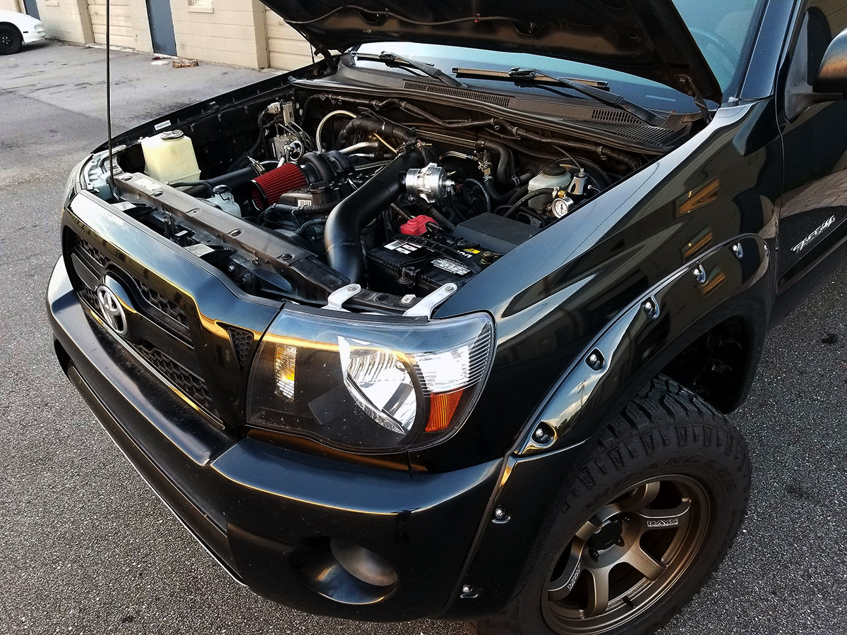

    Ordered the MAP ECU 3 today, should have it next week. The patch harness was delayed by around 7 days but I may just skip that and wire directly to the factory harness. I haven't tuned a MAP ECU since it was on it's first version... so this should be interesting.
    Which one exactly are you looking at? I have loads of fittings in stock
    With this setup, as much as I could with a piggy back before pissing off the ECU too much. I did build a little big larger turbocharger for the truck after I get this running right... but I don't have an excuse good enough to justify going with a standalone since I bought the truck for a daily...... for my daily driver which ended up getting a built engine and huge turbo.

    I ended up putting this bad boy together for the next stage of the project after I get it running good on the GT28 -
    Drove the truck home from the shop today for the first time as I had no choice... have to haul alot of equipment there tomorrow for an event we are having and the truck drove without a single hiccup.
    Depending on how much free time I have next week, I will start on the new intercooler piping fabrication and new intake as well.
