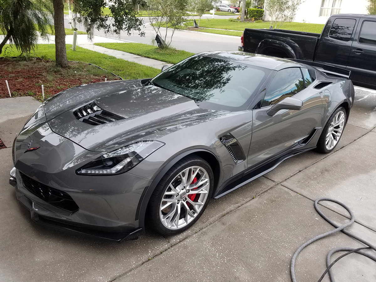

    Sorry for the lack of updates, got a new toy.. but the truck is still running awesome!!
