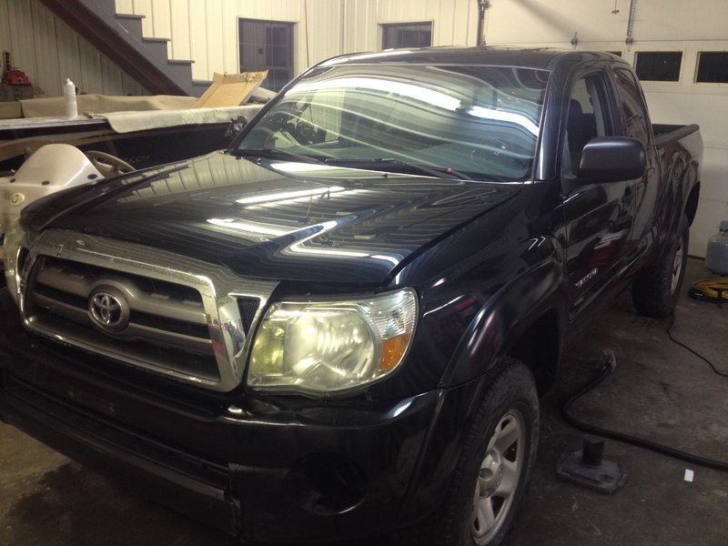

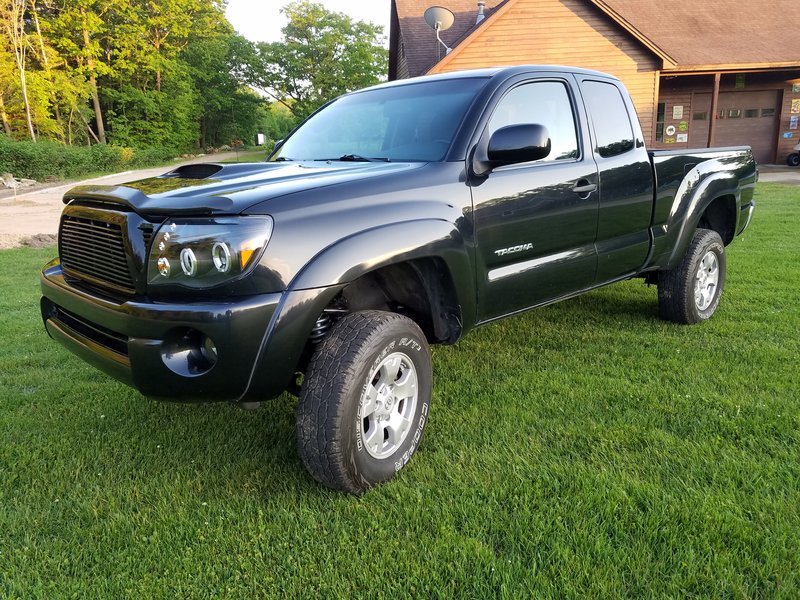

    What kind of program do you use for tuning? I am gathering info for a two stage project. First, adding turbo with stock programming and components. Have come to understand if you want quality, it's better to buy the components yourself and get your hands dirty. Second, will be adding programming and inter-cooler. Can you provide a list the components you used on your build? Thanks so much!
    Before and after pics: IMG_1592.jpg 20160529_204421.jpg
